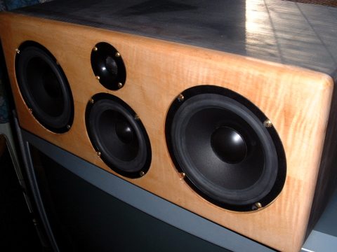

Bricolo said:Al, if I want to finish my speakers this way, have I to use solid wood instead of MDF?
The rounded edges might be difficult with veneer, but the process should work fine, it is a finish that shows good wood to it's best, but most decent veneer has a very good figure anyway.
The hardest part of veneering around a corner (sound like a description of the way I drive!) - is that the grain makes it difficult to get smooth...You end up with a high line instead of a nice curve. I hear a bit of water on the veneer helps, but I found strectching it as much as possible, before splitting it is OK too...
My next speakers will definately be real solid wood...Al, where did you source that flamed sycamore from; it looks stunning!
I have been working my way up the finishes. First I used a quick hammerite paint (!), then properly sprayed, then veneer and next will be proper wood!
I don't understand your answear
I was asking if I can do the same thing as you with MDF wood, or will I have to build the cabinets only with solid wood
Bricolo said:I was asking if I can do the same thing as you with MDF wood, or will I have to build the cabinets only with solid wood
Sorry, I thought I anwered your question🙂
The method I used was to build the entire box from plywood, including the front, and then apply a decorative baffle of solid hardwood. You could do this with MDF, as it is finished black, any material will do, but you may have to use paint rather than stain on MDF.
If you were to make the box entirely from MDF, then you should apply veneer, as Rarkov and many others have done, and then you could finish the veneer as I suggested, with oil and wax. Bare MDF is only really suitable for painting IMHO.
Gaz- I have a very good woodyard 2 miles from my house!😀
http://www.slhardwoods.co.uk/
The sycamore just came in with their regular stock, I just happened to be in that day and almost grabbed it off the truck. It was just a coincidence, there were only 2 boards with that figure, and they happened to be bookmatched. Some other bits went to make my Gainclone. Pics here-
http://www.diyaudio.com/forums/showthread.php?postid=135432#post135432

Rarkov said:The hardest part of veneering around a corner (sound like a description of the way I drive!)
Ha Ha Ha Ha! I'm with you there Gaz! Map in one hand, coffee in the other....!!
I have just priced it up. It'll be £222.98 to buy enough Birdseye Maple to rebuild my present speakers... Maybe next year! 😉

Gaz, I saw the pictures of your new speaker project, on your website
can you give me some details about them?
Bricolo said:Gaz, I saw the pictures of your new speaker project, on your website
It ain't happenin'! At least not yet! I have all the Audax drivers but I heard some Neat Acoustic Ultimatum MF5s. They were fantastic so I spent loads of money on good drivers. I tried bending wood to make those speakers but the problem I had was not getting a uniform curve, but getting it all square and true. Maybe when I finish my CNC Routing machine, I'll CNC a profile out of thick pieces and join them up. If I'm clever, I'd be able to CNC tonque and grooves into these profiles so I would, in effect, have curved laminate flooring! 😉 Anyway - that is a while off yet...
