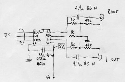

the schematic you link at is uncorrect IMHO:
the 47k resistor must be connected at the signal output after the caps and at ground , while in the picture they are connected at ground and at the ground of the output pin
I also use filter the high freq with a cap across the 1k I/V resistor : my first set is 2.2n but I suspect that I will prefear a 12db/oct slope; more listening will tell me what to do .

It is a D/A converter ,the TDA1543, that accept I2S signals format at the input (at the left) ;
It is complete of a passive I/V converter (pin 6,8) output stage , and a resistor ,1K at pin7 ,for a voltage reference that is essential for the DAC circuit.

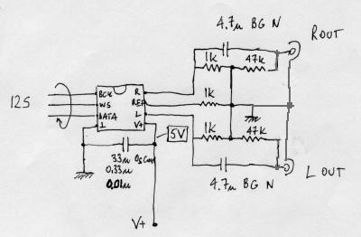

I will try and look into your points about the schematic. I hope they're correct, but easy to fix if not! Thankfully! 😉
I haven't been able to run the DAC yet (as it solely accepts I2S) but when I ordered the CD-PRO2 uint - the bloke said that the onboard DAC is excellent...so it's just a case of trying them I think.
I've just checked the datasheet and nothing was mentioned about output stages...I'll ask Peter Daniel...

Yes, the 47k resistors are connected on a schematic between 2 grounds, which doesn't make sense. They have to go from output to ground as mentioned in a post. They are only there to discharge the caps and I'm not using them at all. You may expect a thump in a speakers when powering on and off, but my DAC is always on so I don't worry about it. In the Kusunoki schematic, there were some caps across 1k resistors (3.3n), but I decided not to use them. The DAC works fine without them and sounds great. I'm using Rikens for I/V resistors and 3.3 u MIT RTX for coupling caps. Reclocking brought big improvement and better PS is also important . This is my currently best DAC, it's better than anything I tried with oversampling and it's also better than TDA1541 in my Marantz CD-94 (non oversampling and partly modified). It may be not the first word in dynamic, but I trade it for resolution and ambience I got with passive output stage. Here's the link to some pics: http://www.diyaudio.com/forums/showthread.php?s=&postid=175127#post175127

This points out the bad points about PCBs!!!
Oh well...Shouldn't be too difficult to change.

If you add a digital filter chip it will be 4x oversampling, otherwise non-os. Peter ment asynchronous reclocking. This is reclocking with a different frequency than SP/DIF. You could contact Elso Kwak for a circuit... (see also my Nonoz page at www.fedde.tk)
