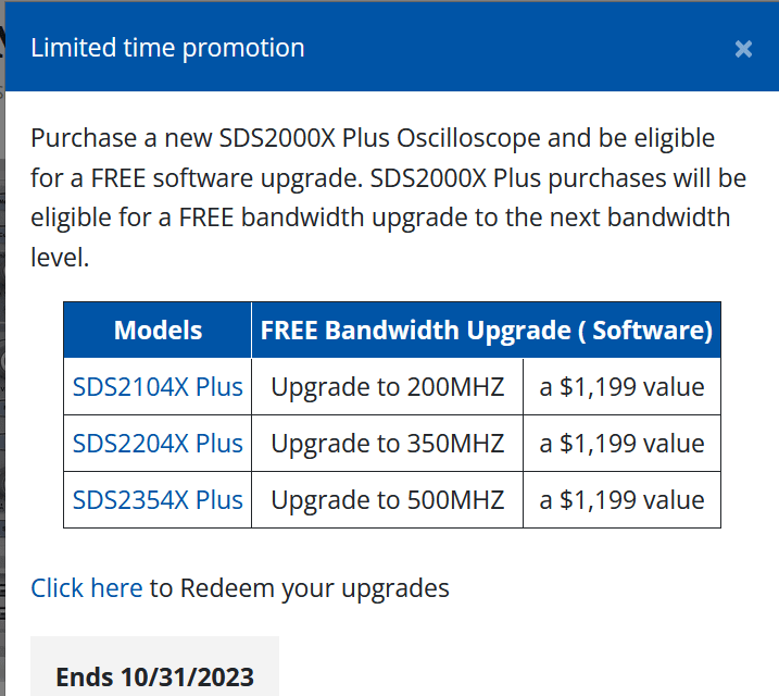

Maybe another to look at, the Siglent SDS2104x Plus which has 10 bit quantization, and is reasonably priced at around $1400 USD,
or the SDS2104x HD at 12 bits for $3300 which is a bit of a budget buster.
The SDS2104x Plus is a 10 bit, 4 channel 100MHz scope which should be a significant step up from my TBS1052B which does have separate sensitivity controls for each of its two channels, but is otherwise rather unremarkable and not very good for analog stuff.
Note that they are currently offering a bandwidth upgrade to the next step if you purchase one of the Plus series scopes at TE equipment (US)

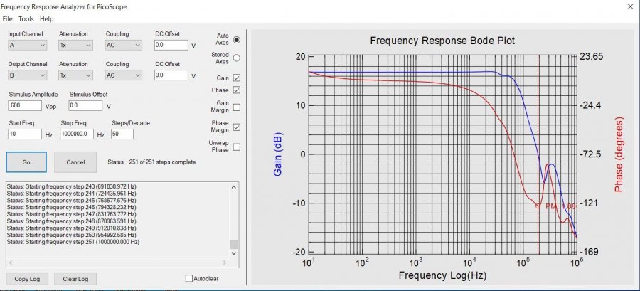

The Bode plot from the Pico 2206B (8-bit) for valve amp application appears to be sufficient to allow identification of gain and phase margins in an amp with circa 20dB feedback, and uses a 3rd party FRA software (still being supported but for 32-bit and up to Win10), but is limited to 1MHz and appears to be about the same cost as the 1104-XE.

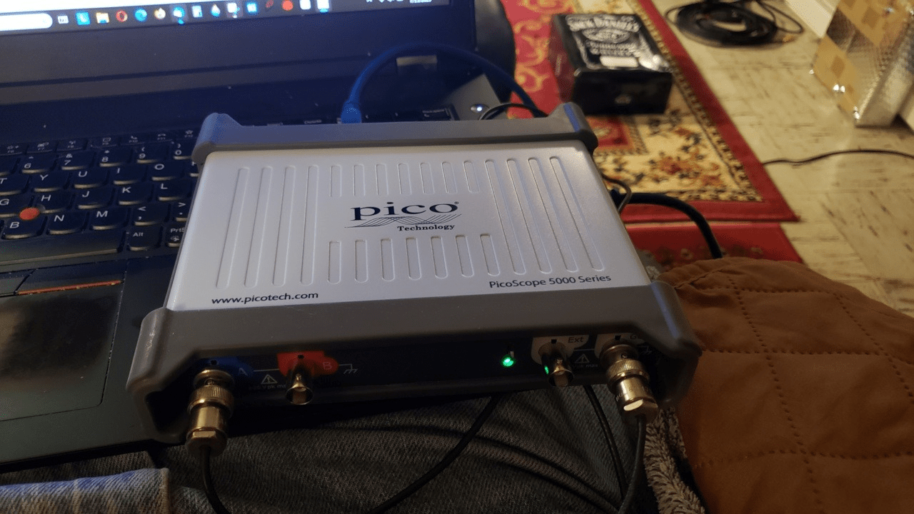

I'm having a Picoscope 5203 starting back from 2010 and still using it! Changed the fan a couple of times because it was noisy over time but the rest is working properly. Didn't had the time or money to ship it back to Picotech to calibrate it ... yet. Since it's sending data over USB , I'm also using a Intona USB isolator for it upgraded with a linear PSU. The signals are sent to my desk monitor which is far bigger than any other scope I have lying around. In fact, this Picoscope was the main reason why I don't use scopes that are showing signals on a small screen. I guess I'm suffering of claustrophobia... :) I also have a Tek which is configured to send signals using local network to my monitor. If you're going this road then there's no coming back!

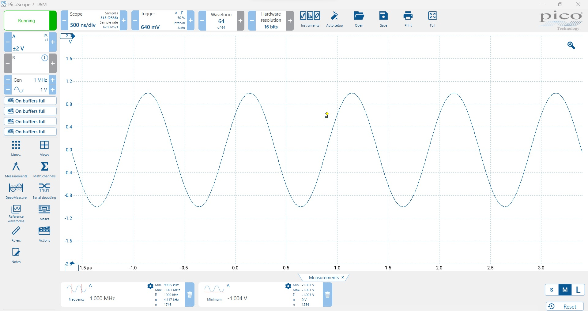

I have been experimenting with the Pico scope 7 software, it seems to work pretty well. Demo mode obviously is not reflective

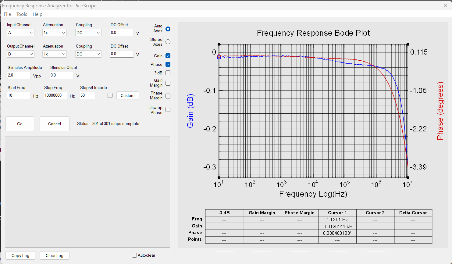

Regarding high-frequency Bode plotting, the FRA4Picoscope app is very nice and easy to use, and since I bought the 5244b last year whenever I need Bode plotting I almost always fire it up. But I also have been able to write python scripts to do Bode plotting from ~100kHz to 20+ MHz using a lowly Owon vds1022 scope and a tinySA as a signal source (which technically can generate as low as 10 kHz but it is pretty ugly that low), and while it doesn't have the exact same performance as the 5244b it works quite well. If you are comfortable with that kind of thing then it opens up more scope options since most will at least have scpi, as long as you have a signal source that you also can control via scpi or some kind of api. If you want a nice professional Bode plotting tool then this approach doesn't make sense unless you want to invest a lot of time to make one yourself.
