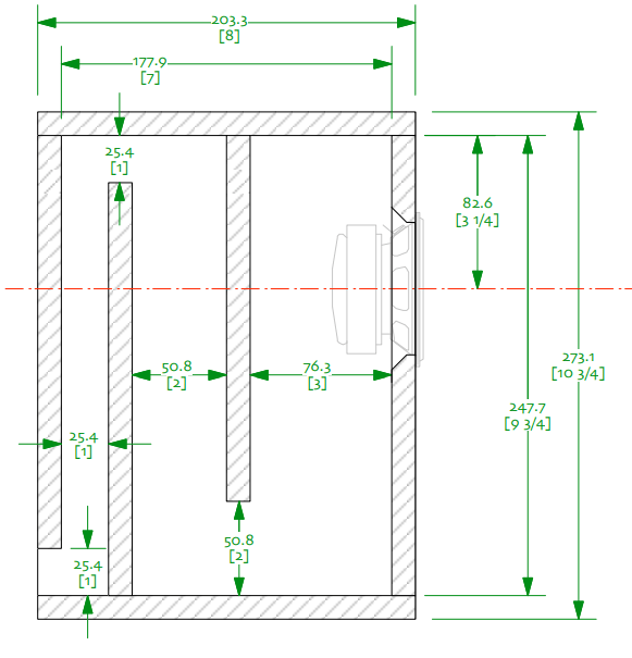

I have studied the Baby-Lab plans a little and I noticed: there are always three internal walls. And they are always spaced a half length from the previous one. So if the first length is 12cm, the other one is 6 and the last one is 3. Also the vent is always equal to the last walls length, so 3cm.

Only 2 internal in total?
I thought you'd seen the boxes? All that range of enclosures have two internal panels (as in pieces of wood or other construction material). http://wodendesign.com/downloads/Woden-BabyLabs-241018.pdf
But won't the 1/4 line then be way too short? For 70 or 75Hz I calculated the quarter wave length would be between 112 and 125cm.
Acoustical length depends on a/ the physical length of the line, and b/ the degree of taper (or expansion), in addition to the usual end-correction necessary for all pipes.
I'm drawing things up as I I'm writing this, and I even had the idea to add 1 additional panel to the 2 internal ones, so the line ends up long enough.
I didn't realise they are not long enough; the last time I checked, they were tuned to the intended frequency & alignment, but I defer to you of course -there is always more to learn, so perhaps you can show me what I've done wrong and why they don't work as designed (although to the best of my knowledge, they do, and have, for quite a few years). I don't claim they are 'definitive' or anything like that -they're just a specific configuration and alignment that I created, based on the acoustical labyrinth. There are many potential alternatives of course -strictly speaking an infinite number, so it's quite possible something else will suit you better.

I'll just summarize how I calculated the quarter length, because while I trust my (albeit simple) math, I also know that you know some things I don't, and maybe I overlooked some things 😀
1. I found out the wavelength on here: https://www.omnicalculator.com/physics/wavelength
Then /4, of course. At 70Hz it should be 4.9m. 4.9/4 = 1.225m So in my head, a line through from the first chamber to the last one towards the exit should be ~1.225m long, right?
2. I drew something up on my own and calculated the "line length" accordingly (I will use a Lance-model in the PDF as an example):
I will go from right chamber towards the end: Internal height (24.7cm) - the gap (5cm) + half the circumference of a circle with 5cm of radius. Then again: 24.7cm - the 5cm gap at the bottom and -2.5cm gap at the top, + half the circumference of a circle with a radius of 2.5cm until the end.
I quickly did the maths on a piece of paper and typed it into the PC:
25-5+15,7 = 35,7 for the first part.
25-5-2,5+8 = 25,5 for the second part
25-2,5-2,5+2 (not a half, but a quarter circumference) =22 for the last part
So we end up with a line of ~83cm which is a wavelength of 332cm or 3.32m

This only works for an untapered pipe with no end correction. As I mentioned above, the acoustical length (aka fundamental resonant frequency) of a pipe is a function of its physical axial length and taper (or expansion), along with any necessary end correction due to the acoustic impedance mismatch at the terminus.
However I have clarify: I have no knowledge what role the gap-size and width of each section play. I wanted to ask you that anyhow: Why do some of the Lab-models get more narrow towards the end in gap-size and width between the panels?
In the former case it's creating a target taper ratio; in the latter it's to establish the required pipe volume to hit the target alignment.
Basic physics tell me if the panel gaps and the width between panels open up towards the end, we should get a "horn like" behaviour, no? Why do we the opposite in a MLTL?
Well, a reverse taper pipe is inherently mass-loaded, although when we talk about MLTLs we're usually talking about an untapered pipe with the mass-loading provided by a duct. They're not horns; impedance matching / maximising efficiency for a given Vb isn't the object, so much as using the eigenmodes to extend the LF. Regular vented enclosures use Helmholtz (cavity) resonance with similar objects in mind.
However I don't know the system behind the width between panels and the gap-size, so I don't know how far apart the panels and how big the gaps need to be.

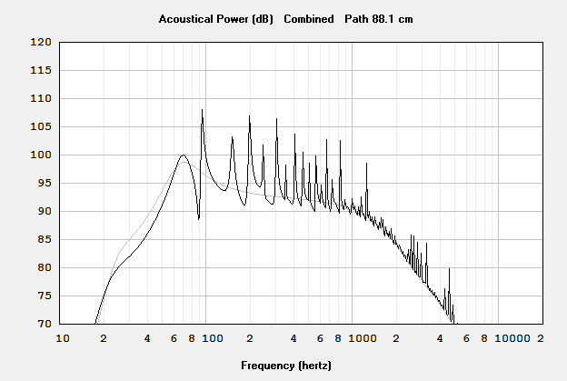

........to wit, all TL, vented speaker alignments begin as Acoustic High-Pass, Low-Pass, and Band-Stop Filters and specific to BR converted to Voigt Pipe design........ same net Vb, etc., but radically different performance parameters.
Note: will need to use Hornresp (HR) to compare 'critically damped' responses.
  • Visaton B200-6 Classic BR converted to Classic Voigt Pipe QL = lossless.PNG

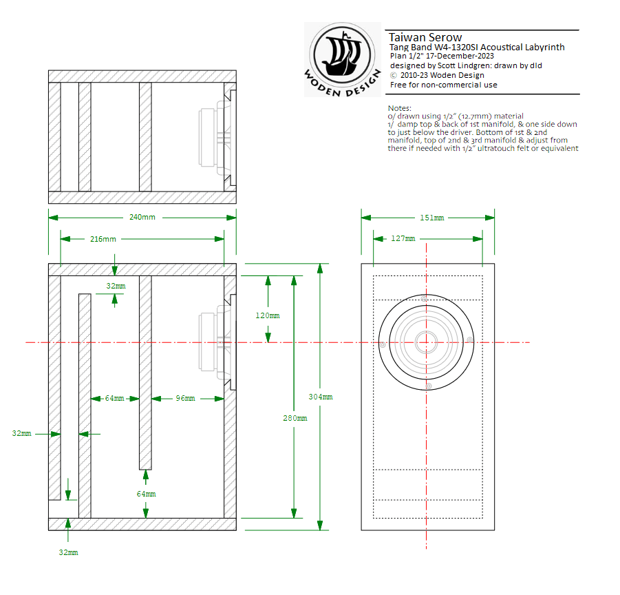

Attached; for brevity I've borrowed one of Dave's CAD drawings & altered the dimensions so it's not to scale, just for the sake of having something to add the values to. As a 4in with a modest Fs & a Qt at the lower end of middling, it's never going to be a bass monster but depending on damping, you can get relatively flat down to about 10% below Fs, or go with an Augspurger alignment with larger quantities to shift things more toward a classical TL at the expense of reduced LF gain.
Holy moly, did you already run a simulation that resulted in a building plan?! If so, that was quite fast! Thank you so much!
I know the 4" won't go down low much, but a) neither do my current dekstop speakers, and b) I don't even want to when listening to music when working. For that, I have BIBs or the magnificent double mouth horns from the spawn family. I built them with the currently available FE206NV, and they perform beautifully. As I said, if you have a paypal or something like that, please send me a message, I'd like to give a tip 😀 (the forum says I can't send you a message)
A pleasure; hope it'll be of some use for you. 🙂 I quite like these desktop labyrinth alignments -they're usually a reasonable size, and give some tuning flexibility. The existing ones seem to have been liked by their builders anyway, which is what counts!

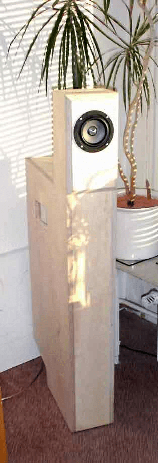

They definitely will be! Started putting them together the day before yesterday. I only had 3 clamps in the right size, so I had to glue 1 or 2 pieces at a time, then wait for a bit, ha. But I just chugged along and had both cabinets themselves ready on the same day.
Yesterday I added the damping, soldered the wires, added the speakers and glued the enclosures shut. Had them sit for the night and tried them today. Damn do they sound good! my office-room is a little smaller and they sound beautifully both when sitting in front of them working on the PC, and also when sitting on the desk doing paperwork.
I guess I'll give the active speakers to someone in the family, then. They are retired as far as I'm concerned, heh 😀
