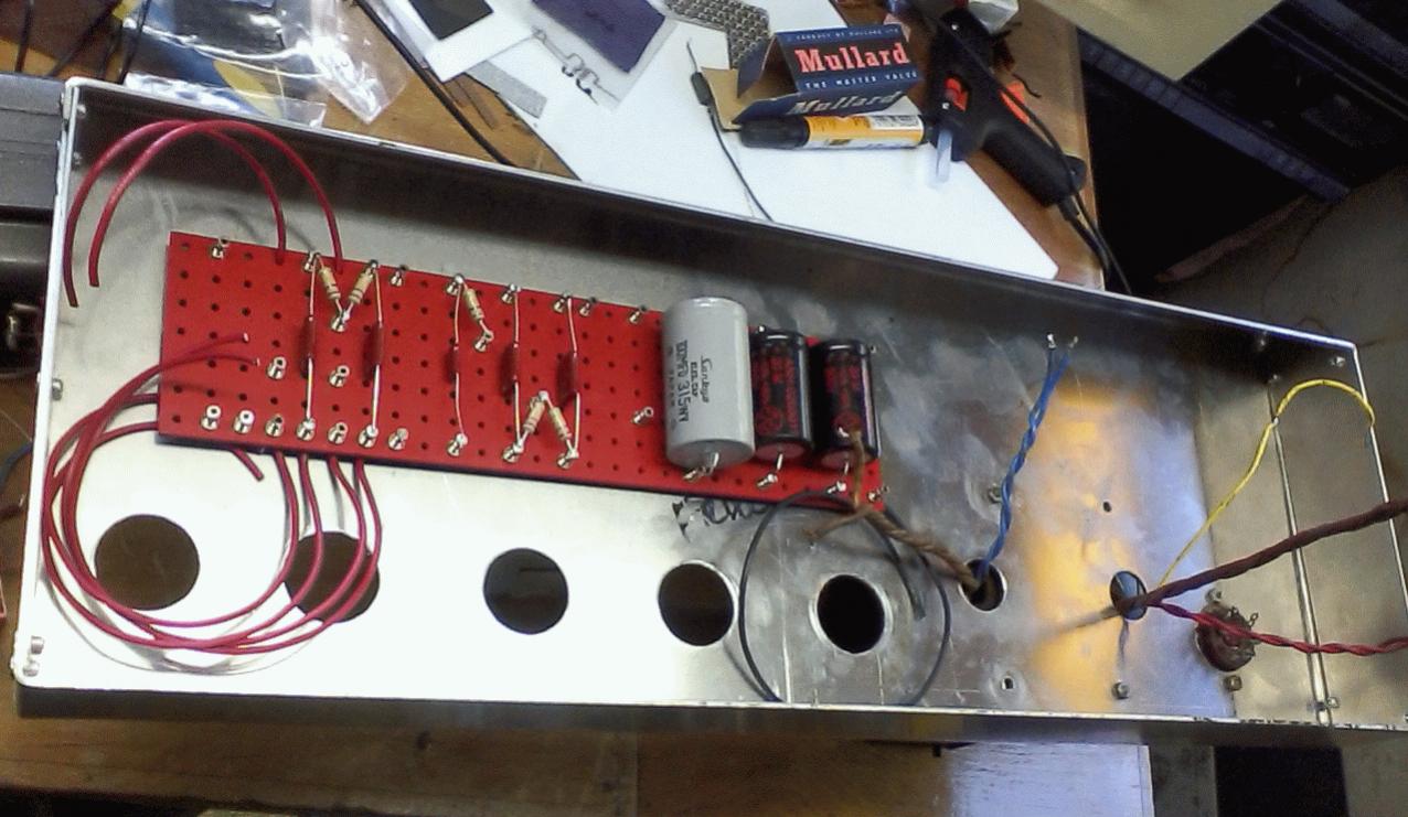

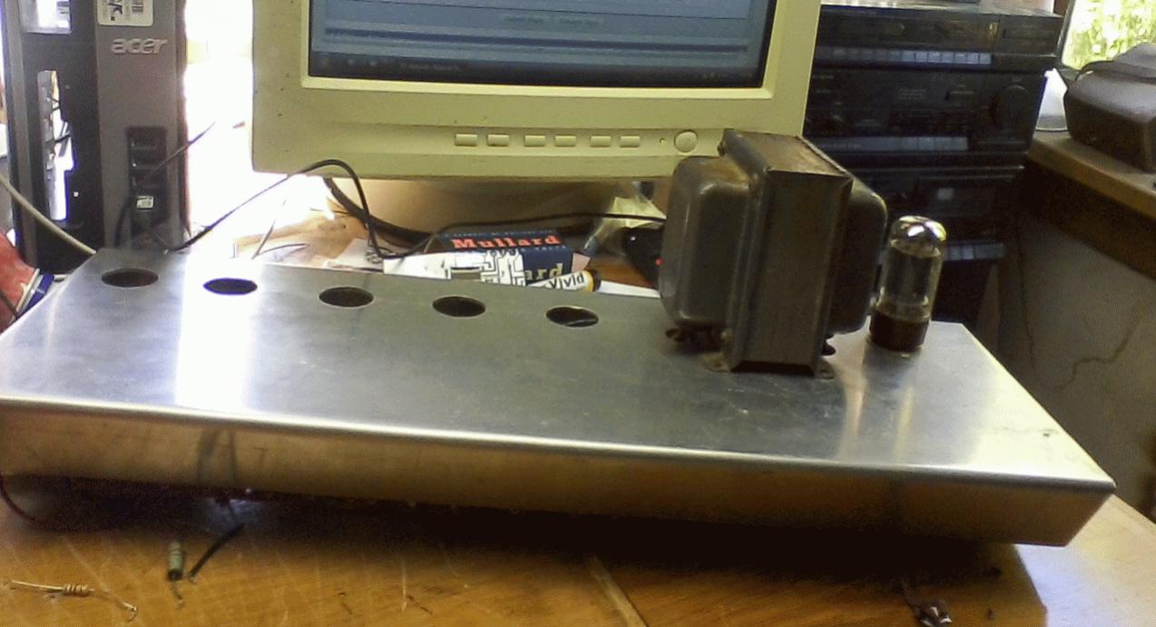

sum pics of your progress would be cool, I just ordered 3 yards of Marshall Red elephant for my new harmonica amp I,m building, got the chassis made up at the local sheet metal bender. asked for 2 mm alloy got 2 mm stainless its a bit hard gettin the chassis punches thru but i think it'll be ok its nice an ridged wont bend under the weight of the trannys.

The retired guy next door to me was a stainless welder for all his career, making custom restaurant kitchen sinks and counters etc. A real artist with the huge TIG in his garage. I've got an air nibbler, but I doubt it would handle stainless that thick. Must be a bit heavy, but not bad since it's not enormous. Still nearly ideal if you're willing to work the stainless; it certainly won't ever rust or oxidize. Bending aluminum that tight in a brake can be difficult unless you anneal it as you go and then you need to temper it back. The stainless is classy. It you lived closer I'd buff it for you. Some stainless will shine up like a mirror. Like stainless mirrors in prison. When it's all punched, insead of powder coating or something, just ask around at your local motorcycle shop for somebody in your neighborhood with a big 3-phase polisher and he'll probably shine it up for a few bucs.
If you have an orbital vibrational sander, you can start with wet-or-dry sandpaper for most of the work, then use a polisher with tripoli for the last bit. Here in SoCal there's big polishing shops that do a big business with motorcycle wheels and things like that.
