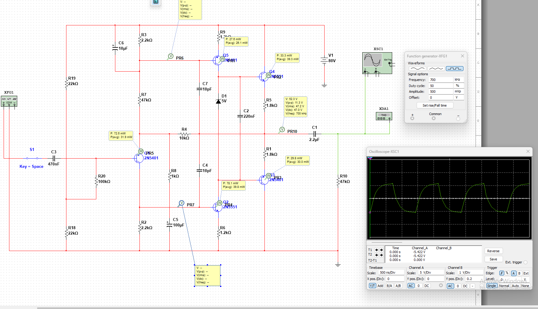

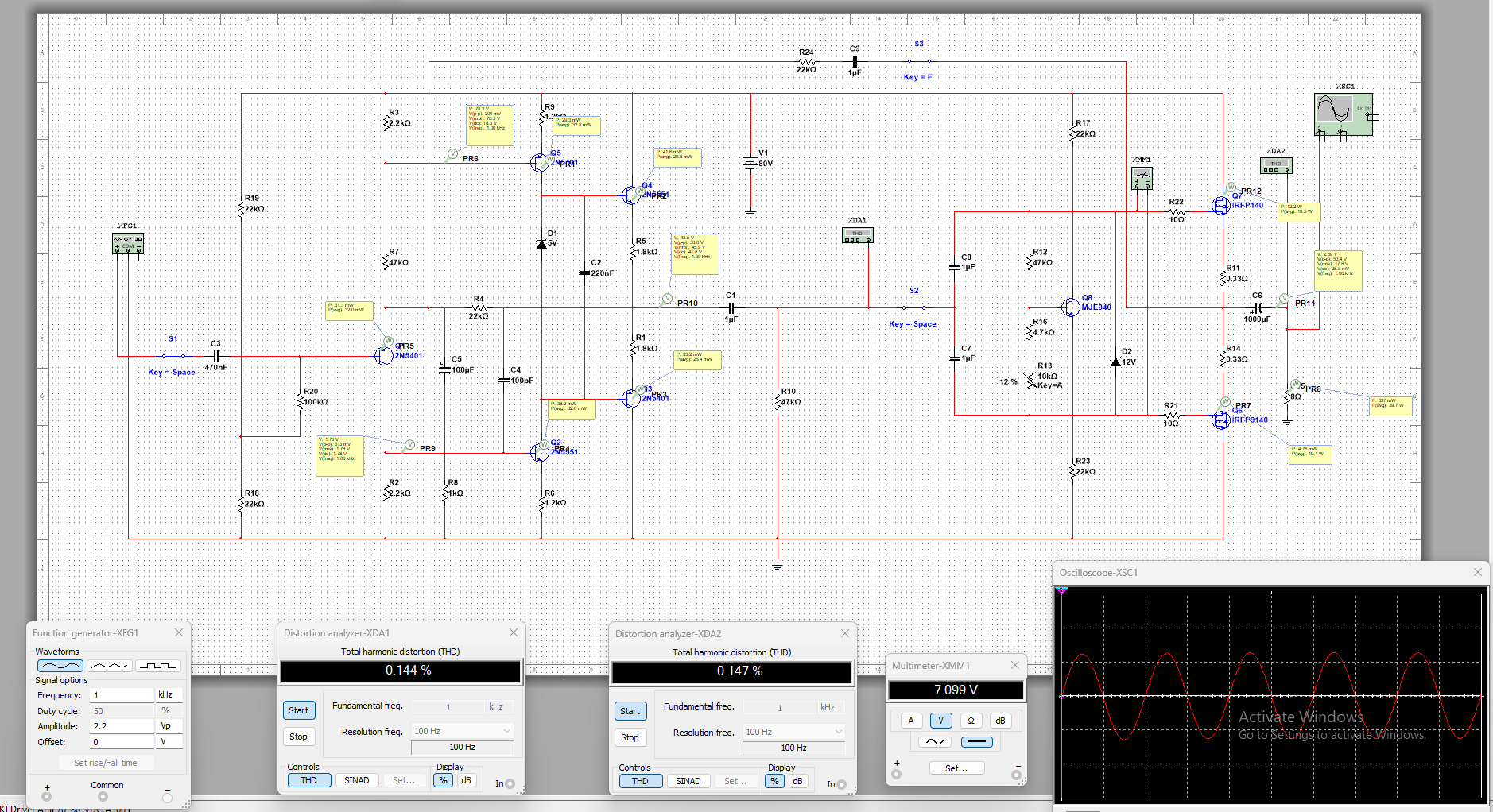

Pick-Up amplifier design adapted to 80 VDC

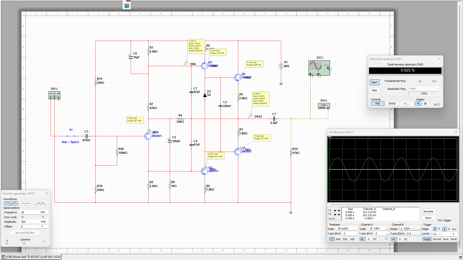

This is my favorite amplifier design for now that I am listening for 3 months and it still is good for me. In the past I build perfect clone of an Unitra Stereo Hit but it was desined with RIA correction directcly in the amplifier and for some reason I did not like it. The schematic I am posting now could have some further modifications and I have to say that I like simple designs more, I did complex stuf but to hard to repair.

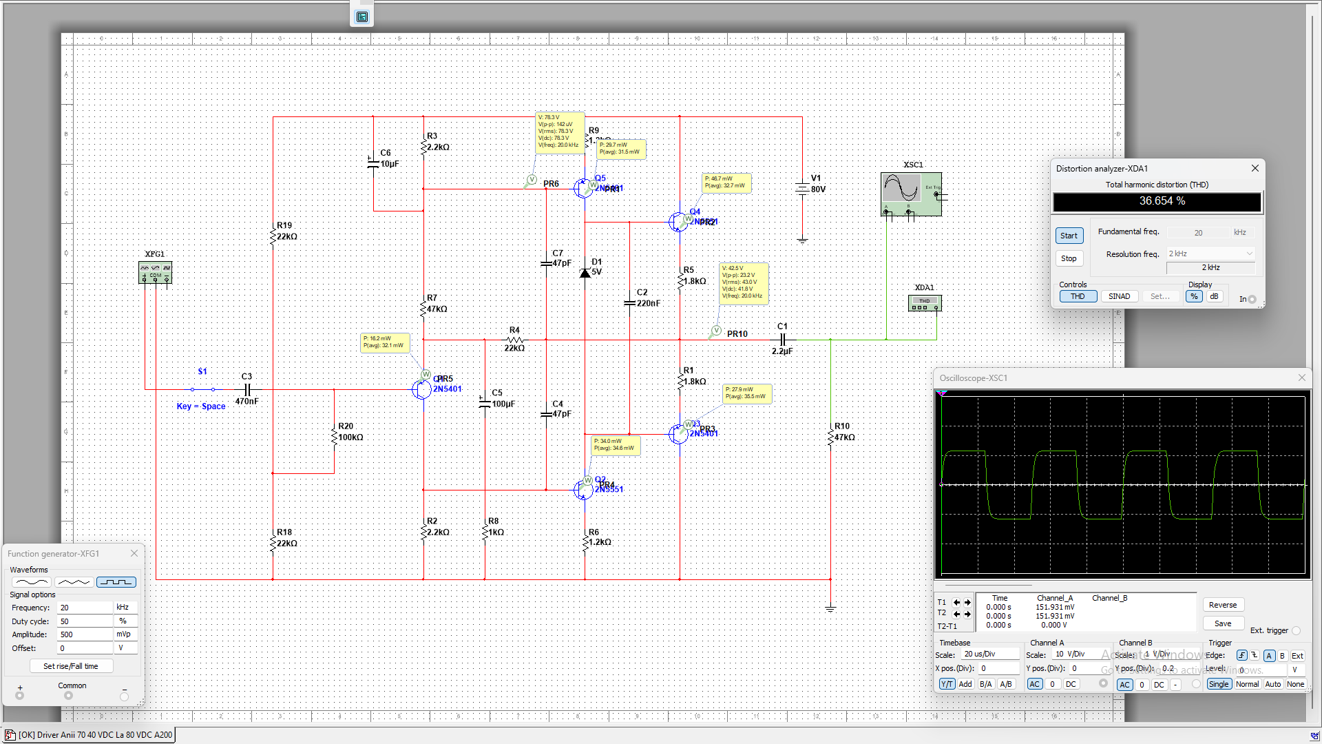

I cheked this morning what is the state of components in the driver stage and I saw some modifications C4 is 47pF and another compensation capacitor of 47 pF (C7) was there, and after this I decided to block R3 voltage with 10uF because the signal there would be 180 degres out of phase.

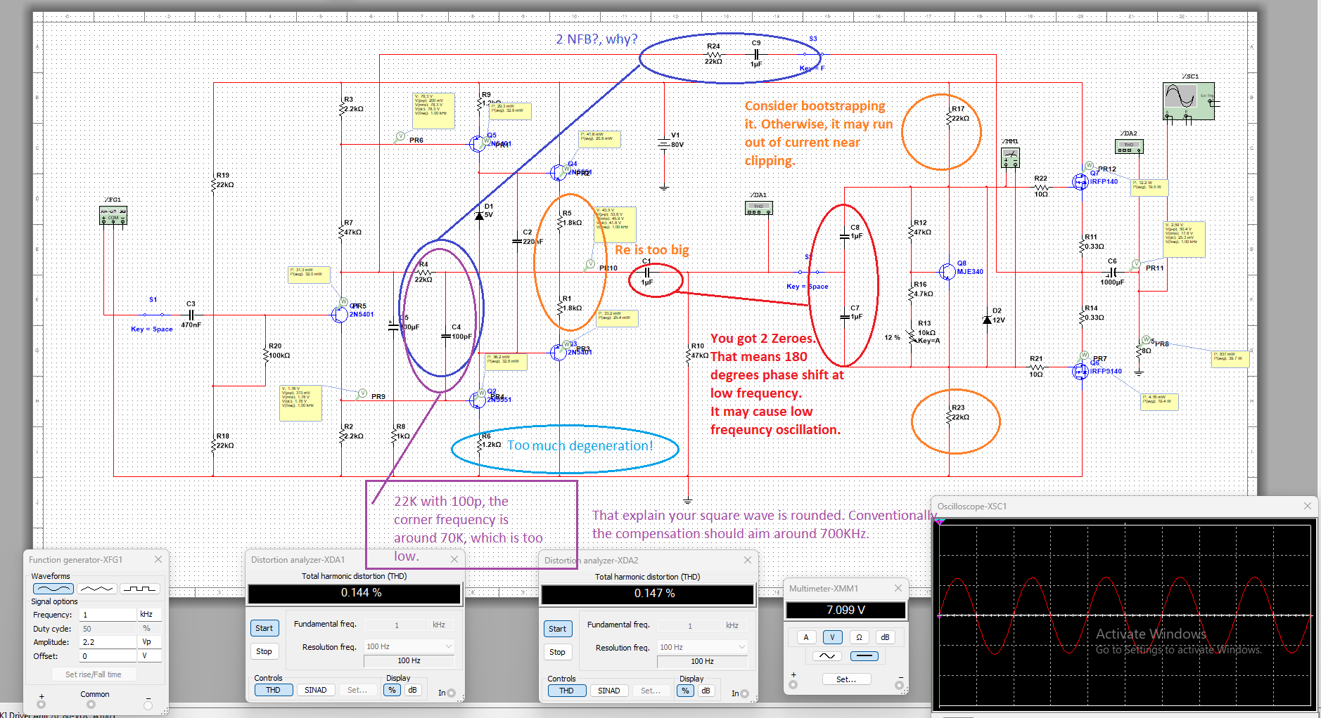

It is my design, just because it simple does not mean it has flaws. I am curios to hear what the flaws are to make a more clear view of what you are trying to say. I make my own designs for 10 years and I do not consider myself a beginner.
