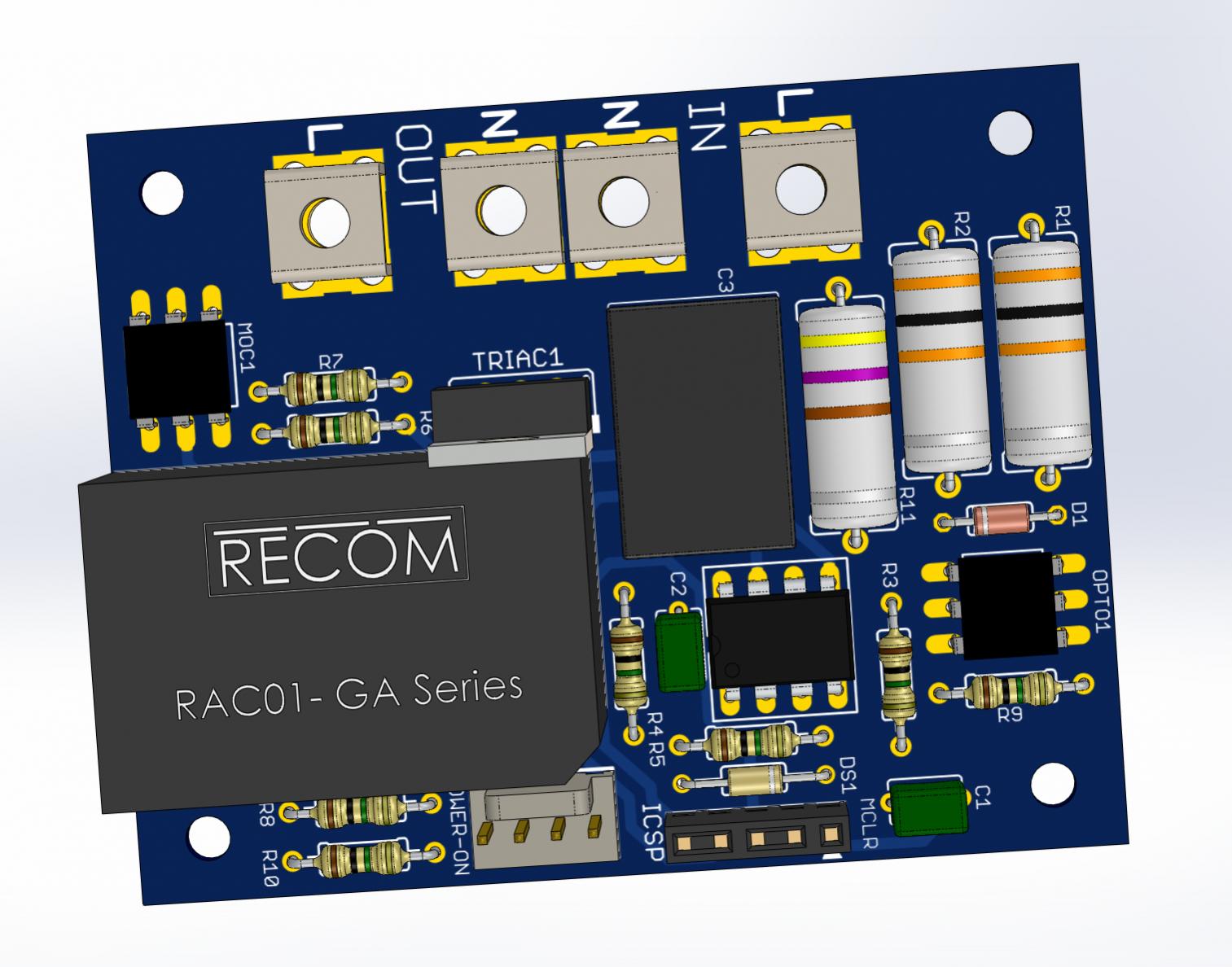

The pcb is 55x70mm. The PIC can be reprogrammed on board via the ICSP header and a pickit or whatever is used to do pic programming.

I used a 5V power module instead of a transformer based PSU for the pic power, so fewer parts and smaller footprint overall, plus it turns out a bit cheaper as well, not to mention simpler to assemble.
I priced all the parts from mouser and compiled a excel based BOM, which should make it easier for anyone to make. It's fairly cheap to make, with less than 15euros worth in parts, plus the pcb.

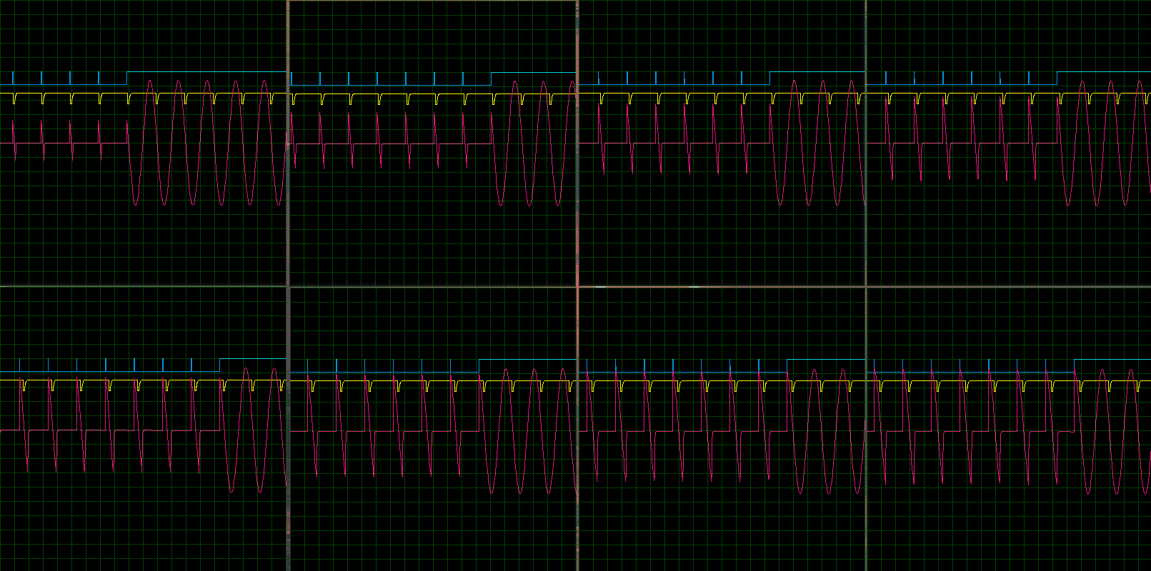

That's a project I am working on too, are doing it this way? I am triggering Triac on +ve halh waves, do you have a snapshot that shows how waves switching progress? I am showing different triggering timings, look at them in backwards order, so the concept is the same for all of them, just different angles till fully switched ON. Which one are you doing anyway?

are doing it this way? I am triggering Triac on +ve halh waves, do you have a snapshot that shows how waves switching progress? I amshowing different triggering timings, so the concept is the same for all of them, just different angles. Which one are you doing anyway?
I'm not sure what I'm looking at there. If some more info was given about what each trace is, maybe I could respond better.
But basically, it makes no difference which half wave it is, wether positive or negative, it's exactly the same.
The zero crossing sensor causes edges to happen on all of the crossings, whichever way the wave is going, up or down.
What I do is use those zero cross edges to trigger interrupts, and then apply a delay from that to trigger the triac with a ~250us pulse.

Ok, I see it mostly about right, although something odd may be going on.
If I get this right, that yellow trace would be the zero cross signal.
The blue one the triac's trigger.
And the red one the load's.
What do you use to do this?
It's not in sync to stay stable, so it's a bit hard to see everything, with it moving all the time. Maybe if possible, put a sync on the yellow trace, so it won't move all over the place..
Is this sim done from my software?

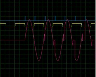

In the mean time, I'm adding one more better visual, although not yet with the power module...

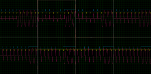

Sorry, I deleted previous post to make things clearer for you. Trace colors are as you have already mentioned:
Blue: Triac trigger signal
Yello: ZCD
Red: Signal across the transformer
You can download the GIF images and look at the actual frames.
Your ZCD approach is prone to noise, so you will have issues later on real HW assembly.
I simulated your code, result is below, honestly it is a real mess, please be patient and look at it carefully:
I am following TSR method, I am only working on either +ve or -ve half waves:
Anyway, did you test your work to see what the correct angles are, because according to TSR, the delay to avoid inrush current differs from one transformer to another.
Ok, something isn't quite right. Mostly, but not quite. Some small bit doesn't look right and there is nothing in the code to do such a thing.
The software uses the zcd as the starting point, from which is applies a delay before it gives the triac the trigger pulse.
But that red trace is showing something that shouldn't be there, right at the beginning of the half waves. That small spike shouldn't be there, only the larger one that grows over the sequence at the end of the half wave, not the beginning.
There is nothing in the software to send a trigger pulse at the beginning of each half wave. So something is odd here.
But still, even if it did this, it would work to limit the inrush current.
And my test showed me that it was doing the sequence just fine with the intensity larger at each step, so the toroid was being powered progressively.
Now of course each transformer will have its own behavior, as they're not quite all the same, but applying that basic scheme should work as is on any toroid, or any transformer, and even on lamps or whatever else.
I tried it on light bulbs first, and they lit up gradually, properly, as expected.
Not sign of that extra tiny spike at the beginning of each half wave. I don't know what's going on with those sims, but something isn't entirely right.
ignore the tiny spikes, you will not see them on real oscilloscopes as I have not optimized the sim, anyway, the sim is correct and shows what your schematic and code are doing. When you see a sine wave at the beginning, then it is there.
Look at the attached file for ZCD and Inrush current limiting, these are a good read. Actually, you need to understand how transformer demagnetization works, your test using a bulb can't reflect actual transformer behavior nor the fact your project is successful.. Also dimming techniques used with bulbs differ from those used for motors/transformers.
I suspect that spike is caused by the transformer inductance shifting voltage and current out of phase. The triac will only switch off at zero current and that point is delayed by the transformer inductance.

you may have a point there, that could explain what the deal is with that tiny spike early in the half waves.
So that would have nothing to do with the software triggering something early on, but just rather a slight delay from the triac when it shuts off a tiny bit beyond the next crossing.
I suppose this is no big deal and it works anyway.
When the start up sequence starts, the delay is about 9ms, so that's about 90% of the half wave away from the crossing starting it. This leaves a little less than 1ms, due to reaction times, to issue the 250us trigger pulse and still be more than 200us away from the next crossing. This satisfies the requirement stated in the triac's datasheet, so the triac shouldn't be subject to not being able to disengage at the next crossing, so it wouldn't stay on.
When the delay backs down to 4.5ms from the crossing, we're at 50% of the half wave, so that's a 90degrees shift, the maximum in the half wave.
It's true the test on light bulbs isn't anything like a real toroid, but at the time, I had no toroid on hand to test with, so that's all I had, and those bulbs are also small and low power, like 20W or whatever.. I knew it wasn't the best test, but at least it tested the software's sequence, which revealed the dimming effect, quite visible with the light bulbs. And it all works as intended.
Once I borrowed a real toroid, I tried it with a quick mockup bridge and cap banks (30000uF) to have a psu similar to the run of the mill power amp, so the load was a complex type just like what needs to be handled.
And as far as I can see, it all works just fine.
