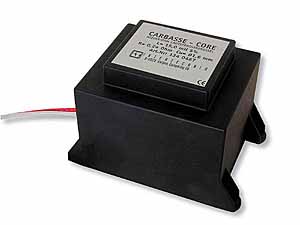

Is it kosher to parallel the inductors in a pi filter power supply? I can't really find the combination of inductance and DCR I need for a 16A +/-12V supply, so I am considering running the inductors in parallel. For example, 4x10mH inductors gives my an effective 2.5mH with a DCR of .064. Any problems with running these inductors in parallel?

I believe there is a small advantage in paralleling inductors in that the inductance will increase beyond the expected 2.5mh if the inductors are kept close and physically parallel to each other.
Other than that i'm not aware of problems relating to current sharing etc. though I must concede i'm no expert.

Low DCR coil
Hi JWB,
How about this one at
http://www.intertechnik.de/
2.7 mH; DC resistance 0.042 Ohm! part # 1340455🙂

Or this monster:
part# 1340690; 3mH 0.06 Ohm
Are You sure that those are suitable for DC-power supplies also?
I thought they are intended for AC-operation (speaker x-overs) exclusively and that they cannot take any DC-current (probably no air-gap) while maintaining inductivity.😕

Airgap can you enlighten me ? Has it to do with saturation of the core?? The transformer like inductors have a 7mm break in the core, the carbasse ones I have never seen in real life.

Yes, that`s what I have meant with airgap. If the core wouldn`t have a gap it would saturate with DC-currents quite easily . Inductors carrying DC current usually are designed so that the core structure provides an effective air gap to limit the DC bias current from excessively polarizing the magnetic material. As those coils for speaker x-over purposes usually wouldn`t have to deal with any DC there are likely not designed for this and therefore I`m not so sure if they can do a good job in DC-Power-Supplies as well.Has it to do with saturation of the core??
I wonder from where do You have the 7mm break (is this gap?) number for the transformer like types??
