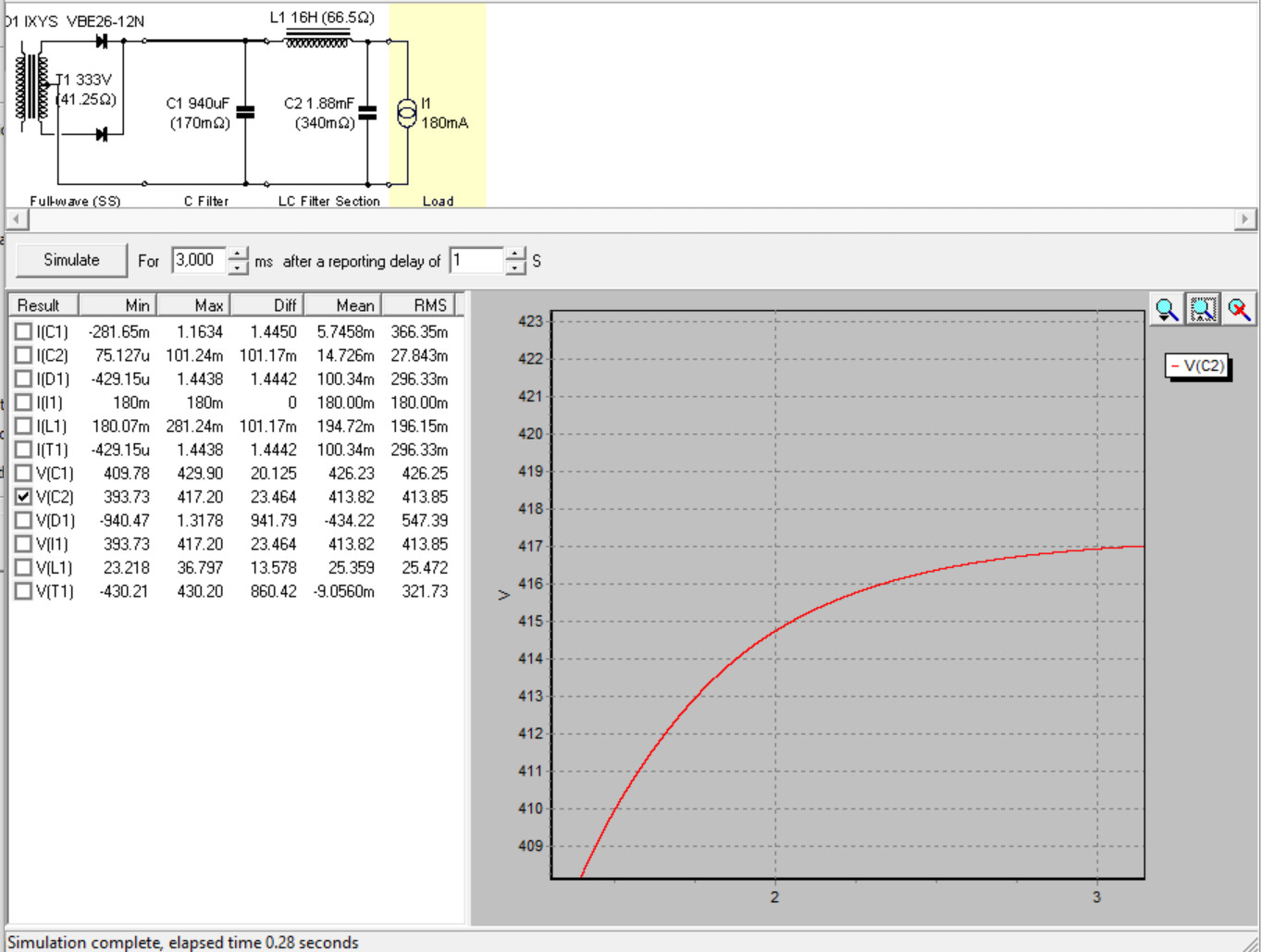

I am putting together a power CLC for a push pull KT88 amplifier. I am using Duncan’s PSU designer to model it, see output pic.
Searching for parts I have seen the Toroidy TDS16/300 - Toroidal Choke 16H 300mA DC with 66.5ohm DC resistance.
Having read a number of threads on Pi filters I came across a comment “they're toroidal core, so no adequate for DC”
Should I be looking to go low DC resistance on the inductor?
The model looks to be perfect but I know I’m missing something fundamental.

Why do you require such a high value choke ? A power amp should not require anything like 15H as a CLC/PI filter .
May I suggest that you model the PSU again with much smaller value input and smoothing caps ? Also try something like a 5H choke and try using the stepped load function which may provide insight into settling times and stability of the power supply

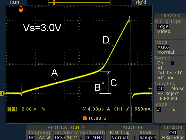

Lovely DIY article found online: Power Inductor Checker
Use an oscilloscope to measure dI/dt . This provides a measured value of inductance L.
attachment.php
A: inductance at low currents (core not saturated) = 21.5 uH
B: manufacturer's rated current = 1.7 A
C: onset of saturation = 3.0 A
D: inductance in saturation = 3.2 uH
_
For a mains frequency power supply Pi filter the choke inductance is related to the small-signal AC current when sitting at the DC bias location on the BH curve. The ramp tester that Mark links to allows the DC level to be appreciated as core saturation licks in, but the inductance measurement does not relate to incremental inductance due to the AC ripple signal.

Just as an aside, the PSUD program is also not showing the overshoot of the C→L→C configuration for the first few seconds after power is turned on, but before the valves properly start conducting.
I've modeled this numerically (real discreet differential calculus!) and shown that much more modest component values are simply … just better … causing far less component stress (especially those poor, poor rectifier diodes!)
One of my favorite topologies is CLCLC, using values
47 µF → 1.5 Hy → 220 µF → 1.5 Hy → 470 µF​
for the 180 mA supply-current rating your initial PSUD current sink implies. Very clean DC, modest start-up overshoot, and modest overshoot on varying load, and so on.
Oh, I don't know about that. All of the activity on the scope trace occurs within 7.5 horizontal divisions (30 microseconds). I wouldn't call that DC.
The instrument repeats the sweep 50 times per second, which again I wouldn't call DC.
The location on the I-t curve where the dI/dt changes in a way that is characteristic of the core material entering saturation region is the appreciation of the DC level where the inductor would start encountering saturation - that is what I was commenting on. The timing is just related to the test jig voltage and inductor incremental inductance along the changing sweep of the BH curve, and the timebase would obviously be circa seconds not usec for the power supply chokes on topic.
The core effectively starts from, and gets reset at test end to the BH origin, although there may be a bit of residual H. Those linked tests could be done at 5kHz with no change to outcome.
My comment is that the inductance seen by the ripple will be somewhat different from the dI/dt derived inductance taken from that tester's sweep as it passes through the DC operating current level as seen by the choke in operation.

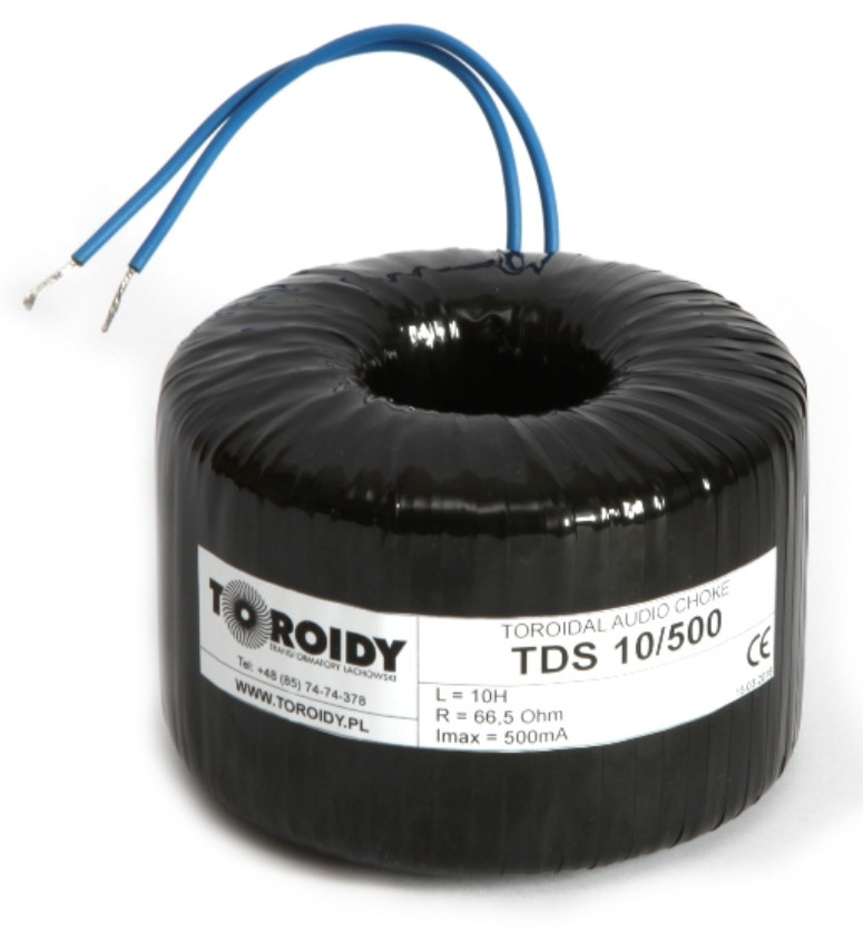

An ordinary toroid improves inductance but does not tolerate DC well.
But Toroidy knows that, and knows toroids, so has probably figured out a technique.
I'm struggling to see "how?" I suppose they could cut the strip iron into short pieces. But that greatly complicates winding the many strips into a doughnut. Modern steel alloys can be heat-treated many ways, and they may have a special treatment to improve DC saturation without physical gaps.
Also wondering "why?" However the TDS16/300 at 4.4 pounds is lighter than Hammond's classic E-I choke 193Q 10H 500mA (similar H*I) which is 21 pounds. And the E-I is $125 while the Toroidy TDS10/500 seems to be $41??
