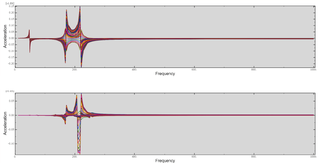

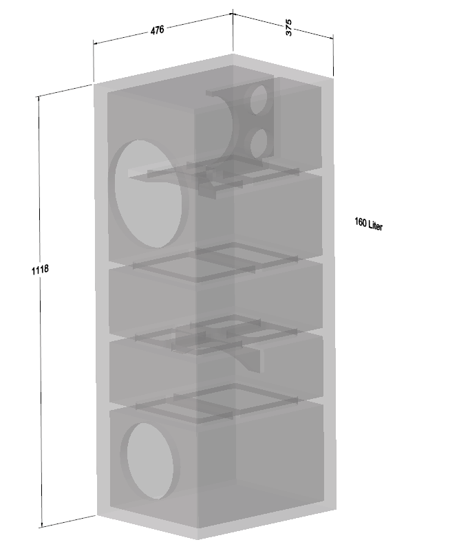

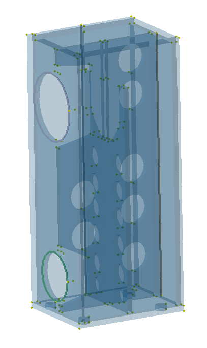

I’m building a 12” fullrange speaker, and I’m a bit confused what is the preferred wayin speaker cabinet design. I’m a mechanical engineer and I have an opportunity to run complex FEA simulations. I had a base design, what looks too flexible, so I started to reinforce it.

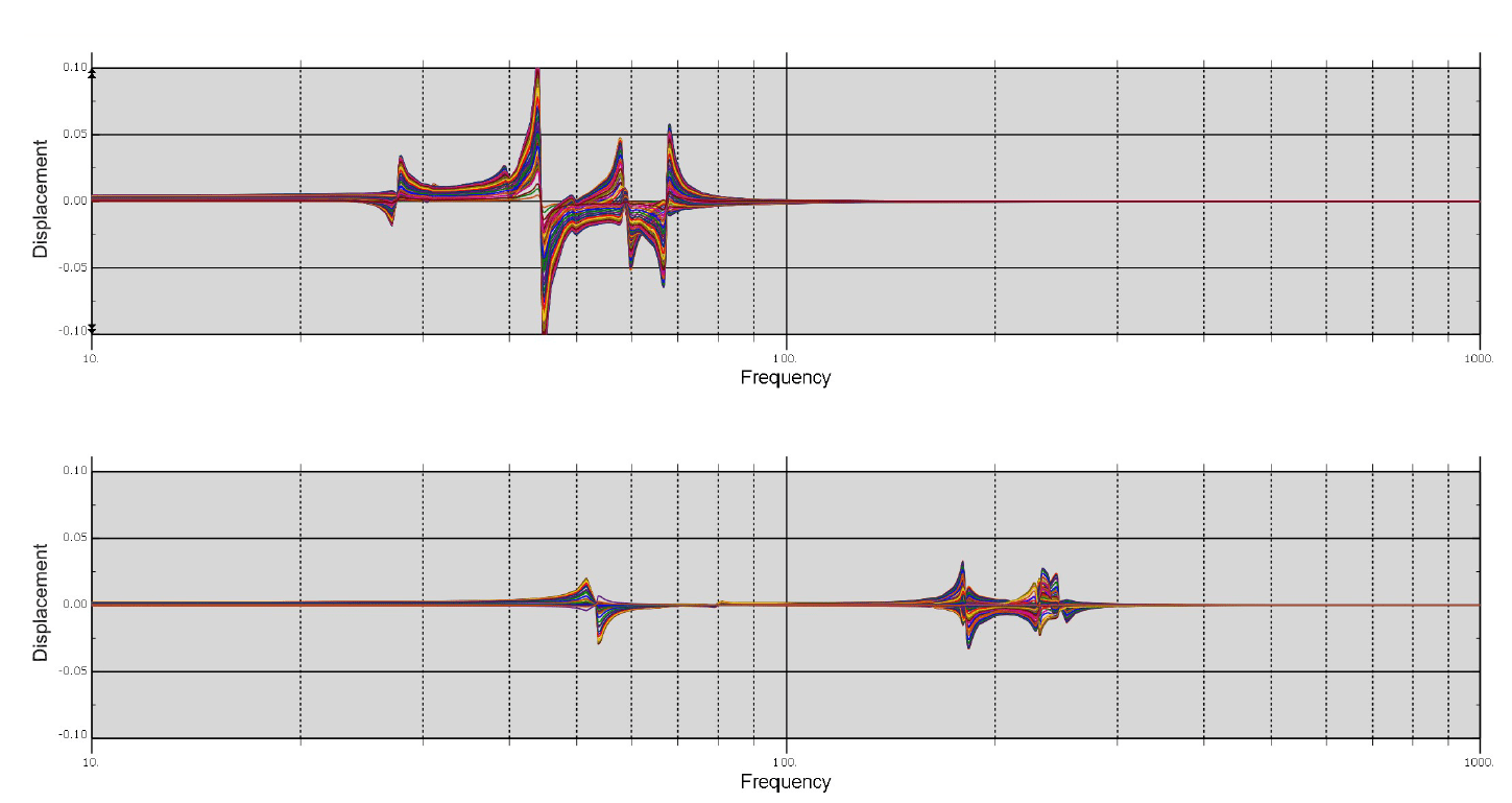

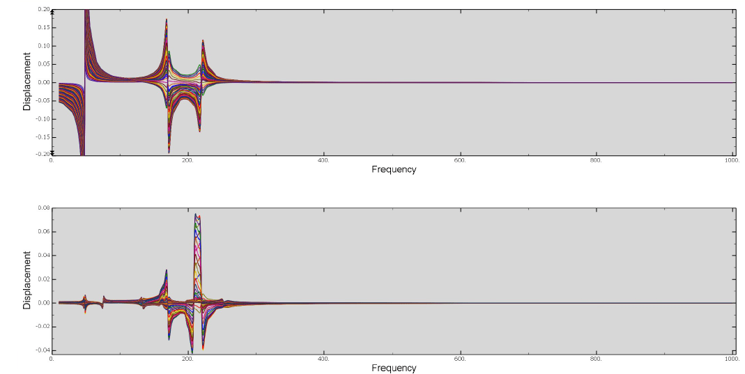

I’ve run Steady State Dynamic (Modal) analysis, do check the dynamic behavior of the cabinet. The result is very confusing:
Base design:
- First resonant freq is around 80Hz
- max. normal displacement is 0.1mm
- max. normal acceleration is 8G
Modified design:
- First resonant freq. is around 180Hz
- max normal displacement is 0.03mm
- max normal acceleration is 50G
My guess is that the new design will have less influence to the sound because if the side of the cabinet act like the speaker membrane, and generating sound waves, the amplitude will be much smaller, and the membrane are is also much smaller.
Is this assumption correct?
Adding more reinforcement moving the resonant freq. up, and reducing the “membrane are”.
Another interesting thing is that the displacement of the 2nd and 3rd resonant frequencies much less, so have to focus on the first.
