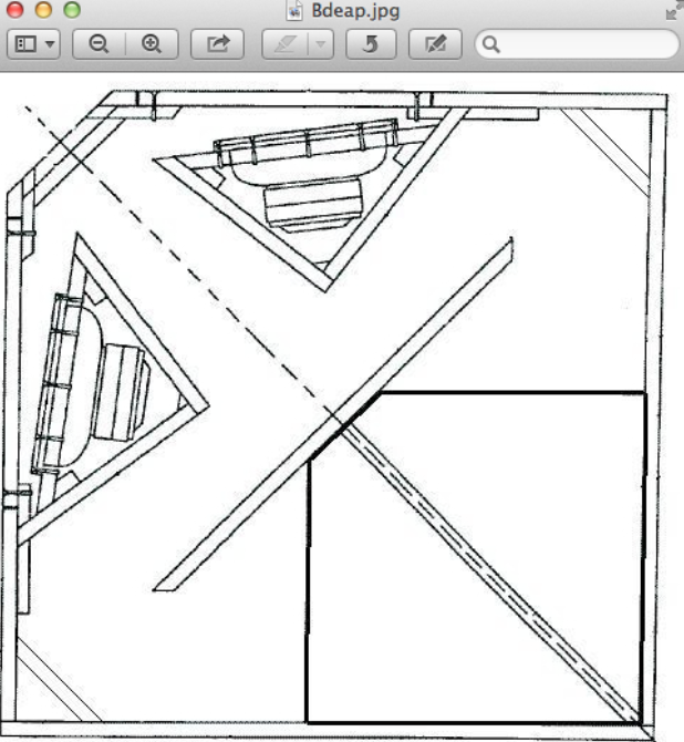

I think I understand as far as the horn has a decreasing cross-section/restriction (that also functions as a low-pass) that also contributes to acoustic mass. But I' still can't figure what "opening on the side of the cabinet" is.

Giri,
The "opening on the side of the cabinet" is the mouth of the horn, which has a smaller exit area than the interior cross-sectional area at that same point.
As an example, if the BDEAP (45" x 45" x 22.5" exterior dimensions) was split into two horns along the dotted line, and the exits were in the same plane as the drivers, each of the two mouths would be approximately 22.5"x 27", while "on the side", the exits for both only comprise a single 22.5"x 22.5" exit, less than half the exit area.
Art
