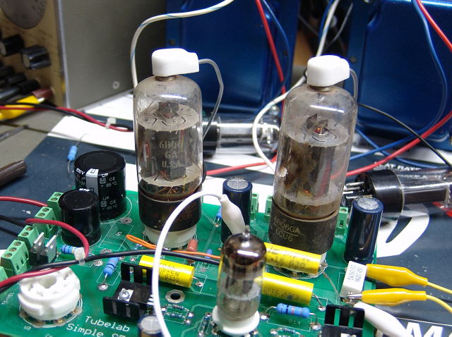

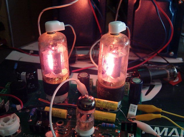

I pulled back the throttles a bit. I am now running 450 volts at about 70 mA. I get 7 watts out at 5% distortion. There is a pale glow when the amp is driven. When you remove the input the tube gets hot. It has been running like this for about 20 minutes.
Further testing will continue, but I need to remove the expensive OPT's so that I can attempt a total meltdown.

The 6LQ6's are far too expensive to "test" although I do have a large (hundreds) box full of odd voltage sweep tubes, and I just bought some ceramic 9 and 12 pin compactron sockets. There are some 6GF7's in the box. Some testing will occur, but I can't say when. This was just a spur of the moment thing that allowed me to get carried away. I keep dreaming up more stupid "tests".
OK, you want to really crank some tubes. You have a nearly bullet proof power supply, those pesky cathode resistors and capacitors have been eliminated, but there is still a pair of shiny blue Edcor OPT's hooked into the amp. I would really be bummed if I blew one of those up, so they have to go. So I must ask the really stupid question, has anybody tried using an old microwave oven transformer as an OPT? I feel another experiment coming on.

I didn't get home from work until 9PM last night so there was very little time for experimenting. I did throw a 6K P-P guitar amp OPT into the amp using the entire primary winding with the center tap used for the UL (screen) connection. Of course there is some saturation on frequencies below 100Hz but the distortion at 1KHz is under 3% at 5 watts. Maximum (fully distorted) power output is now 18 watts.

I had some fun blowing up a couple of already useless 6V6 tubes, and I made a few questionable tubes a little bit more questionable. The fun lasted for a few hours but I got tired of it. I put the 6V6's back in their box (so that a few more could die) and put the box back in the far corner of the closet. In the process I discovered a box full of tubes that I had forgotten about. It contained some tubes that I had saved for "future experiments". I opened the box and decided that it was time to visit the future and my distant past at the same time.
When I was quite young (12 to 14) I was making guitar amps out of old TV sets. I had cooked up a single ended design that used a 6BQ6 or a 6DQ6, the power transformer from the donor TV and the vertical output transformer from the TV as an OPT. I made these amplifiers and even sold a few without really understanding what I was doing. I don't think I fully understood this "bias" thing. I didn't know what a load line was or even understood "impedance matching". I didn't understand why the small tube (6BQ6) was louder that the big tube (6DQ6) in an SE amp but the big ones worked better in a P-P amp. Guess what was in the box. I decided to re-explore these tubes. What would it take to wire one into the Simple SE? A quick trip to the tube manual revealed that it was a drop in! All I had to do was make a pair of wires with plate caps on one end, and screw the other end into the plate terminal on the OPT connector.
NOTE: DO NOT TRY THIS YET. IT WILL BLOW UP THE CATHODE BYPASS CAP. THESE TUBES DO NOT BIAS UP LIKE THE TUBES NORMALLY USED IN A SIMPLE SE. I will post more info as I experiment further.
I already had my amp wired up for an external bias supply. This allows me more freedom to adjust the operating point.
At first I didn't know what to expect, so I picked the crustiest dirtiest, ugliest tubes in the box. There was a Philco and an Admiral 6BQ6GA (both GE's). Both were well used with much of the getter used up, so I decided to "test" these tubes.
There is another user on this forum that is fond of these tubes. He says that they are like a 6V6 only better. I'll say!

It was really easy to get 5 watts in UL mode without really warming up the tubes. 10 watts came without glow. I don't think that you can do this with a 6V6.
