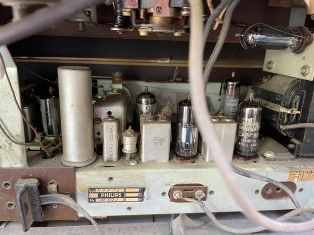

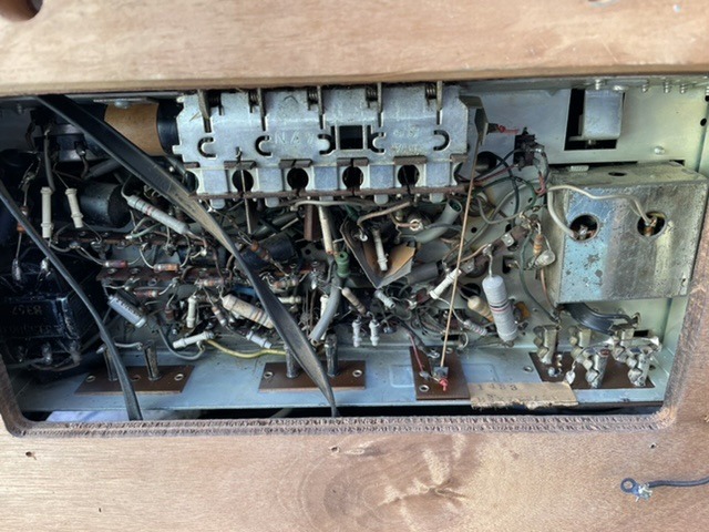

I might get myself a couple of these for bench testing given their flexibility.
Current project - late 1950s phillips receiver + record deck.
I actually ordered a couple more yesterday.
That receiver seems to be in a decent shape for the age. I'd love to do something like that, I keep looking at vintage radios on e-bay and gumtree, but not enough time to dedicate at the moment.

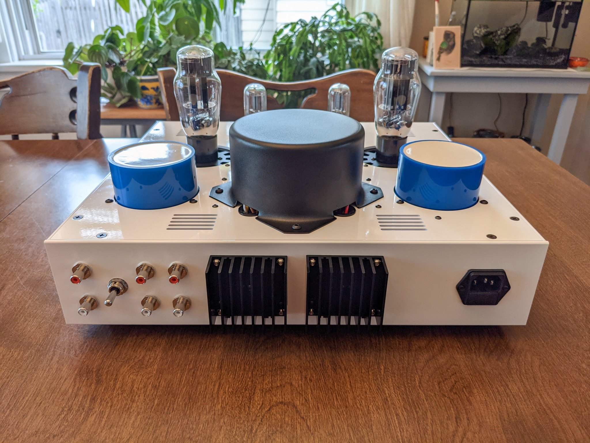

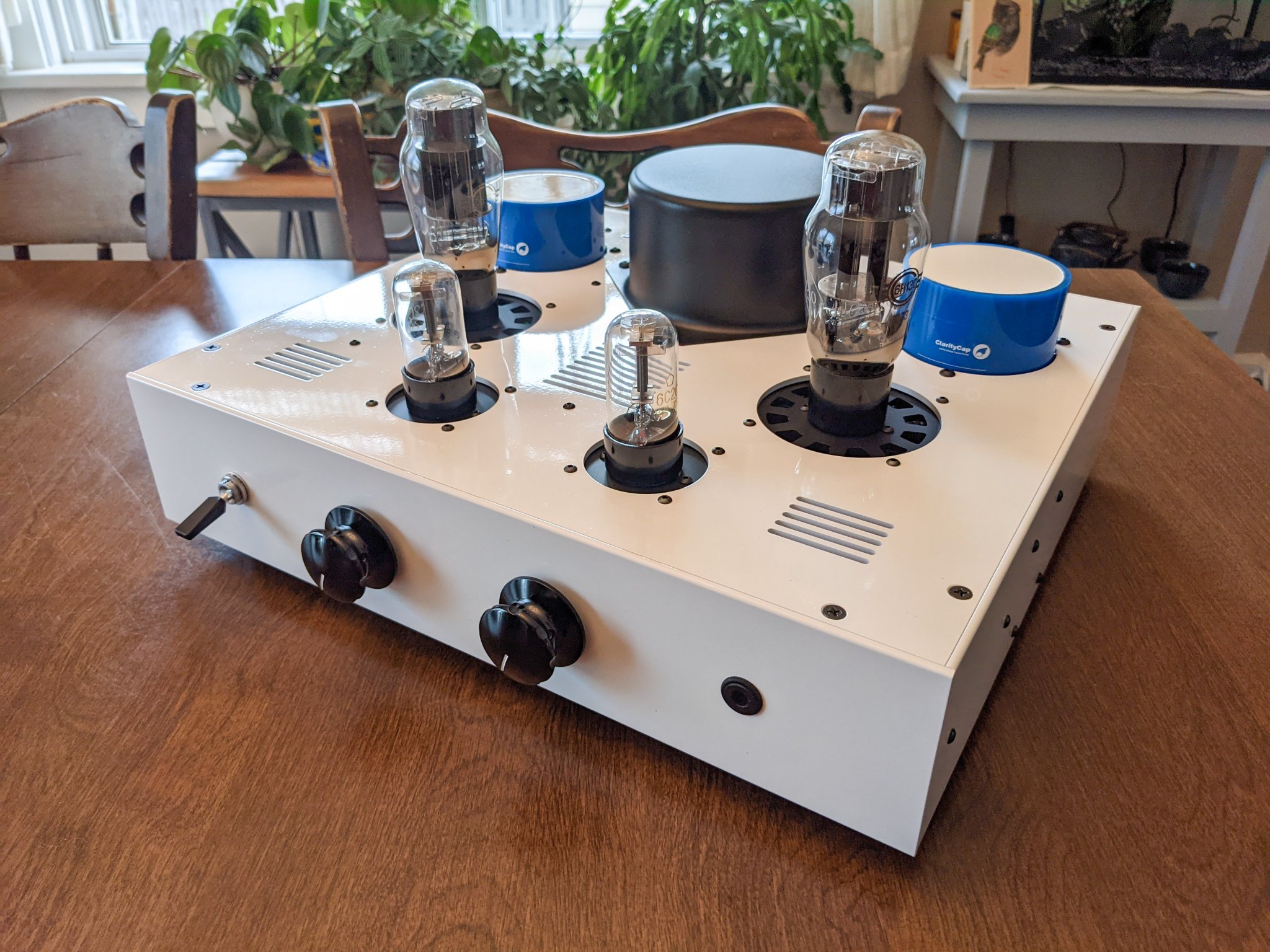

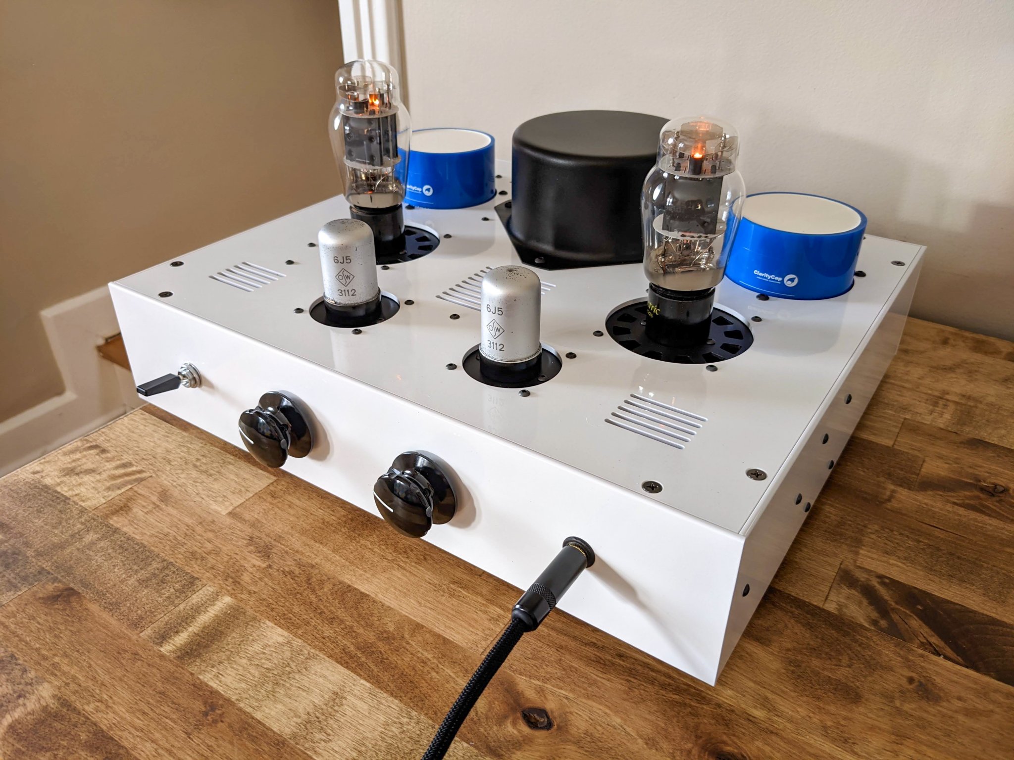

EF6 driver, EL3N SE
Just finished. New look (this time no "box") thanks to a friend of mine.
It is an EL3N Single Ended with a EF6 triode connected driver. PSU and amplifier on separate chassis. Chassis both plywood, no metal parts used. Earth/ground consists of a 1mm2 silver wire..
Sound is very much okay. I tried both EL3N connected in triode and pentode (1.3W vs 4.5W) and do not understand why some people dislike pentode connection.. ;-)
Was a battle to get the parts in the small space.. but managed..
Can you share the schematic if you don't mind ?
I'm building EL3nSE with EF6, (EL3n UL connection.)
Thank you.

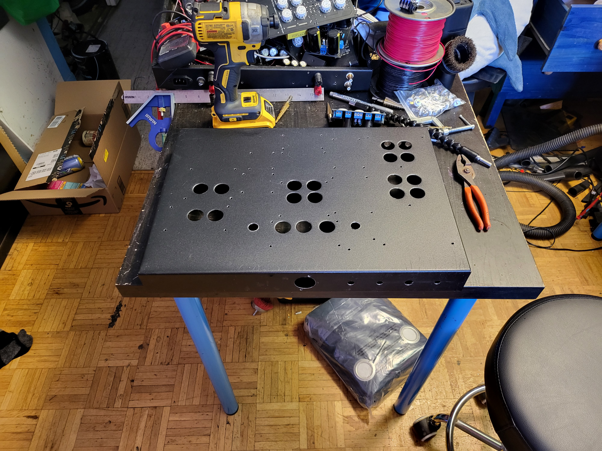

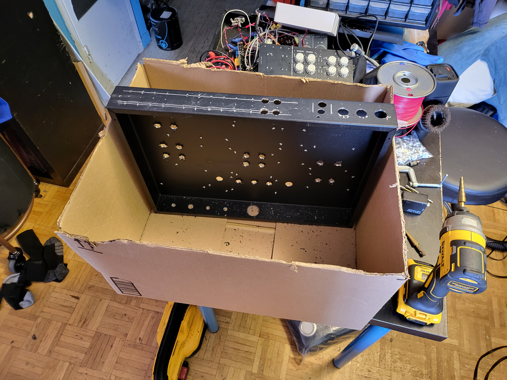

Here begins another preamp. The box helps catch the filings from the drilling.
Fun fact: The HEIC file I took was 2MB. The PNG that was exported and uploaded here was 12.1MB, the forum resized it to 4.3MB. Still over twice the size of the original.
That looks very high tech (and big!) for a preamp. What's the function? Phono, mic, line?
kodabmx
2011-10-31 1:00 am
Toronto
Phono, line, buffer for xfmr coupled output, gain for eq input, bluetooth, 6e2 level meter, in-13 level meter, relay input switcher, 4 in, 4 analog variable out, 1 variable buffered xfmr out, 1 variable optical/coax out, 1 direct input, 1 direct line out, 1 attenuated line out. I don't think I forgot anything :) PSU is separate and built already (ATX powering DC-DC boost into linear regulators).

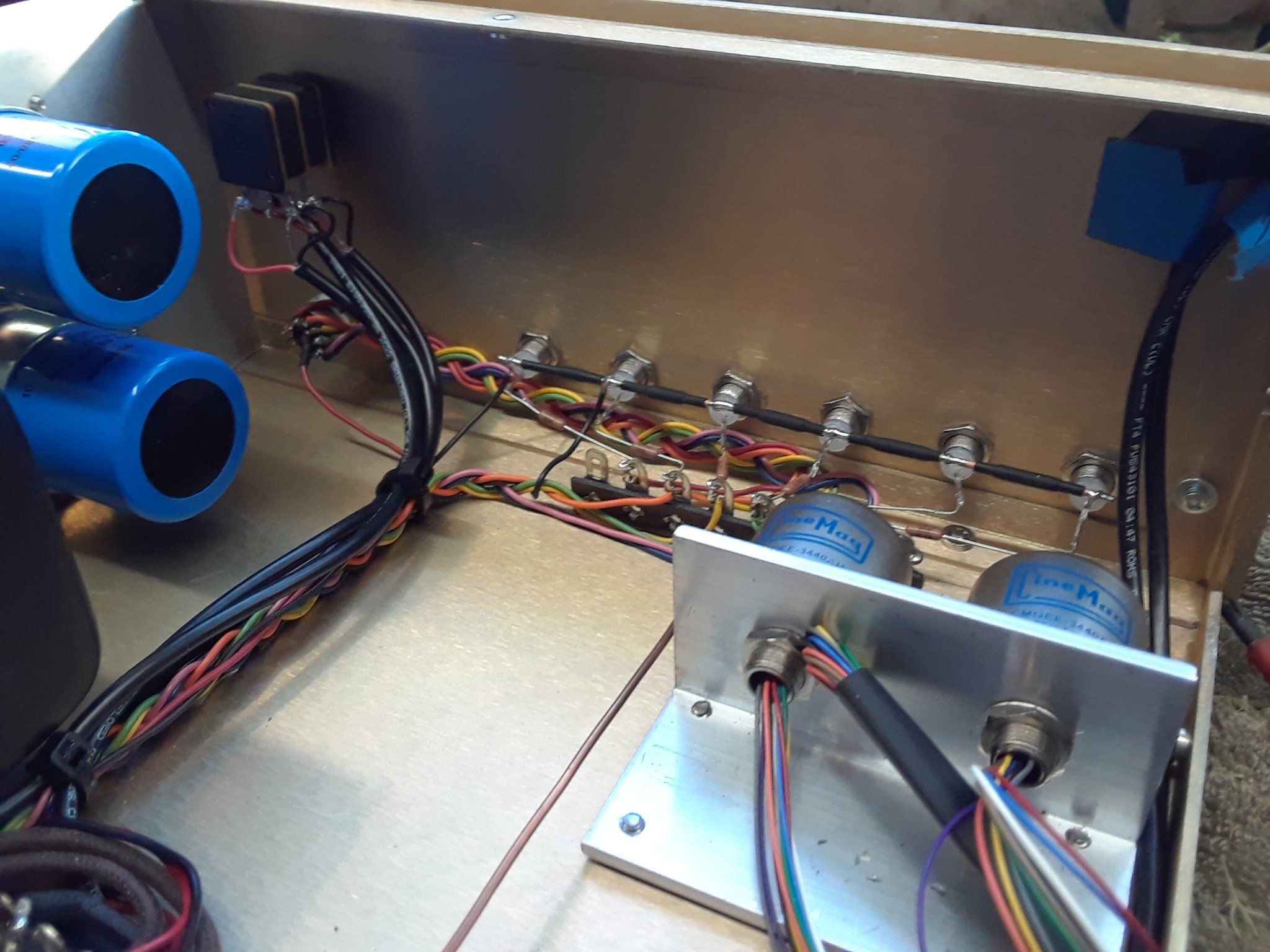

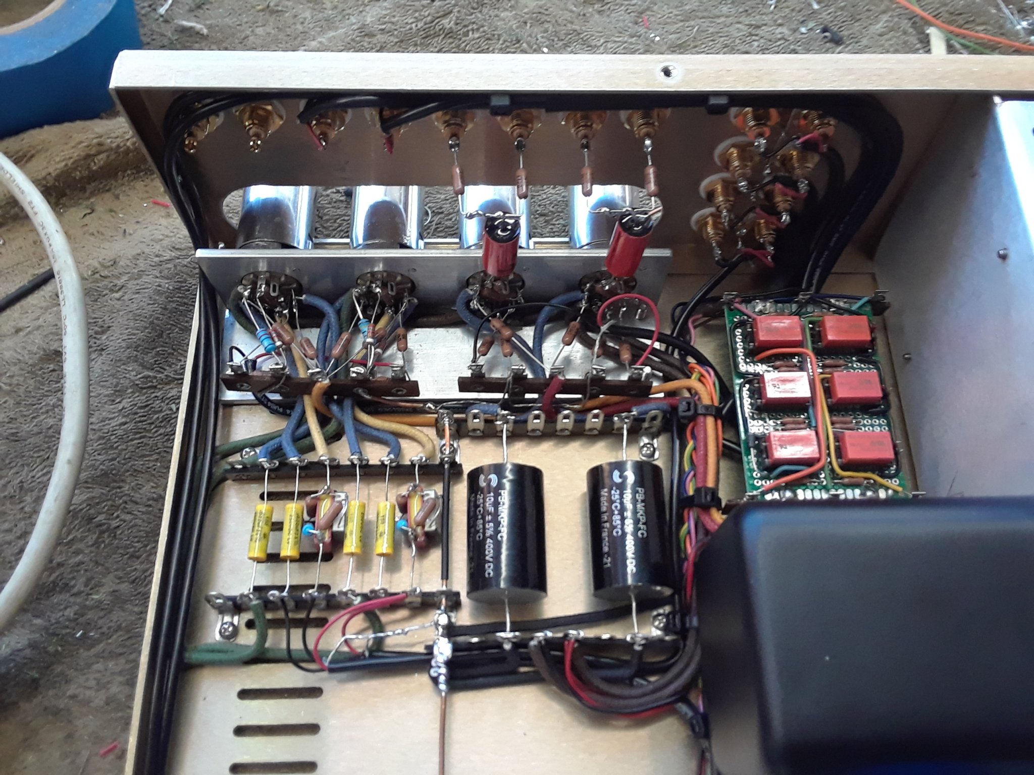

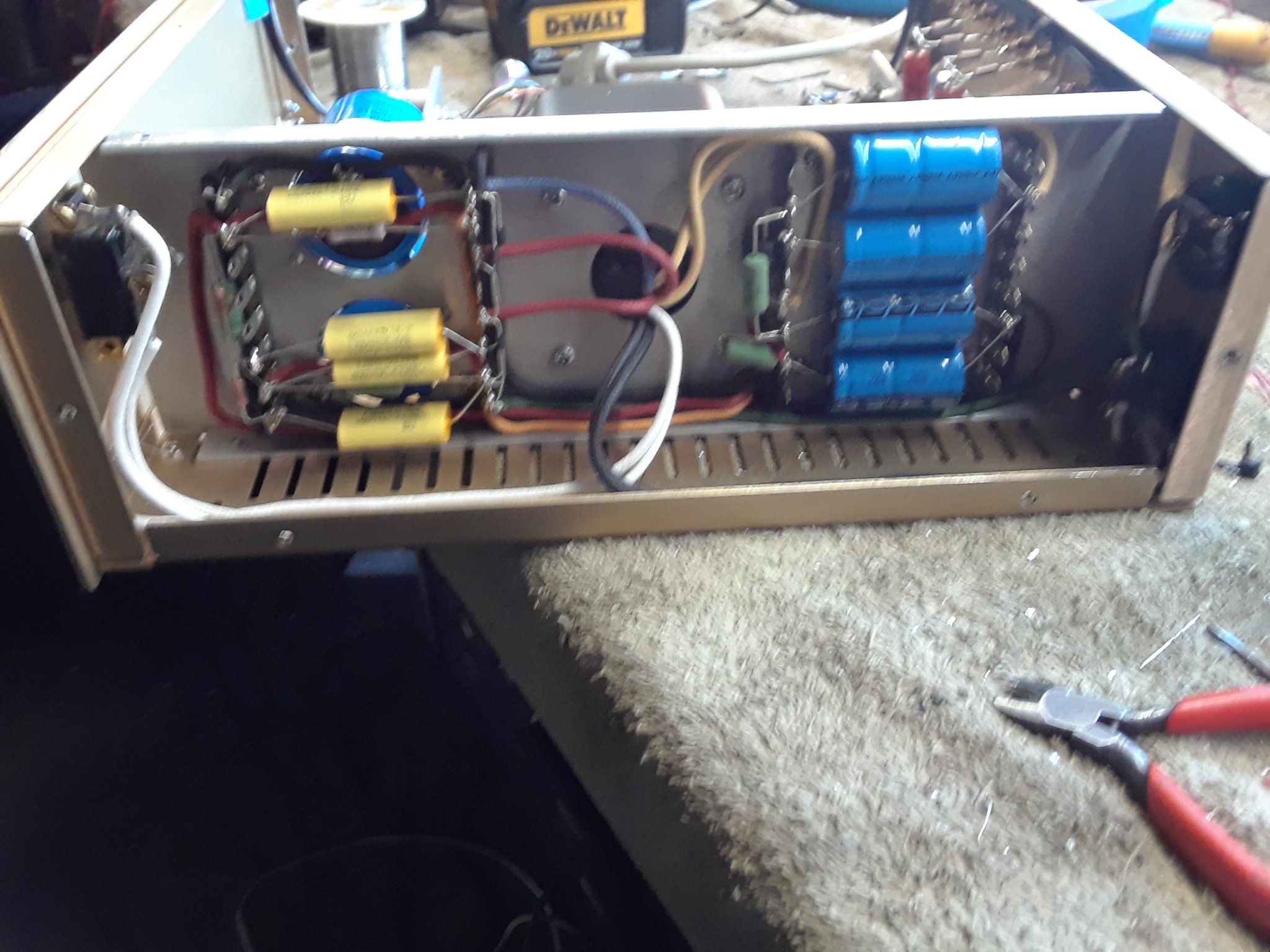

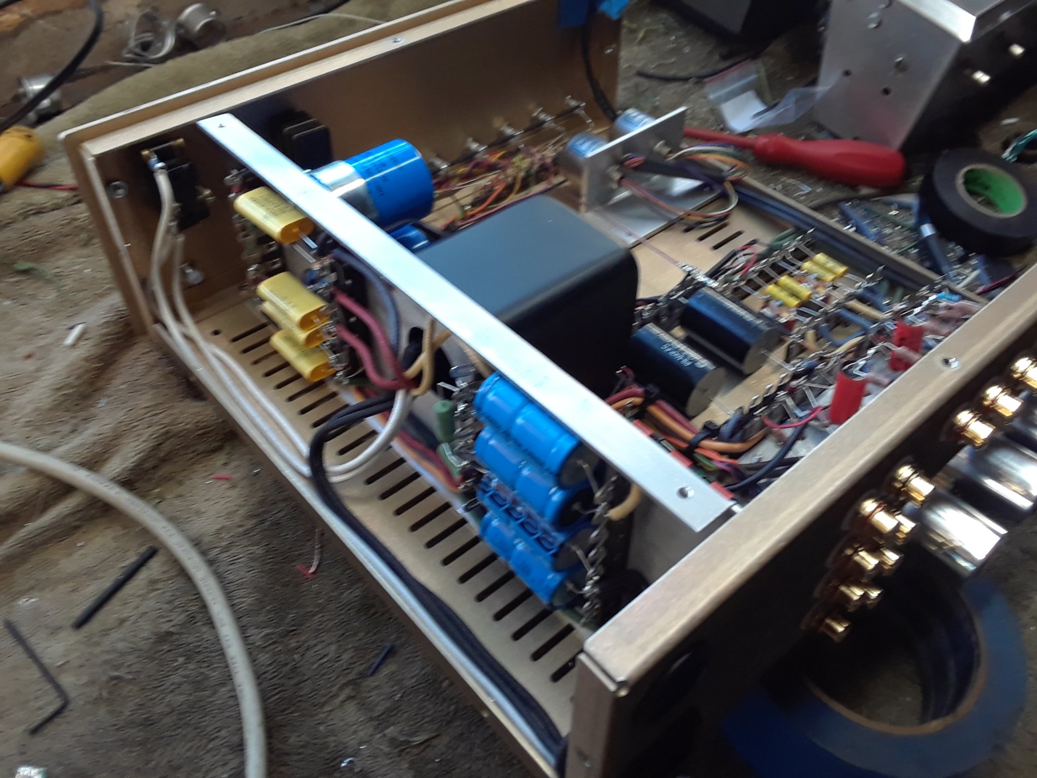

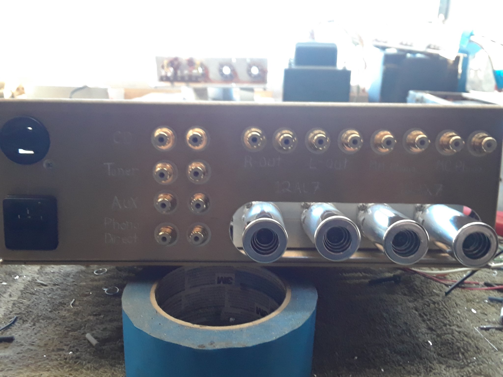

I recently got the itch and built another preamp which oddly enough I had the parts for laying around.
Due to it being the eighth one I've built on this design I tend to order lots of parts and have them stashed everywhere...
I've still got to wire the cinemag transformers on the moving coil phono input, but the rest should work...
Reactions: 6 users
Nice layout, you can tell you've done this before, do still have to de-bug on the first few power up's?
Yes I had one wire misplaced las tonight when I powered it up.
Should be easy to spot in the photos.
I was pulling signal from the feedback connection at the cathode instead of the capacitor next to it attached to plate.
Simple mistake really.
Hard part is getting that relay board built correctly with no opens, shorts,or cross talk.
It puts out a clean sine wave on every channel and every right input spits out on the right output, same with the left.
No I'm not perfect but the mistakes are easily corrected.
Very interesting, it's the first time I see the tubes coming out of the back and horizontally. Great build!
