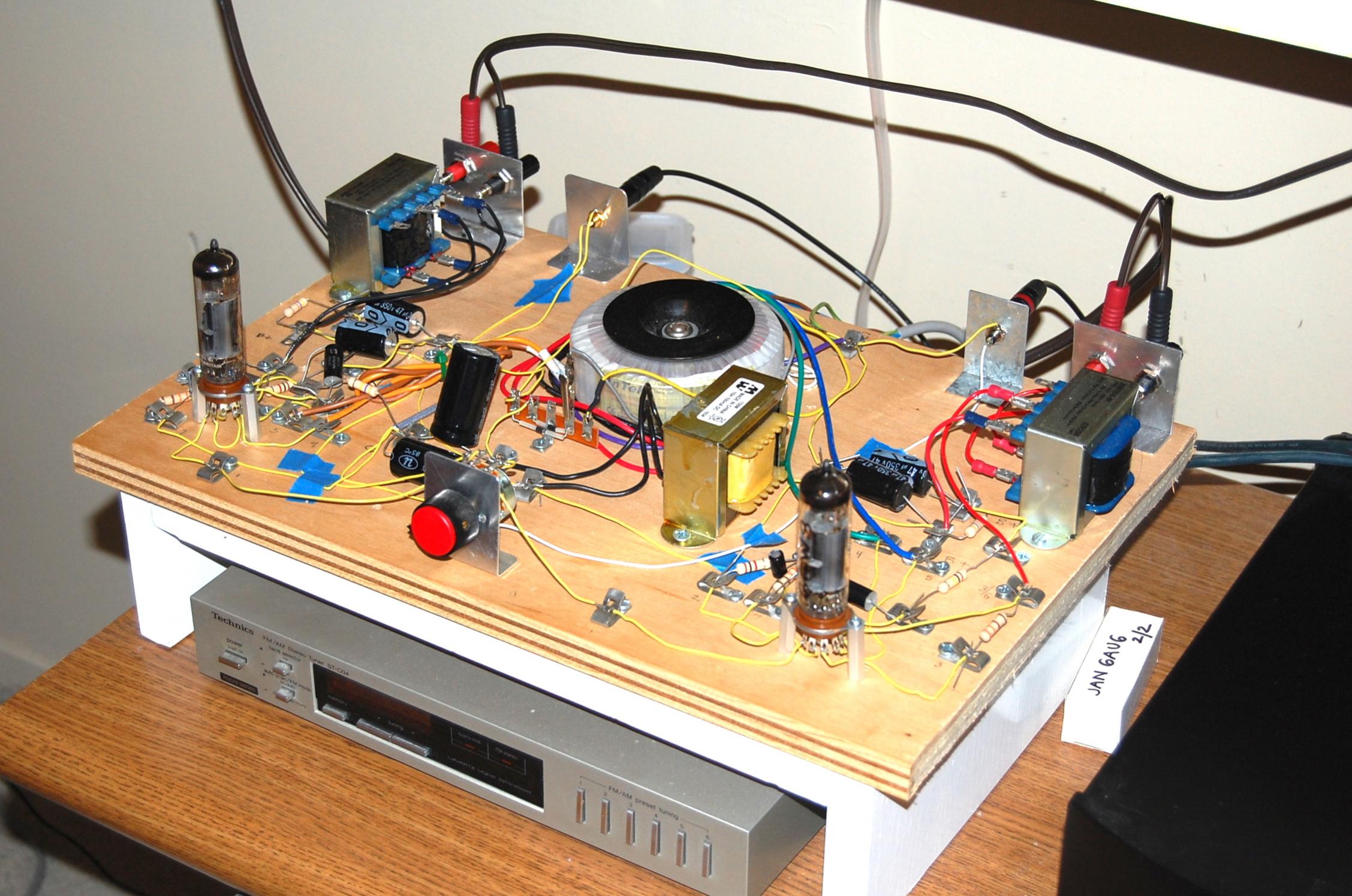

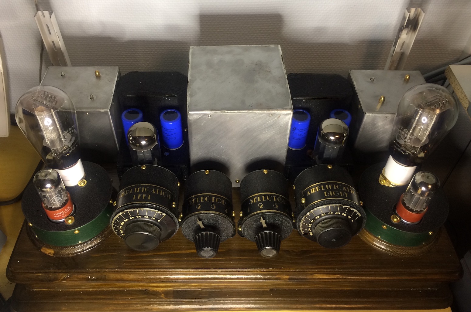

My very early design 300b SE
Hi
posting pics of my very early design, first design Atwater breadboard type amplifier. Plenty of time so I made all calculations, schematics, all hardware, hanwinded the power and output transformer, also made a simple hand winder and so on. To much spare time I guess but I wanted to go deep and understand the whole design process from start to end.
Hi

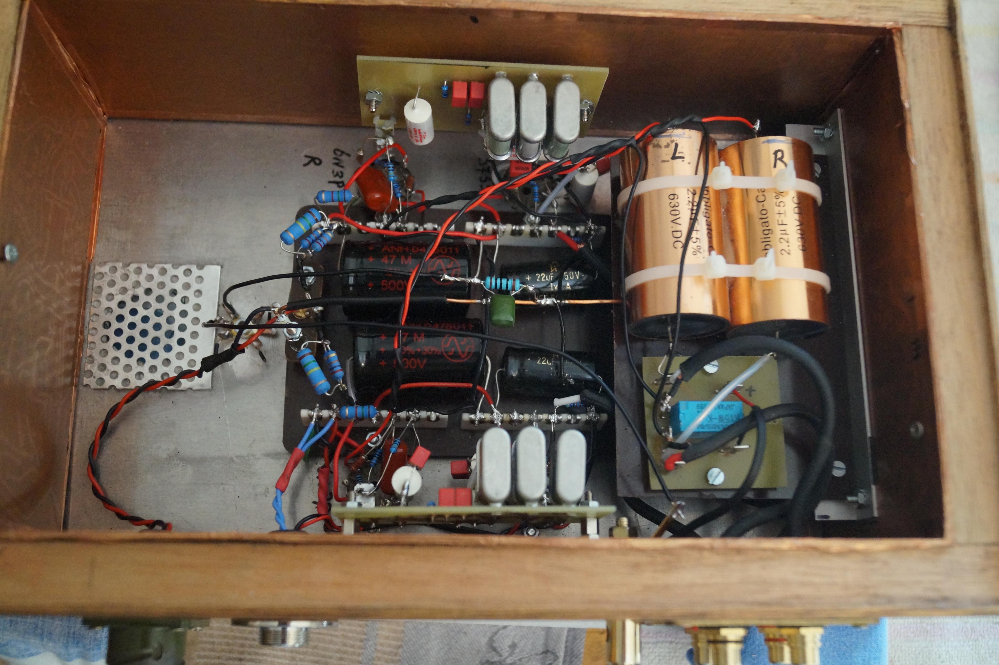

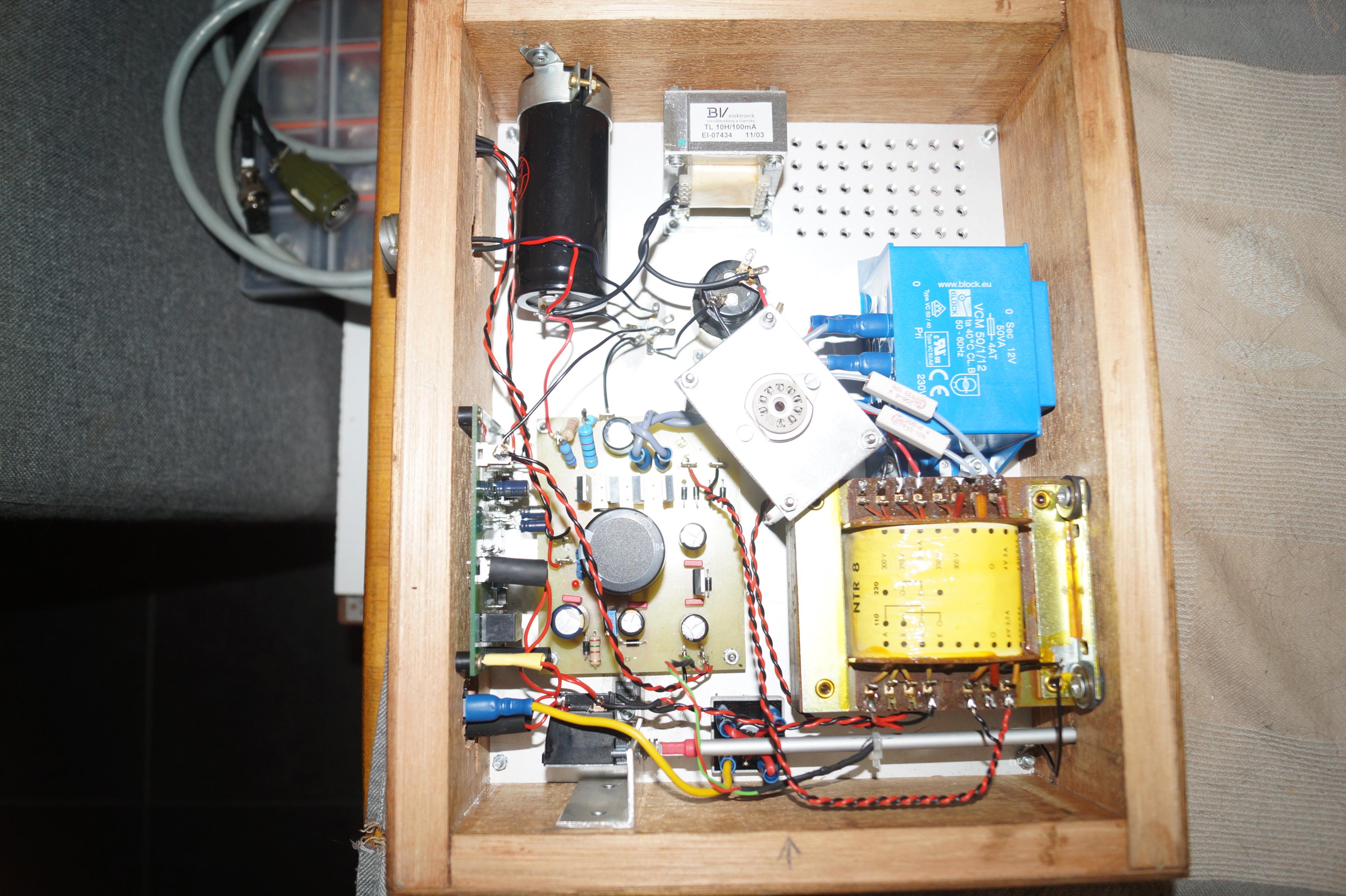

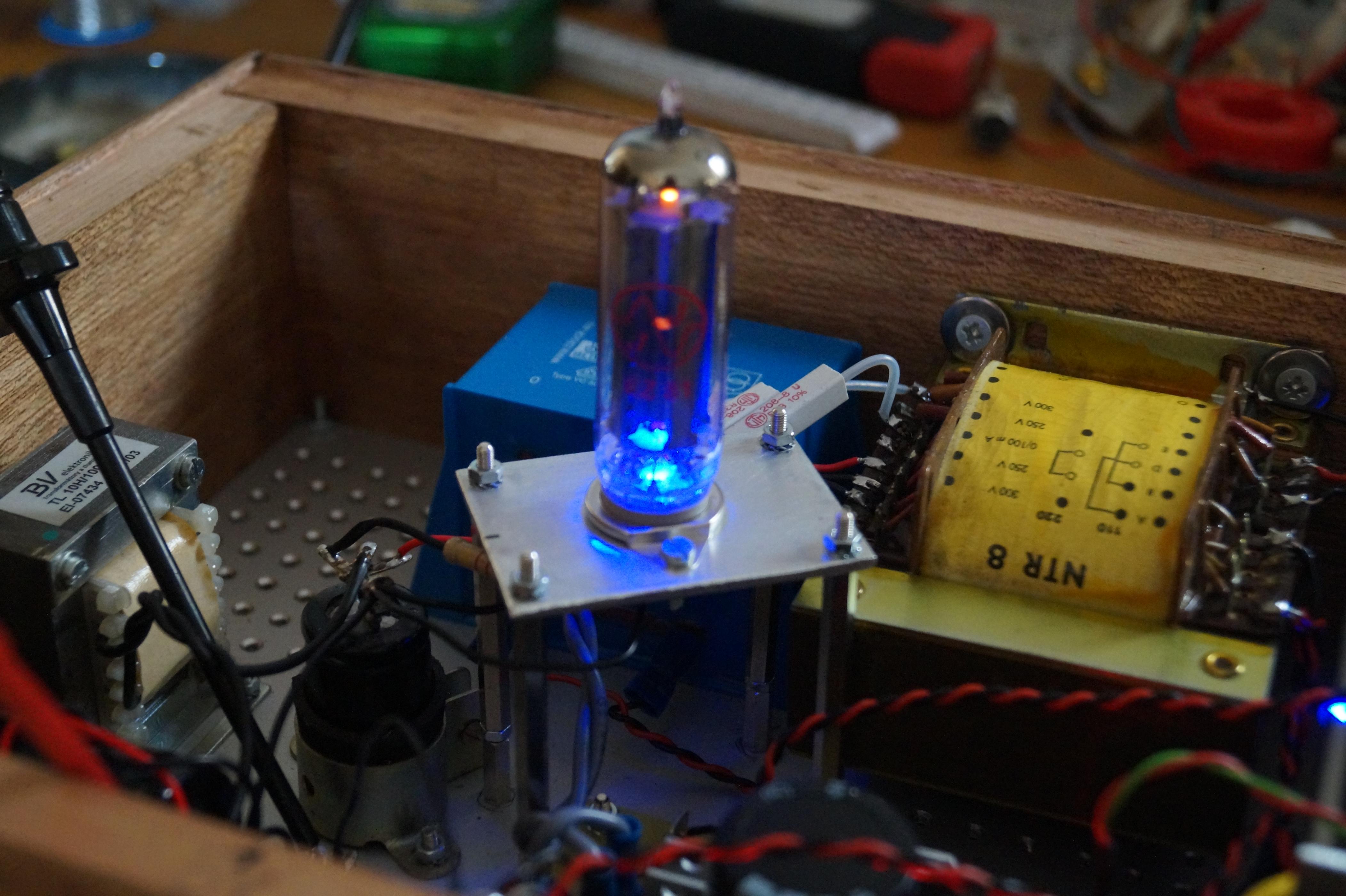

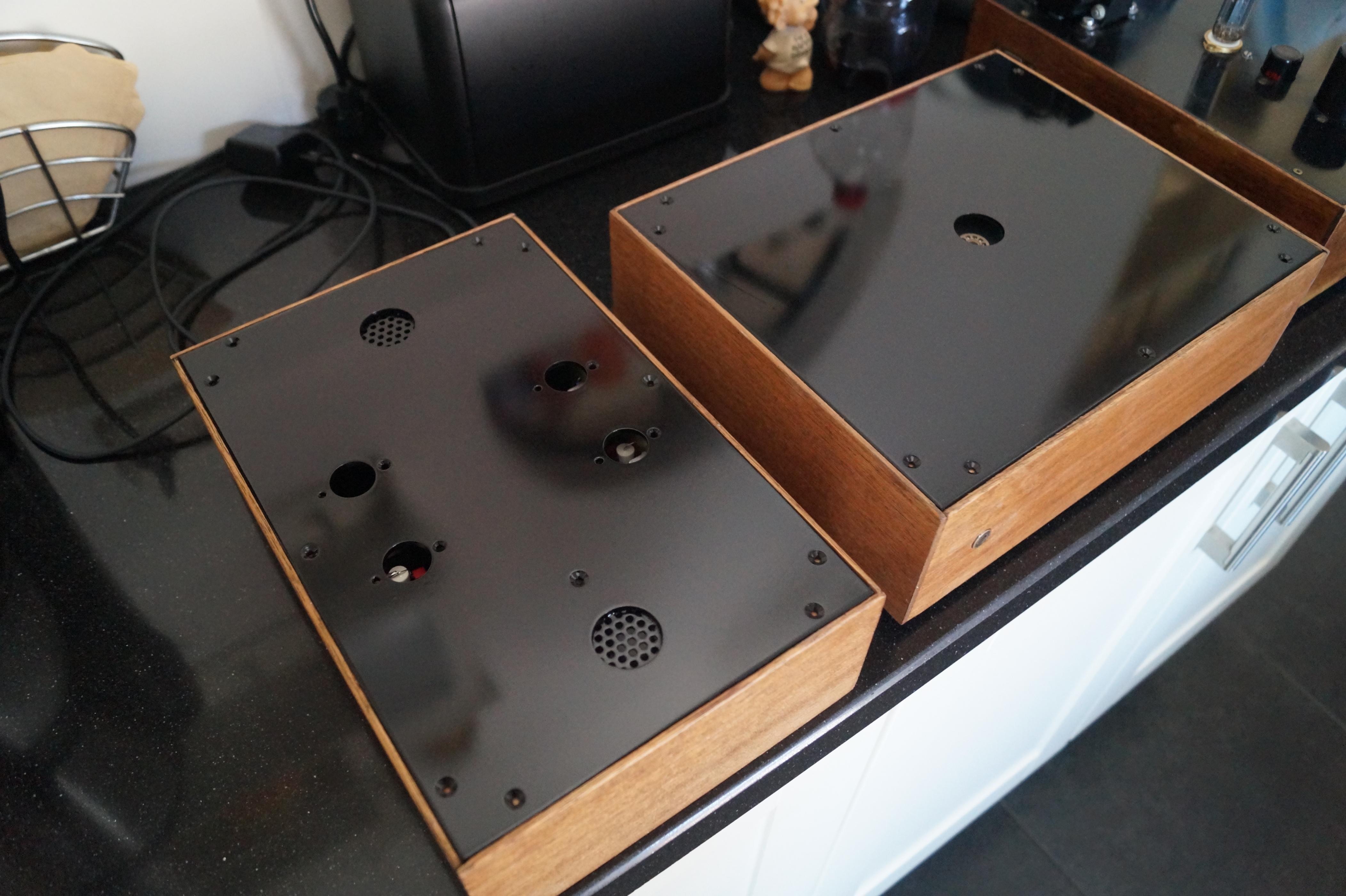

I made a RIAA preamp for a friend.
Separate power supply.

So how did it work out?

Very nicely done.
I assume that's an Aluminium top painted black - do you have any challenges with good paint adhesion ?
Yes allu.
I use MOTIP primer and paint.
And a good,sanding (800) and degreasing with soap and nail brush. before paint.
The paint is dry within a day, so you can build the day after.
The blue LED under the EZ81 rectifier tube is not only for bling.
It is attached to the bleeder resistor,so no blue no voltage .
Also build in a timer mute relays on the out and a anti turn of thump circuit.
All the filter condensators are sorted out (<1%)
After a week ore two it sounded beyond expectations.
Thank you for asking!
Well, I thought it was splendid at first but have become more and more critical.
I have a steady hum probably from bad filtered B+. I use only a CLC filter 47u+5H+47u. Have learnt to ignore the hum somehow. I think it is lacking som highs, seems to roll off from 15-16k. Can't hear much over 13k anyway. It goes really deep, house shaking, type base but it definitely lacks punch compared to other amplifiers I'v built. To sum up, it hums, lacks highs and swampy bass but other than that... Maybe my schematic was too simple. Surely could need some good advice, haven't given up on the thing yet.

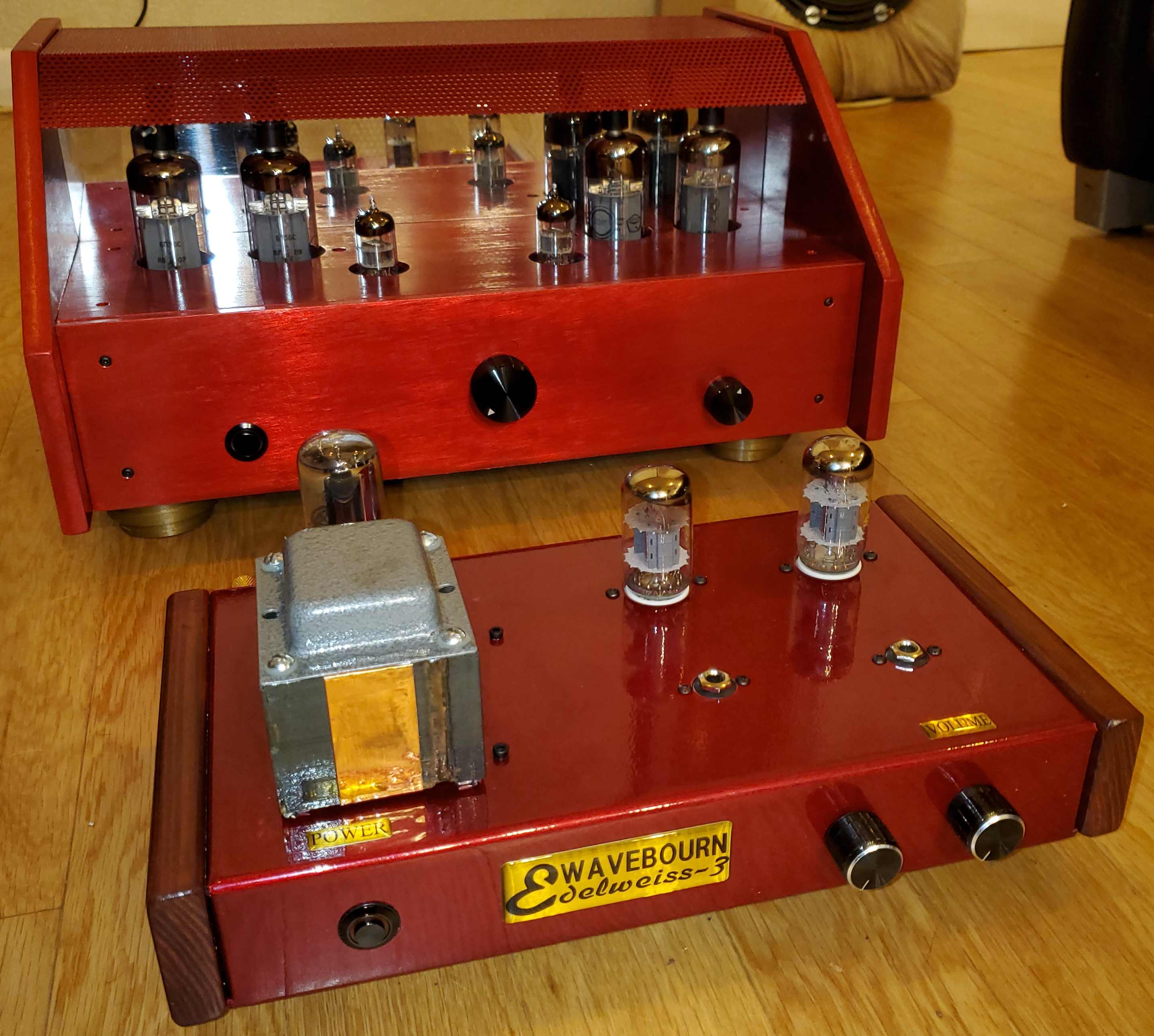

A new version of Hercules prototype, almost ready.
Class A1 push-pull amp, 45W per channel.
Unbalanced RCA and transformer balanced inputs, 0 dB.
4, 8, 16 0hm speaker outputs.
Continuous variable damping factor cоntrоl, from negative output resistance active servо-damping) tо positive (current drive). Almost inaudible soft saturation when overdriven.

Superb. A variable transconductance tube amp.

A bridge in feedback loops, with the current transformer.
