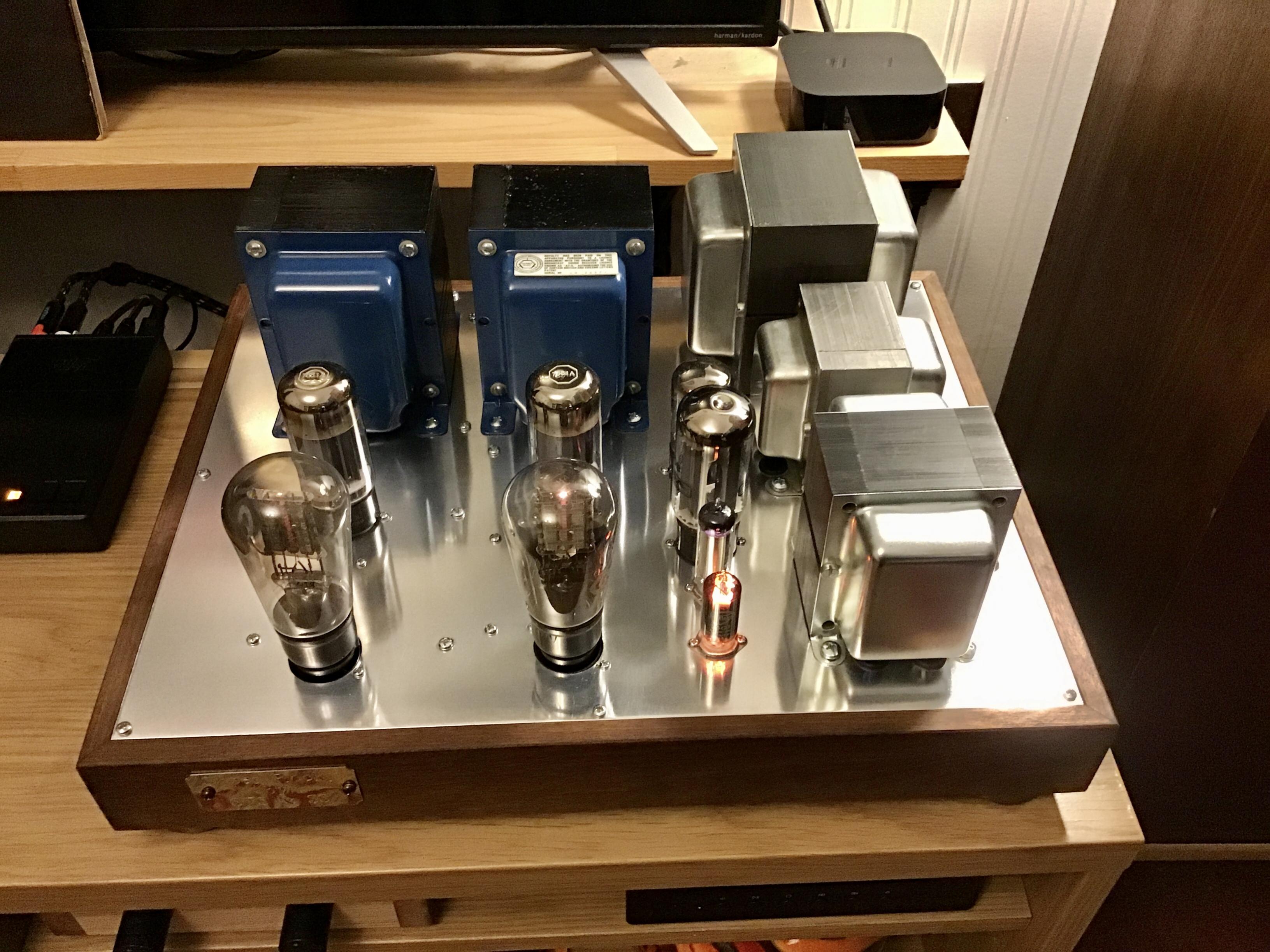

Below is a pic of my single ended ultralinear amp with cathode feedback using the output transformer secondary. Output stage is a new production Tung-Sol 7581A.
Input/driver is a British mesh-plate globe MH4 from the mid 1930s.
There are separate choke-input power supplies: one for the input stage and a glow tube shunt regulated one for the drivers.

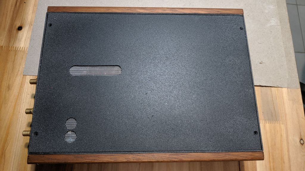

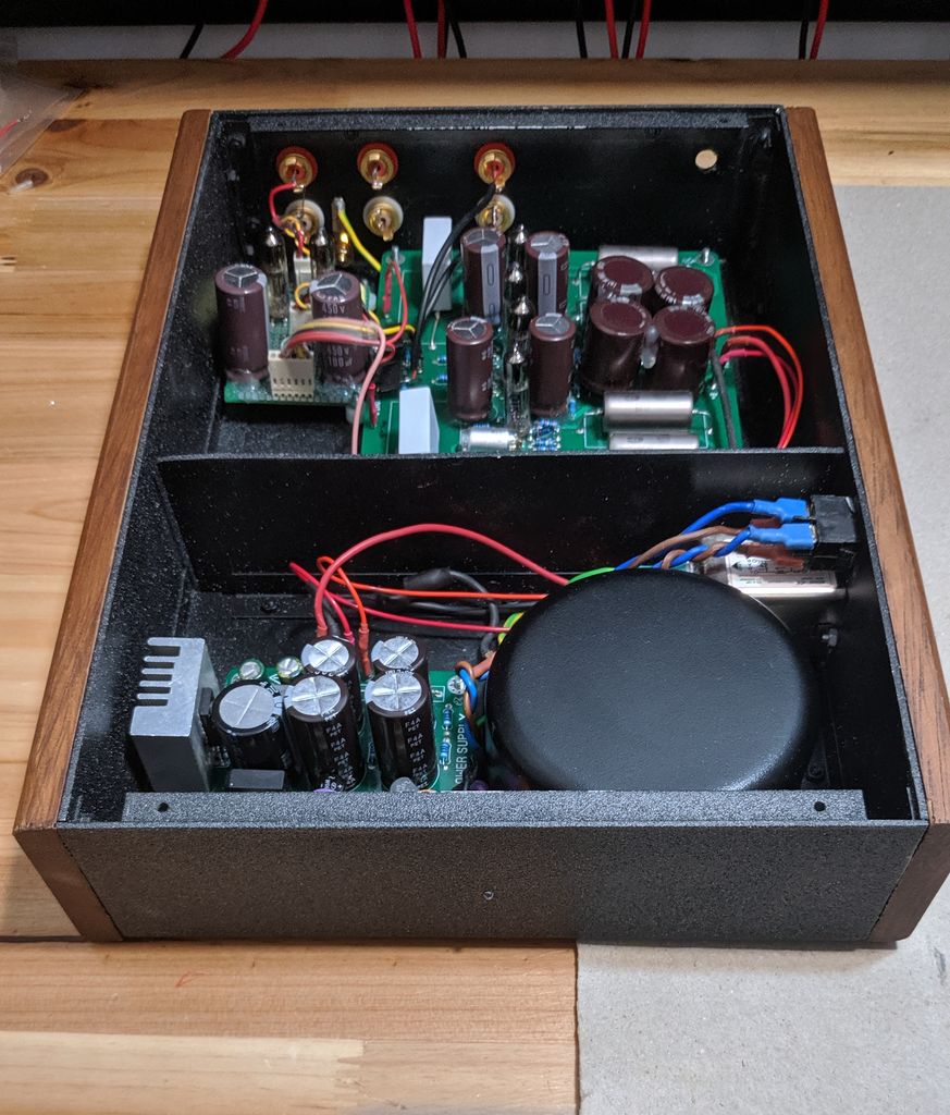

I managed to revisit and finish a little project I left a couple of years ago due to luck of time.
It's a phono preamp designed by Koifarm with pcb provided by Boydk, here and here, based on 6N16 miniature tube.
Also added an MC pre-pre stage based on the same tube as I mostly use mc cartridges
Looks don't say much but it plays beautiful 🙂

...what are the OPT's Steve?...
Andy.
Hi Andy,
OPTs are old style multiple secondary, Hammond 1627SE, wried for 4R, with 8R speakers to give a 5K reflected load.

Very nice Amp Steve congrats, I am just been curious but what are for the small tubes on the right? .....all the best
The small tubes on the right are gas-discharge voltage regulator tubes, and are part of the input stage power supply. These tubes were the forerunners to zener diodes. The two on my amp are valued at 150V and 75V, which means that series connected, as a shunt reg stack, they maintain a steady 225V supply to the plates of the two input valves.Very nice Amp Steve congrats, I am just been curious but what are for the small tubes on the right? .....all the best
