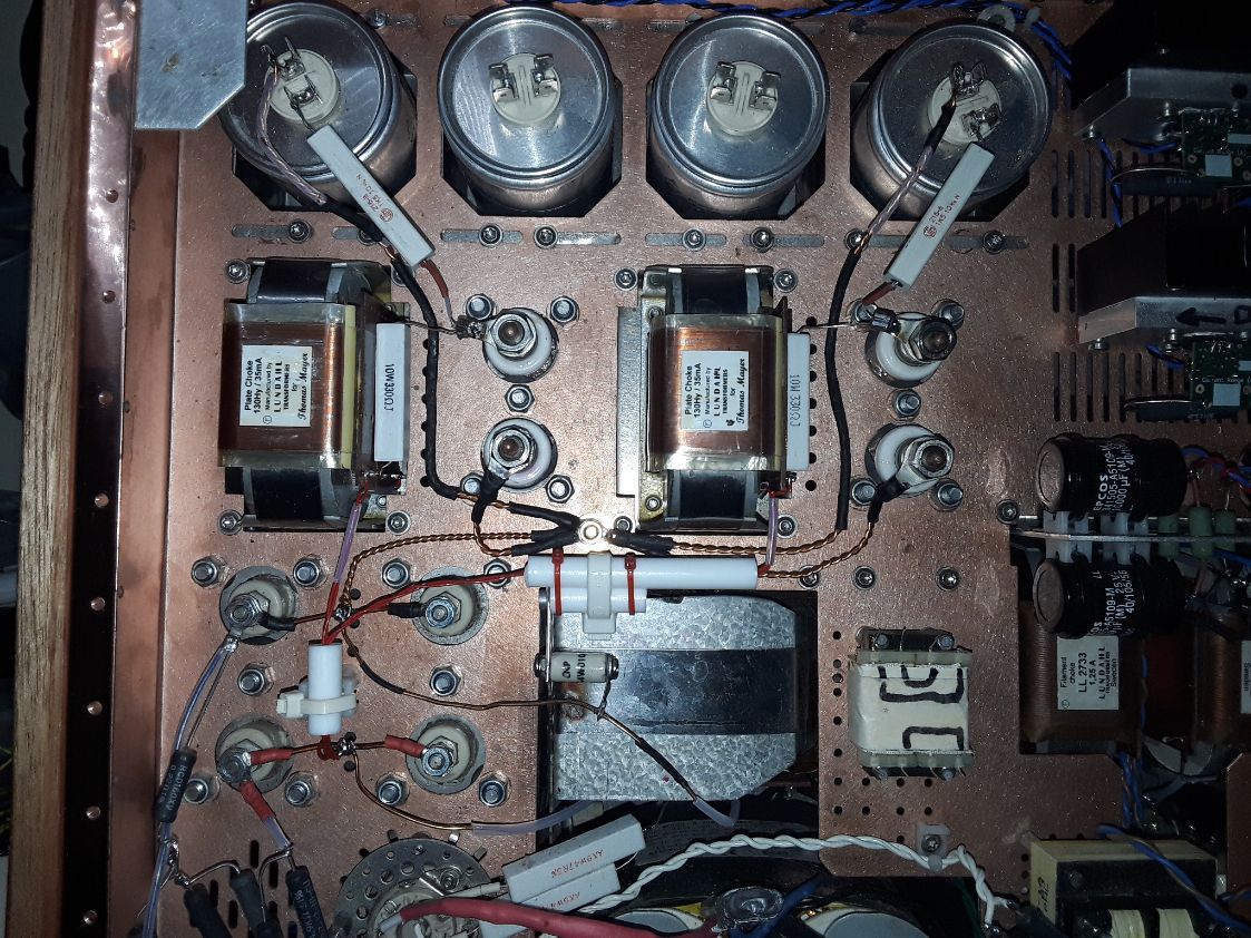

Hello Bas,

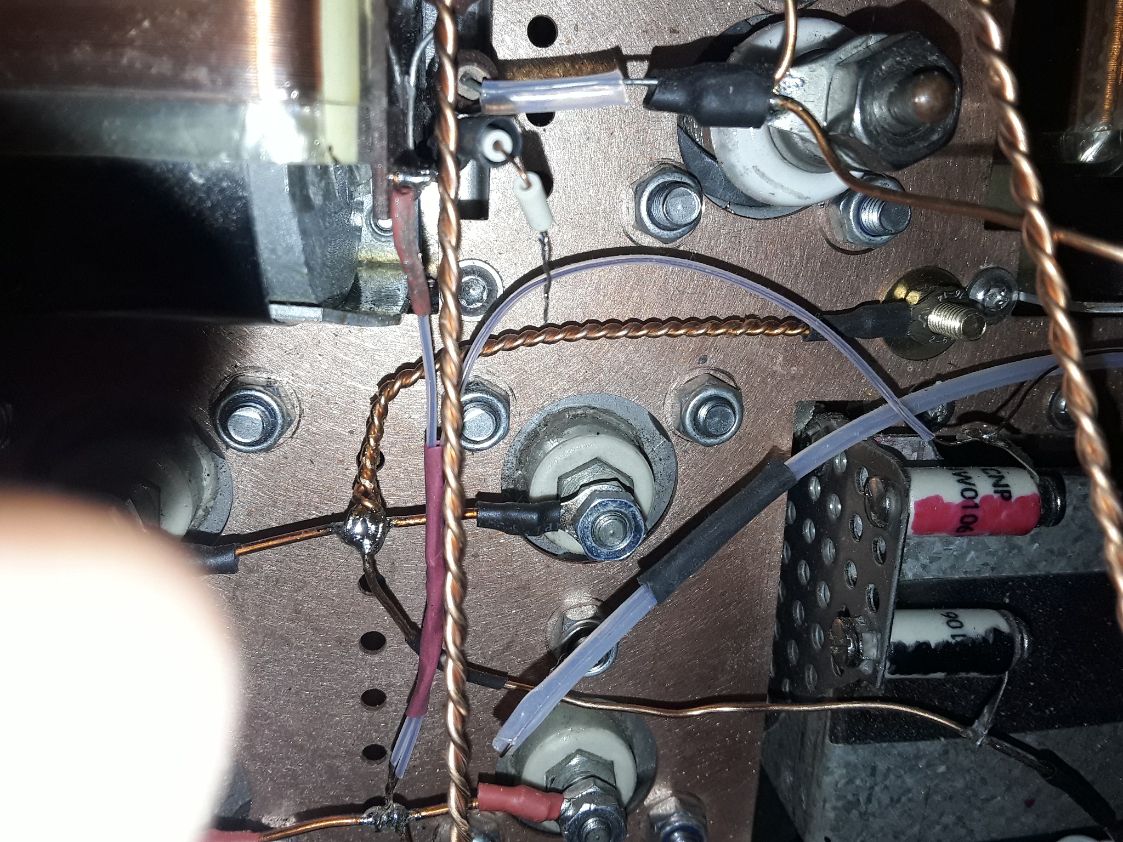

Sure it take loads of time to get it done. Try to gather information how to get the wiring done right was the latest issue.
It looks like i know now how to get it done.
In the beginning the LCLCRC supply was done with all chokes having half of the wire so to say in the return. Peter van Willenswaard ( Audiomagic) told me not to do this for the second choke so i changed that.
All caps have their negative pole connected to the chassis at the same point from there will be a 35 cm wire running to the input tube.
The AC heater supply of the input tube will be guided along the opposite corner of the one that has the twisted black and blue from the Rod Coleman circuit running to the UX4 support. These wires are running close to the top plate and the 6,3 volt will be close to the bottom plate . Running it in parallel with the 35 cm mass wire would be bad.

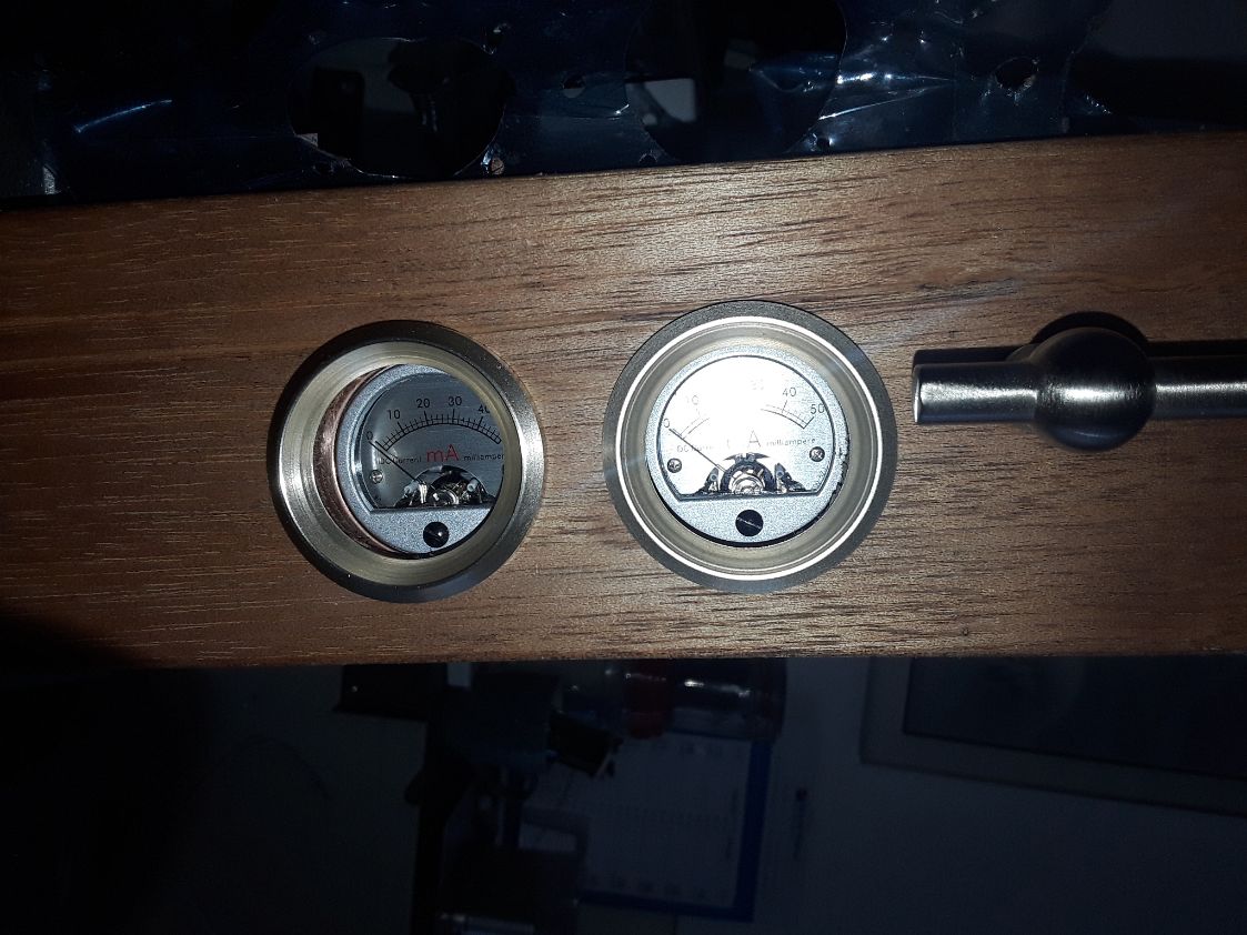

Have to finish the hole for the Yamamoto meters. Probably covering the inside with a black? plastic foil. It reminds me of the the Minions cartoon.
Greetings, Eduard

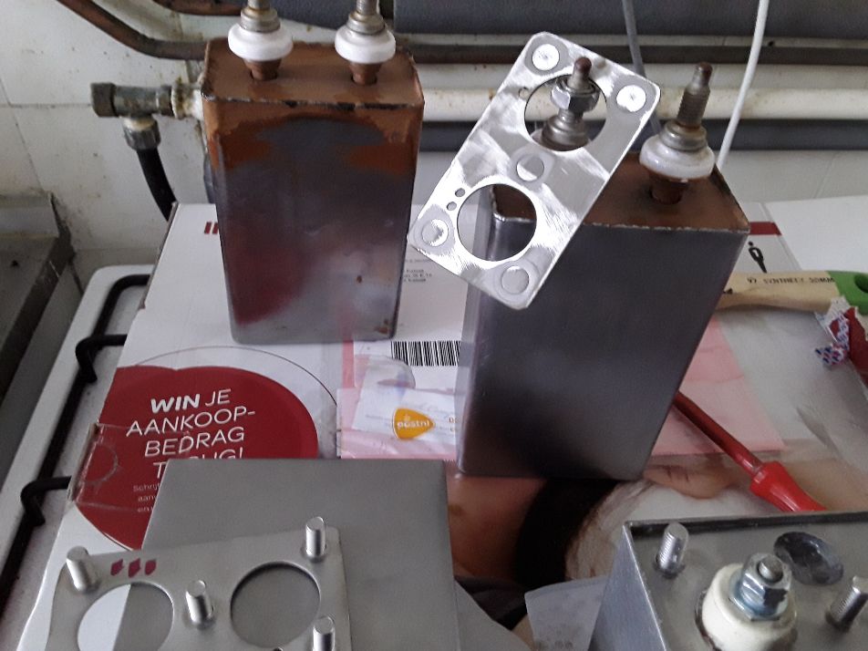

update on capacitor mounting

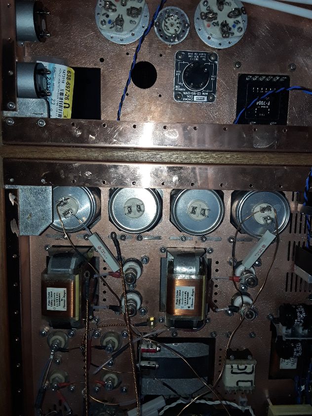

Hello Bas,

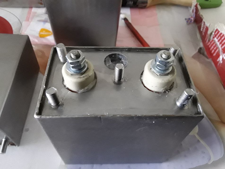

Yes, i made some stainless steel plate that fitted exactly into the small chamber of the CSI and the Russian oil capacitors.
The fixation bolts are 6 mm so you are tempted to attach them to powerfull!!. The plates were a little thinner than the space inside the capacitor so the outer rim of the cap will be on the top plate of the chassis and if you use to much power you the glued plate will come loose. I used some kind of elastic glue and it wasnt the best one for this purpose so i glued the CSI one more time using two component epoxy glue that is used at the company to glue alumium to an already powdercoated chassis. The '' designers '' have done some test to find the best glue. Dont know the brandname. I was only told how to use it. Degrease it!! Once the two parts are together you can slide them but if you seperate them the glue will NEVER work.
The Russian caps still glued with the not so powerfull elastic glue but i used some rubber rings to prevent to much force on the mounting glue.. When i put the chassis upside down it will be supported only by the highest and heaviest part ( 11,5 kilogram) which is the power transformer and input choke. When put on one of the sides it is also supported by this cover.
I had the two copper plate parts folded twice at each side AND added a small piece of aluminium in each corner to make it more ridged because the wooden frame doesnt add much strength.
Especially the power supply part have loads of holes so i needed to regain strength by the stainless steel covers on the top side. In the end that worked well.
When the chassis will not be sturdy it could be that soldering connection involving ridgid cable could be stressed during transport.
Greetings, Eduard

Hello Bas,
Greetings, Eduard

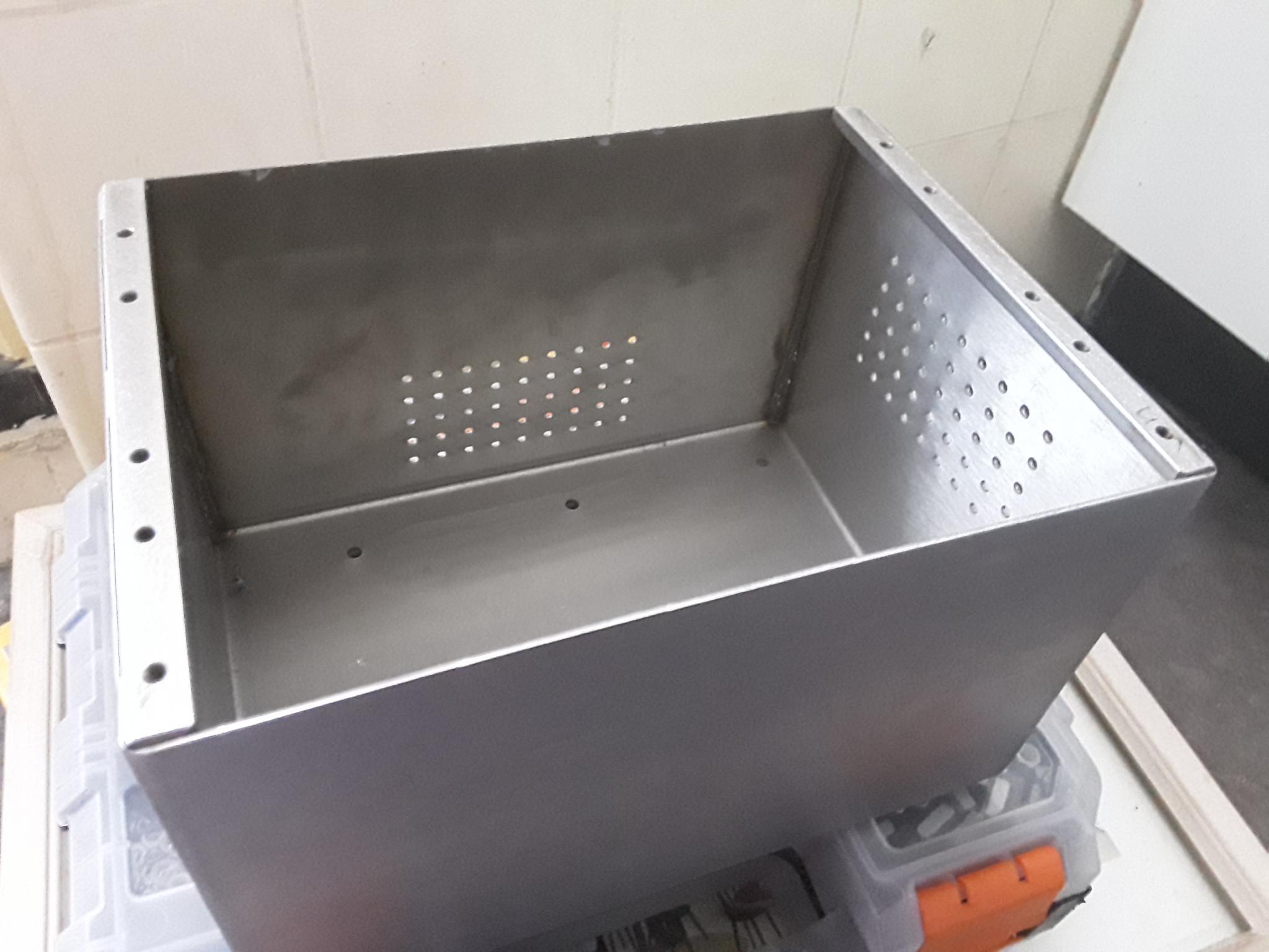

A lot of metal fab. going on there.
Disabled Account
Joined 2002
Hello,

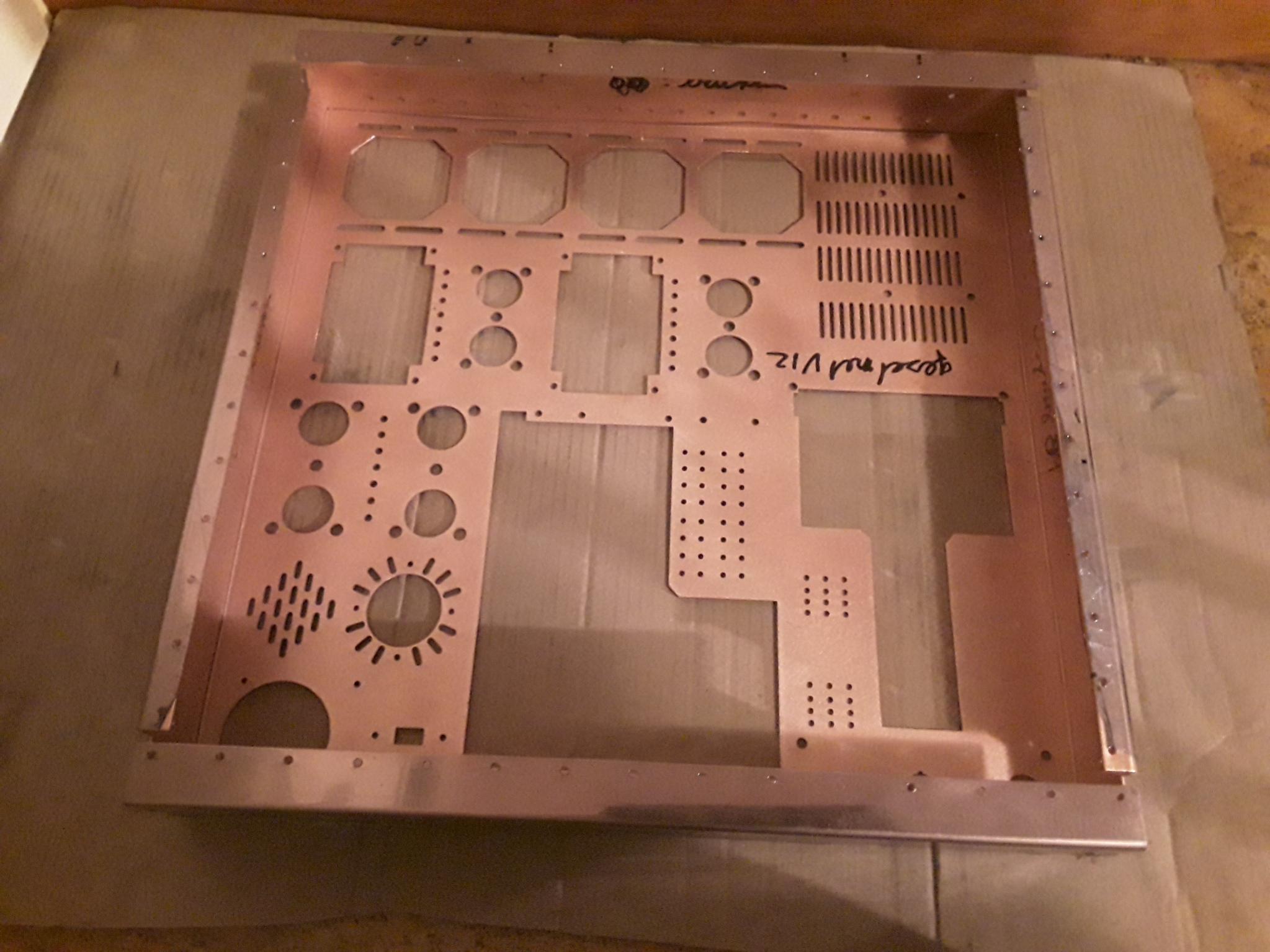

It is my job so it is rather easy to do with sometimes help of coworkers. Only the positioning of all the elements in two later connected copper chassis was a hard job. First made one in stainless steel to see if it has the looks.
I need to add some plastic foil inside the '' eye socket '' of the Yamamoto panel meters. They look like the Minions eyes. On each end of the wooden front panel there is a stainless steel T bar? This is not for really lifting the chassis but to pull it out of the audio rack so it can be really lifted by the two side panels.
