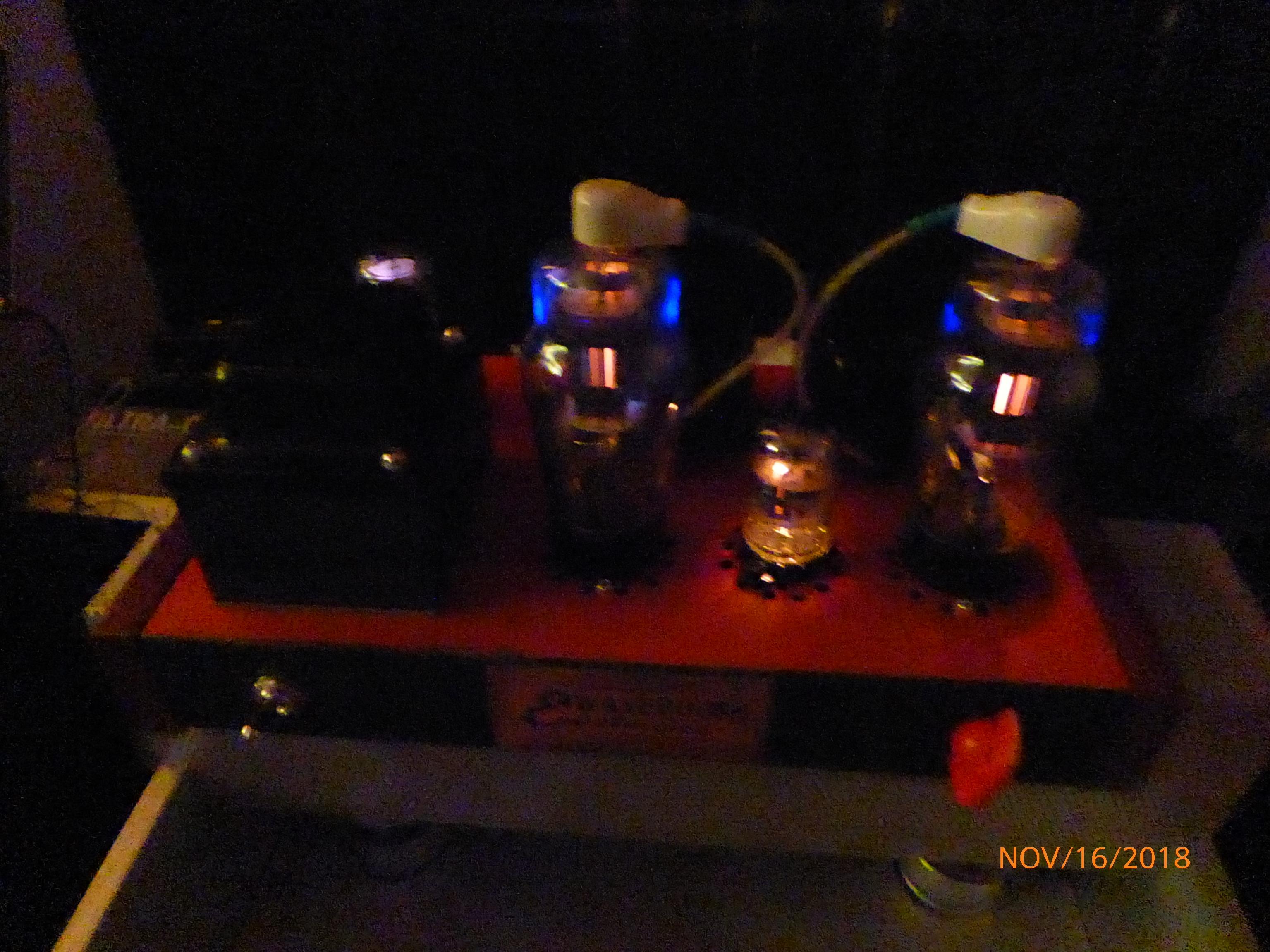

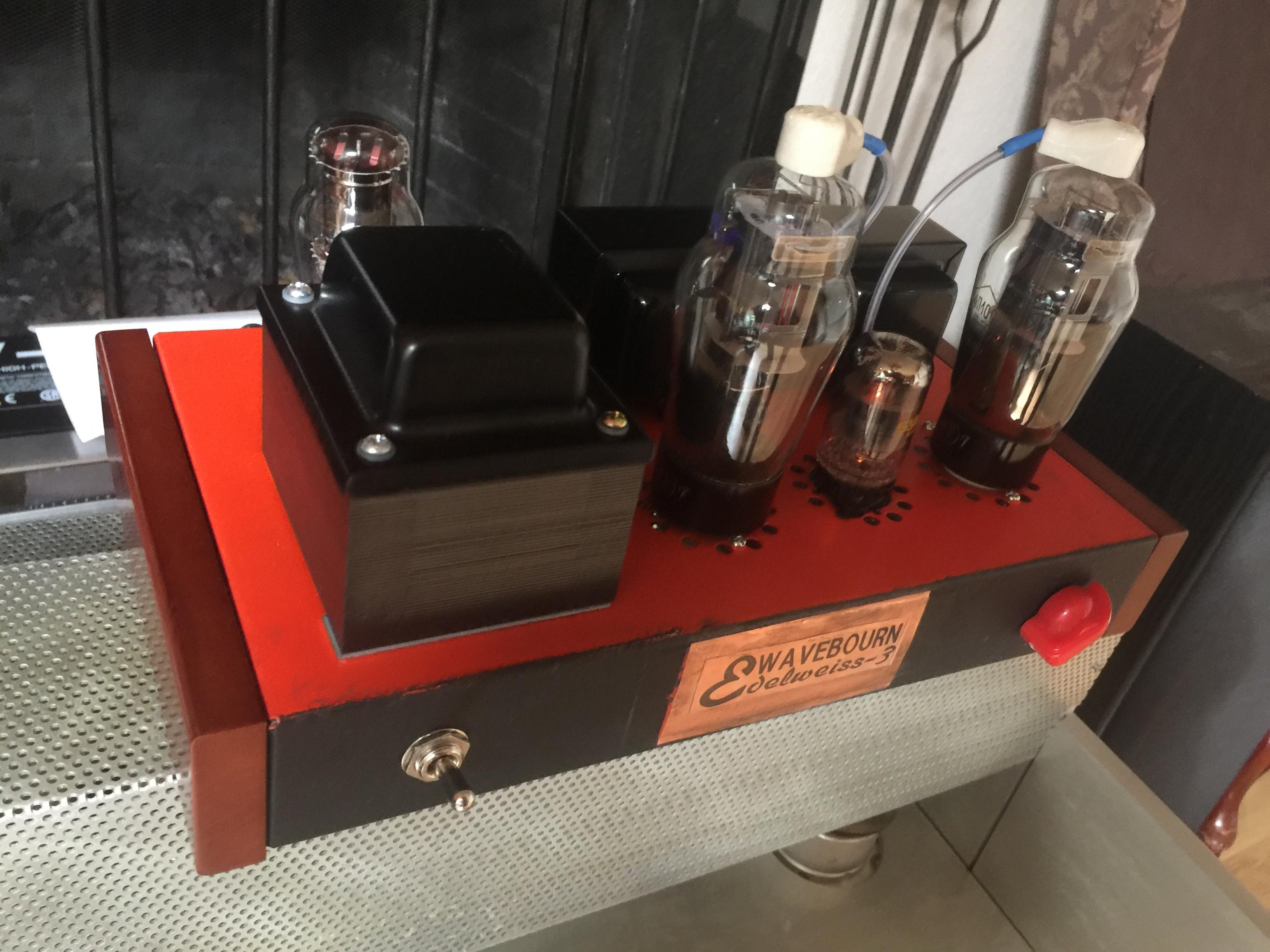

Ok, the amp is all soldered, performed the first audio test. It sounds lively, real high end, even with Chinese output transformers from Walmart. Tomorrow I will measure and fine tune the schematic, then post the results.

I used the chassis and an iron. I did not measure yet how it performs with their output transformers, but the sound is gorgeous! Power transformer does not hum, does not overheat, but I had to insulate bolts and add 5V secondary in series with the primary. I highly recommend the kit as the source of chassis & an iron.

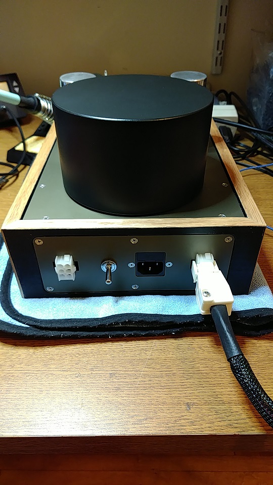

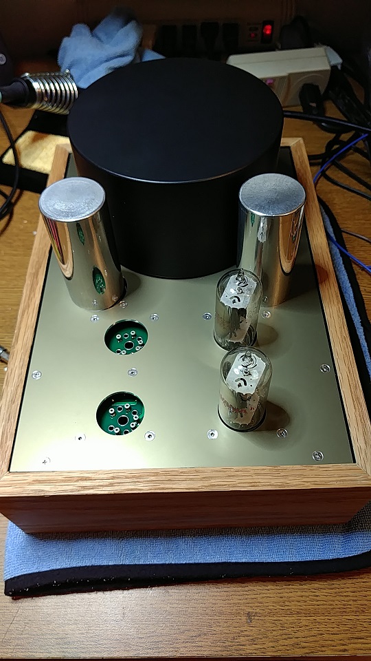

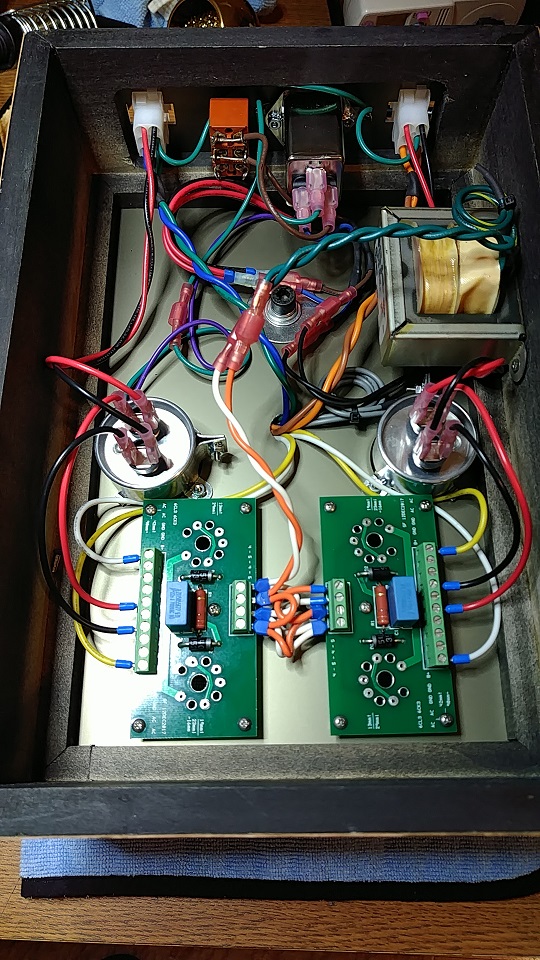

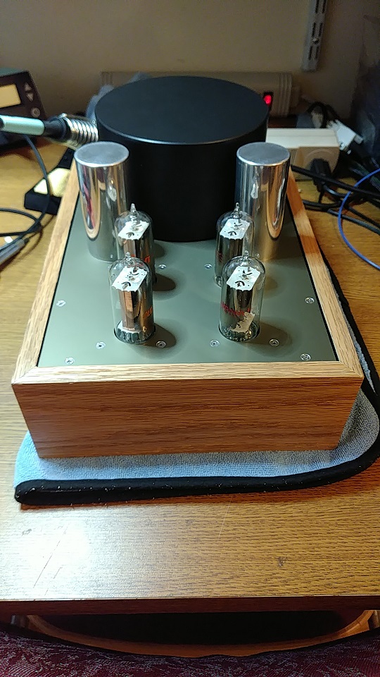

Dual Hybrid Power Supply
This is a dual hybrid power supply using 6CL3 damper diodes.
First stage filtered DC, heater supply, and chassis ground sent via umbilical cables to future planned monoblock amps.

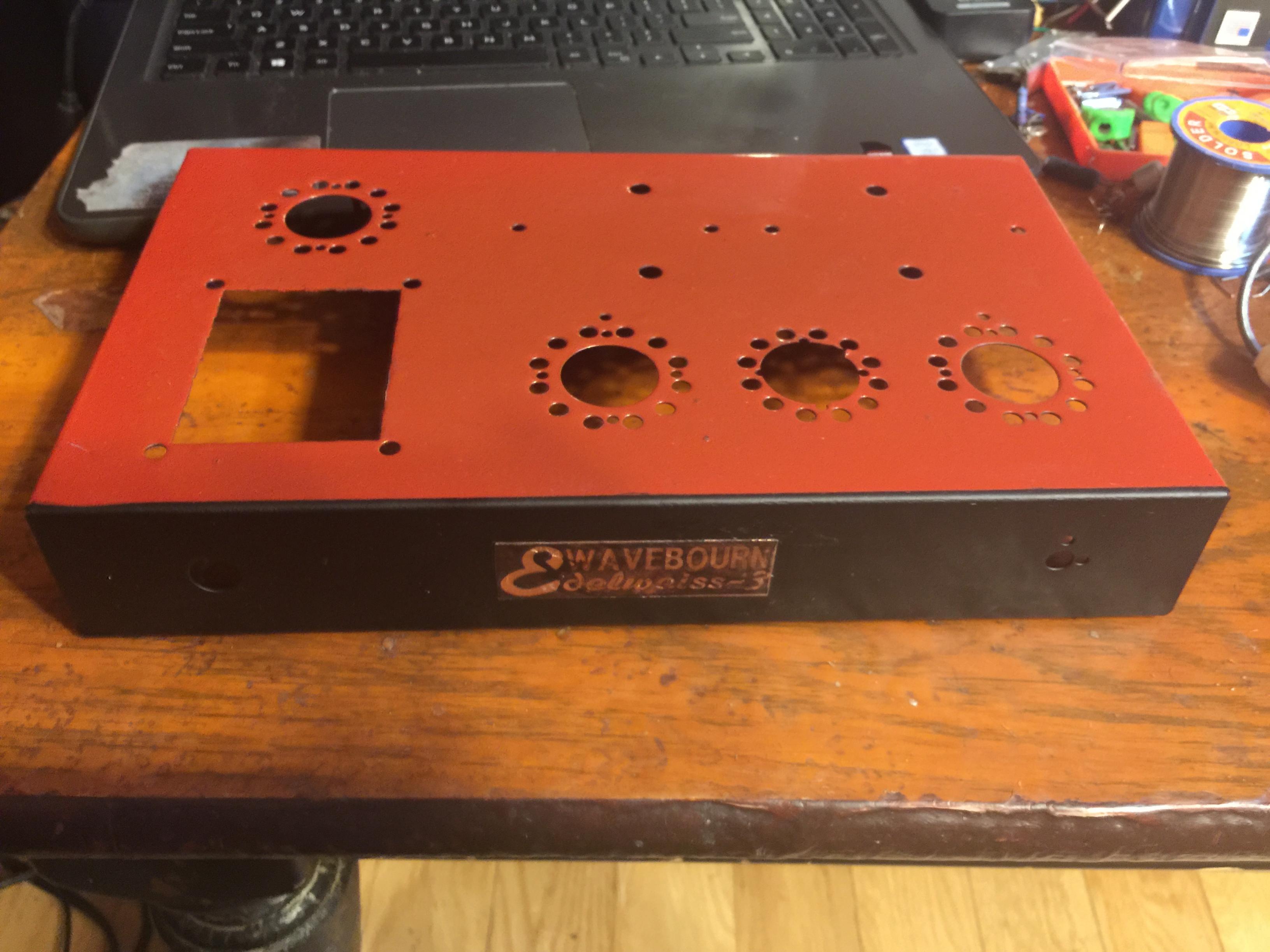

Hello Mr Wavebourne:
Could you talk a little about "baking a chassis". I find this concept quite intriguing. Does it help reduce scratching the finish during the final assembly of the project?
Thanks for the help
Thanks for the help

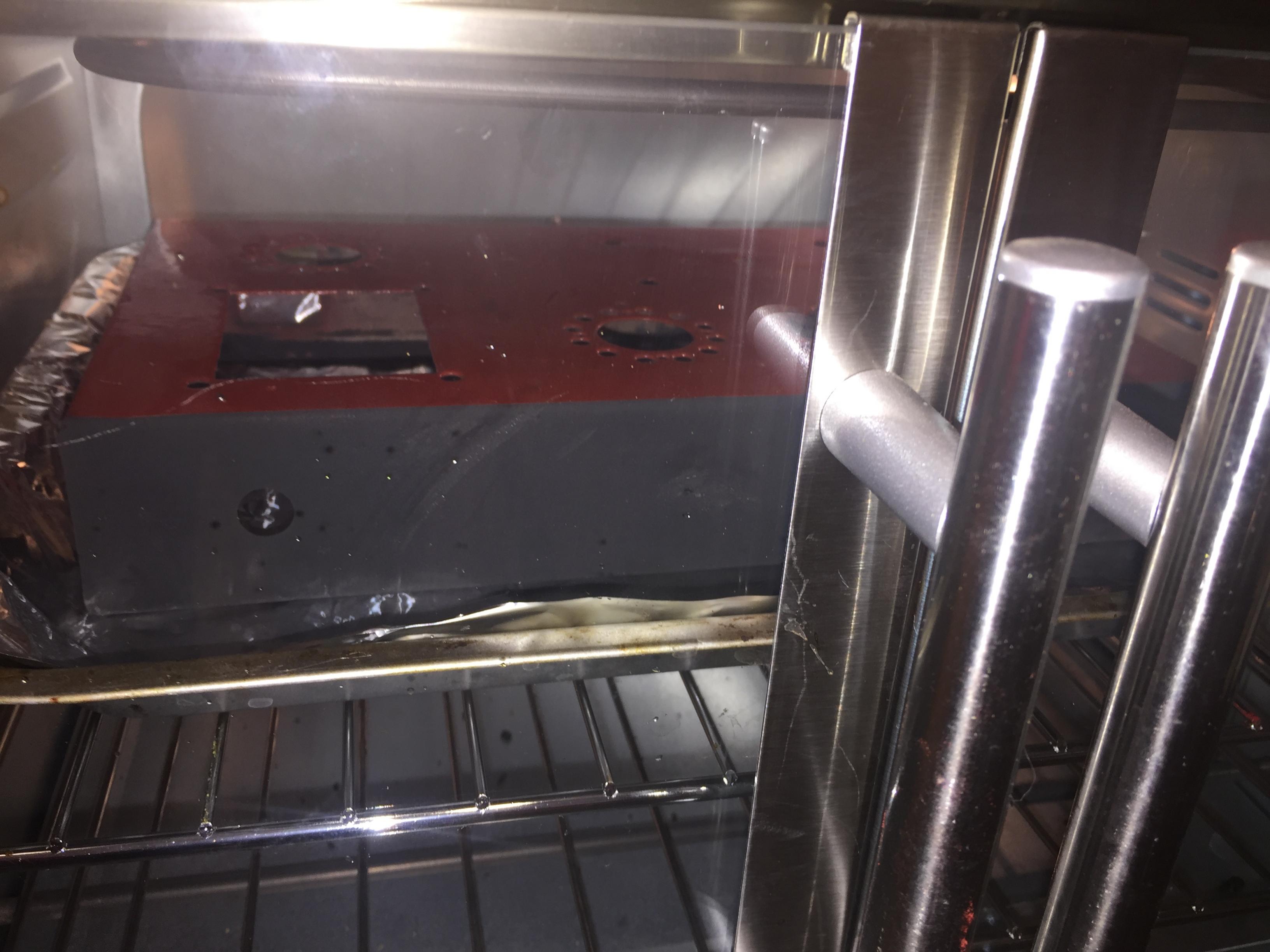

It is off-topic here, may be Moderators move it to some appropriate thread?

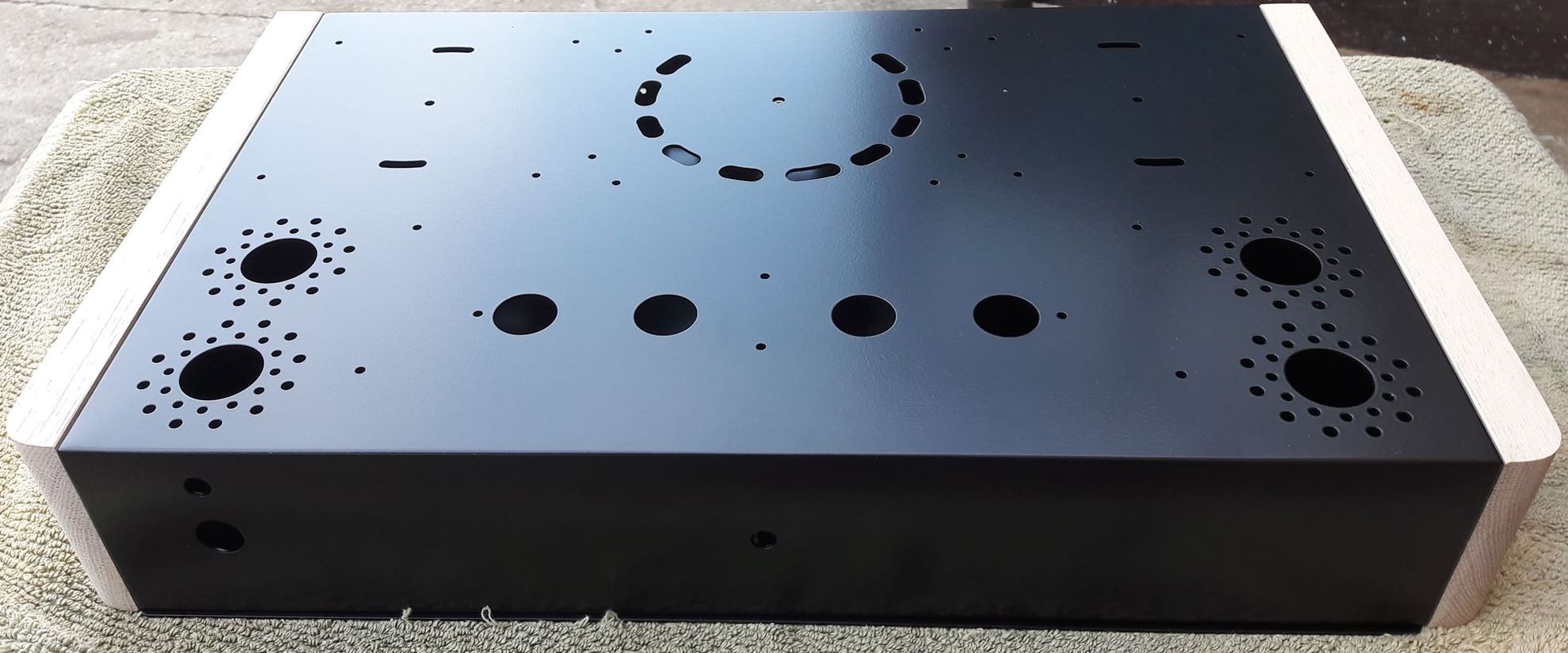

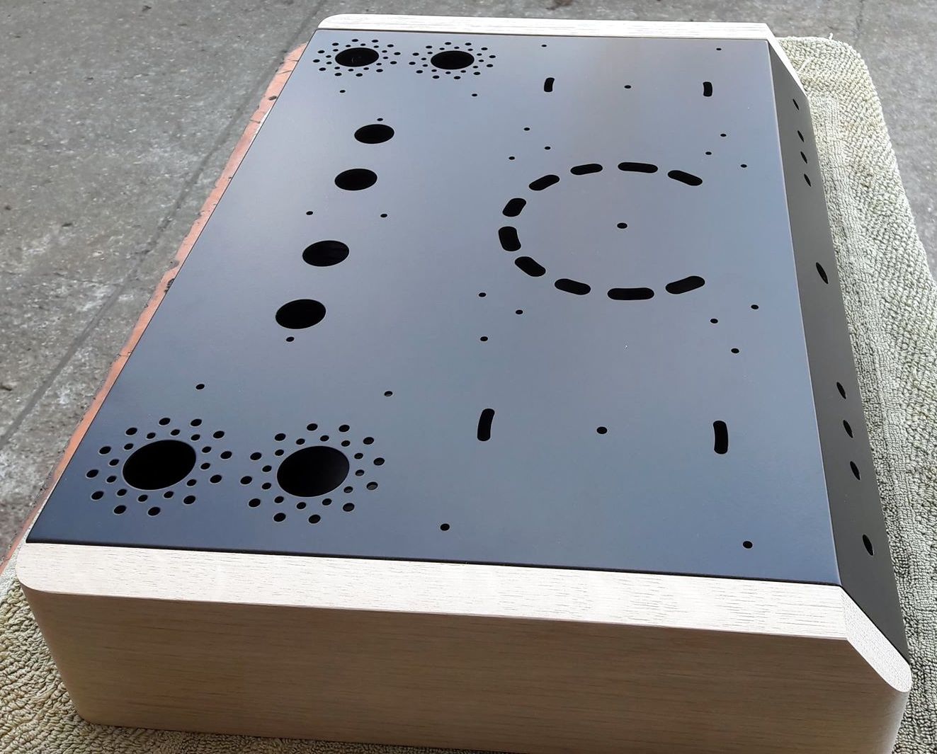

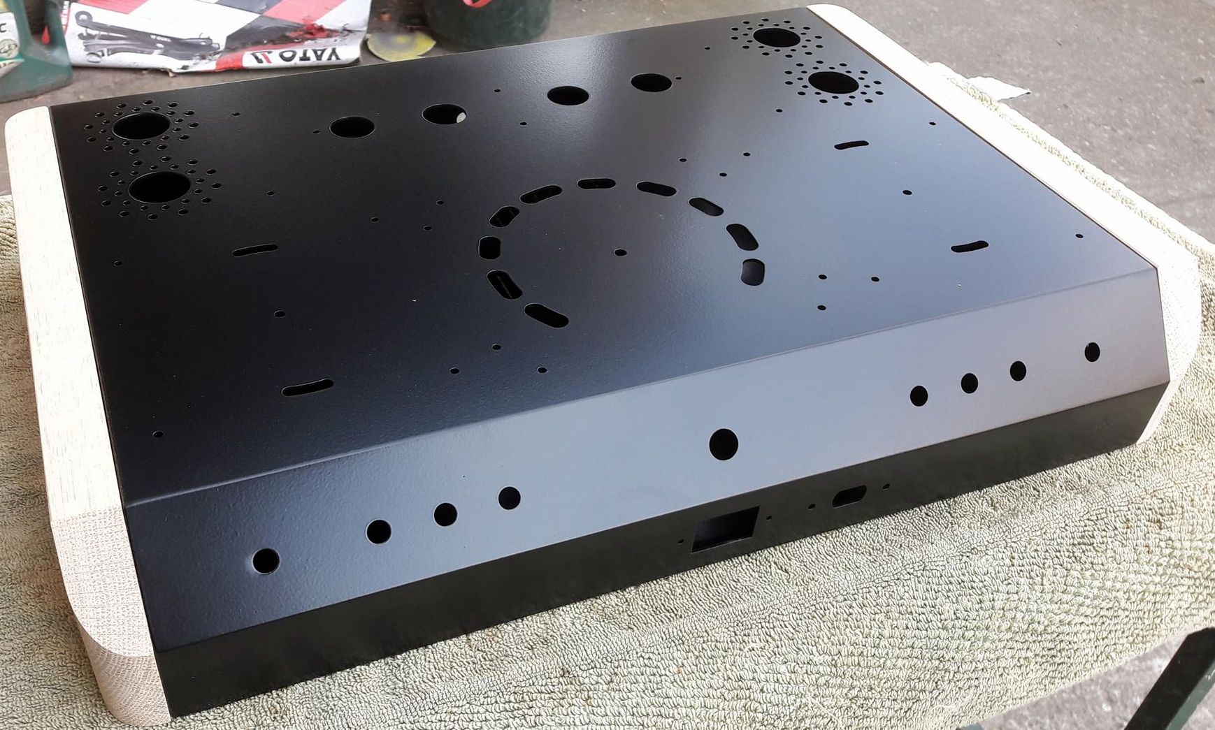

I use a machine that I bought in Harborfreight store and a compressor that I also bought there. They sell a cheap stuff, enough to learn the process.
The machine contains a pulverizer and a high voltage source. High voltage attracts a special powder that then is being cured in an oven, 400F for half an hour.
The machine needs up to 30 psi, otherwise the dust will be everywhere!
It is very similar to laser printing. The adhesion is great, and the surface is pretty durable.
