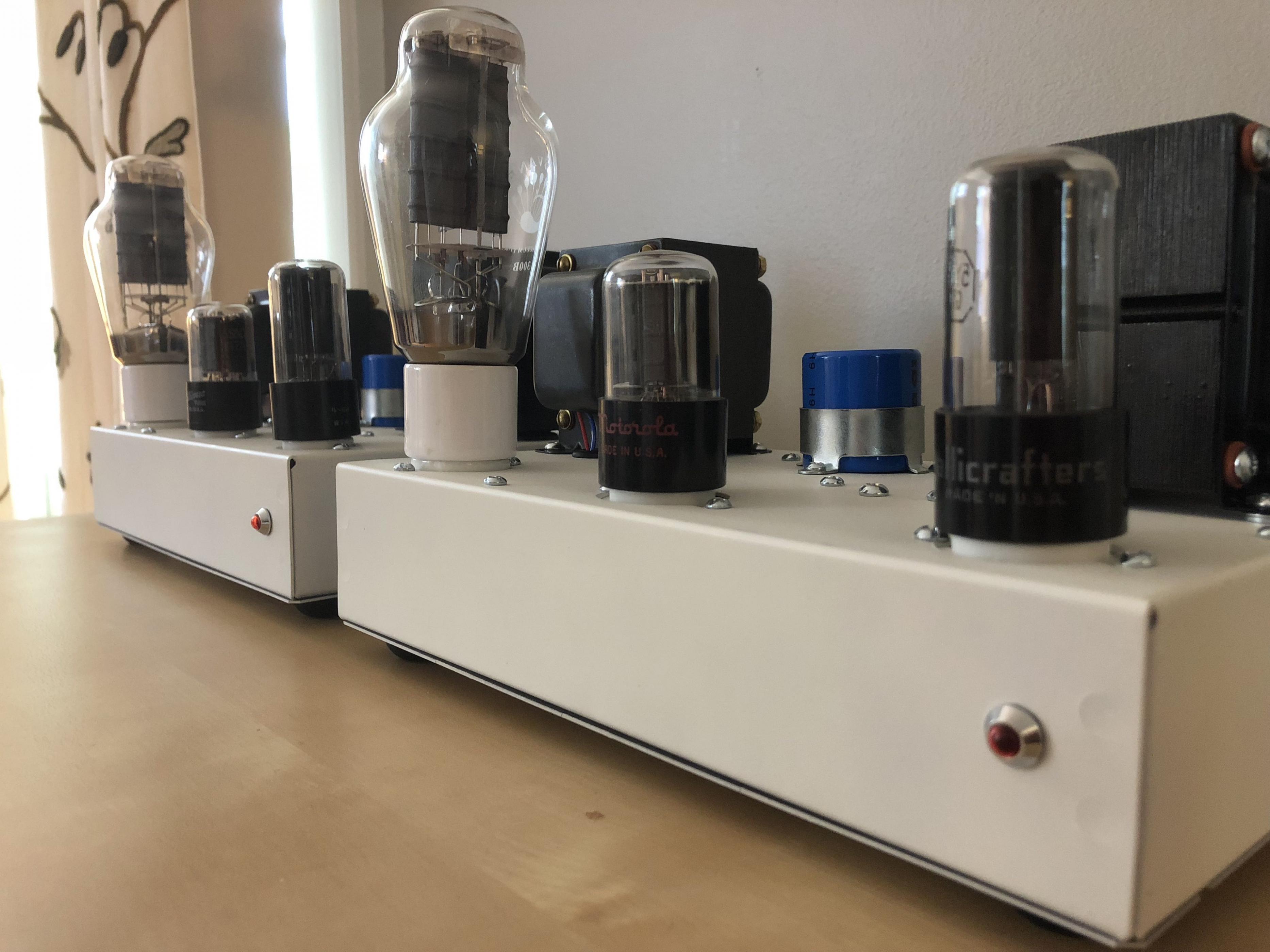

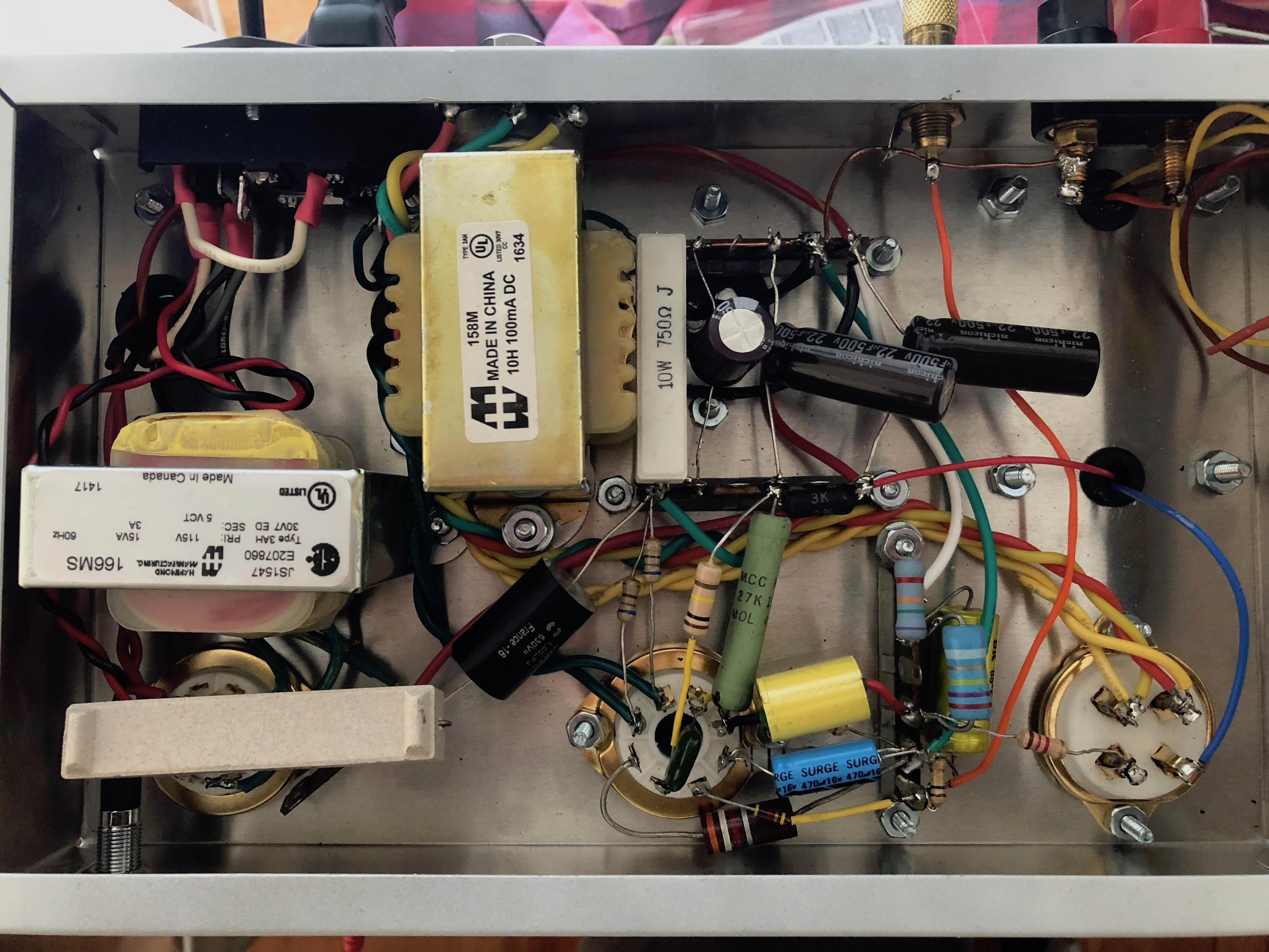

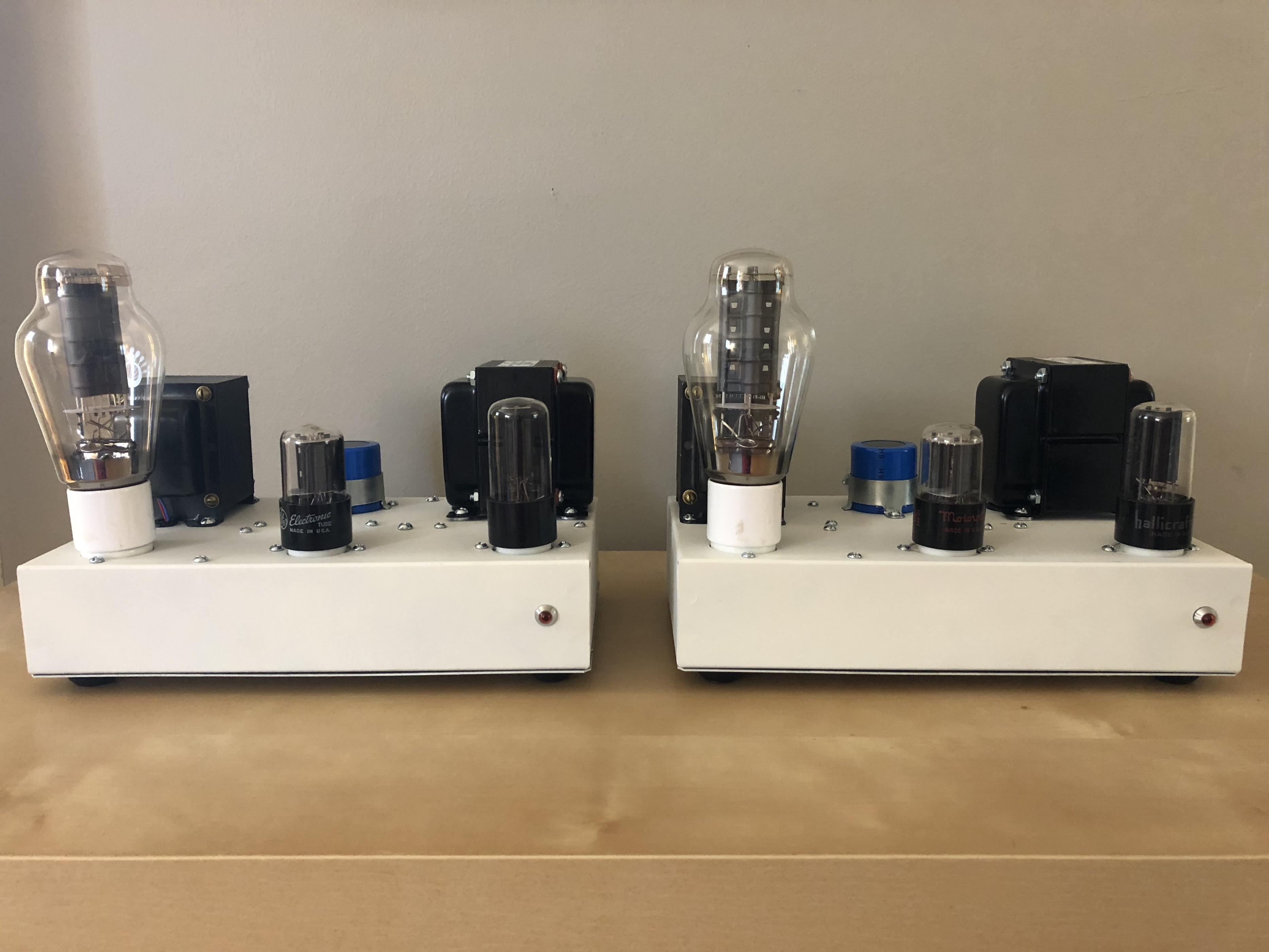

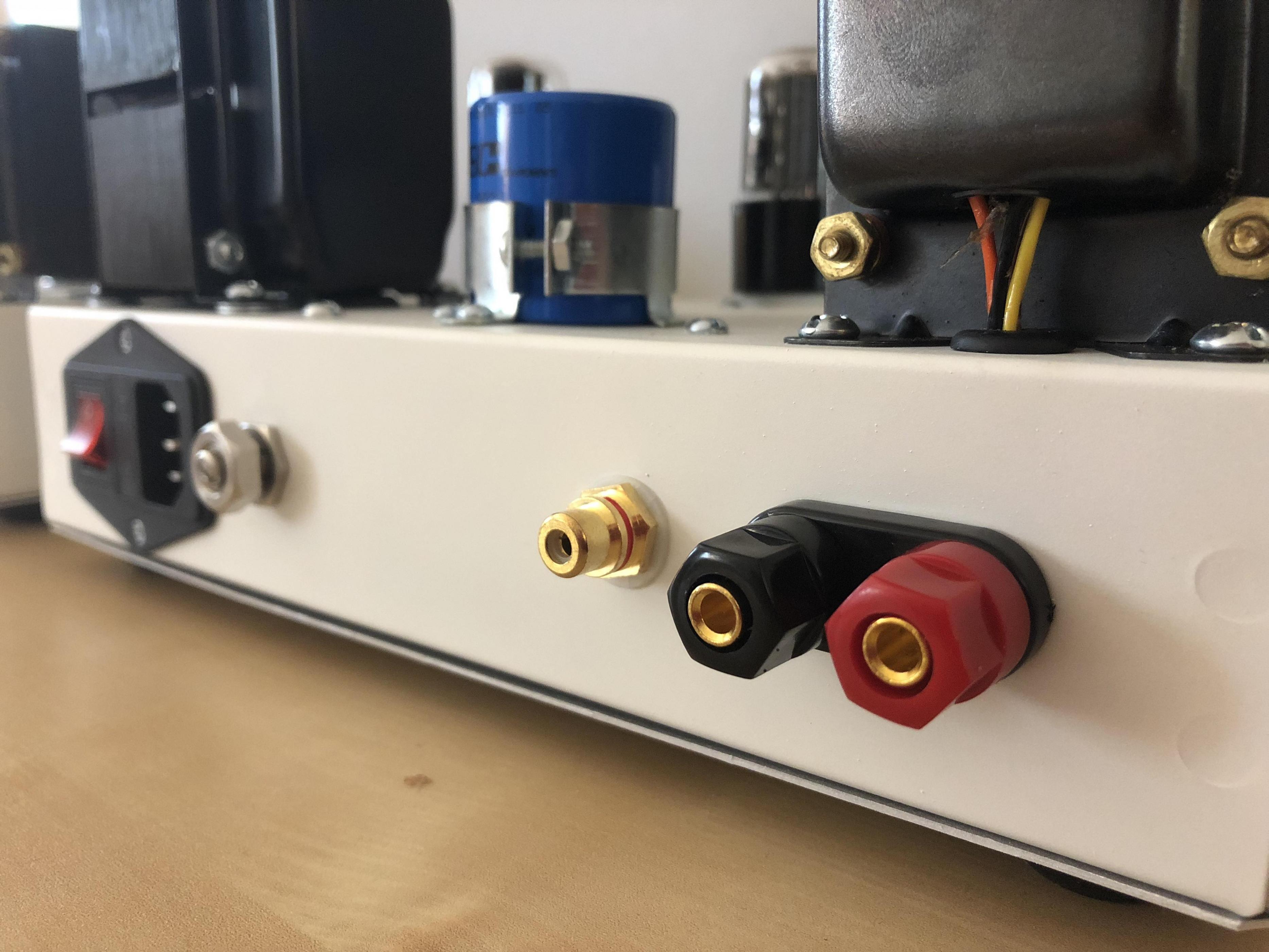

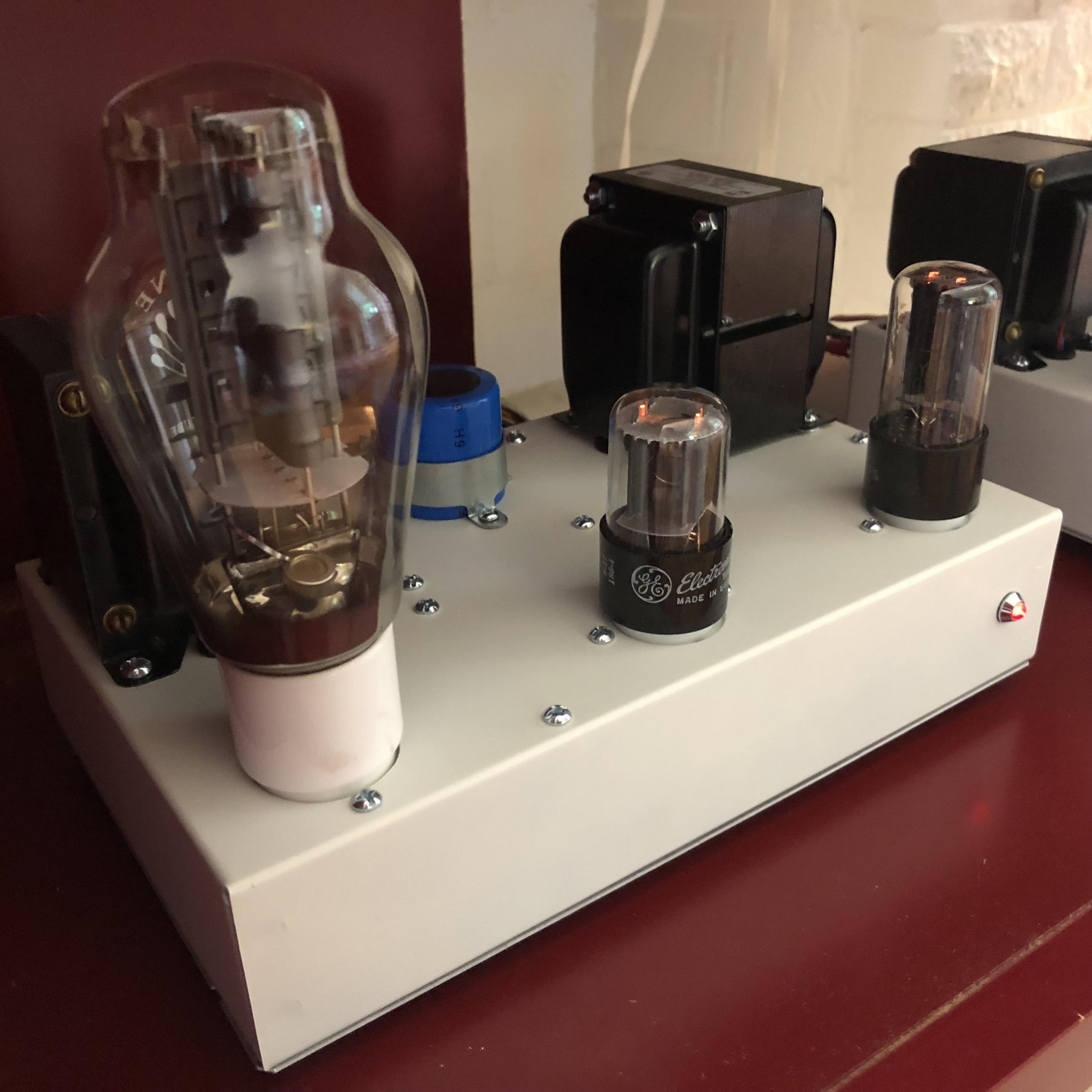

Reverse-engineered Wright Sound Mono 8. This has been a labor of love to recreate the first tube amps I'd ever heard back in 2001. My friend had his pair modified by George to use the Magnequest/Peerless TFA-204 output transformer (instead of the stock FS-030), so that's what I've done here.
5Y3, 6SN7, 300B; B+ 310V, 300B 260Vak/55mA -- so it's basically a 2A3 amp with a 300B stuck in it. *Very* satisfied with the sound, but I'll keep fiddling with the operating points to try and get a higher 2nd harmonics profile for that "euphonic" sound.
Thanks for looking!

Id like to advise You to increase plate current to 80-90 ma and 300 B start sound much better than with 55 ma with wich sound is little bit dry, but You can sense.
Thanks for the suggestion. I’ve breadboarded numerous 300B amps and tried them at a variety of operating points, including above 90mA. To my ears the sound is thick and labored with higher current, but lithe and airy with lower current. My favorite combination was 390Vak/56mA in a WE91A circuit.
But maybe higher current would sound better with higher voltages than I was running back then.
For these amps, the TFA-204 has a maximum DC current of 60mA, so the operating point is limited by that.

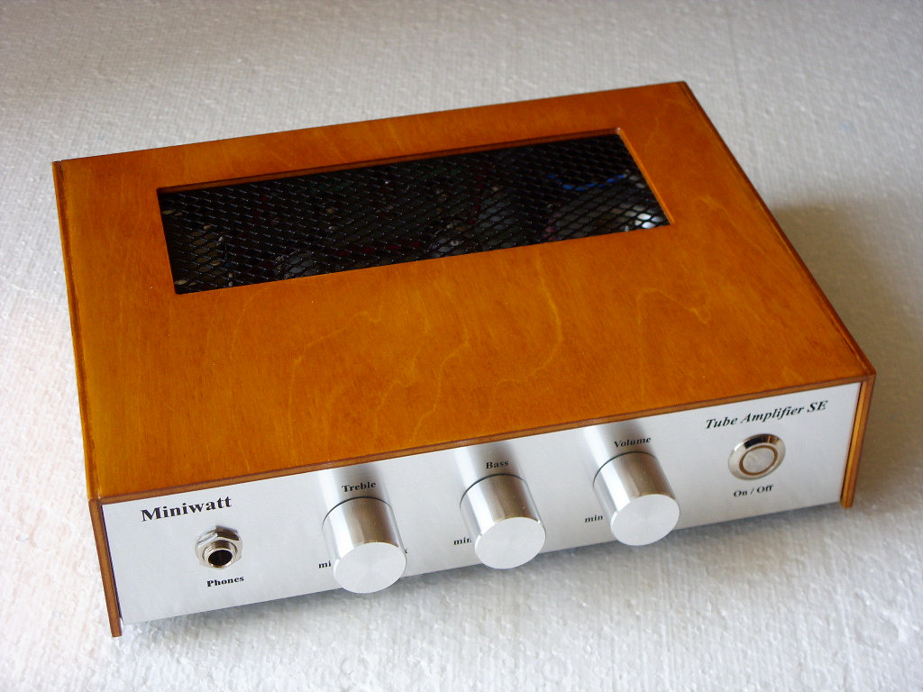

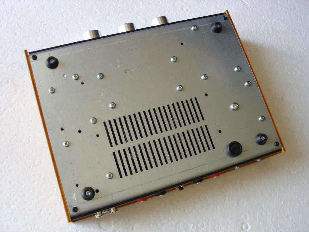

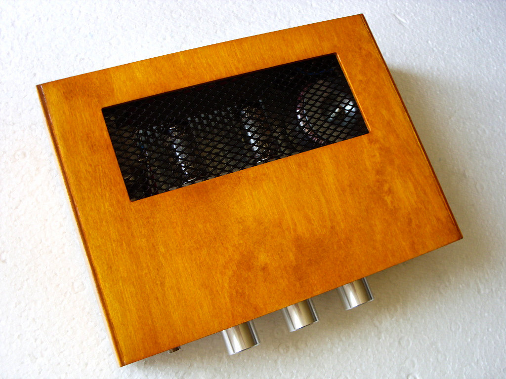

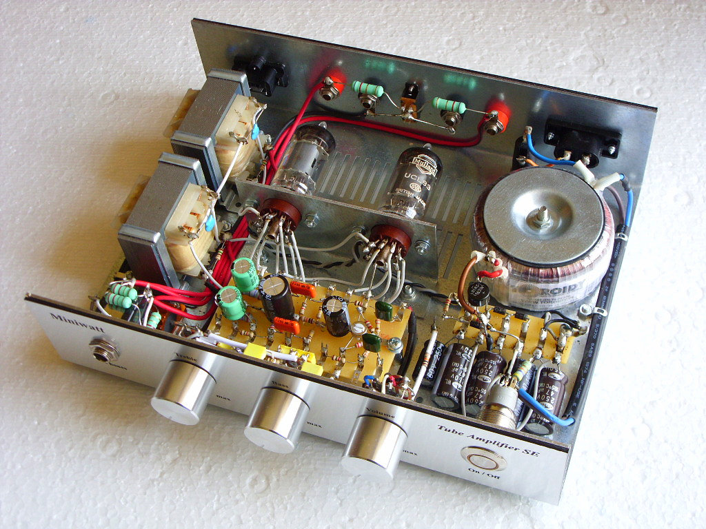

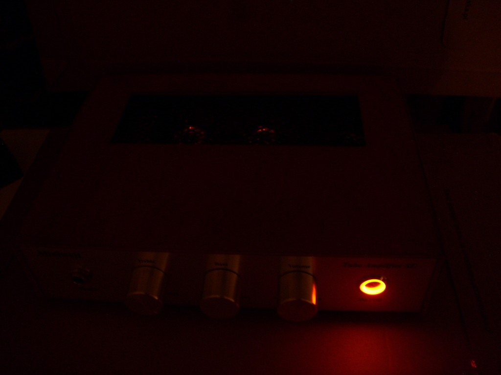

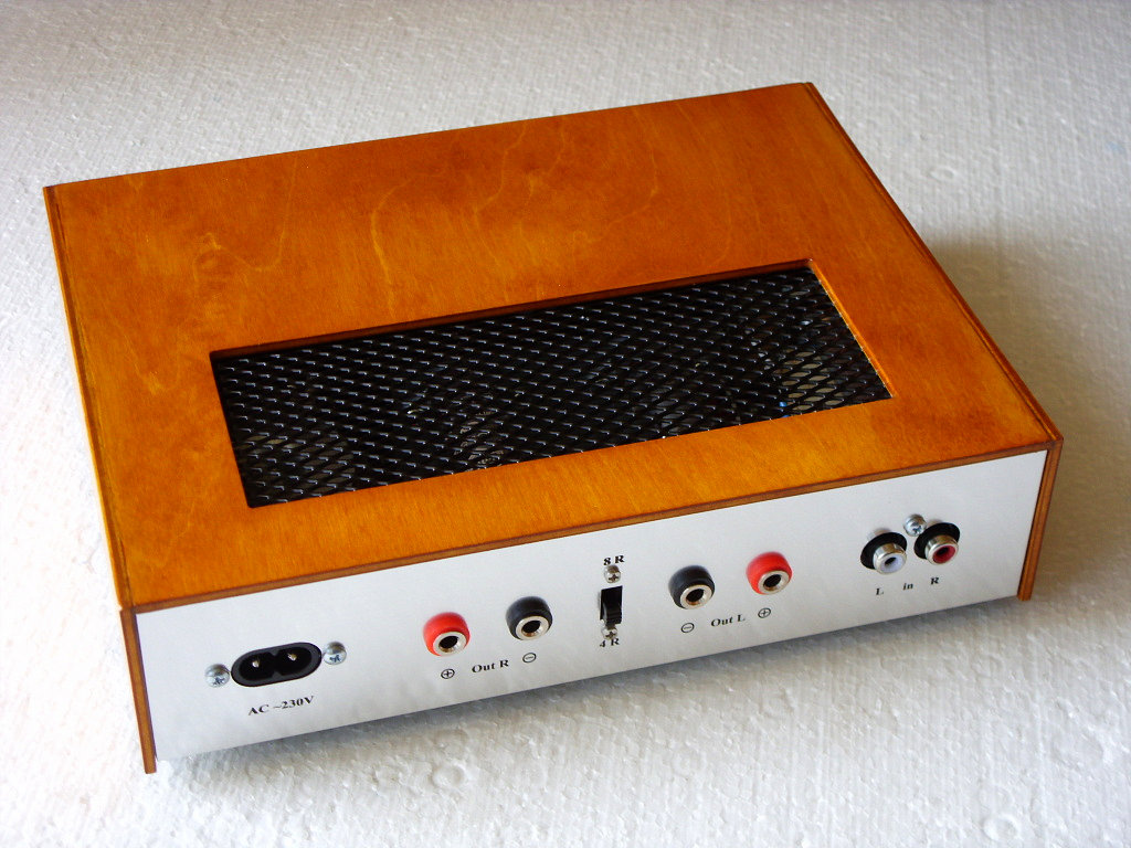

I present my amplifier, 2x2W output power, 2x UCL83 tubes.
just perfect !
The smaller the better!

Nice pair of mono-blocks you get there! And good to know you've got a combination that you are enjoying (at least for now 🙂).

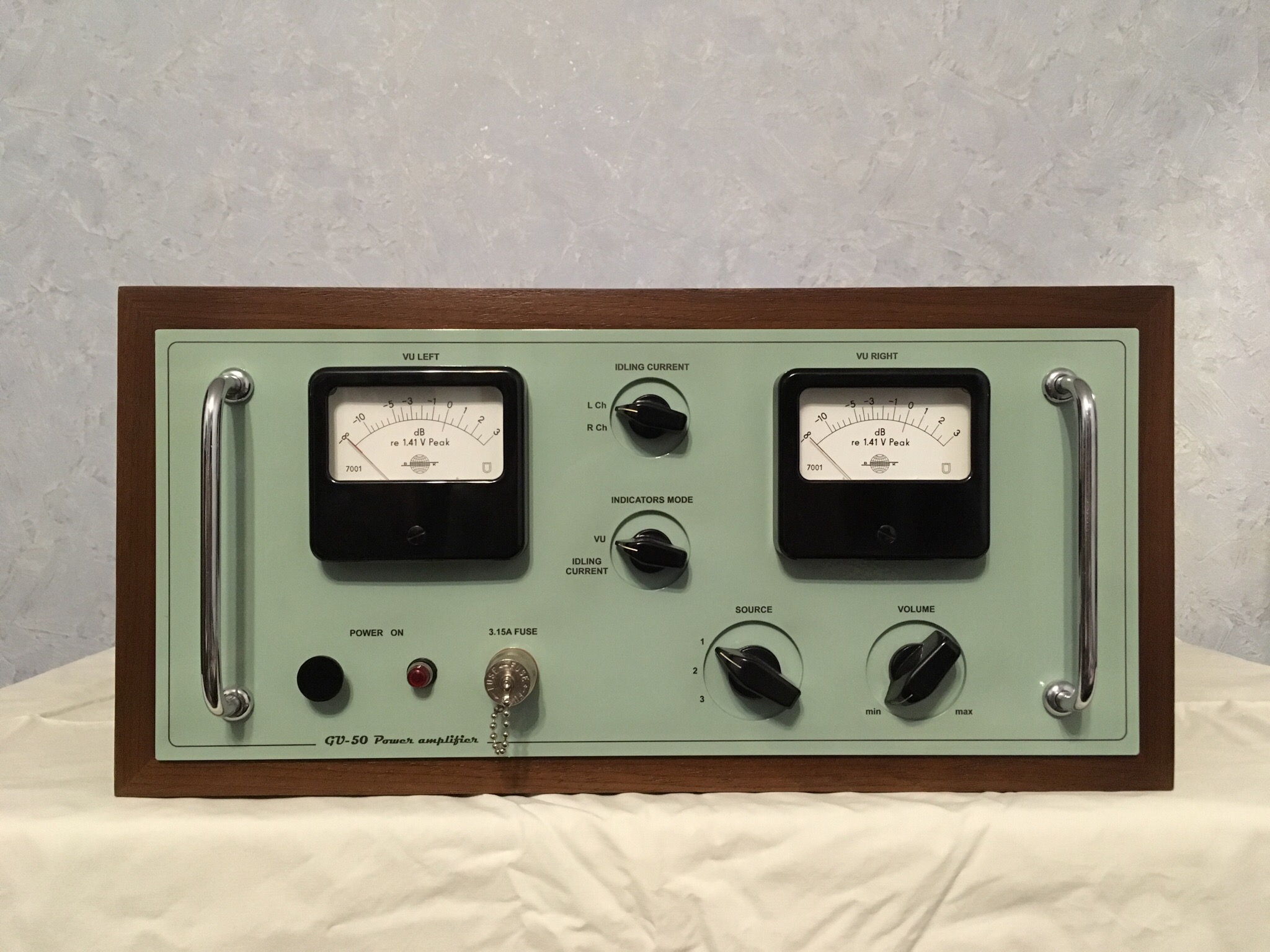

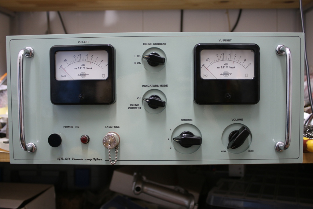

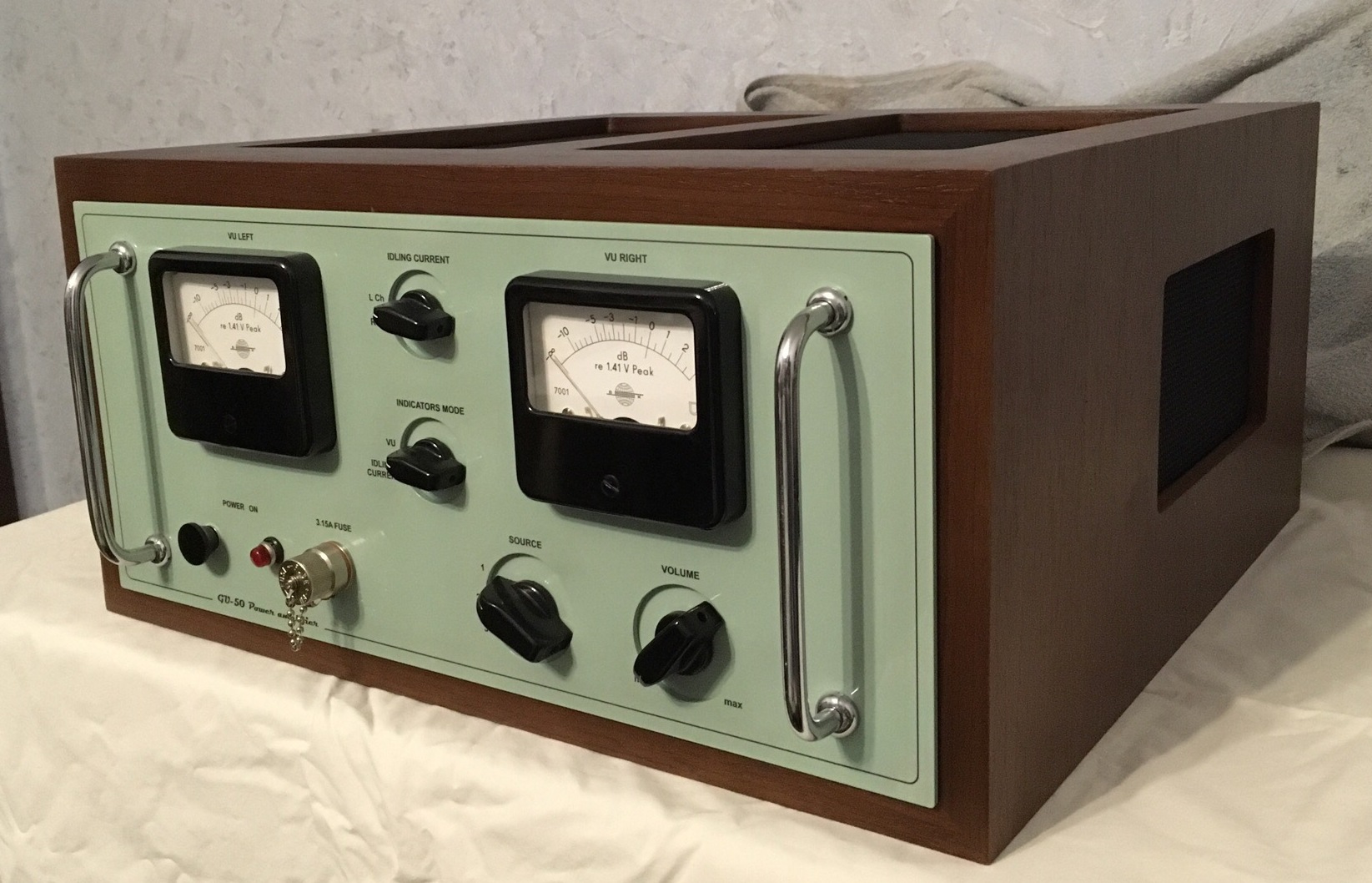

GU-50 Push-Pull
More photos - Страница не найдена - mymegahobby Jimdo-Page!
Very nice , congratulations !! .
Professor, possibly the most well thought out and beautiful amp I have seen. Very, very nice. I bet you spent as much time thinking as you did building.

Thank you! I was inspired by the design of devices by bruel & kjaer =)Professor, that looks extraordinary.
