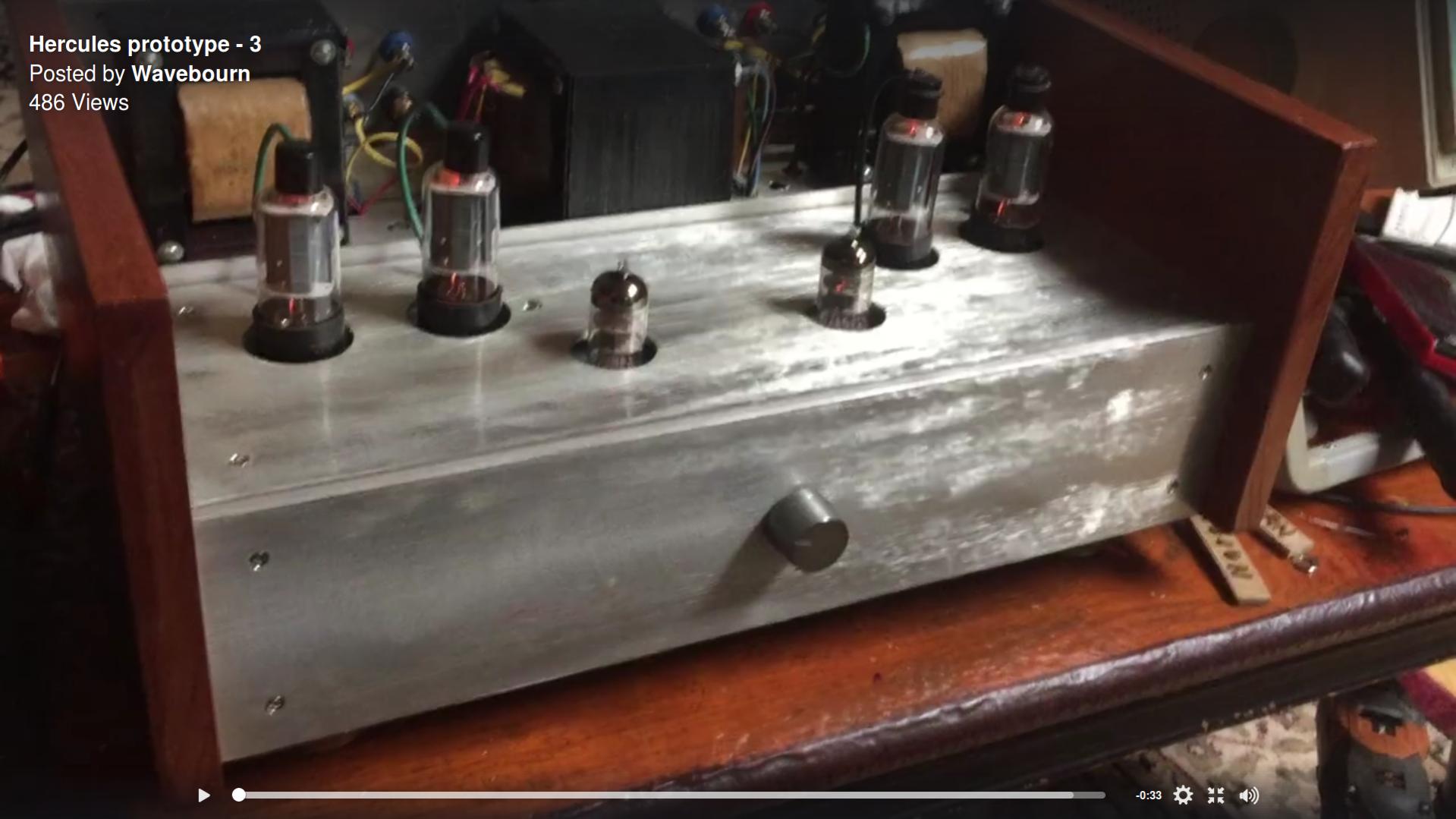

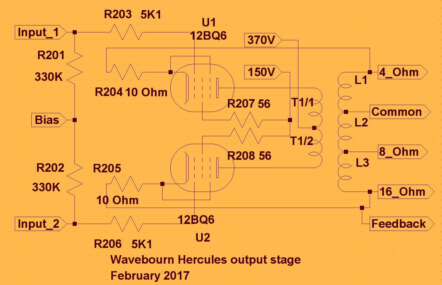

Hercules amp, 2x30W

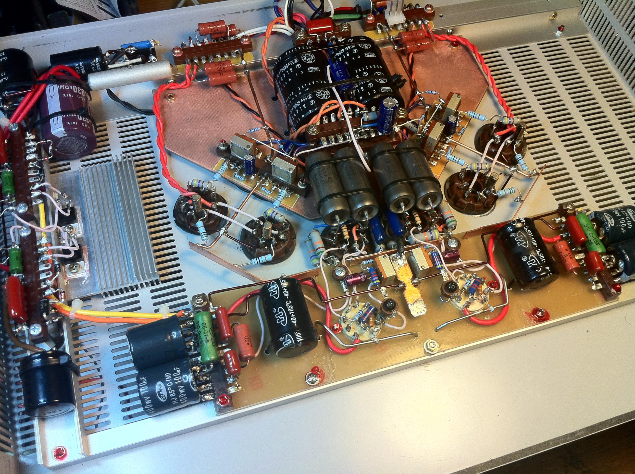

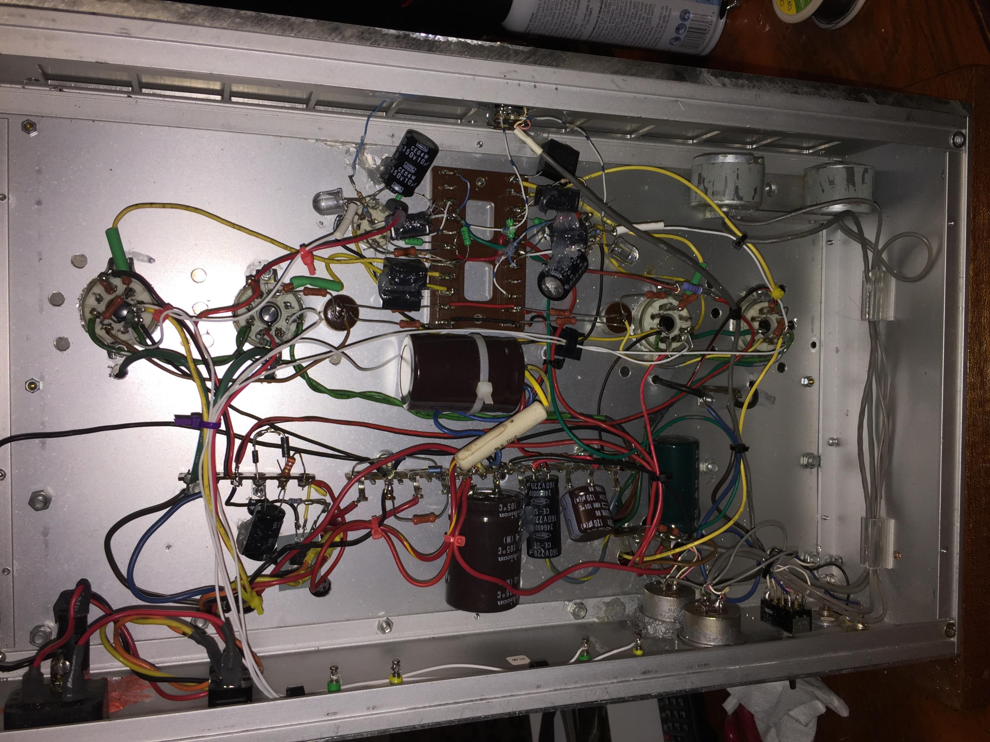

What does it look like on the inside WB?
Caps glued by silicone. Rough, but keeps well and is repairable.
Wow! That is a good idea. Will remember this.
Some mechanical damping as well ?Caps glued by silicone. Rough, but keeps well and is repairable.

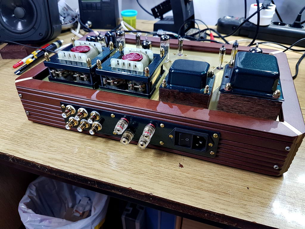

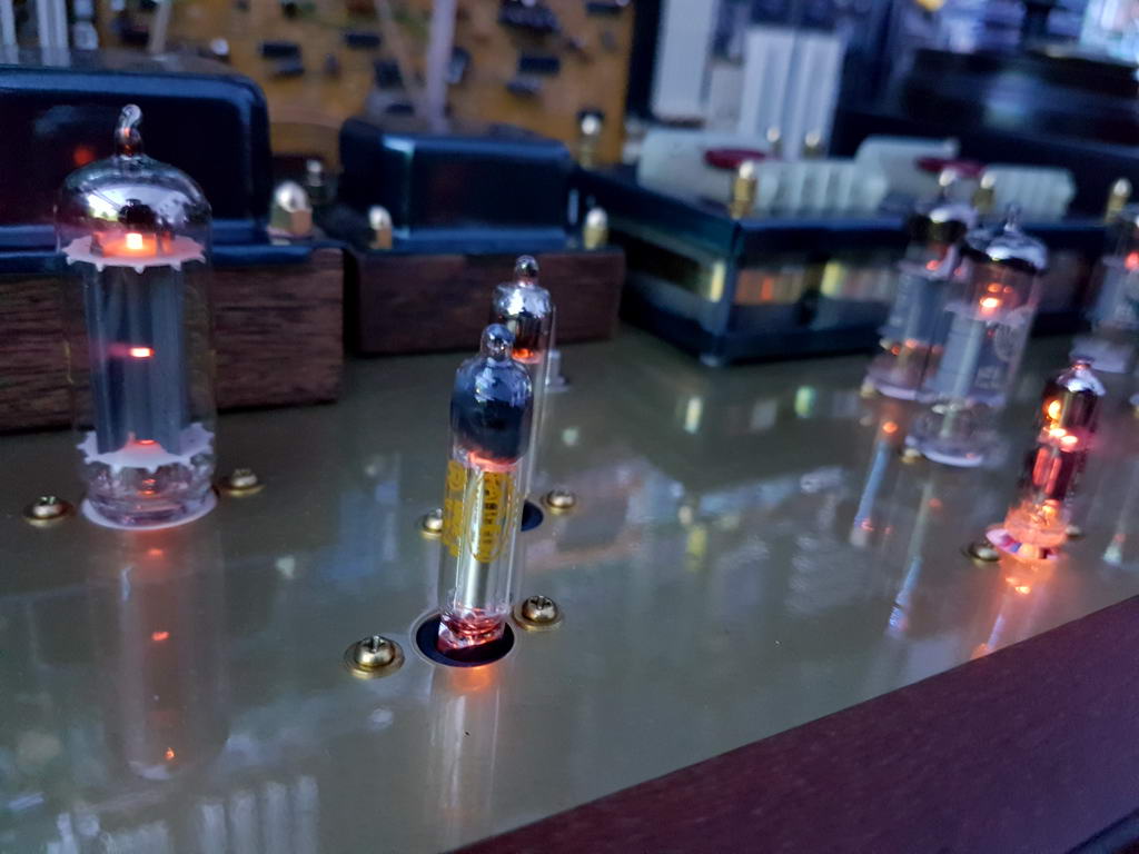

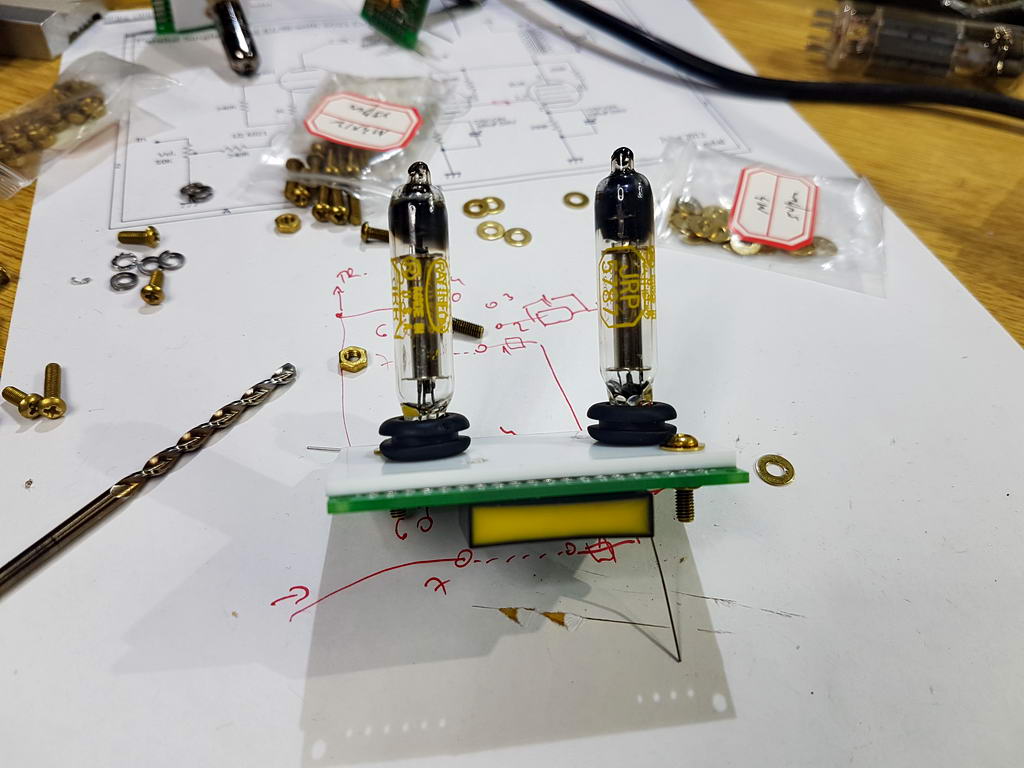

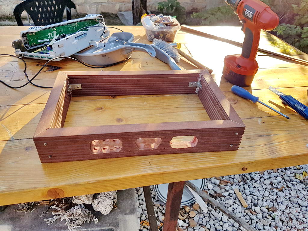

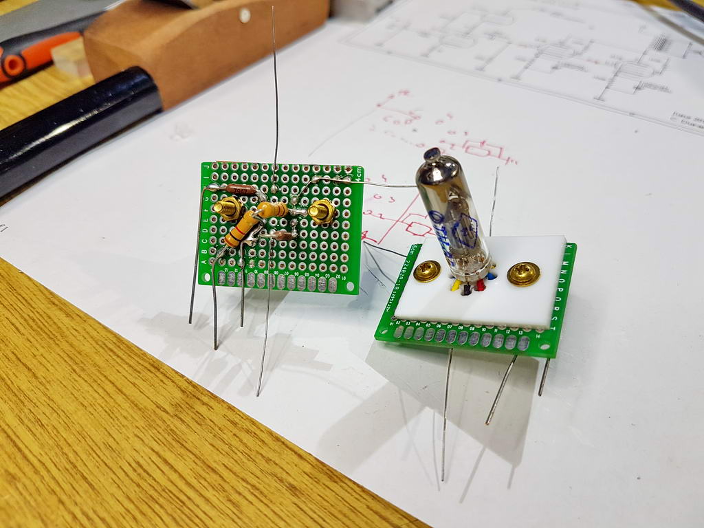

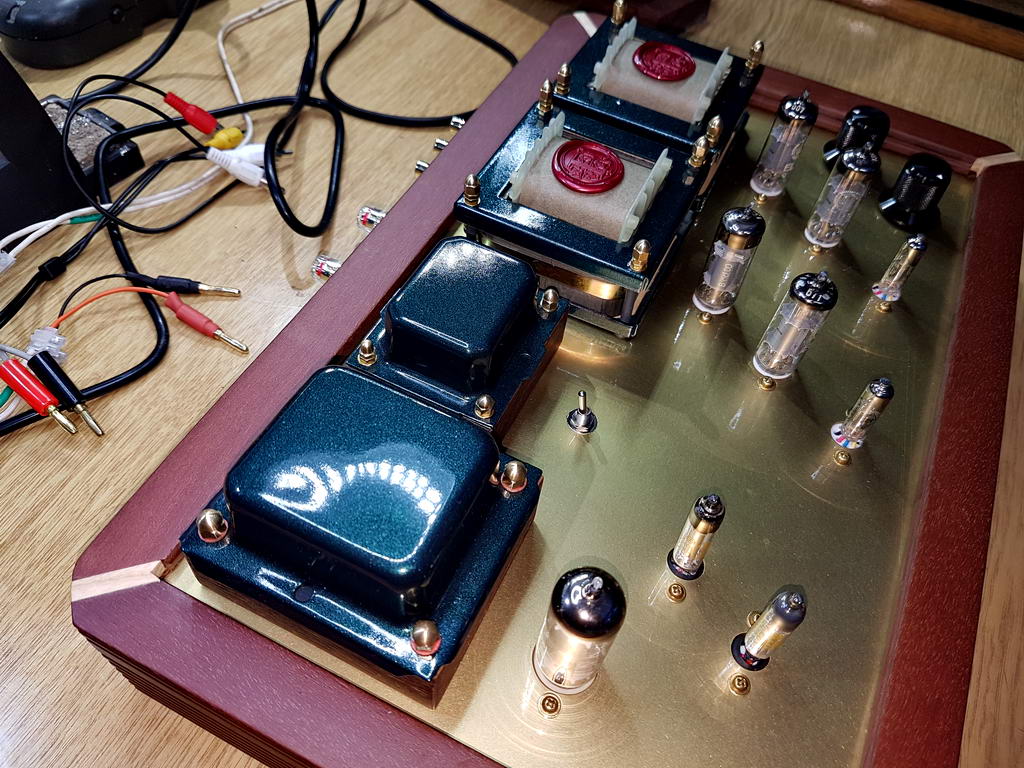

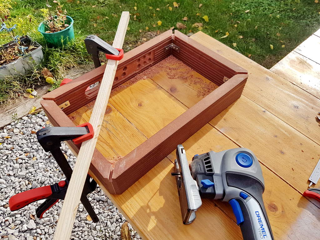

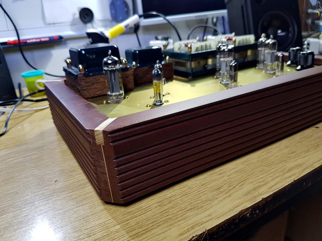

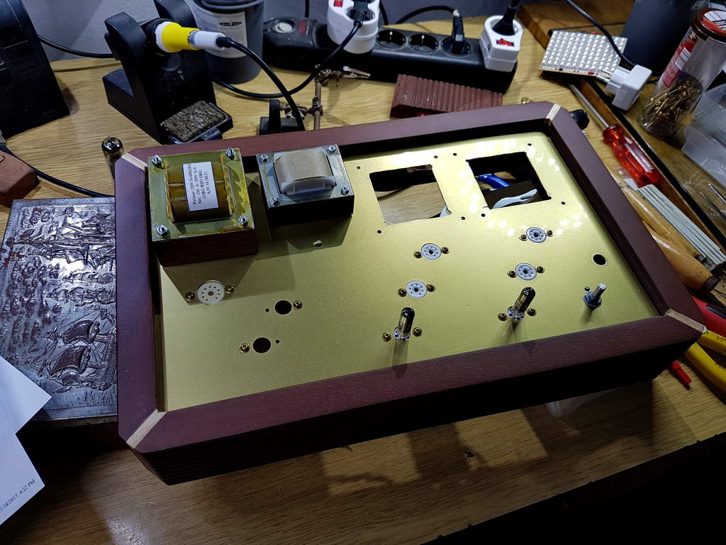

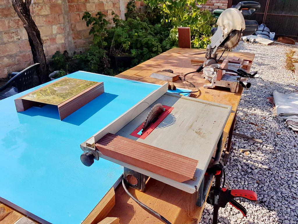

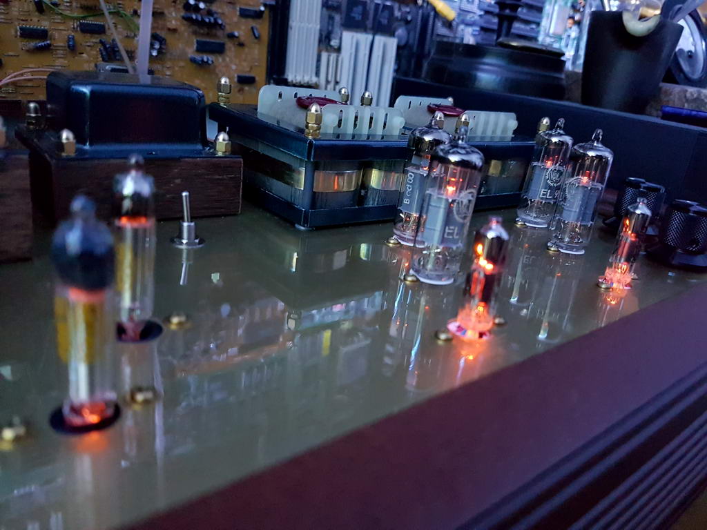

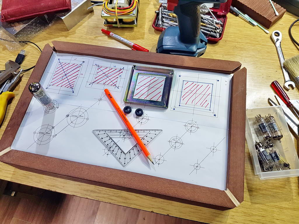

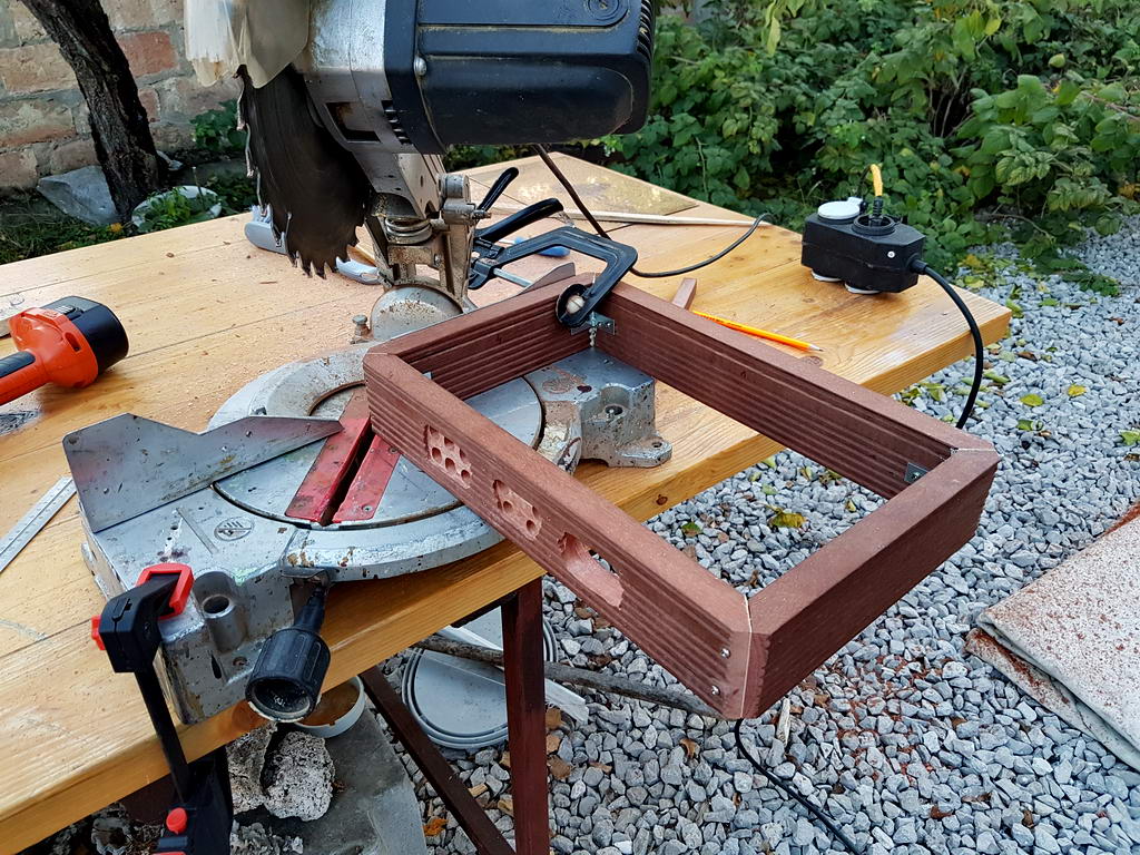

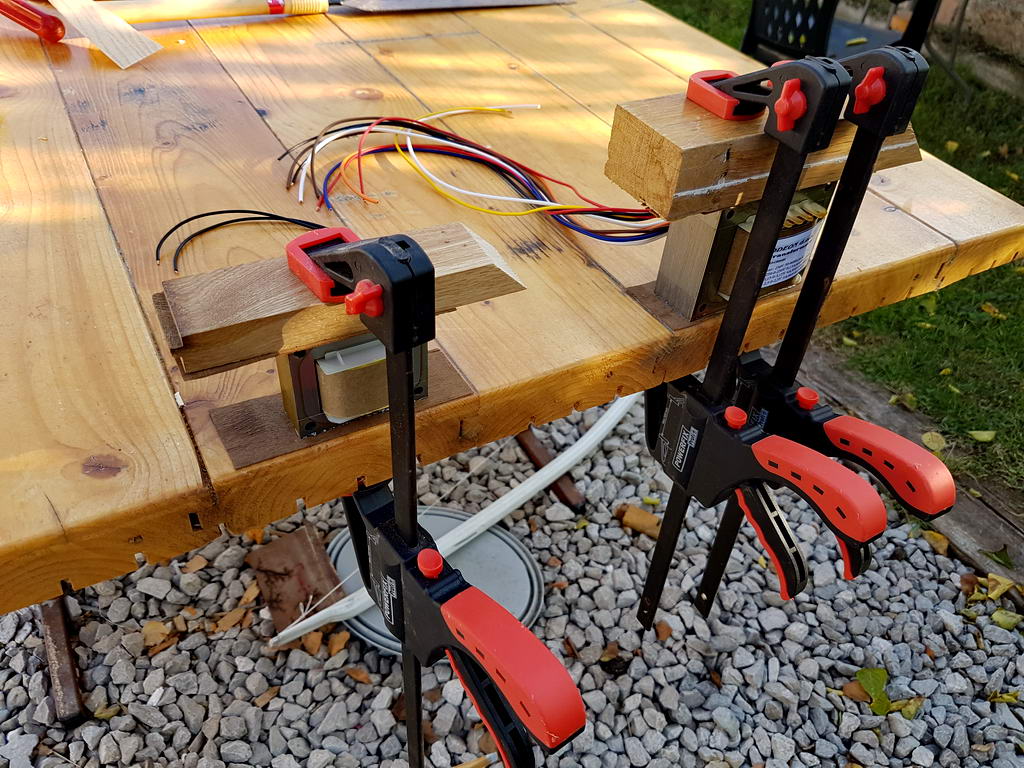

...small but heavy EL95 PSE with 6N16B in drive and EZ80 and two 5787WA VR`s in power supply... output transformers made locally, UL tap, 4k5 primary... amp schematic is basically Lorelei EL95 PSE (google it pls.), and psu was made with tube full wave rectifier followed by CLC to the output tubes, and added two 5787WA VR`s in series to get 200VDC stabilised for driver tubes... not to brag or anything, but I didnt expect much (more like made it for fun and practice), but I stand corrected.... this thingie SINGs (not too loud, but sweeeeeeeeet)...
UL mode is soon-to-be tested, dont have to say much about it right now... expected power is cca 2W in triode, and close to 4W in UL (I was told, I suck at calculus but like to make things )

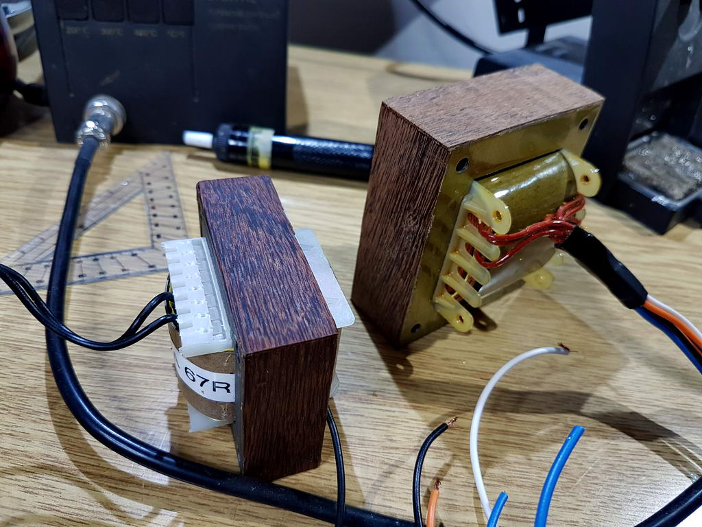

Great job love the brass acorn nuts on the transformers . What value is the choke and from where ? Regards...and a few more
thx
the choke is 8H 200mA 69R and was wound locally by the same guy that made the OPTs... I had two chokes done earlier for another project and used only one, so this one was at hand and already payed for so....
Yes, but not for the production. Ok for a prototype, when it needs frequent tweaking and change of schematic.

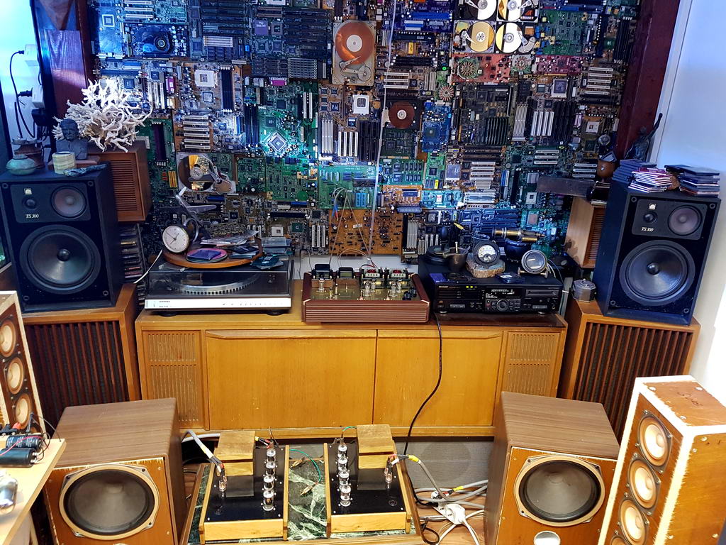

Awesome man-cave! I'm coming to same thing: several amps, several pairs of speakers. .. can anybody suggest any good amps/speakers switch? to vary the herd.
production?
production?
Even if it is DIY for yourself only, final version should be more accurate. However, I remember one guy in the laboratory I worked, made a breadboard of a reproduction amp for a tape recorder. He dipped the whole breadboard into an epoxy compaund.
