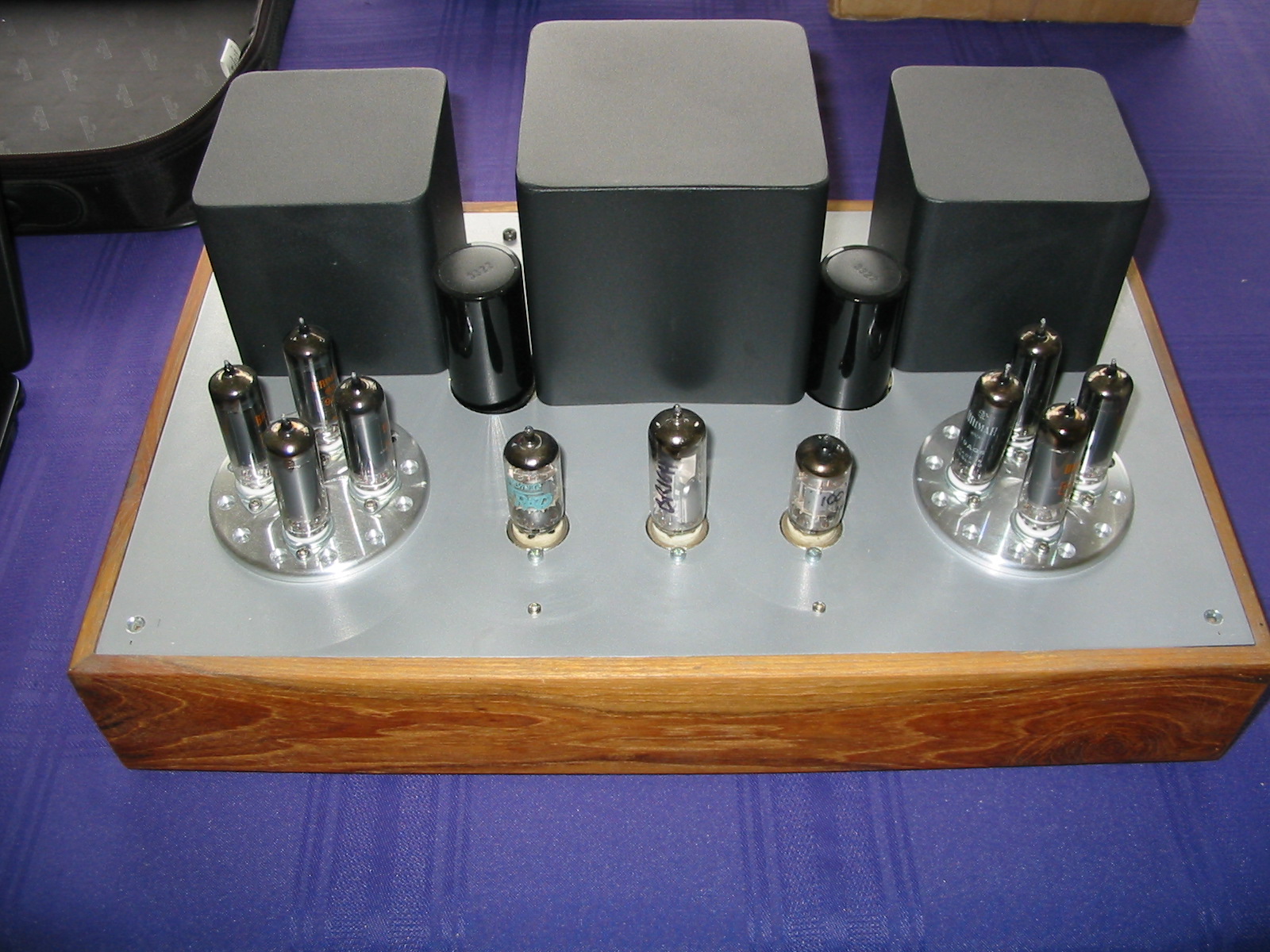

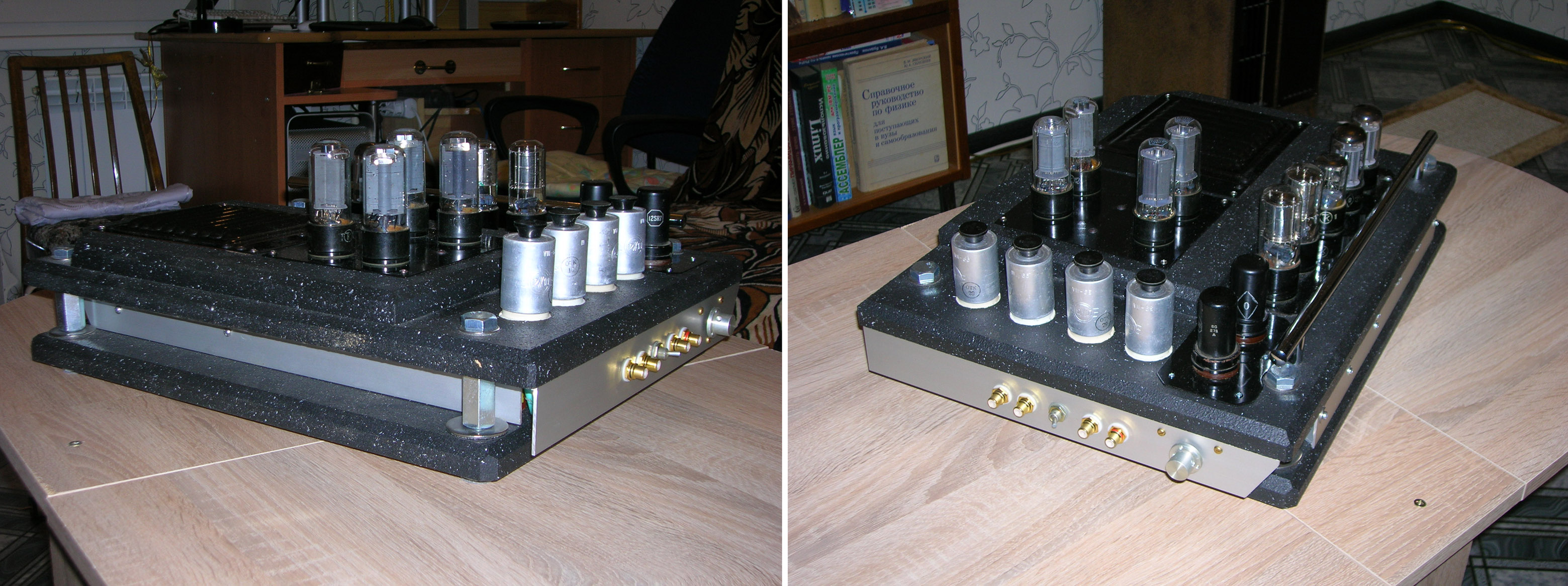

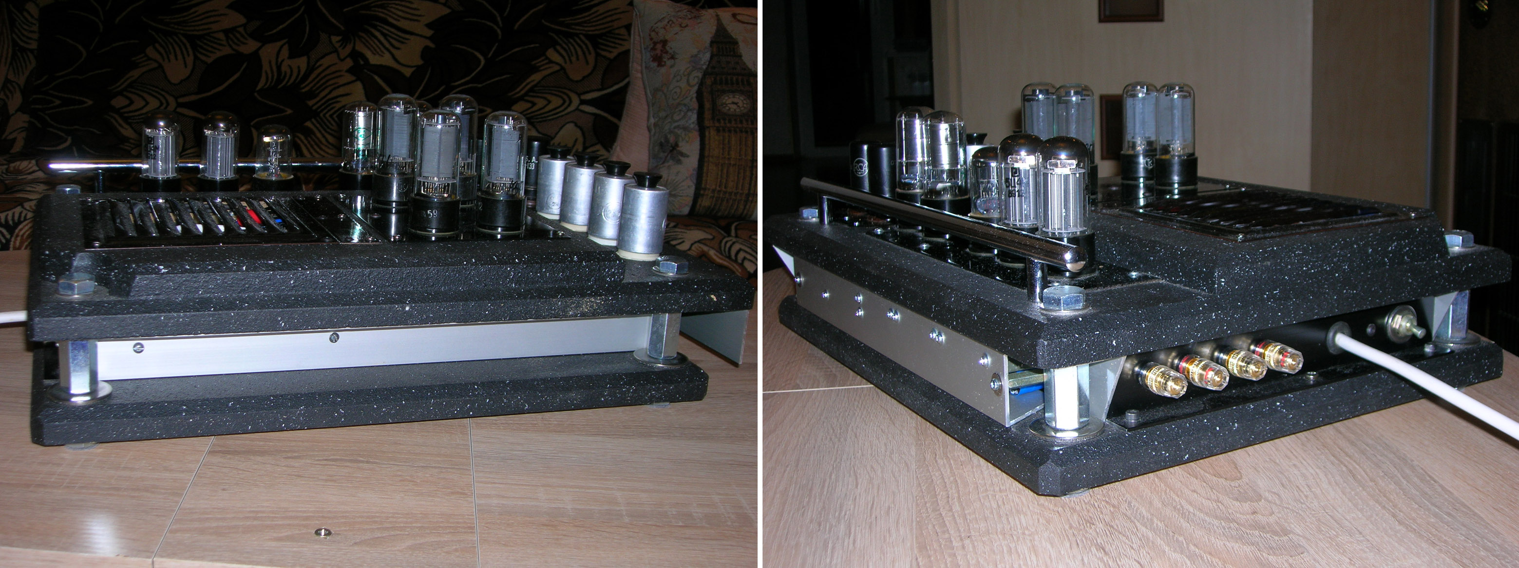

Grid metal boxes for pencils for 1$. OTs are my development with South Korea iron.Very nice amplifier, curious as to what OT's you use in some kind of metal enclosure, which looks very nice.
One more New amp /now in USA/ PP QQE03/12 with pencils box for PT /for cooling/. Gas stabilization 6G4S Russian for second grids. 10 W per channel.Grid metal boxes for pencils for 1$. OTs are my development with South Korea iron.

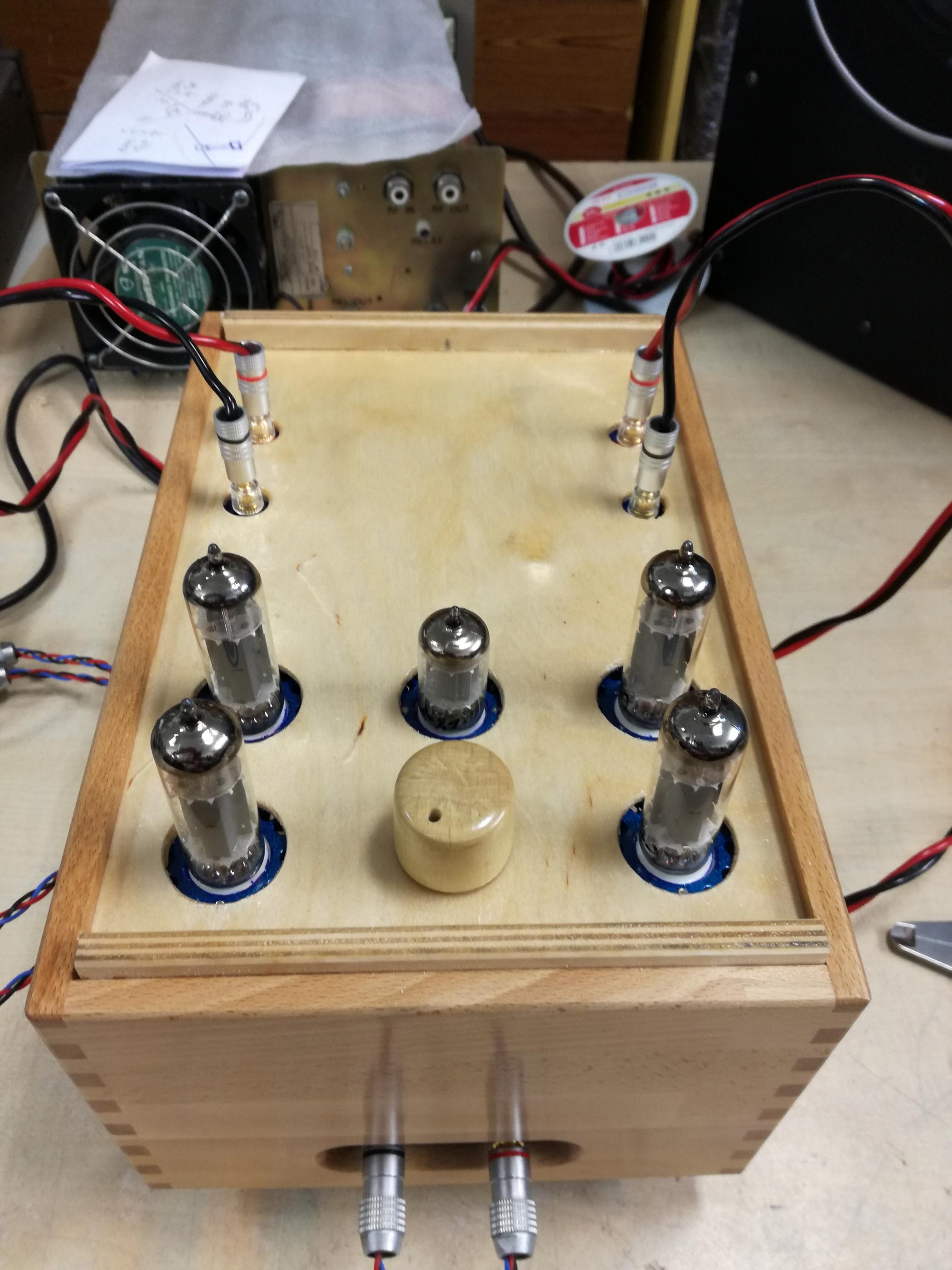

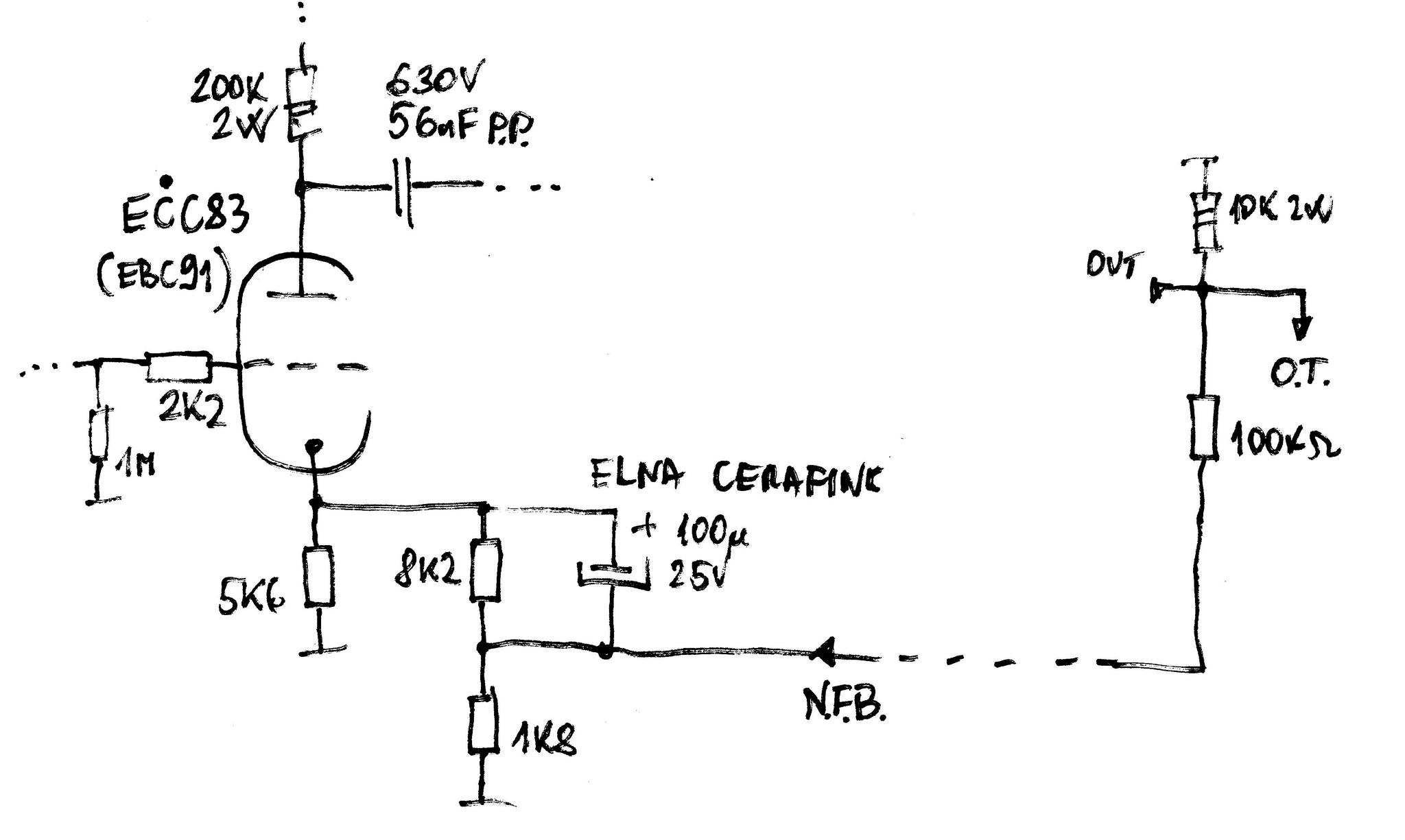

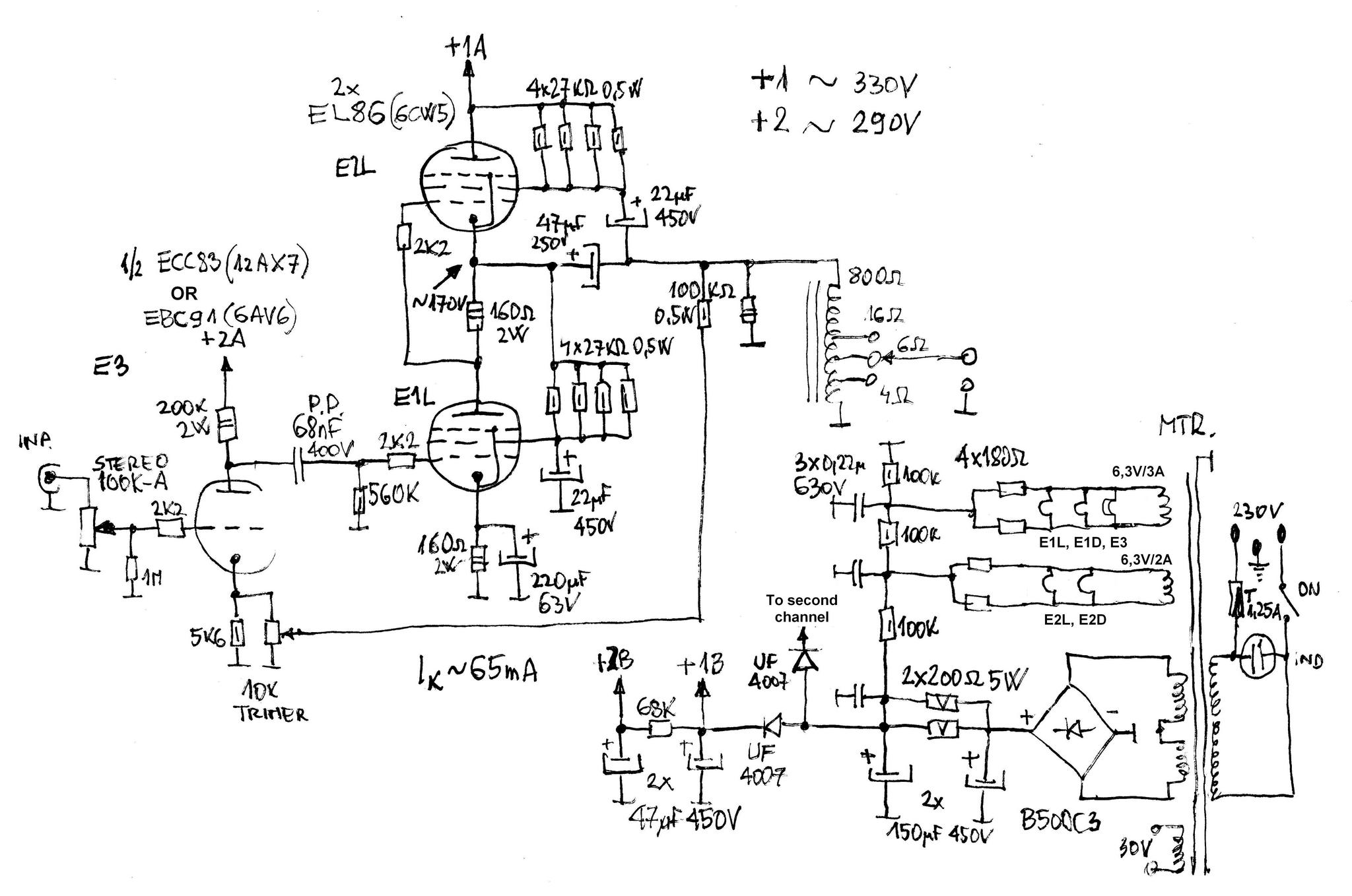

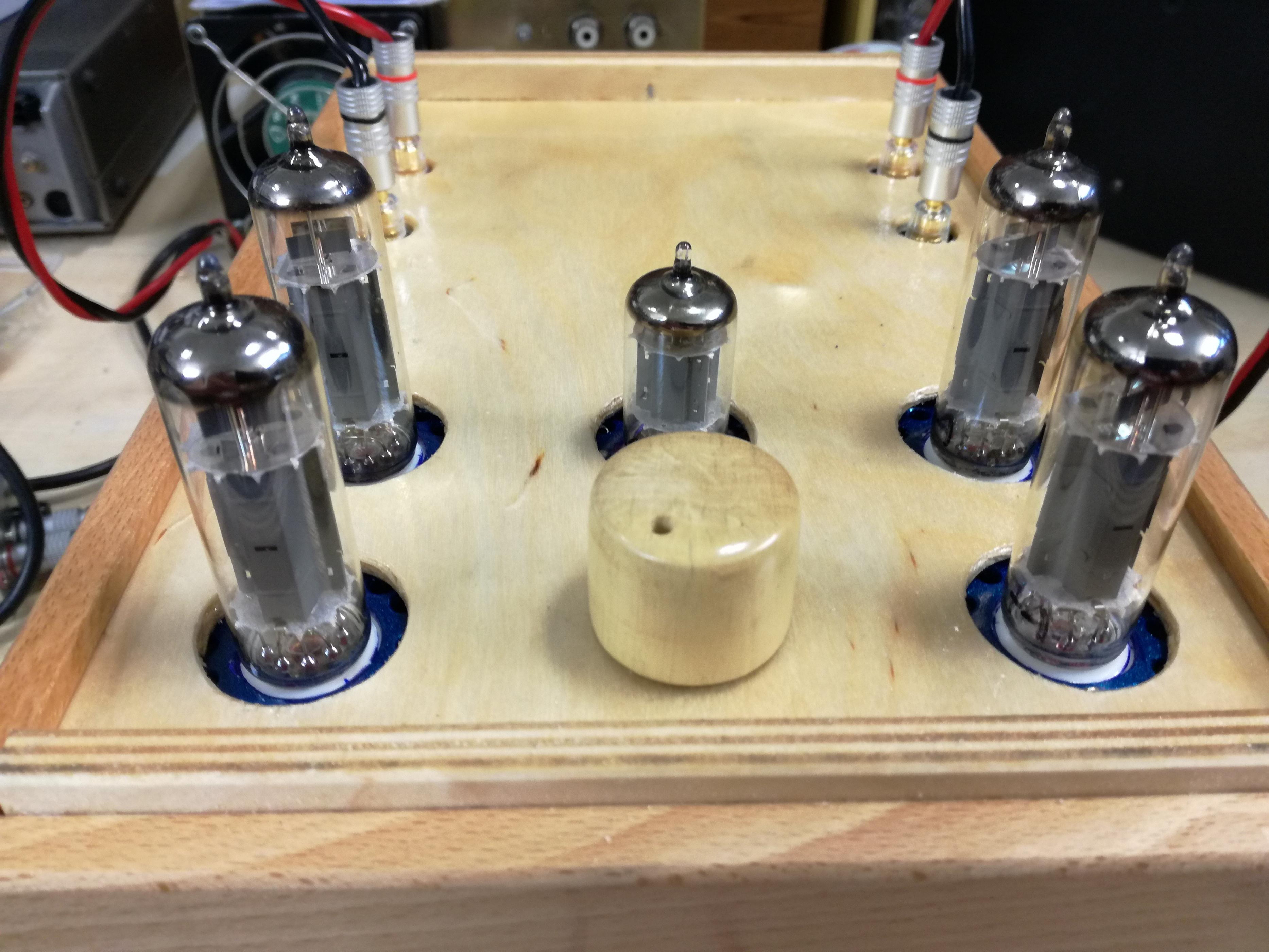

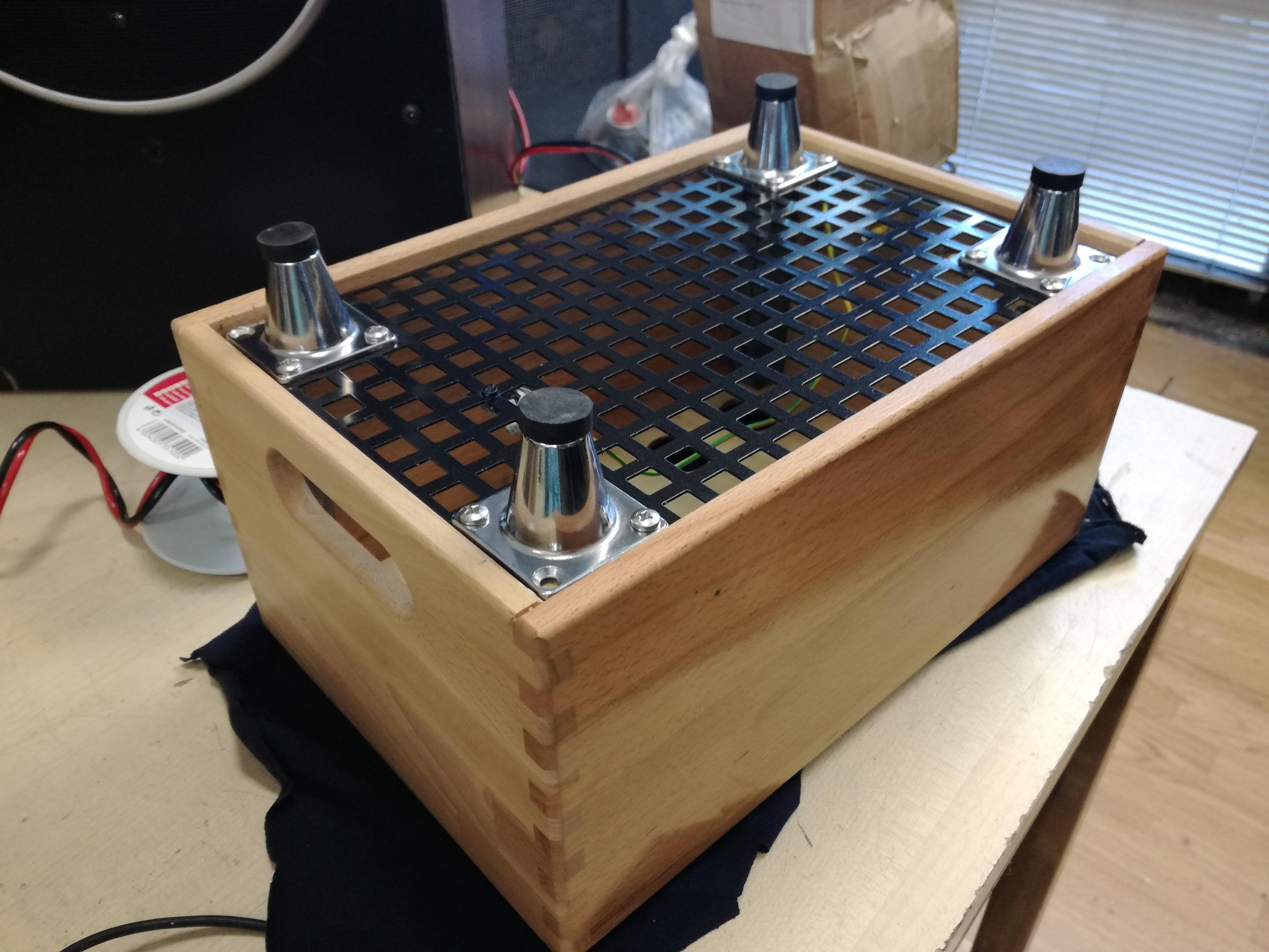

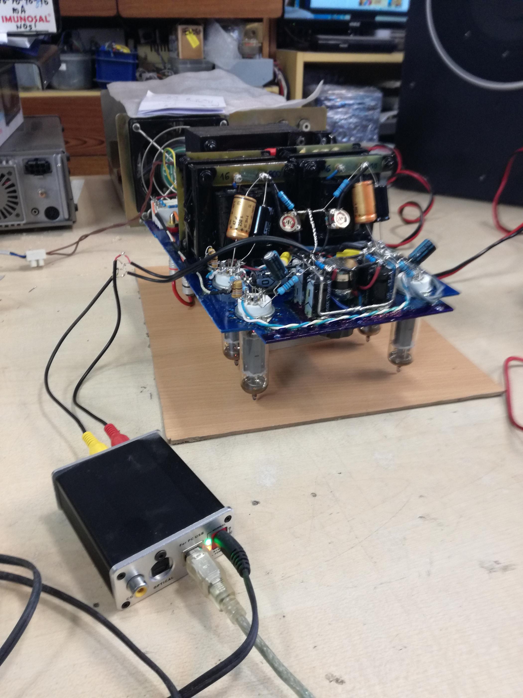

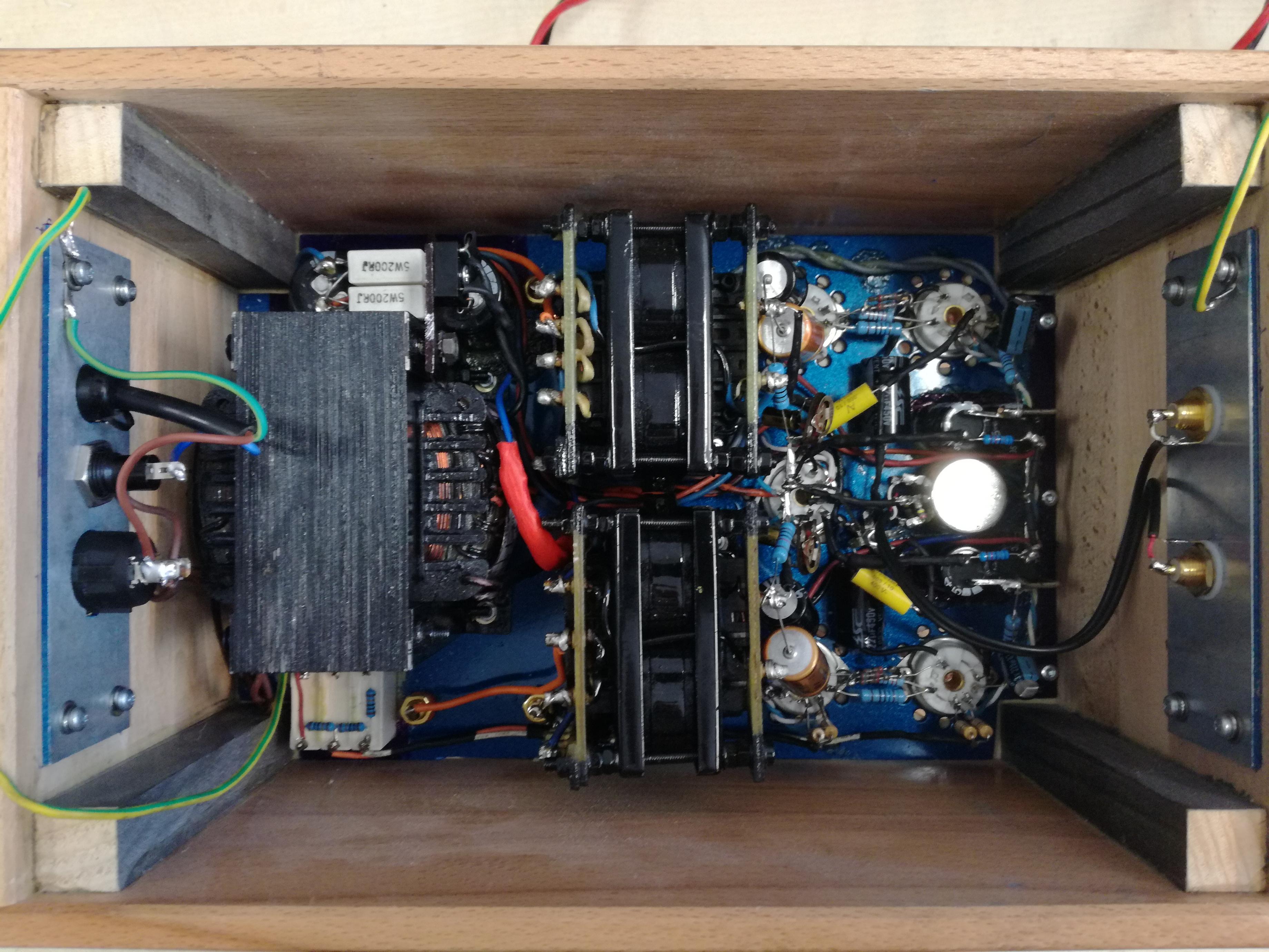

Small SEPP amplifier:
Beautiful work! Excellent wood work, one think I would change if these nice looking amp (case) would be mine
I dont know what is the purpose of the Baltic birch, I would remove that from the top... I would hide that under the cover plate etc., the whole thing made out of nice solid wood and that Baltic does not match the rest of the case, for that reason I would hide that from the top. If is not possible or if now is too late I would use oak would veneer to cove the edge of that Baltic. These is my opinion only
One more time it is supper nice work, congrats!

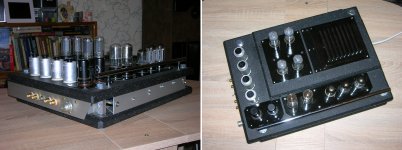

PP amplifier.
Phase-splitter concertina 12SR7, second stage using Russian 12J1L (12Ж1Л) x 2, output stage using Russian 13P1S (13П1С) x 2.
PSU Russian 5Tz4S (5Ц4С) x 2, bias rectifier Russian 6H6S (6Х6С), gas regulators Russian SG-2S (СГ-2С) used to supply the screens of 12J1L.

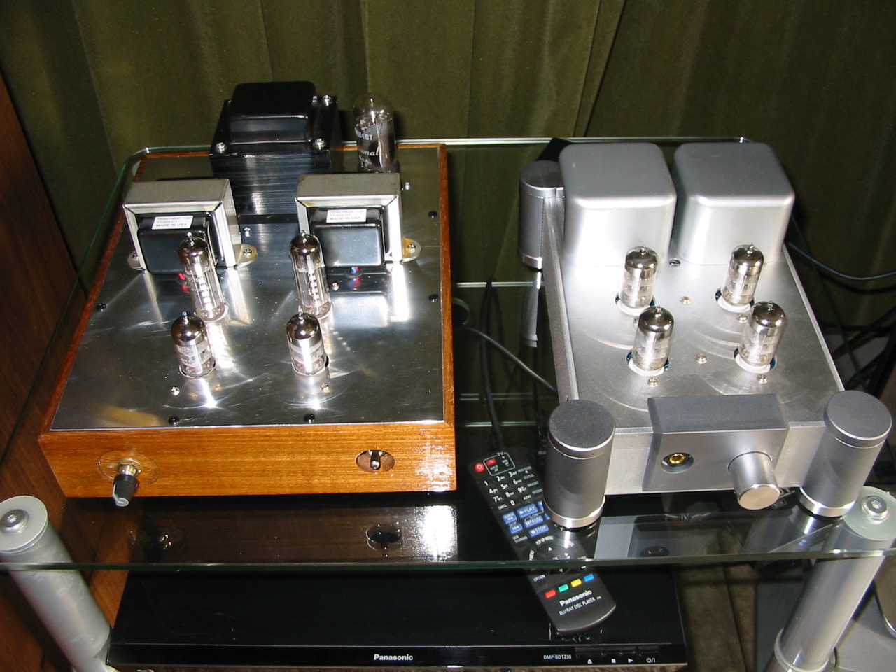

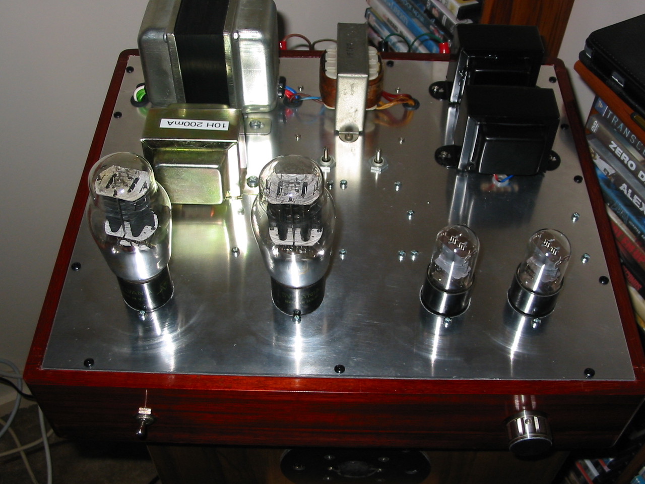

Here are some of the projects I have recently completed, or still in process:
Pic 1: 6A3 SE driven by 6N9S, no feedback. Completed and sold.
Pic 2: 300B SE driven by 6N8S SRPP, running but not where I want it yet.
Pic 3a: 6360 tetrode PP, driven by 6N2P. Completed with a nicer knob now.
Pic 3b: Shanling 6N3P buffer/headphone amp.
I stripped out a faulty Shanling CDT-200 transport and re-used the tube buffer and HP amp PCBs, mains transformer and choke. Found a lookalike mini chassis on eBay and squeezed it all in. Built but not yet running.
