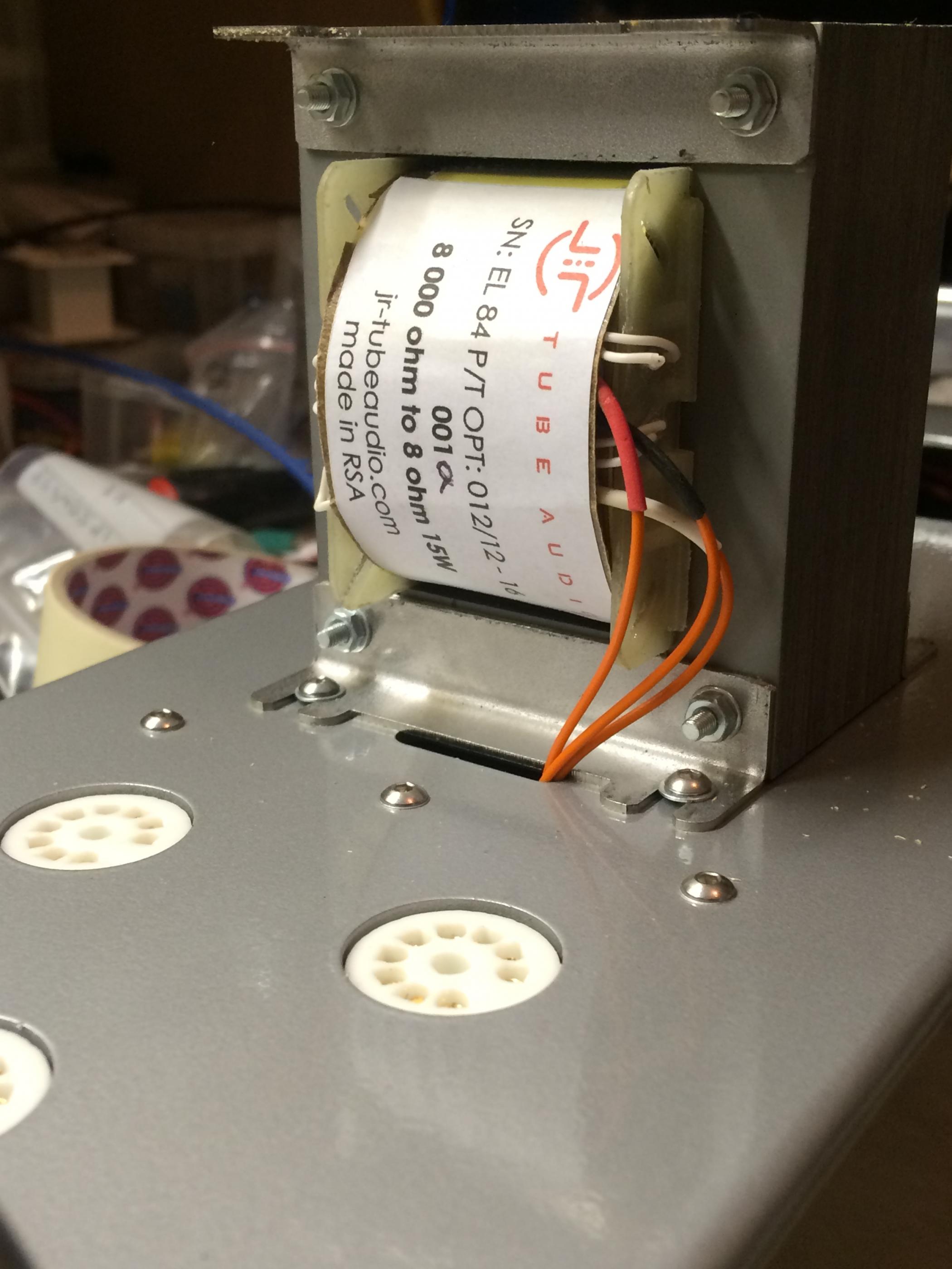

Push pull? What is the power output?
Yes, push pull. 2 x 15 Watt in pentode mode, 2 x 4.5 Watt in triode mode.
Flat from 24 Hz to 70 kHz at full output.
Great! What OP transformers have you used ?
FX200, you did an excellent job!!

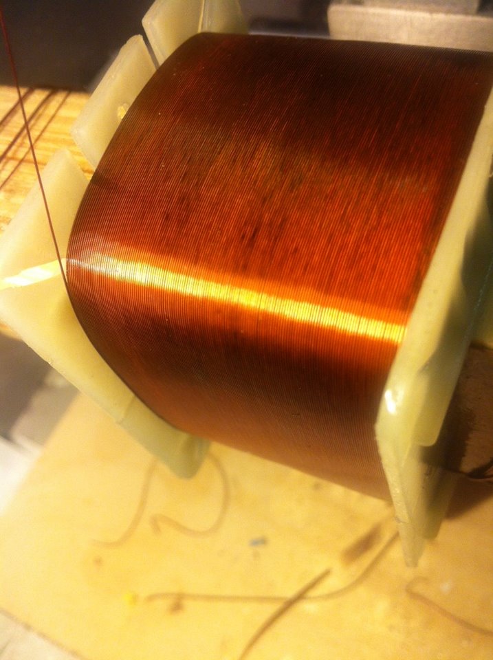

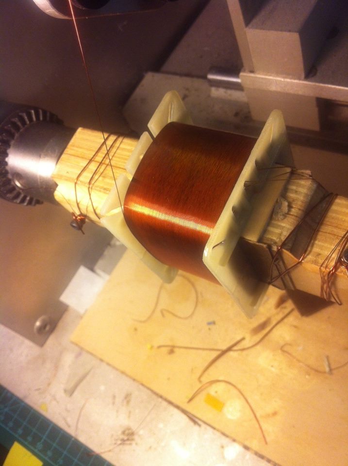

I wind them myself, using an EI 85 x 42 mm stack for wider bandwidth.

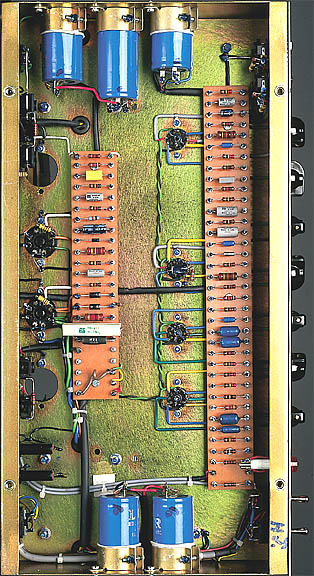

It is not mine; I found the picture on Facebook and attached to show how to wire tube gear properly. The amp was not designed for military vibrations, but PCBs and resistors were oriented properly, for better heat dissipation. It is a Soviet school of design.

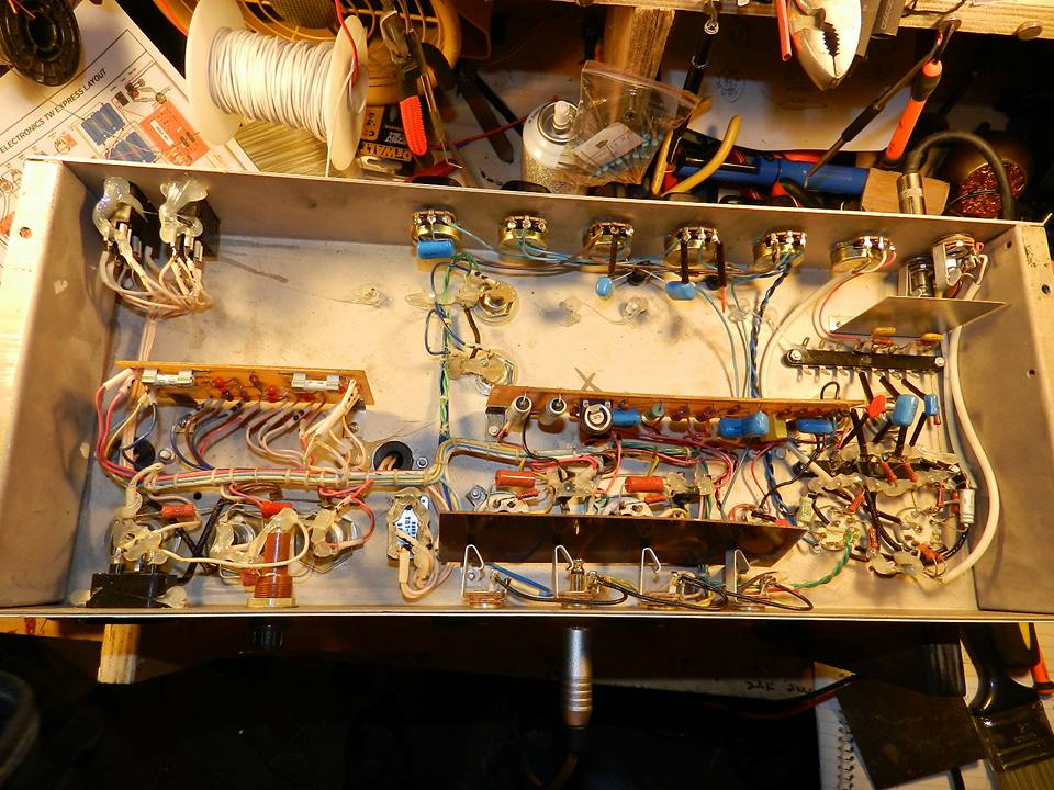

Harry Joyce was one of those military style builders of amps.
FOR SALE - HARRY JOYCE 30 Watt Combo
"After assembly, each component, fastener, and solder joint was checked under magnification and marked with an identifying colour.
Each amp received a 48-hour test and burn-in and was then hand signed and serialized by Harry Joyce. "
HIWATT 😉Harry Joyce was one of those military style builders of amps.

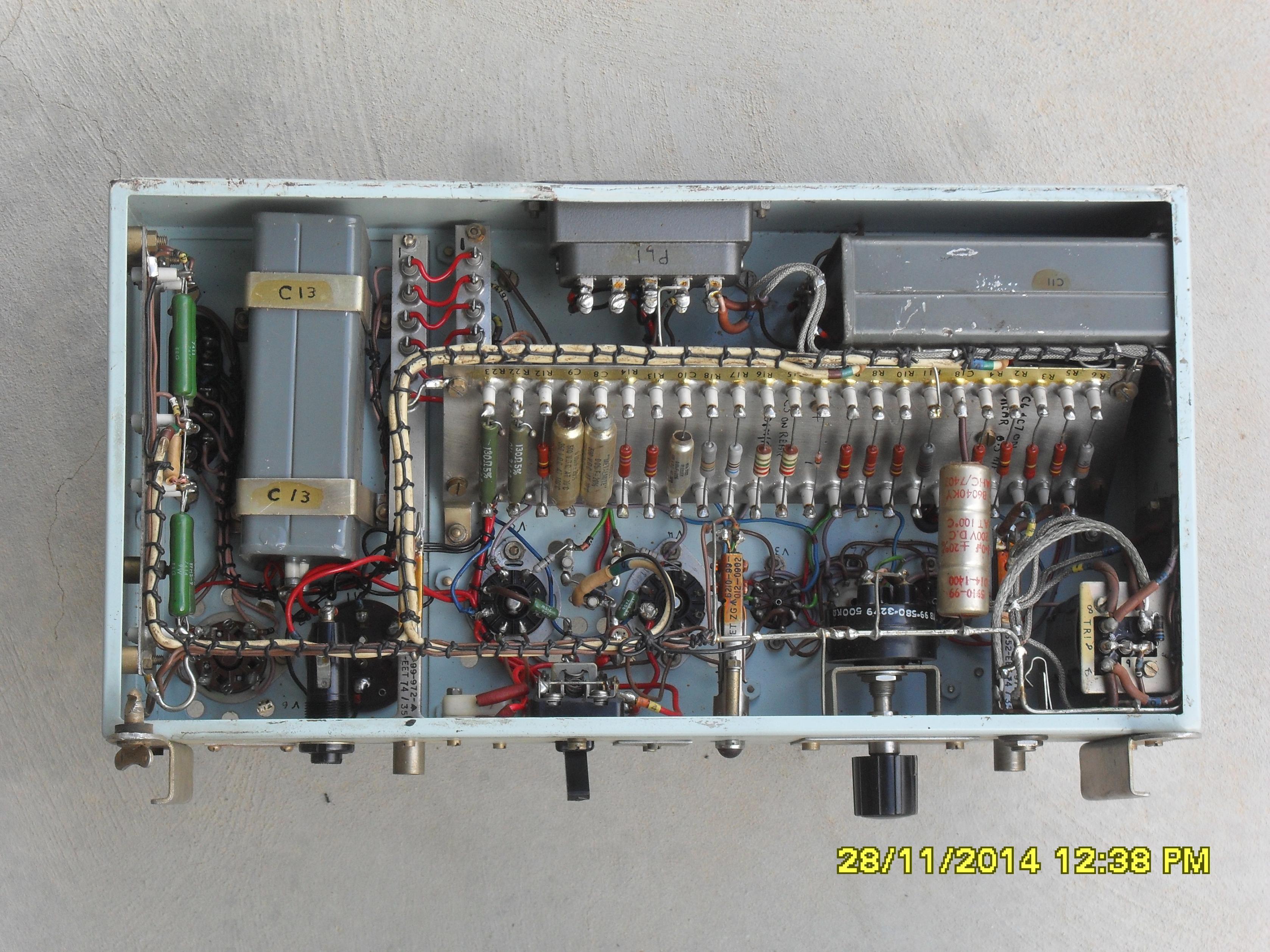

Check out this one, it's a Parmeko tube amplifier . I found two of them in a scrap yard many years ago. Apparently is intended for military use.
Impressive!

No convection path for resistors, obstructed by boards.
are guitar amp work the back is upNo convection path for resistors, obstructed by boards.
No difference. It should be 90 degrees tilted for the best cooling.
