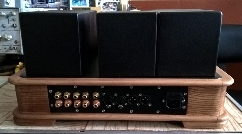

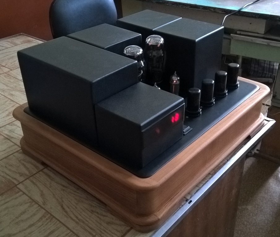

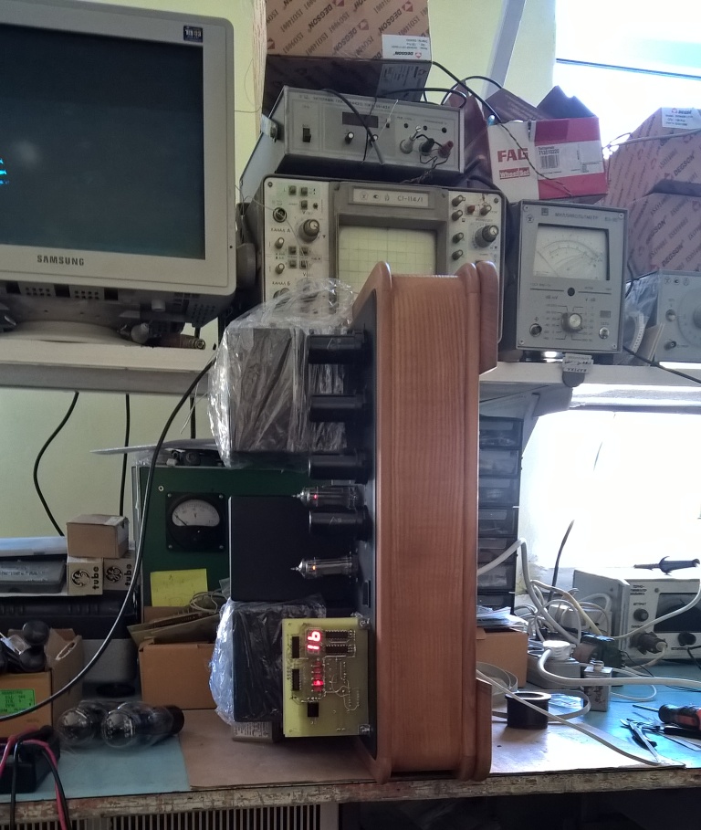

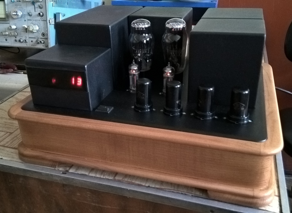

My new preamp.
1 balance and 4 unbalance inputs, multiterminal transformers volume control. Remote control for input selector and volume control.
Power the synchronous rectifier 5Ц3С and 6C19П in each channel.
Amplifier on a pair of 6Г1 with transformer load.
My new preamp.

🙂🙂 Beautiful finish.
quite nice and... uncompromised ))My new preamp... 5Ц3С and 6C19П... 6Г1 with transformer load
Gracias, Esteban 🙂 Tengo suerte en que no arañé nada. Jaja. Un cordial saludo desde los EEUU.

very nice looking but seeing that this is a DIY thread we like to see the guts...all the internals please 😀
No problems. I'll make a photo and show you.

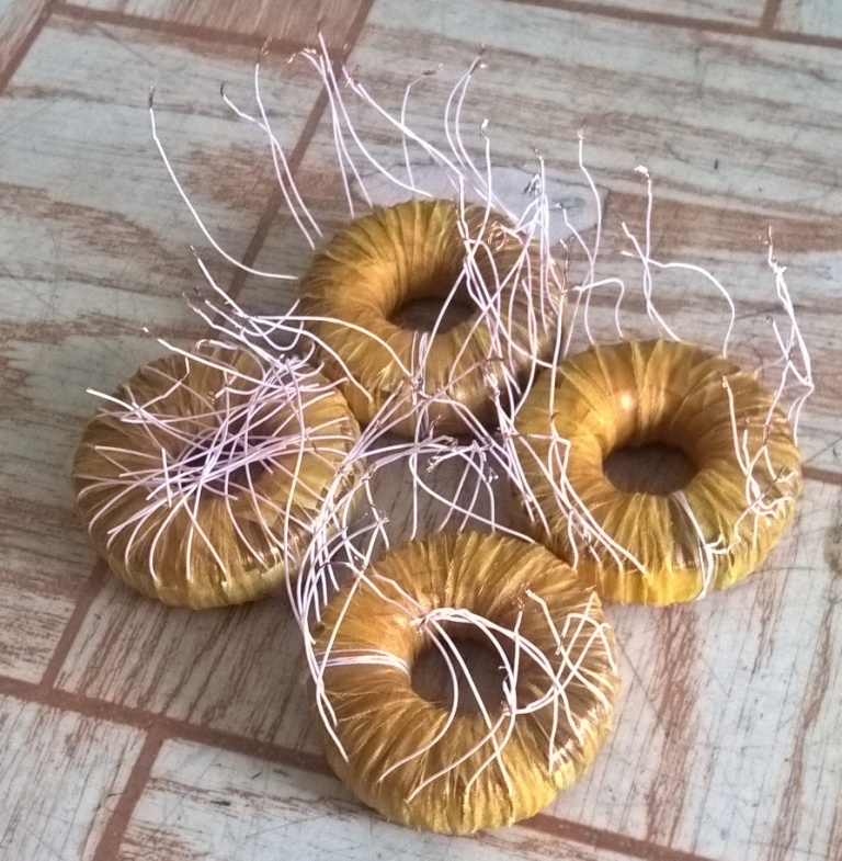

Photo permalloy transformers to begin.

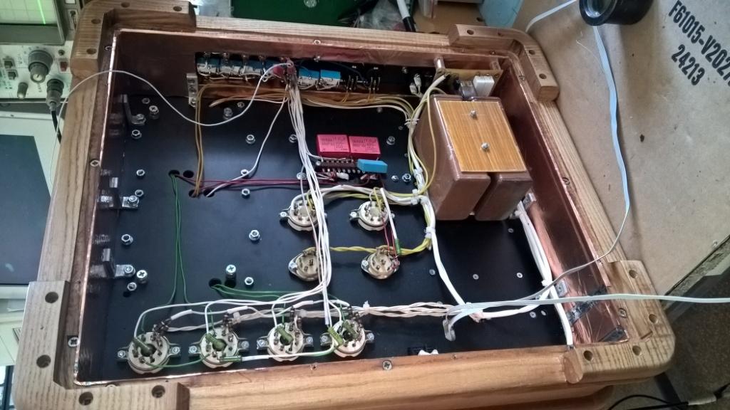

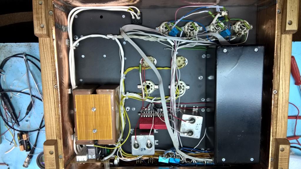

For all who do not believe that this is a DIY amplifier.
Now that is what we like to see 😉. Beautiful and well done!
I want some coffee with those...Photo permalloy transformers to begin.
I want some coffee with those...An externally hosted image should be here but it was not working when we last tested it.
I'm afraid teeth broken ...
I agree....
