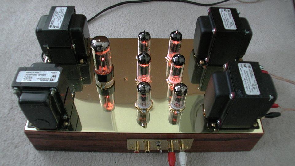

Very nice looking 45 amp.

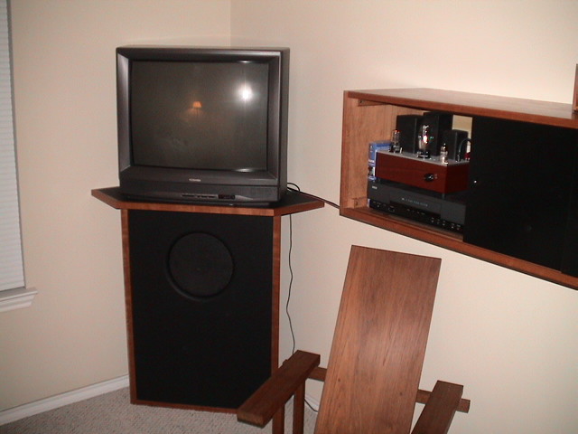

I believe you are only running mono with your TV. You should go for the stereo one.
Good thing is that your wife love it.

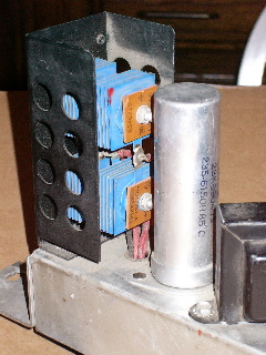

I got my ebay special PSU today and...what is this component? Primitive voltage regulator, nitro-methonic discomboobalator? It is wired parallel to the output of what appears to be the B+ transformer. The circuit then goes through the usual cap-choke-cap to an 11 pin I/O socket.
Thanks in advance for any help
philipbarrett said:I was trying to get around the "too big file" message;try this one...
The blue things are selinium rectifiers... very unreliable. Replace right away (IN4007s will do at a minimum)
dave
Thanks - there's some figuring out to do with this PSU, it's stamped Motorola 1962 and includes a relay activated on/off circuit. I'll take it slow with a variac!
