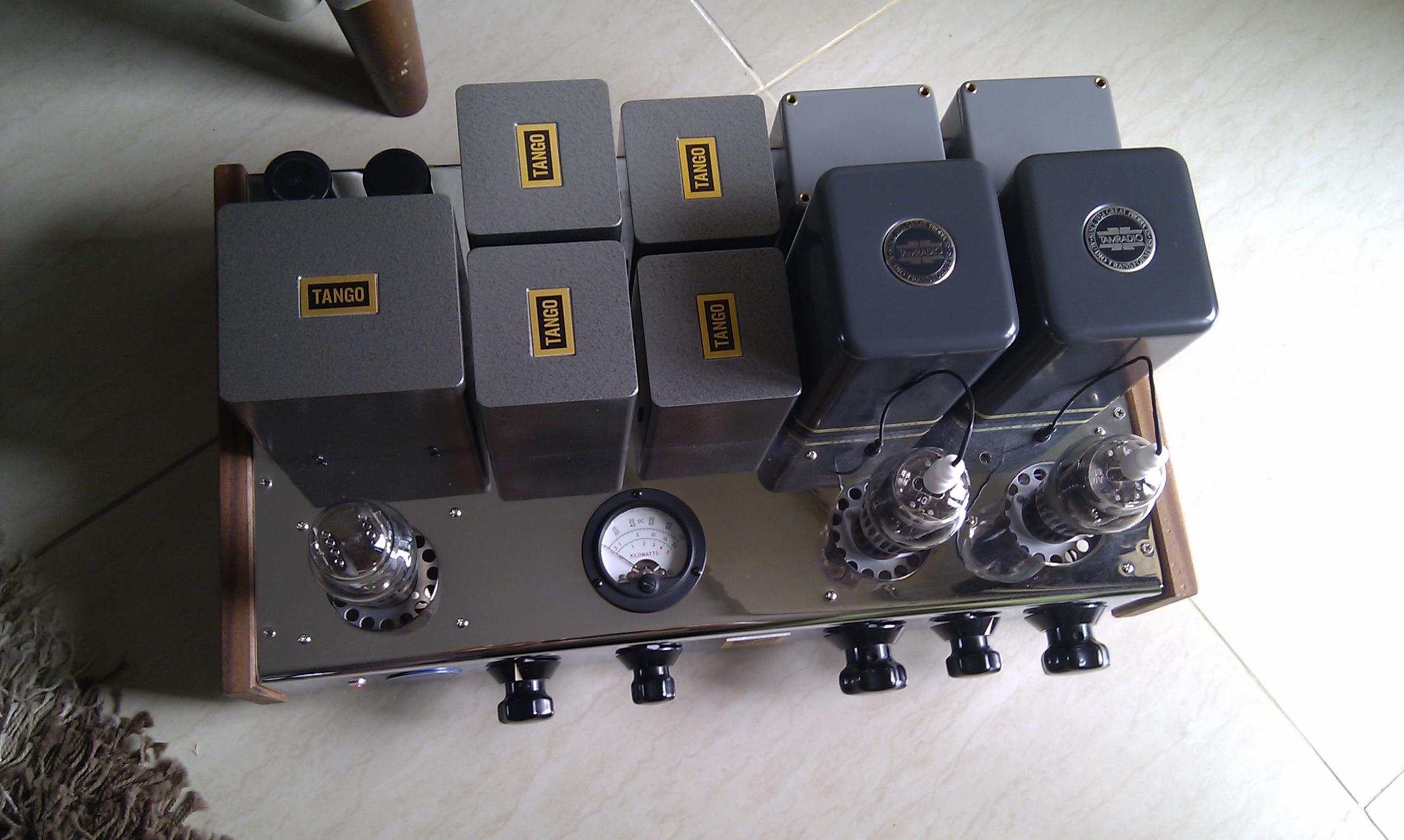

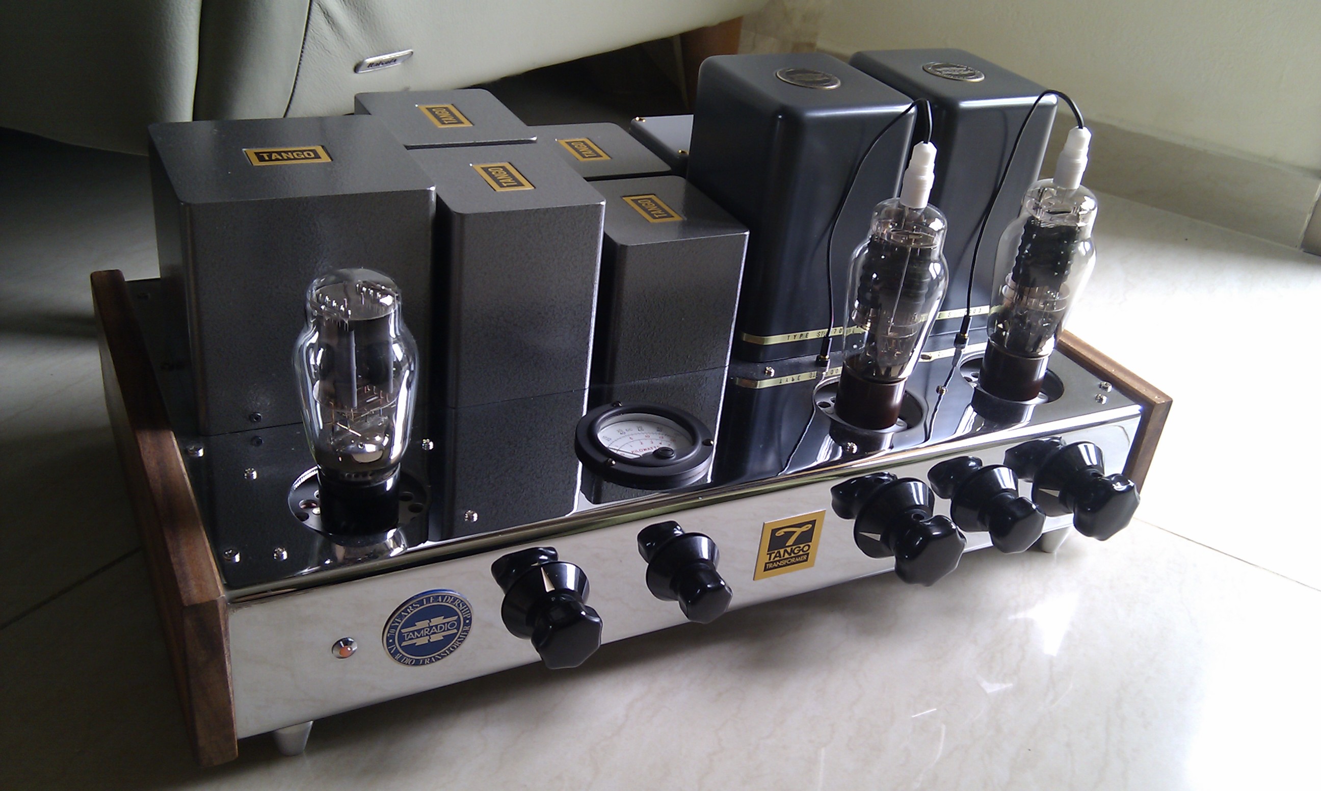

This is my last preamp 307A base.
This is what I like to see!
A proper built and functional!
Very inspirational!!!
We need to see more of his kind of build please!!!!!!!
I can't stand it anymore when I see extra " thingies" on tubes amps. If they don't serve a purpose, don't put it on there...
Sorry for a mini rant!
And the tranny behind the bunker?
Yeah, what's behind the bunker thingies ? Choke?
That's probably the choke for the CLC supply filter.
~Tom

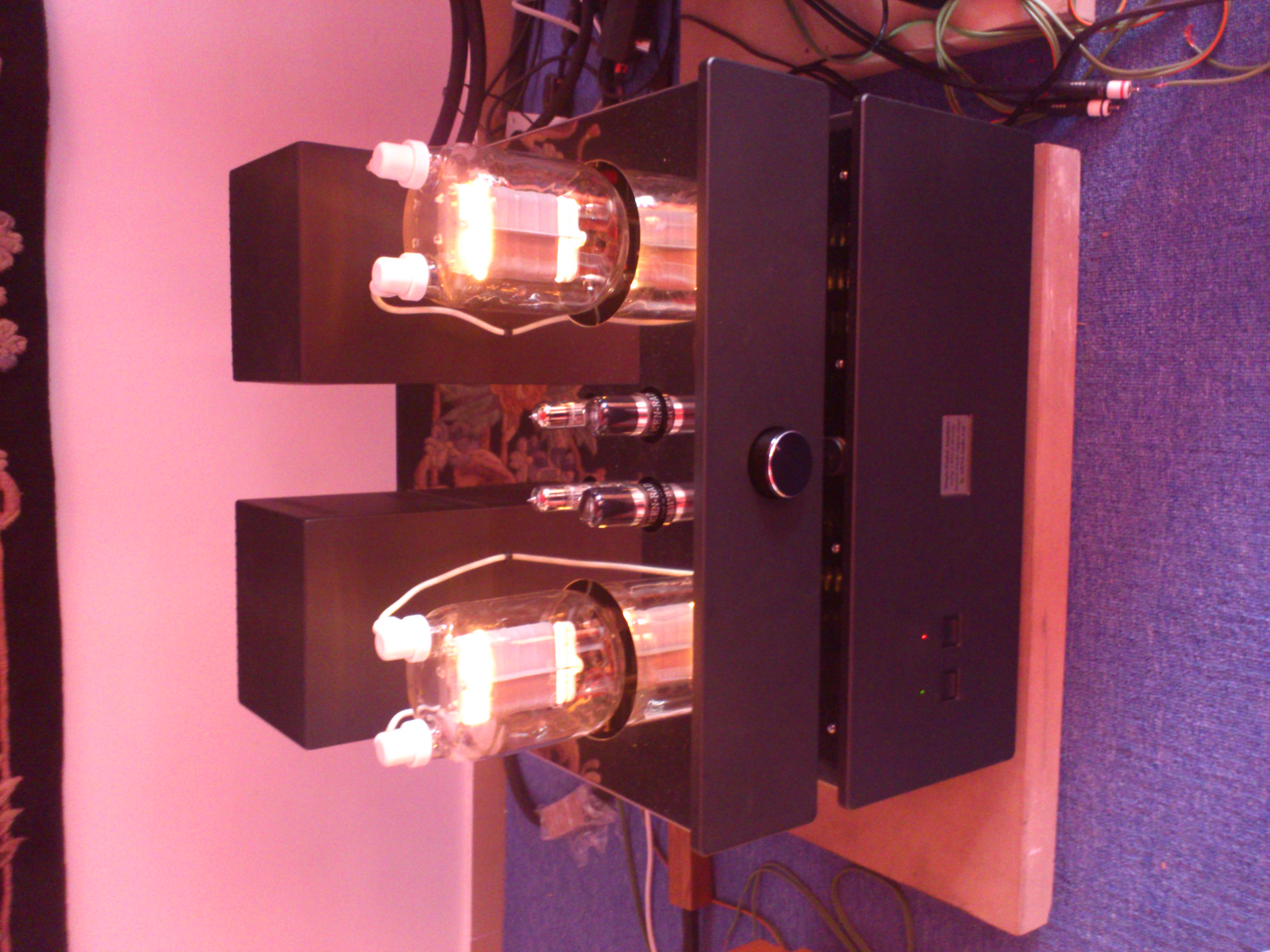

Dual mono 6sn7+211

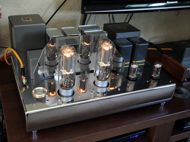

My daily 845SE amp's
Wow, really, really nice.
Hi! Yes,2 of this is chokes for HV,another 2 chokes for filament.

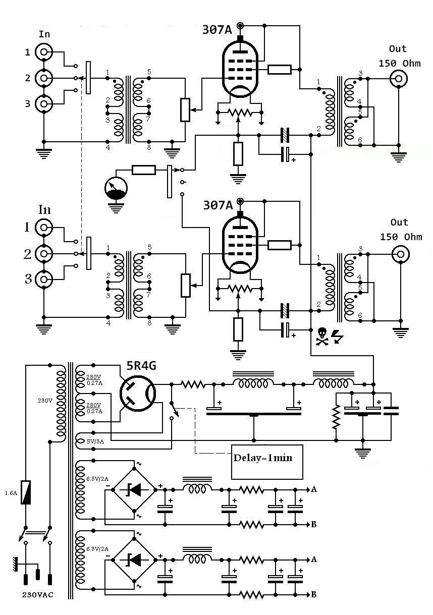

Data sheet for 307A: http://frank.pocnet.net/sheets/136/3/307A.pdfIf this is the preamp, how is the amp?
I never hear before about this 307A tube. Which topollogy use with her?
Is possible similar to 11e3 english one?
Tjis is schematic of this beast:

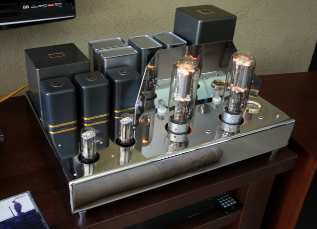

845
Whoa! Is output power in kilowatts?! As far as I can see the meter readings.![]()
Very nice! PSE I assume? What is the max power output?
Hi! What do you mind PSE? Push-pull SE? No,just 845 driver push 845 output tube.. Pout=24WVery nice! PSE I assume? What is the max power output?
