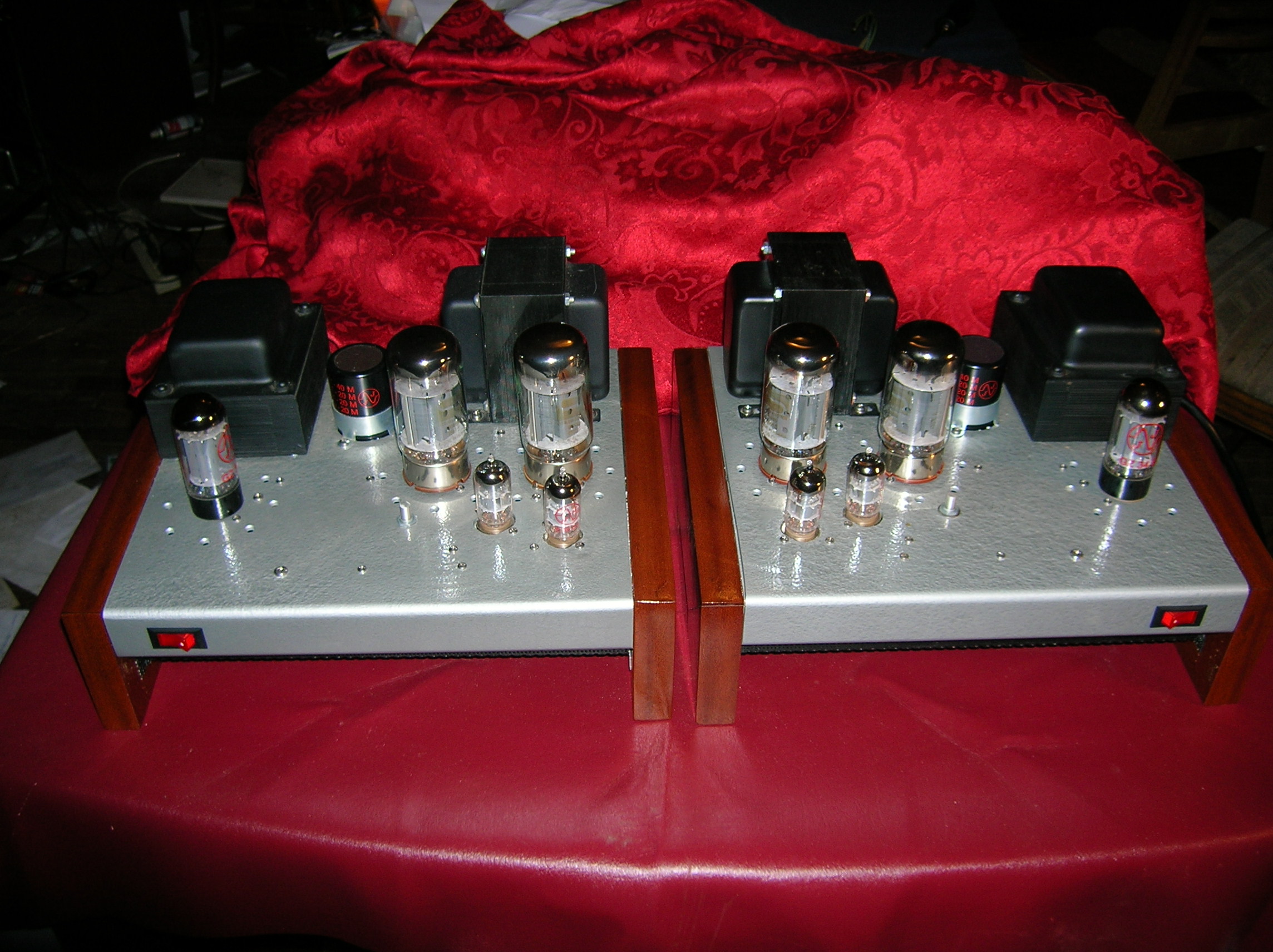

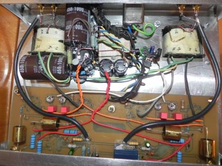

D3a + 2A3 Opt AK audio labs 😉
.....connection have finised this evening , I will start tomorrow after double check ........now I'm sleepy 😴
Great execution!
I like that you posted the schematic also.
I need to build a 2a3 one of these day.

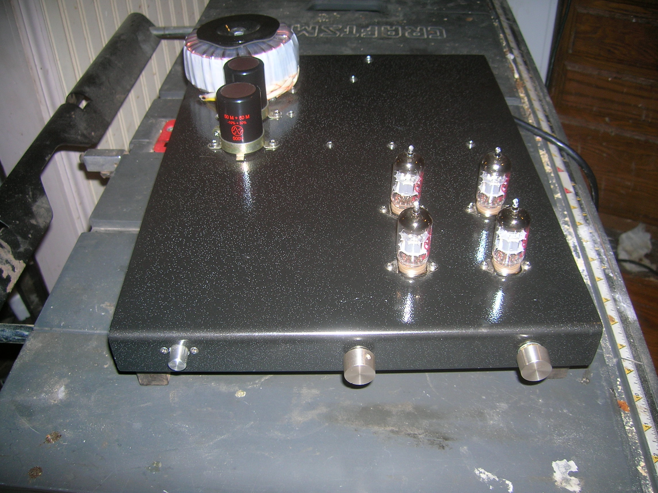

Mark III clones, 8b clone, Aikido line amp, RH84 SE
Nice lineup!
Wich aikido is that? I just got the aikido 5687 all I'n one board, haven't got the time to work on it yet. how do you like yours?
Great execution!
thank you😉

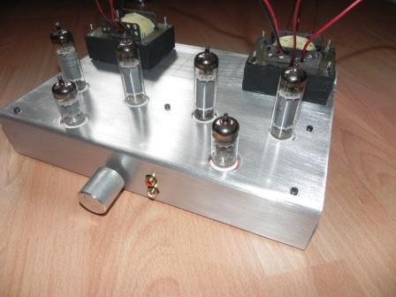

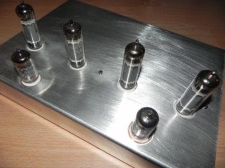

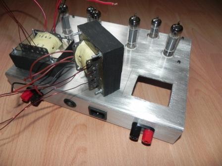

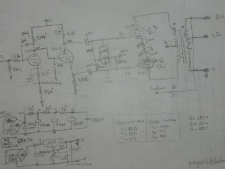

Fisher X100A Modified
Here is my Fisher X100A modified clone amplifier
The biggest chane on the amp is to apply negative bias.
The other change on amp are on the negative feedback and on the input filters and some of the resistor.
Here is the amp. spesifications:
Amplifier output power: 16w on 4ohm (17.7w on 3.6ohm)
Input sensitivity: 290mV
Apmlifier gain: 32dB
Upper cutoff frequency: 20.5KHz
Lower cutoff frequency: 35Hz
thank you 6L6

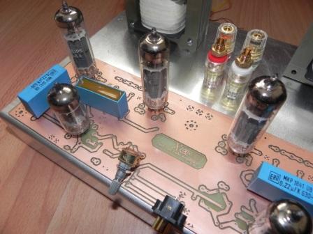

yes ı did a pcb on my own,
here is it
here is it

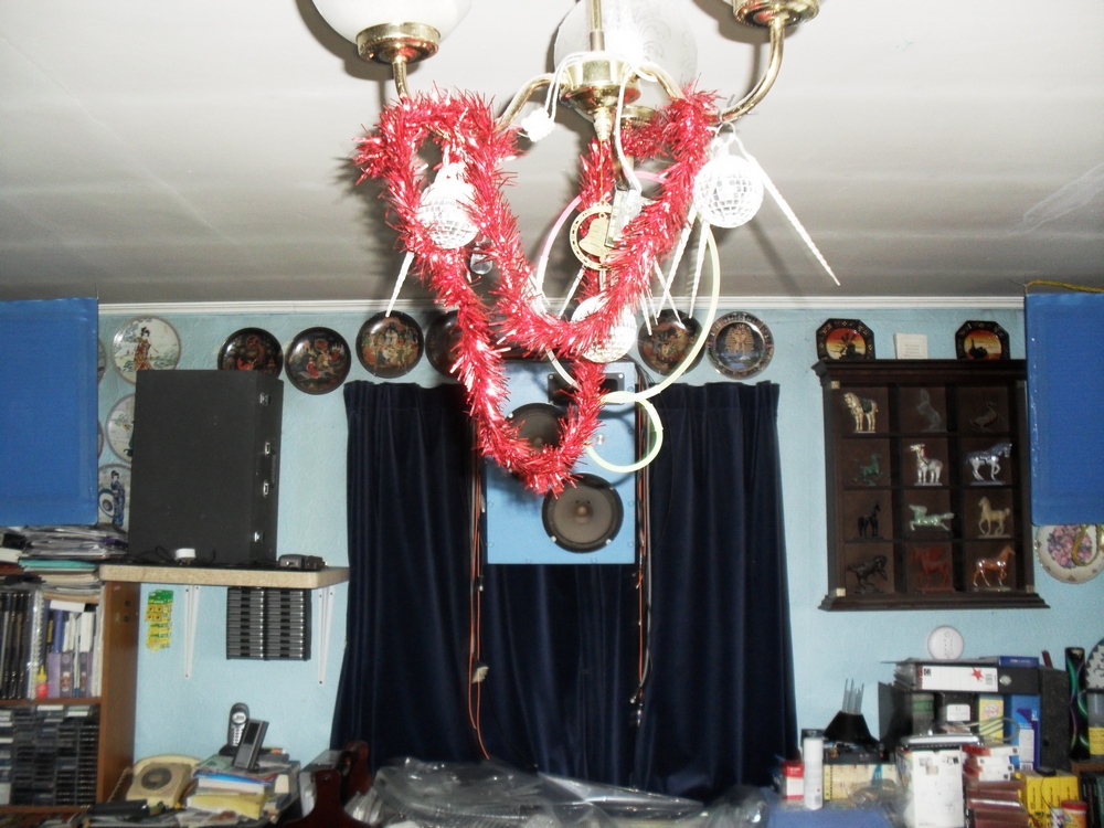

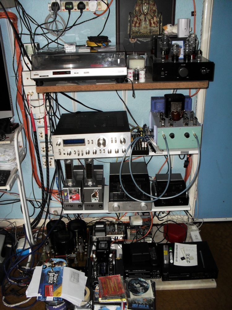

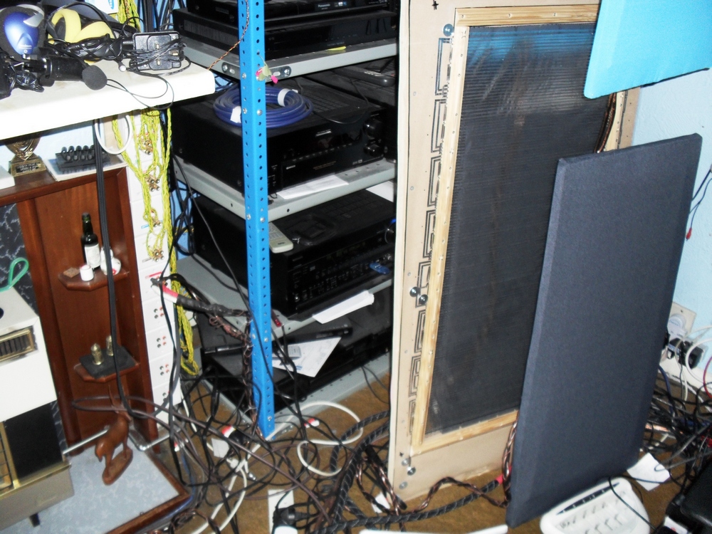

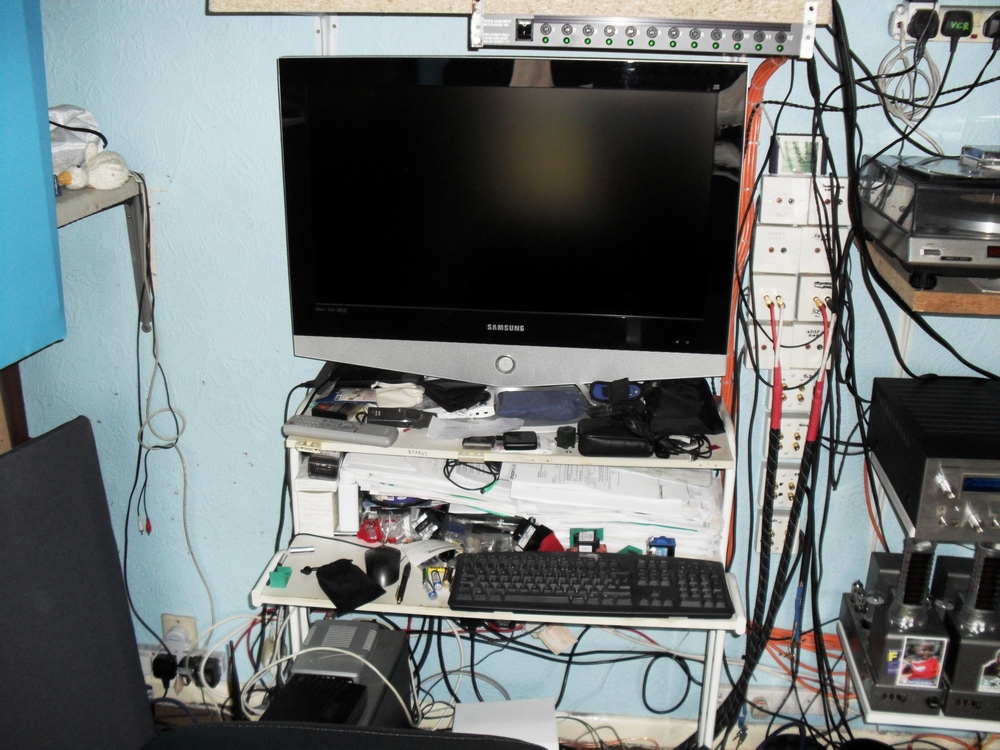

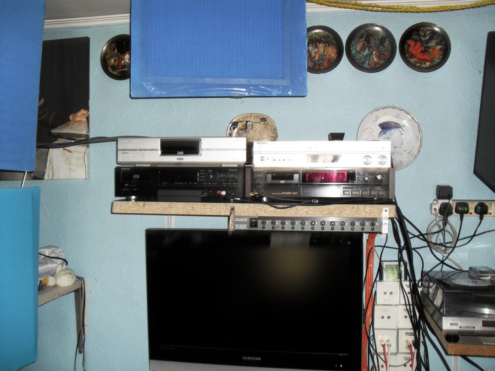

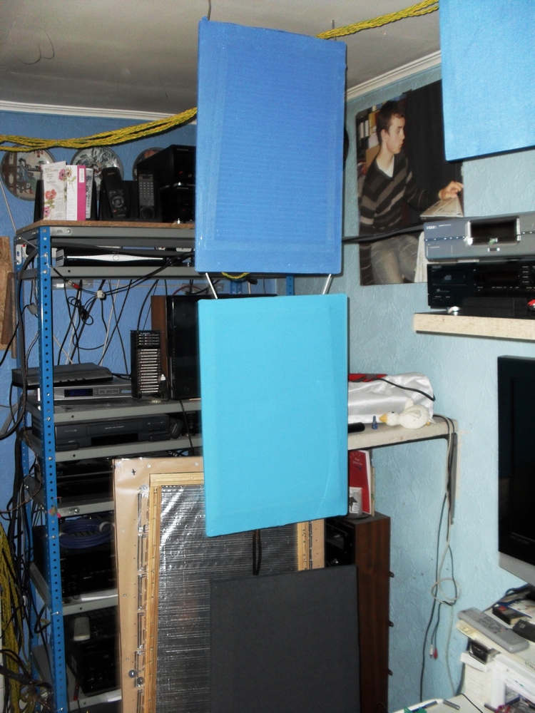

This is my latest layout, I have re-organised and made more space in my living room. Put 3 more shelves up and re organised the power supplies with the orange cables using IEC plugs all in one. I have bought a new distribution amplifier as the one I have now is giving me trouble. Using SPOTIFY for my music, about 215,000 tracks 21 months worth already. As you can see I am not married, so can do what I like, lucky me. The speakers are all home made All full range planars except 2 Bailey transmission line, 2 Underfloor loaded and 2 I.Bs.
Hi Henry, is clear you have no wife. If the mine watch this pics oh my god.
Enjoy your singlely and your lonely life.😛
