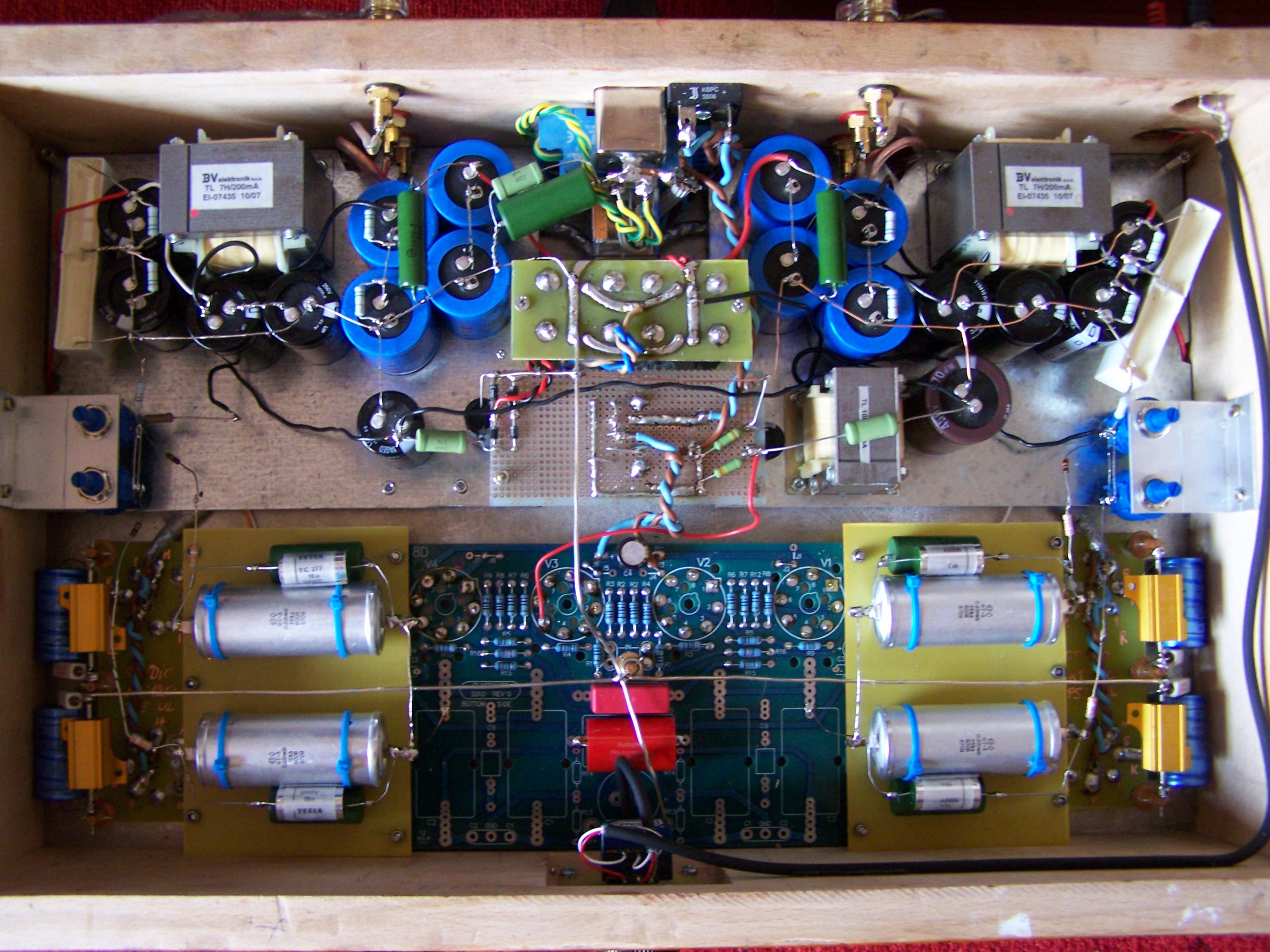

As promised I'm back on this issue. Finally KT120 PSE / Aikido drive is ready. I had some issues with PSU…. The first PSU was CRC and I did not get a clean sound… I tried all tricks but I couldn’t get free of PSU noise…. Finally I rebuilt this part with CLC filtering and all problems solved. Idle current was set after several test at 90 mA per tube – there was no noticeable sound difference from 80 up to 120 mA… With 90 mA I am sure the tubes will last longer. I do not have equipment to test this amplifier fully, but it sound as good as it looks… From the first listening I could remark an excellent control over all frequency range at all power levels. There is no “colored” frequency, tubbier sound or what so ever – very clean and clear with excellent dynamics. Compared with my previous KT88 PP I do not see any loose of bass. Miller capacitance effect – not a trace of it, Aikido makes a very good job. Coupling capacitors I used are military Russian Teflon, paralleled with smaller PIO and Styroflex. The cathode R’s are rated at 25W but they still get warm. There is no NFB at all..
After 4 hours of listening I seem to improve – but I believe it needs more time. Burn in not only for the tubes but for the C’s as well…
Well, finally I attach one more picture with the actual PSU…

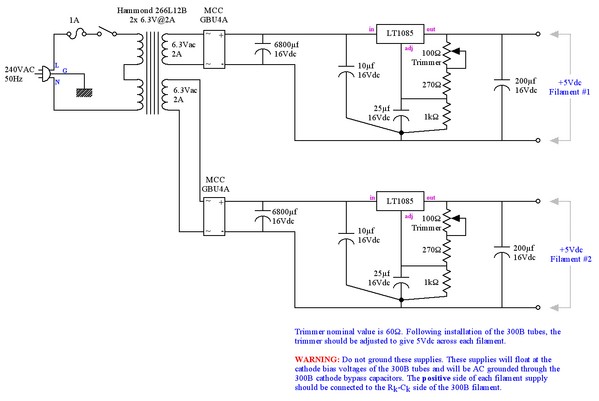

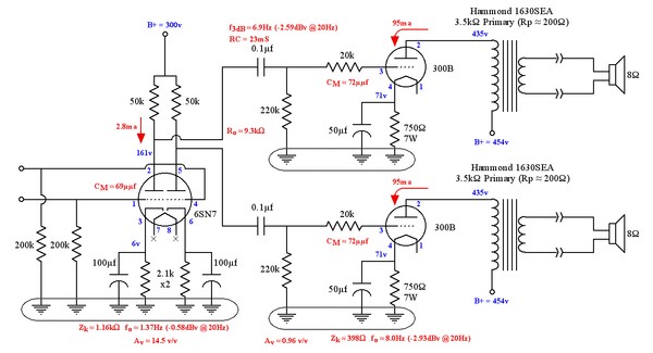

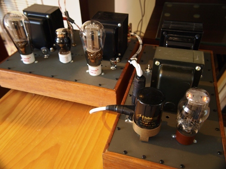

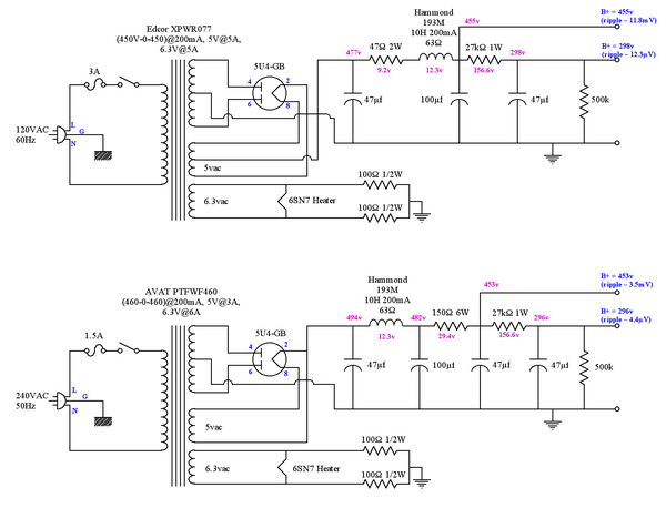

Lucas is a good friend of mine and lives down my way. He is very intense about his trannies. Great guy and pops into my Franskton Jaycar on occasions. If he designed it it will be good. Take a look at what a guy in the States designed for me.Hi mHouston

Very nice looking 300B SET . How do you find the Mundorf tube cap's ,I've used the Tube Cap range in the amps .The larger SET is complete film cap supply and the smaller pair have a mixture of Evox,BHC and Mundorf Tube caps .Lucas is a good friend of mine and lives down my way. He is very intense about his trannies. Great guy and pops into my Franskton Jaycar on occasions. If he designed it it will be good. Take a look at what a guy in the States designed for me.
