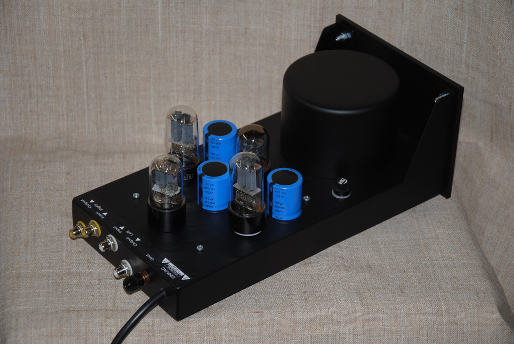

My first tube amp. A 6LU8 Spud. The schematics and such are available in this post.
The chassis is made from 18 mm think walnut. It measures 290 x 290 x 95 mm. Top plate is 1.6 mm aluminum. Bottom plate (not shown) is 1.6 mm aluminum perf plate.
~Tom

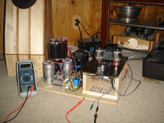

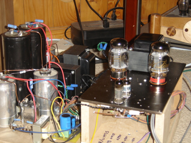

My first valve amplifier, a pair of 6EM7s used, rectifier is a 5Z4.
Layout's not great, but the sound is pretty good...
Bias is from a pair of rechargable batteries, one per side.
Hey chris661,
Breadboarding at its finest! Be warned, you have just started down a very long slippery slope. There is no turning back now...
That looks a lot more organized that one of my DeathTrap™ designs... 🙂
DC coupled, eh. Nice.

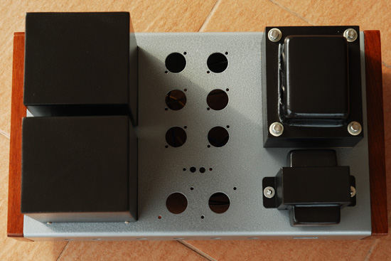

Hey Yoss! Nice build. Say, what kind of output transformers are they?
Hi h00hbt,
My OPT is custom made from my friend in Thailand. Primary impedance = 1.5K but I plan to change in to 2.5K soon.🙂

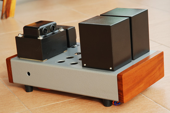

Hello Yoss,
Very nice builds! What kind of chassis did you use?
Hi jim,
The chessis made from folded 3mm aluminum sheet and spray by hammered paint.
I also enclosed some photo of my chessis work.
