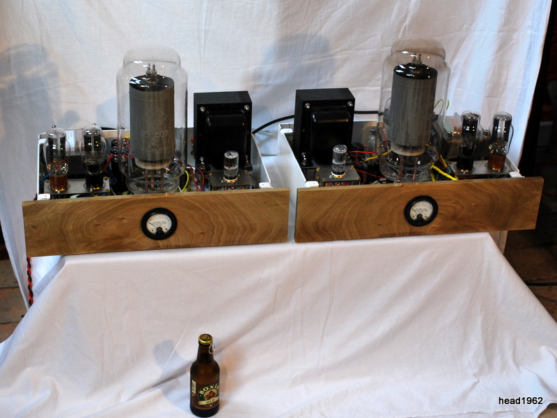

RS607 telefunken

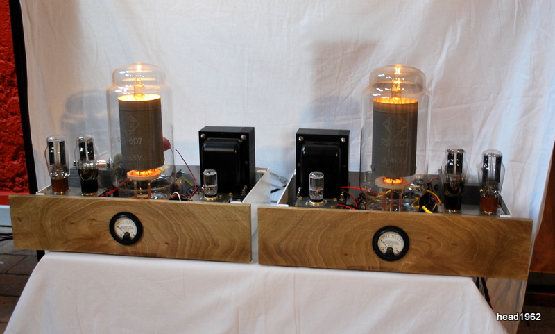

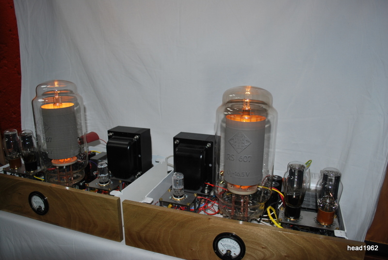

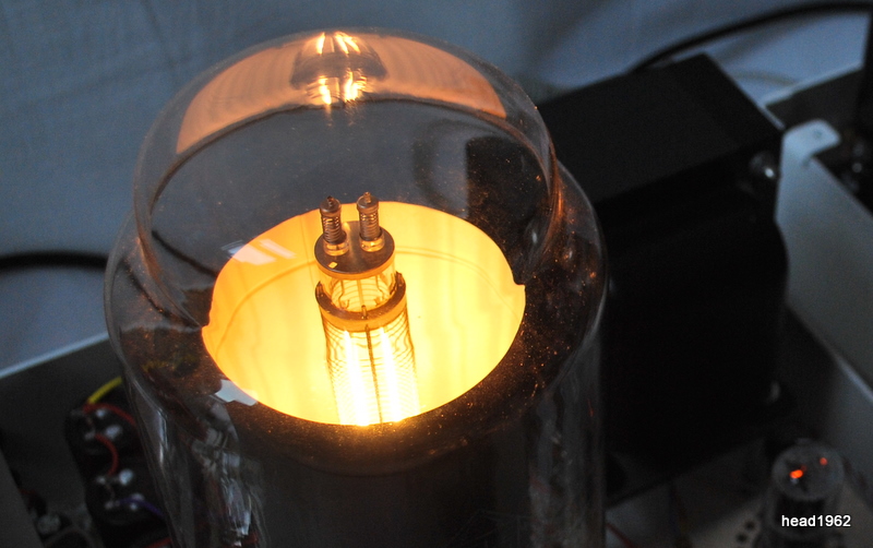

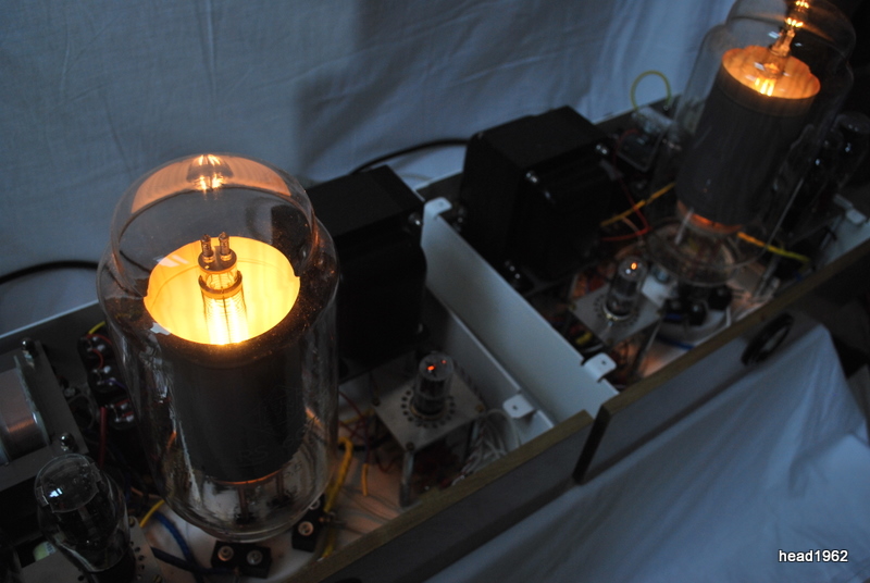

Hi Guys!!!
It's done!
in Stereo and on.
amazing sound, very SE triode.
The pre-amp tube is a 6EM7, strong enough to drive the beast RS607
the other 2 tubes are rectifiers.
about 4 feed wide and not even 150 pounds.
luckily I finished it before the earth runs out of electricity...
the beer bottle is for scale http://www.diyaudio.com/forums/images/smilies/eek.gif
It will now! 😀 😉
Amazing Tube !! Wonderfull !!
What OPT did you use ?
they're Electra Print MT5KB
bought them in Holland a couple of years ago.
Sound nice. and they can handle the 1kV ok.
I saw one on E-bay germany not so long ago, so they're still around.Very Cool Head!!! I am still looking for a pair of those tubes. Just awsome.

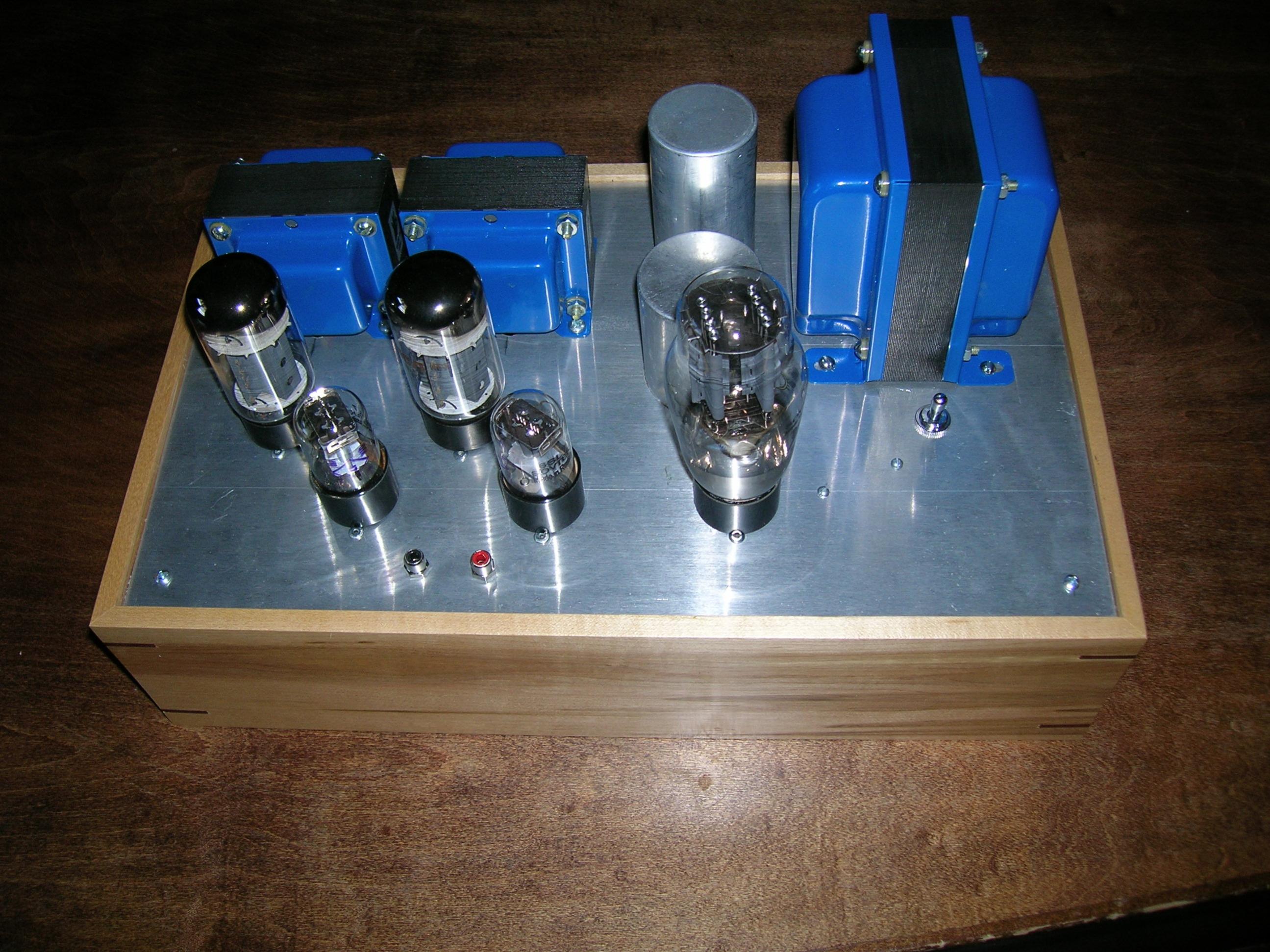

This amplifier was built to reproduce music playback with high fidelity. The sound is light and natural. One doesn't get tired of listening to it for many hours. The voice sounds softly and naturally without tension. The amplifier has great microdynamics. The preamp is built based on tube 5692. The power amplifier uses tubes 8417. The tubes can be replaced with different ones: 6L6, 6L6GC, KT88, 6V6 and alike. In this case, the current of the output tubes can be tuned. The output transformers are Hashimoto HC-507U 5K. For more pictures, please visit AlexKap.com.
looks nice!
what is the red paint you put on the connections?
can you post a diagram?
I like your solid state(?) amps too.

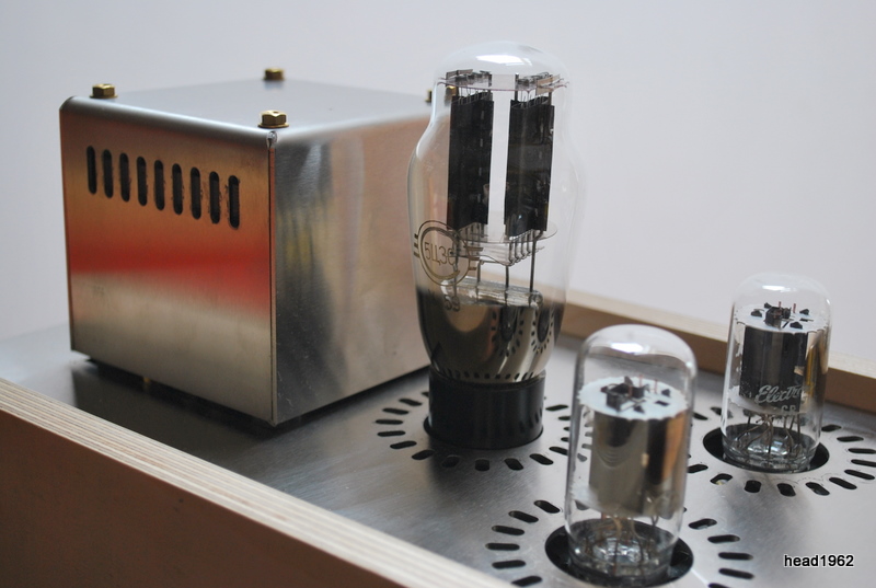

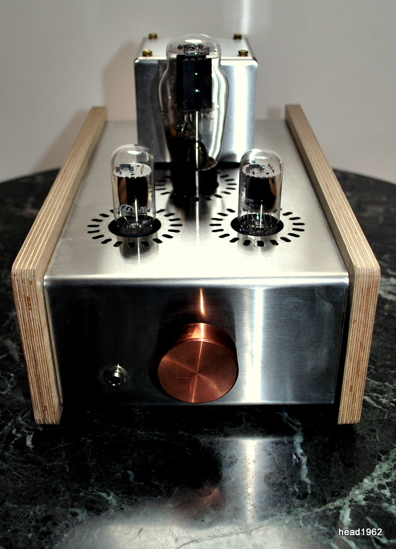

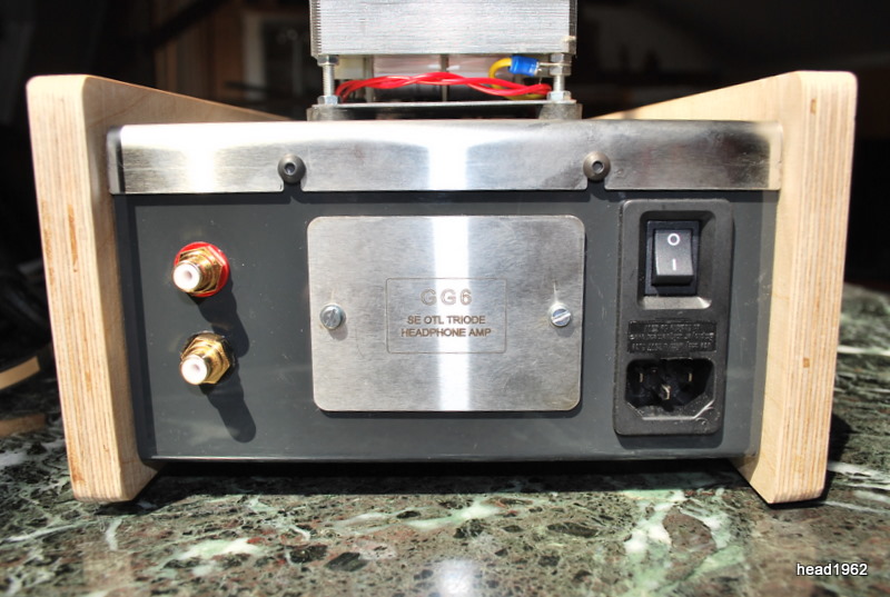

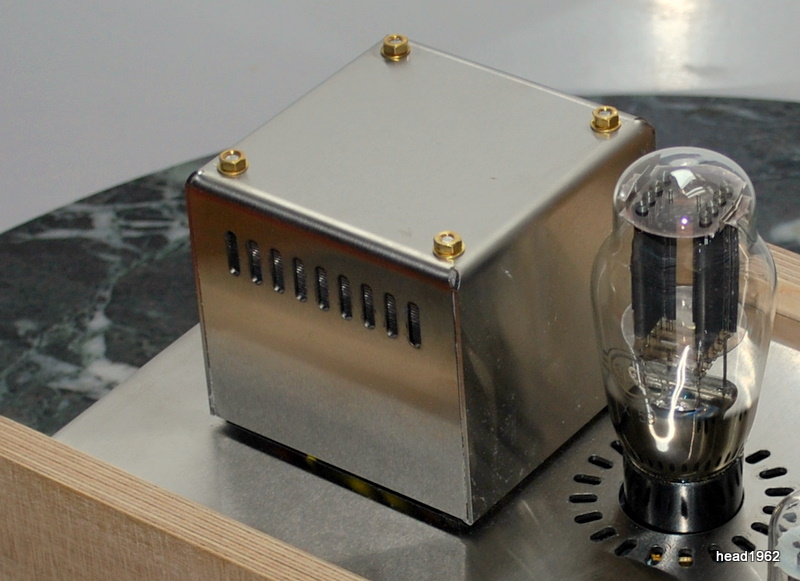

1 tube SE OTL headphone amp
just finished this one for a friend.
it gave me lot's of headaches to get rid of all the hummmmm
but now, without the hum, just great!
a 6EM7 in cathode follower mode. DC coupled. no output tranny
gets very hot 🙂)
gets very hot 🙂)
Thank you. I used heat resistant paint. I will post the diagram some day later.

I posted the diagrams here 5692 / 8417 SE Tube Amplifier | AlexKap.com
