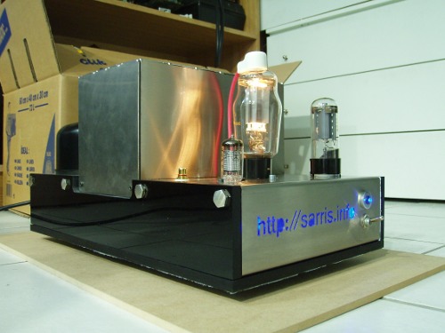

Nice amp for cold winter!
But I would definitely put a grounded cage around dangerous voltages, with safety switches that turn off power when the cage is open.
noyan said:An externally hosted image should be here but it was not working when we last tested it.
Very deep and powerfull bass, huge and transparent soundstage, lovely mids.
Here is some photos of my tube amp.
http://img200.imageshack.us/gal.php?g=img1663t.jpg

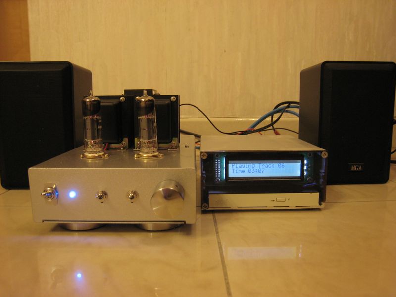

I missed that. BTW I have all parts to build a DIY CD-player from a PC CDROM, but when will I have the time to finish that project??like there is a home brew cd player...
My new project . PS is on the left side down.

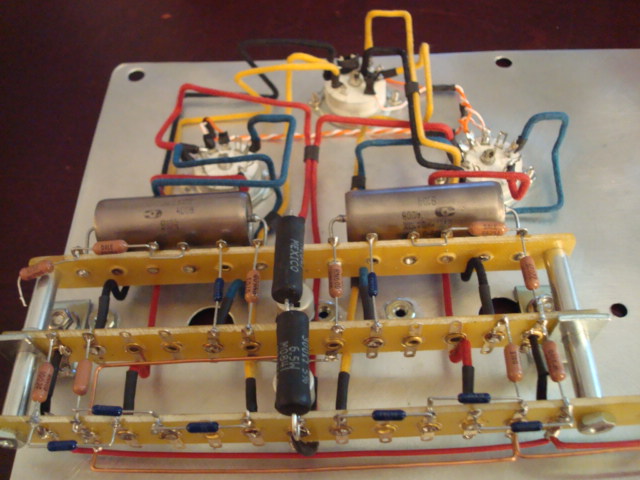

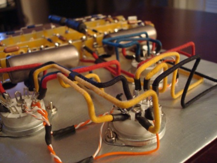

Re: under the hood
Very nice & tidy !
Jim
tim614 said:under hood before it was finish
Very nice & tidy !
Jim
tim614 said:Thanks Jim!
Im very proud of this build, labors of love on this one.
here's another pic

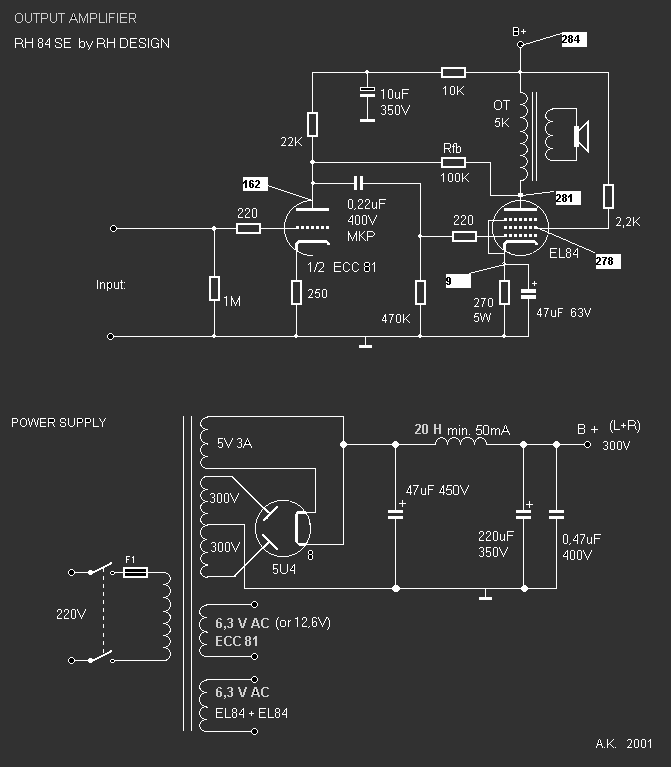

Nice work Tim!
do you have a diagram?
I'm optimising a mini 5EM6 SE, to try to squeeze 2W out!
head1962 said:
Nice work Tim!
Its an RH84 design by Mr Alex k

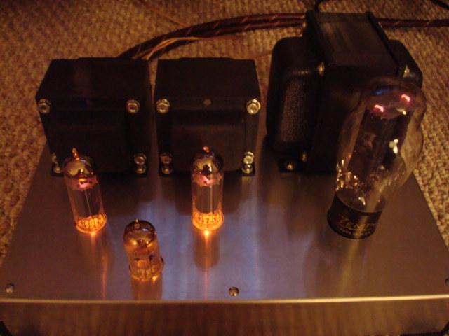

Re: diy se el84
Looks great. I'll Paypal you 50 cents for 5 dozen of those amps please...
tim614 said:SE el84. I know these are dime and dozen but here's mine.
Re: Re: diy se el84
Sorry im out i'll let you know when i get more
Thanks you all for the kind word, its mean alpt to me am a tube noob
