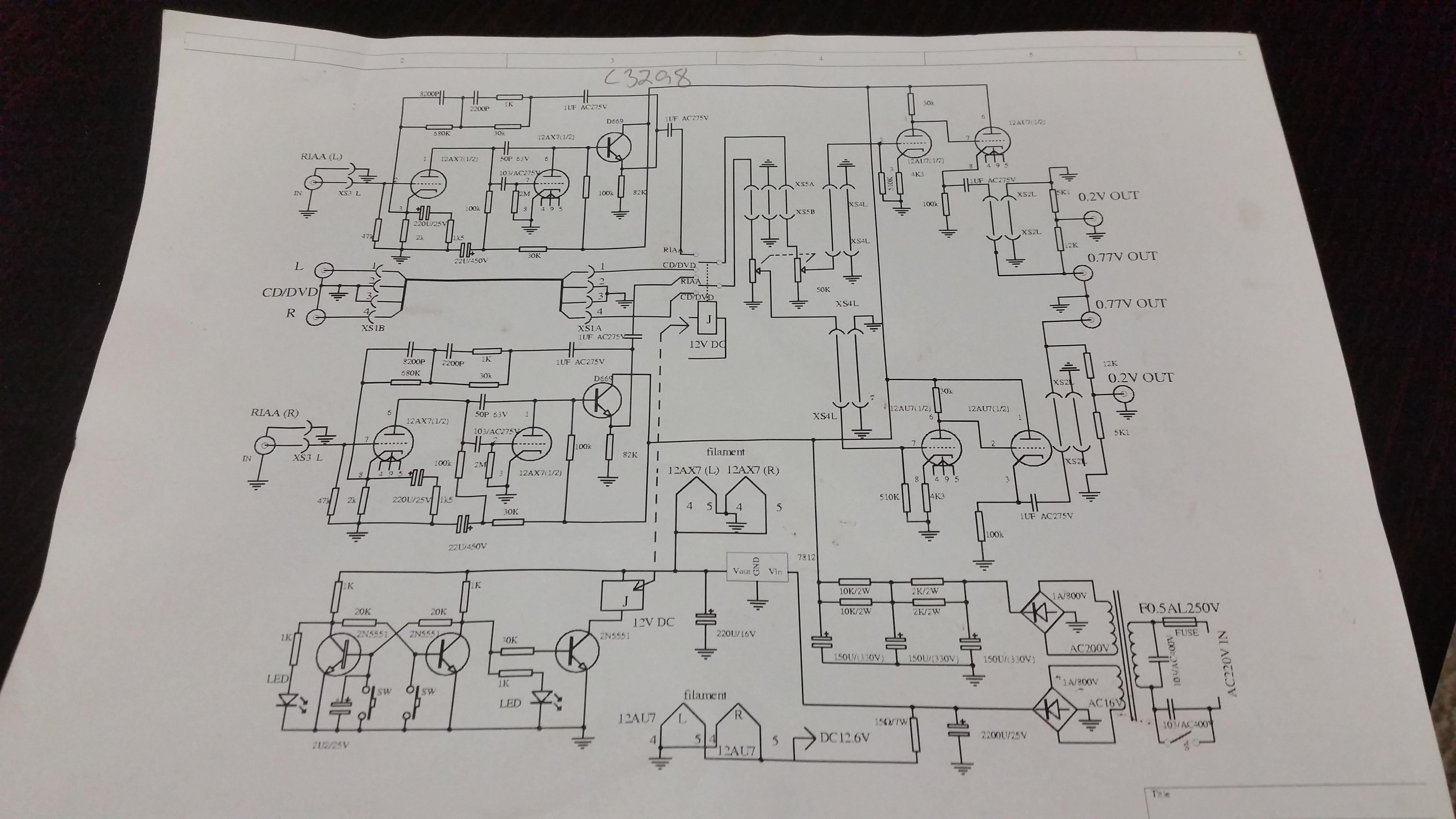

I built this phonostage and I am just looking on a way to improve it. I used .33 uf audionote copper caps instead of 1uf it's lacking a bit of bass. What values should I use? Should I add a .01uf in parrallel as well? I did not use the same power supply in this diagram.
