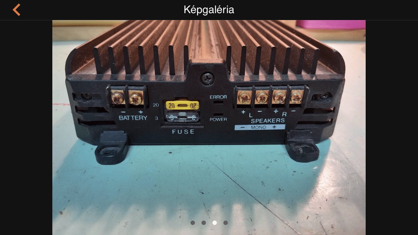

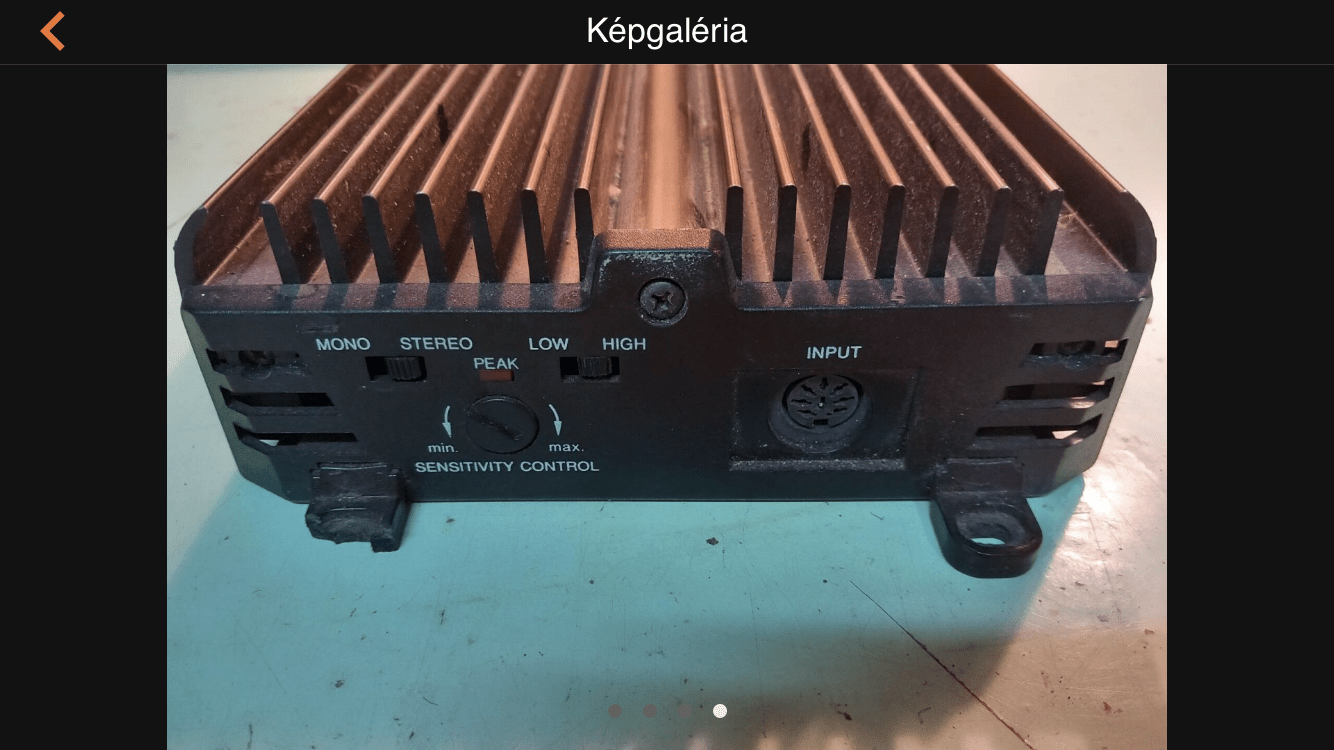

Can someone tell me this amplifier din connector pinout?
I cant find this..

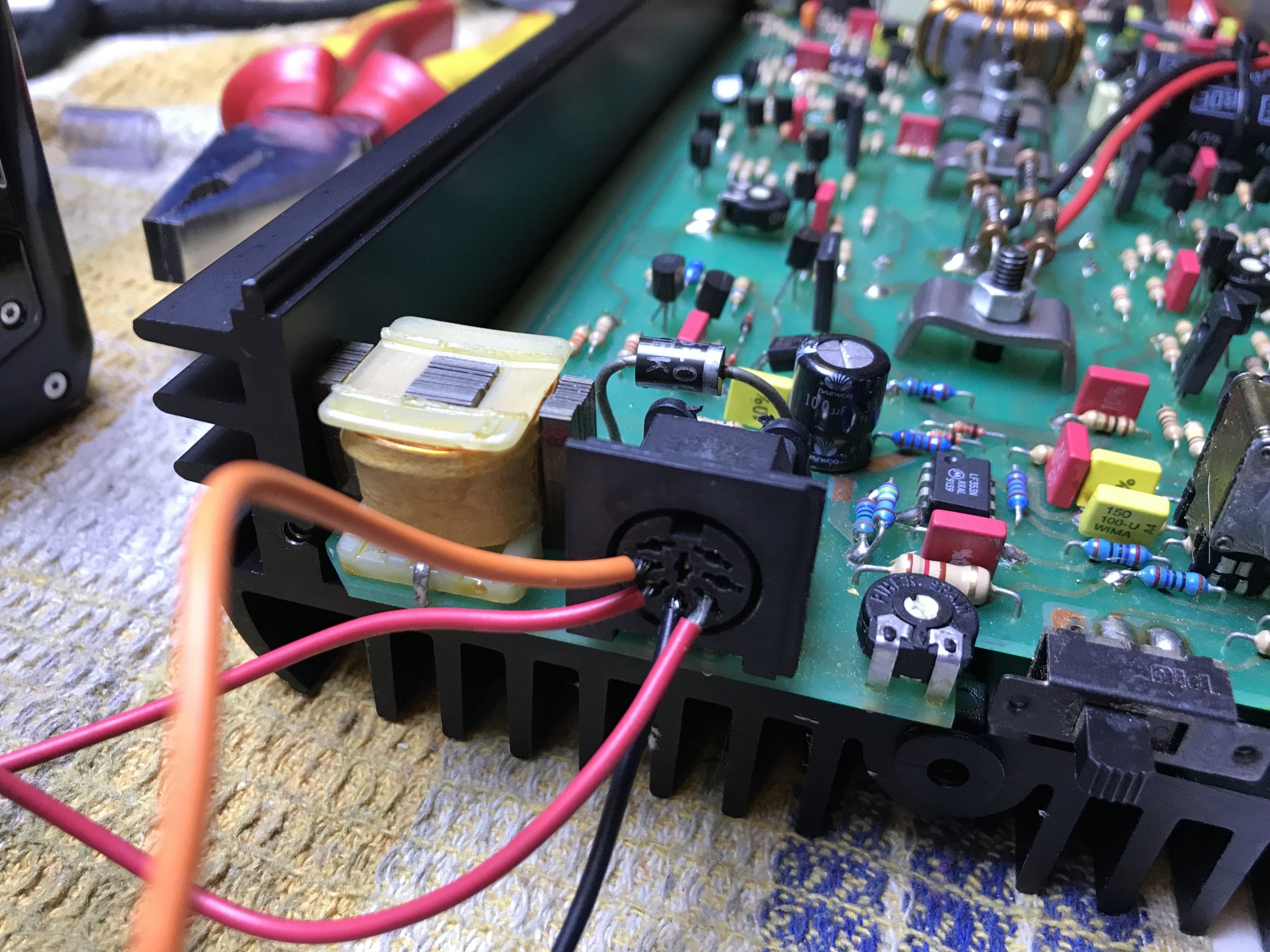

Two channels ,and i think here is the remote pin..
What values can i measured?
Edit.: No short transistor finded.

Are you saying that you don't know which pin is remote?
If not, it should be a circuit that goes back all of the way to the area of the PS driver IC.
If you can't find it, applying 12v through a 1k resistor should be safe to probe every pin to see if one causes the amp to power up (switching power supply producing drive pulses).
