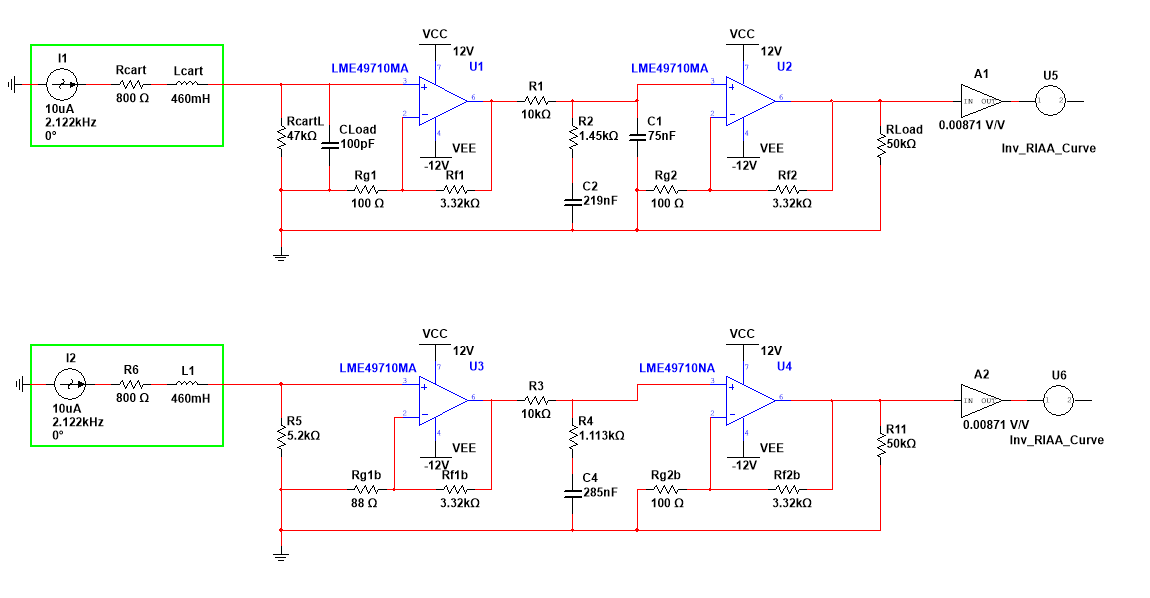

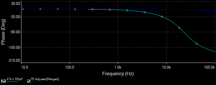

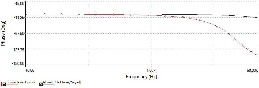

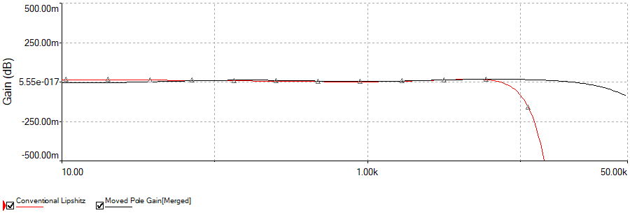

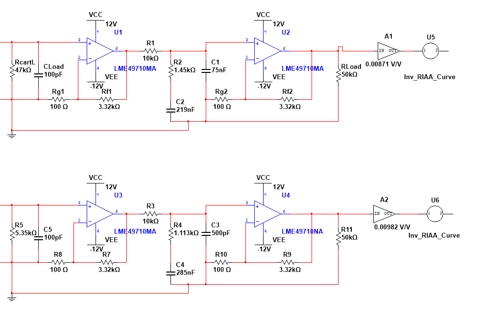

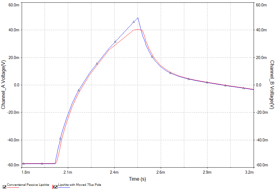

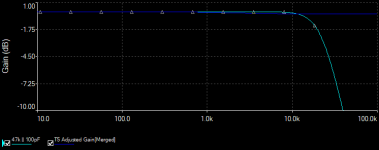

At the moment, I am going to use the "simple model" -- for a passive RIAA correction the first with the 75us pole a la Lipshitz 1C, and the second the cartridge loading resistor "tuned" to just a bit higher than 75us (64uS) and a 1uS pole in the passive network. (Figure1). The two are gain adjusted for near identical response at 1kHz.

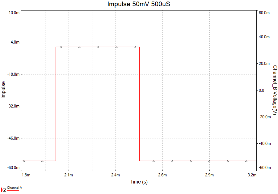

So, wondering how this would be affected by an impulse, I put a 50mV 500us pulse in both,

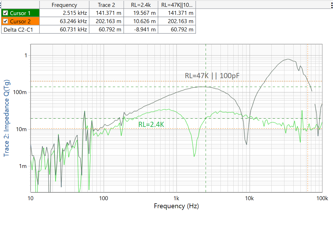

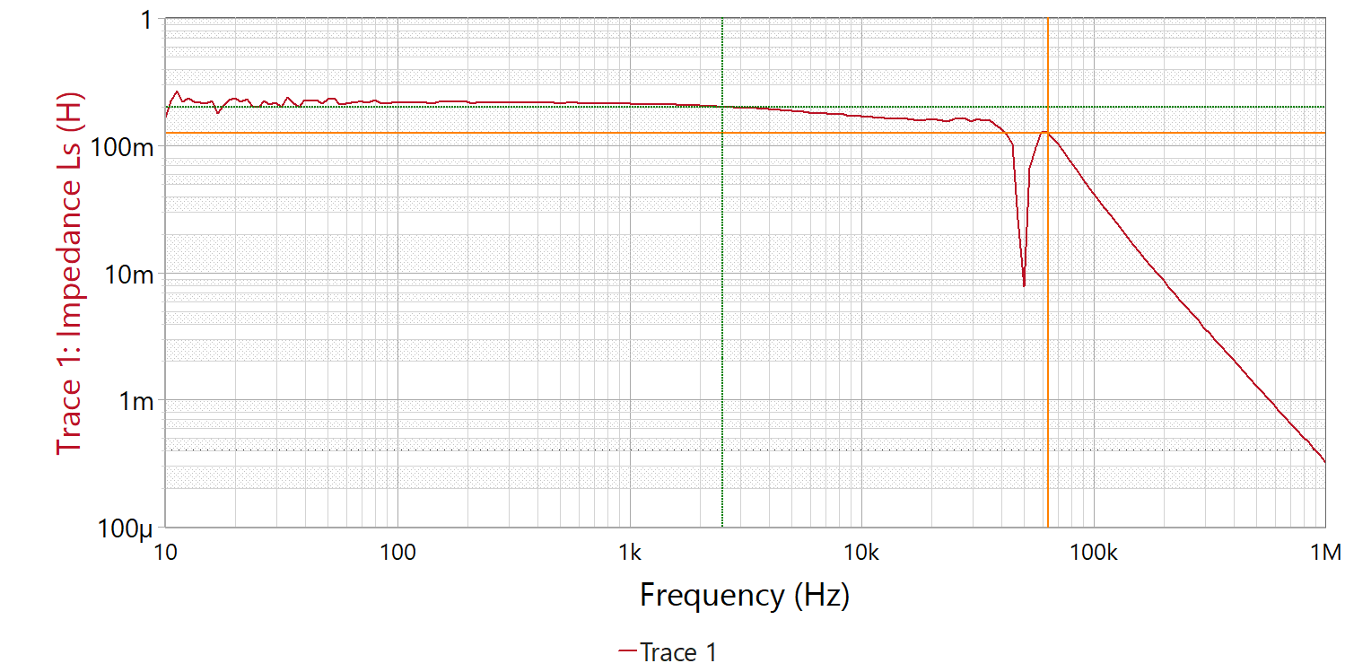

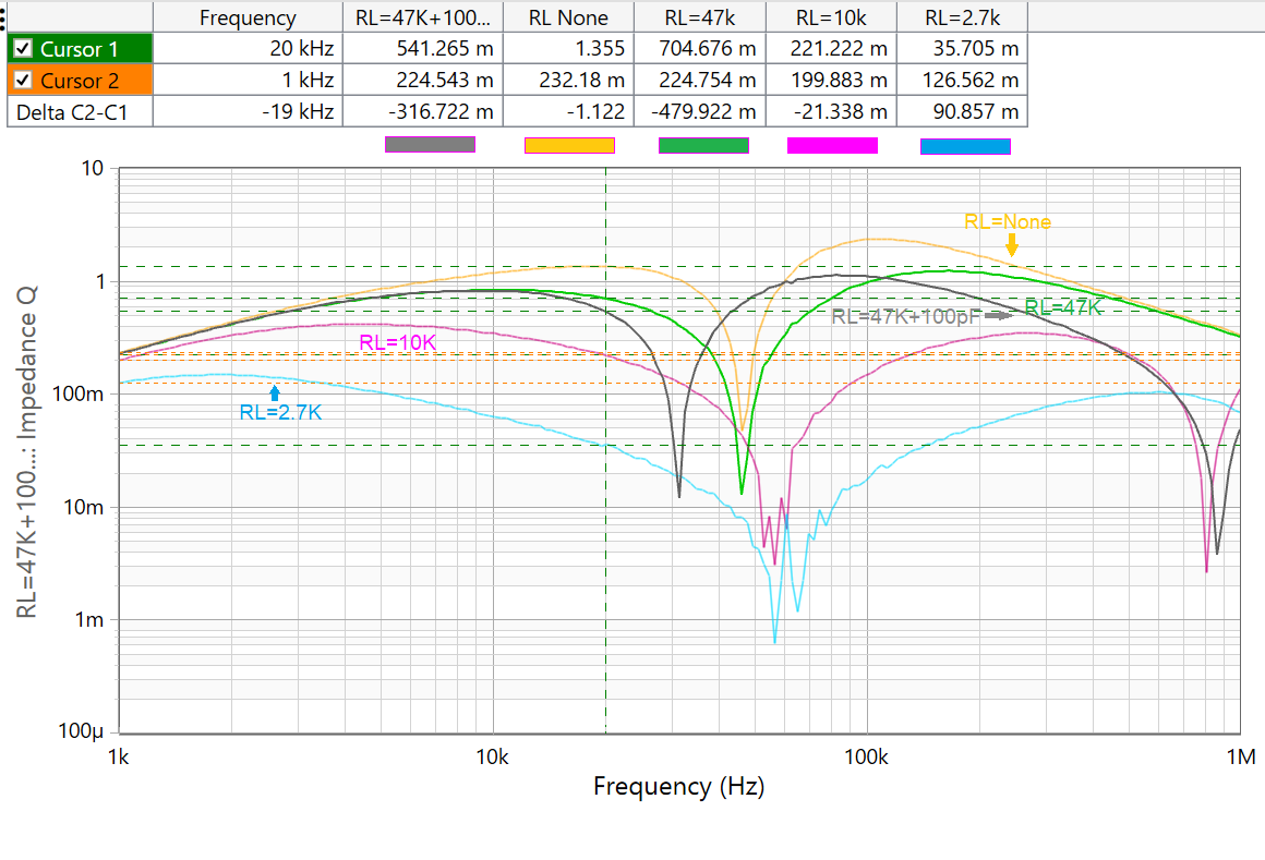

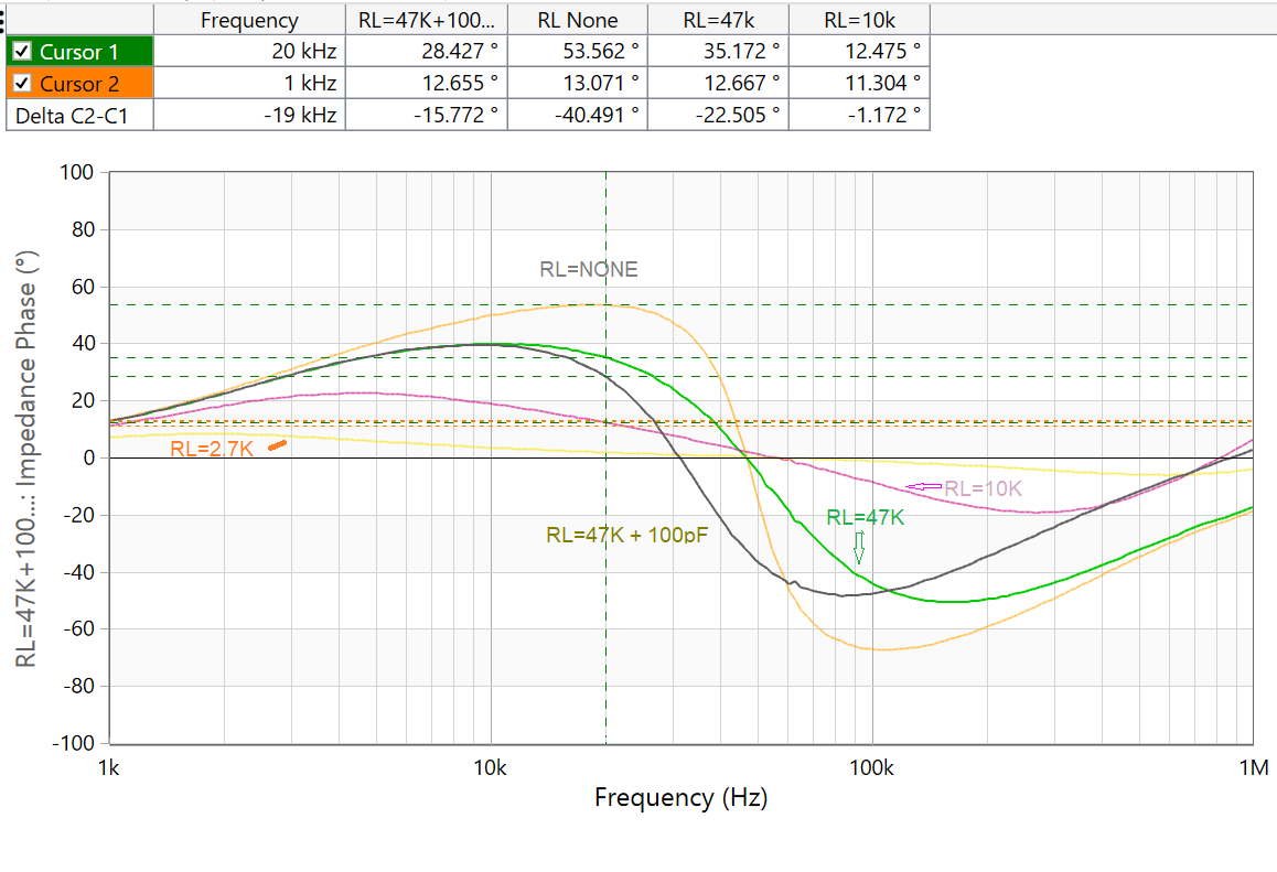

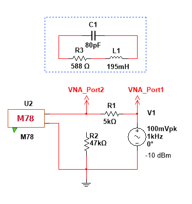

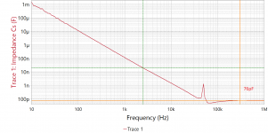

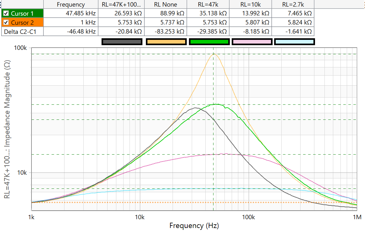

I have a Shure M78 for playback of 78's -- they basically placed in parallel the two halves of a stereo cart. I use a 5k Caddock and -10dBm source to deliver about 18uA to the cartridge from 1kHz to 1MHz. The setup is standardized so that there's only a few pF of residual capacitance.
The attached should be pretty self-explanatory. The usual 47k||100pF might not be optimal -- but whoa, the maths!
Another chart. I thought that averaging would help. It doesn't. The task now is to make two identical preamplifiers with two loading systems and compensation networks, see if there is a detectable difference, and a betterment of one versus the other.

So, we can do this -- substitute LM4562 for LME49710 in each case. The gain setting resistor in the T5 compensated amplifier is lowered to 88 ohms so that the gains of both amplifiers are almost exactly equal. a 1us pole replaces the 75us pole so that some of the values change.
I'm open to suggested recording torture tests. We've used "Rachmaninoff Symphonic Dances, Funeral March Andante con moto (tempo di valse), Reference Recordings 5" -- good (excellent) if you can find it.
