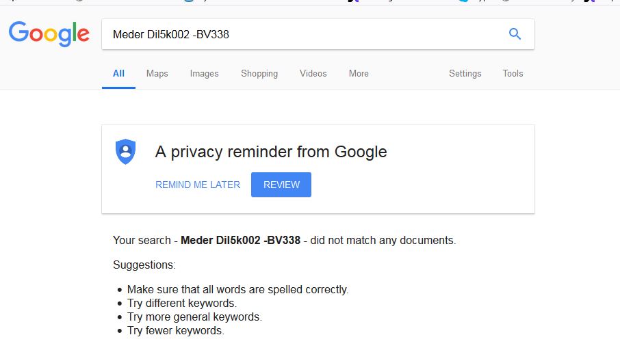

Blimey googling 'Meder Dil5k002 -BV338' returns no results. Not had that in a while!
When i try " dil 5k002 bv338" there are a lot of hits here in europe on google and ebay.

I know, odd. Google is usually so desperate to return something!
