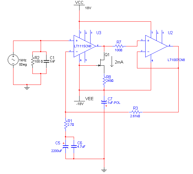

The AD745 is quiet and fast enough -- but a little pricey (around $7). It's used in hydrophones, ceramic transducers etc. Walt Jung describes an MC RIAA corrected preamp in the "Op Amp Applications Handbook" (but there is an error in the schematic).
The FET's are a good idea -- Erno Borberly has several designs on his website -- www.borberlyaudio.com you are free to use them on your own, or can purchase PCB's from him. He also has PDF's of the various articles that he has written for AudioXpress.
here's an idea adapted from Linear Tech's LT1115 datasheet:
