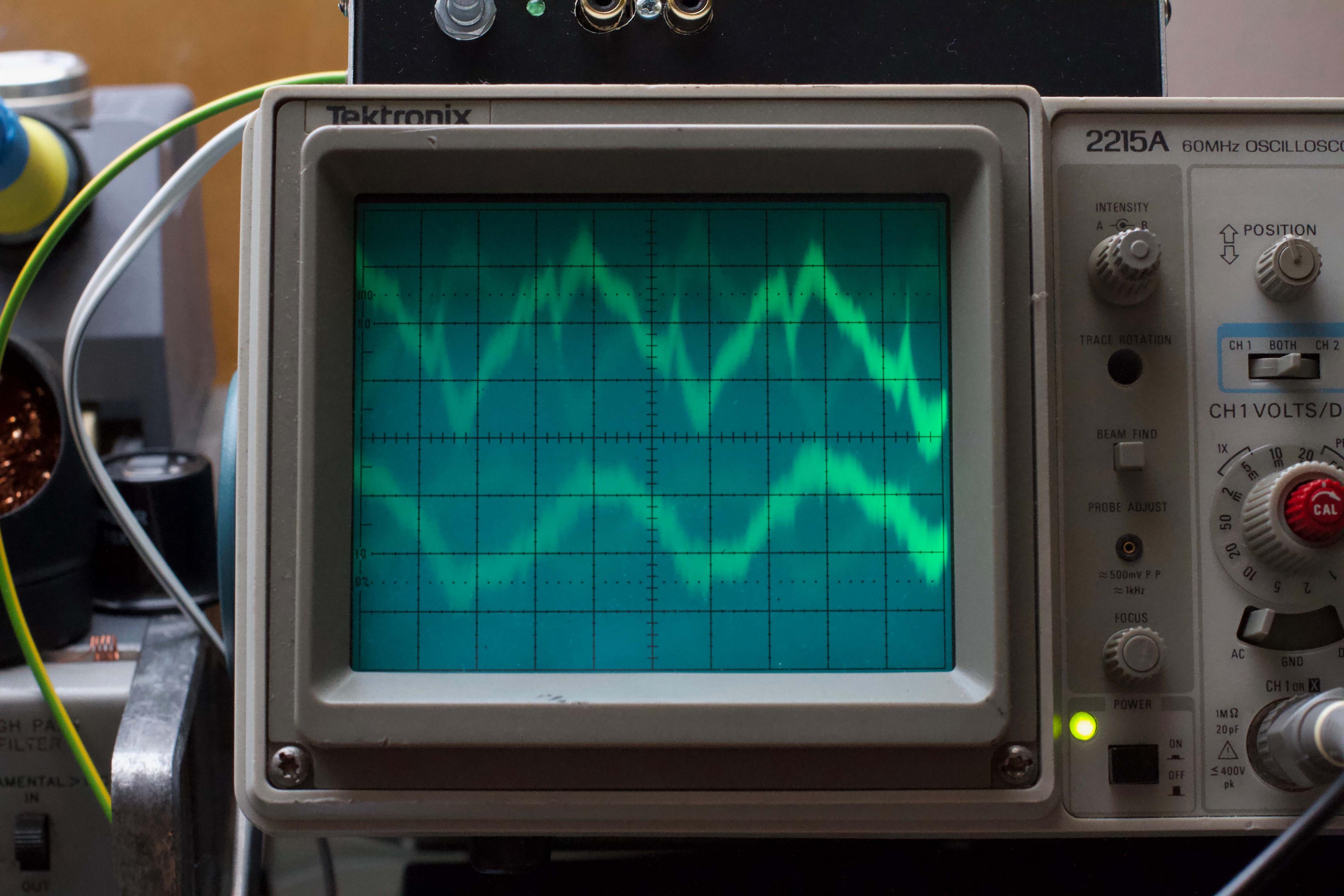

So today I'm getting -1.6-1.7 mV on the left channel & 2.5-2.7 mV on the right... when I plug in the TT the left channel rapidly changes between about 0 & -4mV and the right channel does the same between 0 & 4mV.
I connected the scope to the output with inputs shorted and apart from the offset both looked identical. My scope only goes down to 2mV resolution but all I could see was a bit of mains hum which wasn't surprising as the PCB is now unboxed.

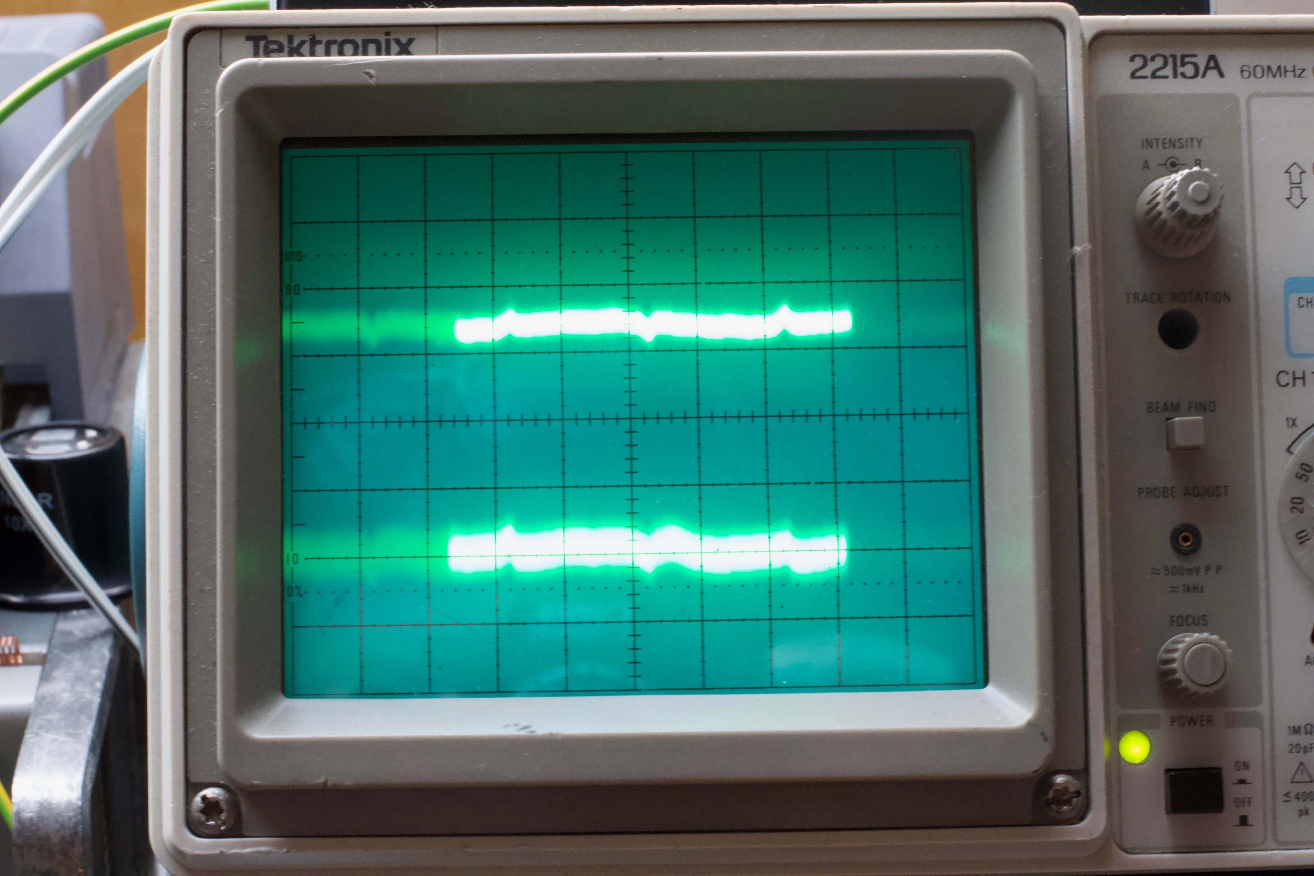

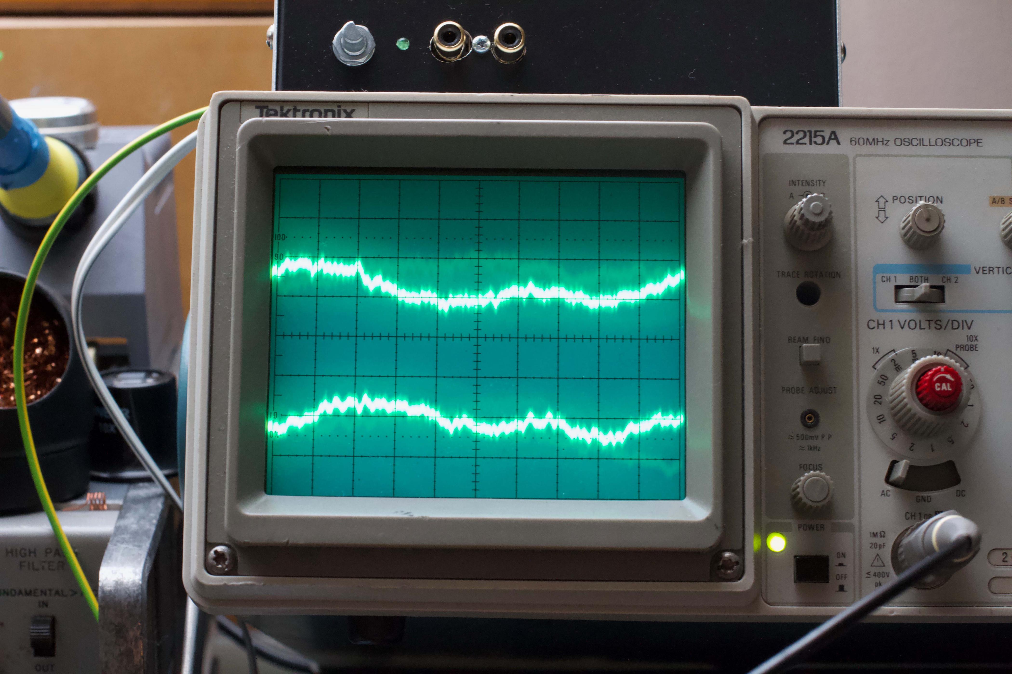

I hooked up the amps to the scope, it's set to 5mS resolution.
The first two have the servo disabled and sub-sonic filter out with scope set to 2mV/division. In the second pic I think the spikes you can see are what I thought was RF interference when I connected the TT.
The second two are with the servo and 20dB gain on the in the final stage with the scope at 2mV for the 3rd picture and 5mV/division for the last one. In this amp the Servos are keeping the DC < 1mV so appear to be working.
I also upped the servo caps to 1uF. After removing the original caps I noticed how difficult it was to clear the solder from the pad connected to the ground plane (I had to heat it for about 20 secs to melt the solder left in the hole). So I wonder whether a dry joint to the ground might have been the origin of the servo problem.

Let me first try to understand what I see.
T
he two traces on your scope images are for the right and the left channel simultaneously in one image, right ?
The good thing is that L and R are more or less the same in all images.
What can't be seen is the DC voltage, so whether the Servo is working or not is impossible to see.
But do I understand correctly that in all settings with servo, DC output is ca. 1mV ?
Your TT is picking up a 100Hz signal with spikes. this can easily be caused by mains pollution from refrigerators or whatever household appliance and doesn't look very alarming.
You mentioned to have some other Riaa amp, try to do the same measurement with the TT connected, and see if there is a difference.
And last but not least, is your amp encapsulated in a metal box, properly grounded to main earth and what about connecting your TT to main earth ?
