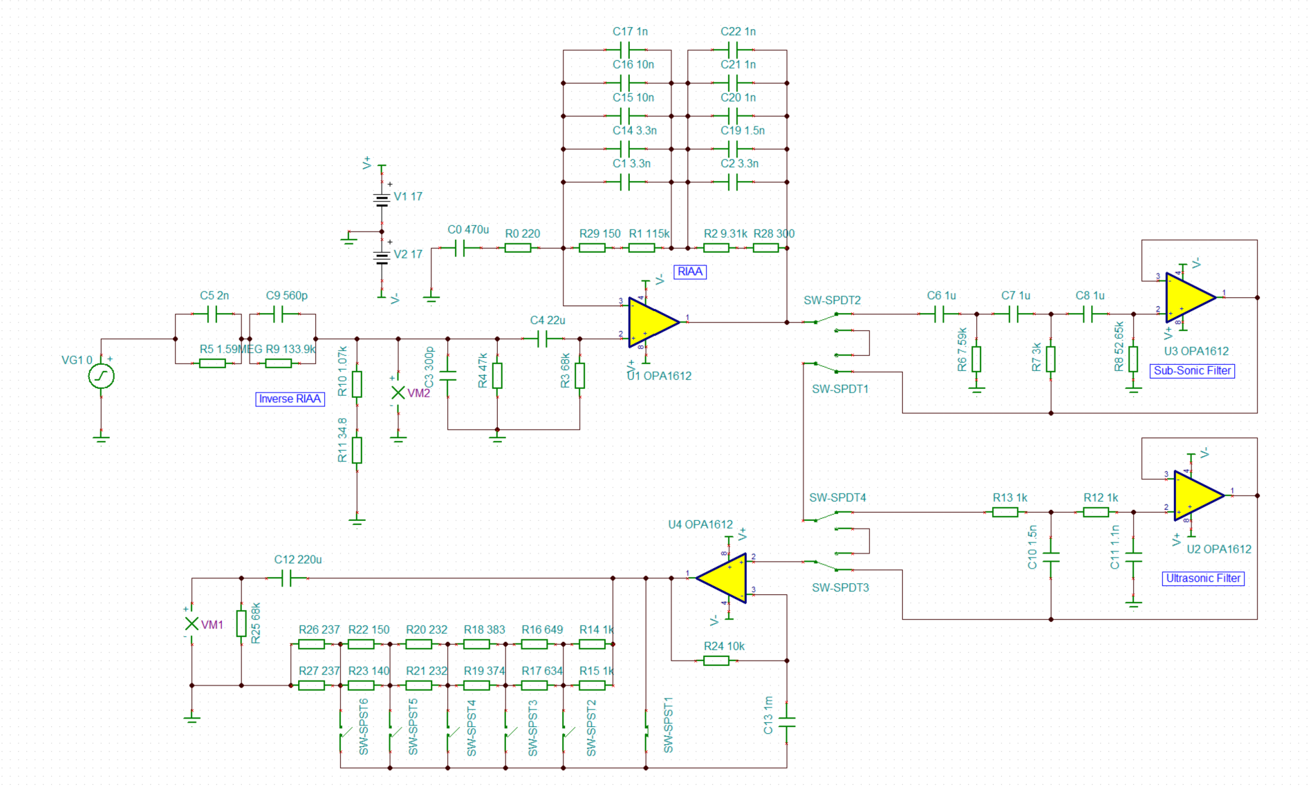

I made my first phono stage a few months ago with a design based upon a TI app note. Thanks to help from people here I got that working and was pretty happy with the results. Since then I've been reading Small Signal Audio Design by Douglas Self (great, accessible book) and have realised that what I produced was far from optimal.
So here's my second attempt, it's a 35dB RIAA stage, followed by selectable high pass and low pass filters with a switchable gain stage at the output. The op amps are OPA1612, ceramics are C0G NP0 1% and resistors are thin film 0.1%. The electrolytics are Nichicon Muse bi-polar.
Because of the signal switching I've gone for a four layer PCB (first for me) with layers for signal (top), signal ground (2nd), DC ground (3rd) & power + switching (bottom). The relays will be controlled by a microcontroller off the board.
So any advice, comments or if you spot mistakes I'd be really grateful to know. It's Chinese new year at the moment so I'm hoping put my PCB order in at the end of February.
Thanks,
Simon.

You have a 47K at the input, and then a 68K after the blocking cap. Load on the needle is 27.8K, an unconventional value.

Thanks for spotting, I added the HPF and forgot to update the 47k to 150k.You have a 47K at the input, and then a 68K after the blocking cap. Load on the needle is 27.8K, an unconventional value.

It seems very complicated and I am having trouble following the design, what are all of these relays for?
Depending on the op-amp used you probably don't really need the input capacitor.

Thank you for posting the Tina Ti schematic, it is much clearer, and I now understand what is going on.
I would probably avoid using the dual op-amp symbol in the future, and use one that treats them as separate parts (U?A/U?B) this will allow you to create a schematic with a logical signal flow.

1) The Riaa Caps are both wrong.
Left side should be 27n6 instead of 26n6, right side should be 7n8 instead of 6n8.
2) C3, 300p should be much lower. The capacitance of the phono cable will already be at least 150pF.
3) I don't understand the variable gain setting around U4. This doesn't work and should be corrected.
4) in this last diagram you have the OPA1612, a dual op amp which is not suitable for an MM. But in the earlier diagram you have the OPA1652, a quad fet op amp. That is a good choice.

Hi Hans, that was an old schematic that I used to simulate the circuit before creating the Eagle schematic and layout (I thought it would be simpler to read than the horrible one I put up before), but it is pretty much what I implemented.
1) The RIAA values are the ones you suggest (27n6 & 7n8) perhaps the top two 1n caps got cut off in your view of the schematic?
2) I didn't think of taking into account the capacitance of the cable - thanks for the advice.
3) I've simulated the gain setting in TinaTI and it works as expected... I'd be interested to know why you don't think it will work in practice.
4) Agreed

Question, why do you use so many caps, 10 in total, instead of 22n+5n6 and 6n8+1n, that will save you a lot of PCB space.
3) Why did you insert C13, 1000uF ? This cap will cause plops when switching and should be removed.
5) When using 1Meg for R3, you could replace C4 by a much better "normal" 100nF cap instead of a 22uF electrolytic. The OPA1652 has an Input Impedance of 100Meg.

I specced all the caps and resistors based upon what I can get from RS Components, they don't stock the cap values you suggest in C0G/NP0 1%. I've just checked and I can get those values from Farnell - so I think I'll follow your suggestion and save a bit of money.
3) I must admit that C13 is the one component that I don't fully understand, I've included it because Douglas Self uses one in his switchable gain stage. I believe it is for DC blocking and R24 provides the feedback for DC to prevent popping. I'm planning on testing with and without the cap to see if I can get a better understanding of what its effect is.
5) From what I've read as long as C4 has negligible voltage across it within the audio band and low current it should not have a noticeable contribution to distortion. Do you think a polyester cap would be better in this application?

R24 is important, because when switching there is a moment that relays are moving from one position to the other.3) I must admit that C13 is the one component that I don't fully understand, I've included it because Douglas Self uses one in his switchable gain stage. I believe it is for DC blocking and R24 provides the feedback for DC to prevent popping. I'm planning on testing with and without the cap to see if I can get a better understanding of what its effect is.

Without R24, gain would be infinite and would cause a giant glitch in the output voltage until the Relay has settled.
C13 on the other hand is not blocking anything, and should not be used.
C4 will have little or no voltage to bridge, this means that you could just as well take it out.
But in case you want a cap at that place, it better not be an electrolytic cap, despite all positive distortion figures.
A polyester cap will be definitely better, but no cap at all would have my preference.
Hans
Most important reason to have a cap between Cart and Input, is to block DC current.
But Since the OPA1652 only draws 10 pA, this cap can easily be left without any reason for concern.
Caps are not improving sound, so the less caps the better.
