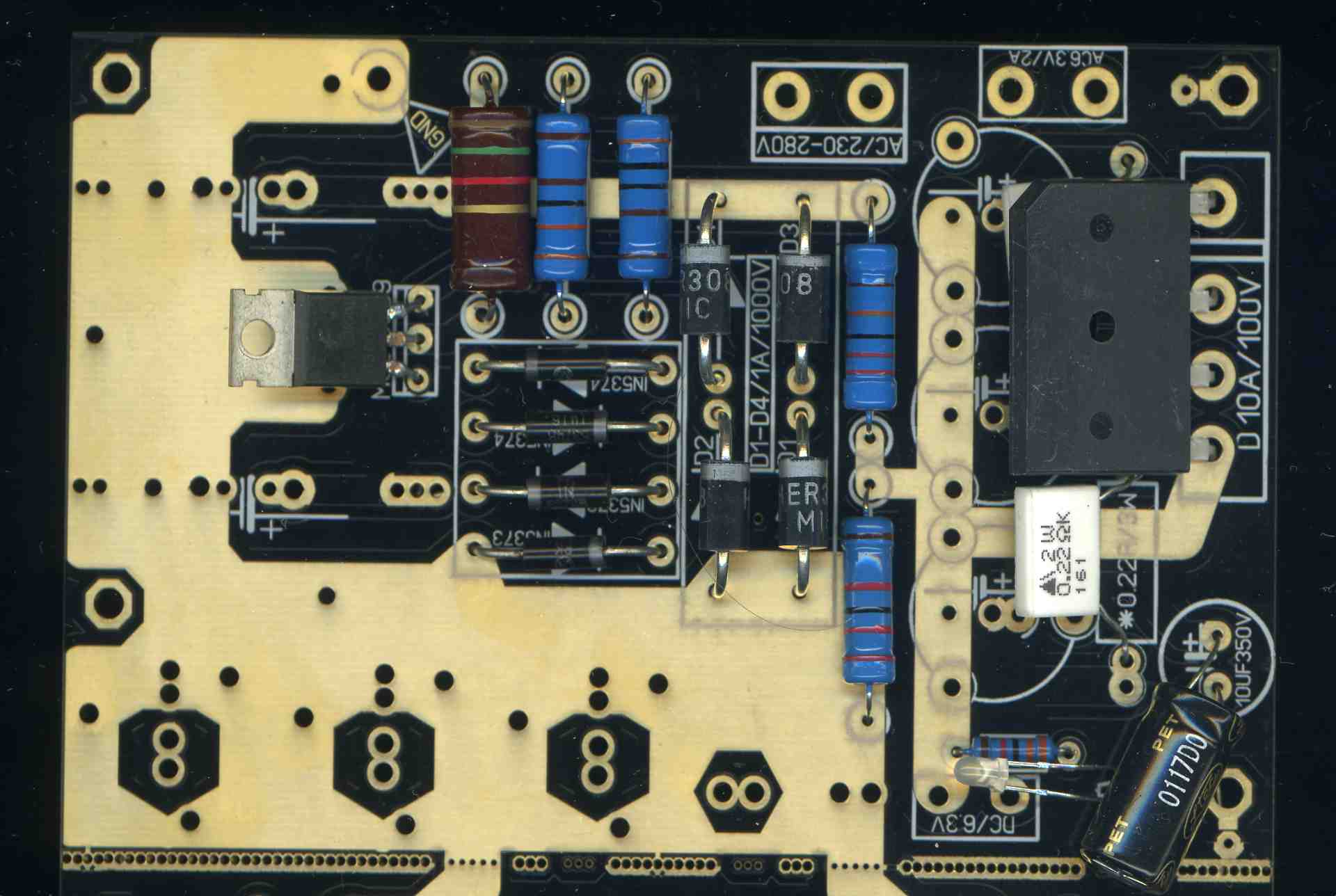

I put the circuit into LTSpice and ran a sim to check the RIAA error. I my limited experience it looks quite good. Not up to my HPA5.1 standard but I have seen much worse -
I am not surprised as the RIAA is the same as in this link:
GoodSoundClub - Romy the Cat's Site - EAR 834P Modification Guide>
Or this one in attached pict.
There are differences in the PS though.
Ironically the Chinese copy-cats made the same fault as Tim de Paravicini.
The tubes are starving from current resulting in harsh sound.
GoodSoundClub - Romy the Cat's Audio Site - EAR 834P Modification Guide
I corrected that and had also a look at Jim Hagerman's Cornet 3.
Cornet3 - MM Vacuum Tube Phono Preamp – Hagerman Audio Labs
My phonostage sounds very good now! 🙂
