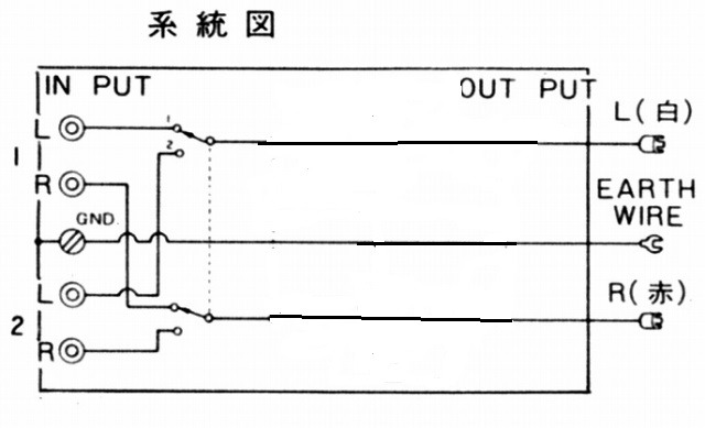

Would a simple switch box as in the attached diagram be adequate ?

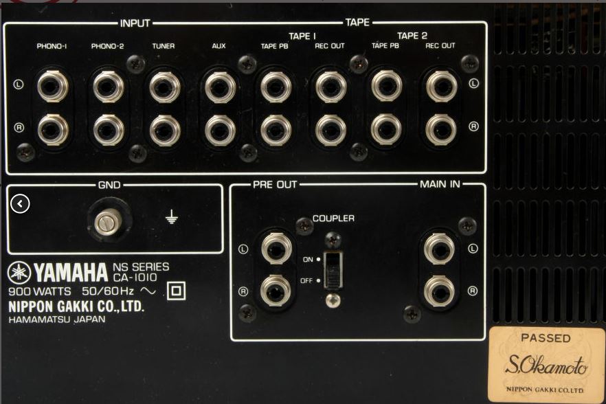

How was it solved in vintage amps of which many had two phono inputs ?
You don't want to switch the MM cartridge outputs. The switch contacts, wiring, and pcb traces are all bad for low level voltages.
Some even switch MC outputs - crazy. I use a pcb mounted jack, on the same board as, and mounted immediately adjacent to,
the input circuit of the RIAA stage. I'd rather have a separate phono preamp for each of the cartridges, than switch their outputs.
You are allowed to use shielded wiring... Then the main issue is contact resistance and oxidation - a signal-rated switch with gold plated contacts will fix that for MM, as the signal impedances are high. For MC though the variation in switch contact resistance is potentially going to be audible - switches are microphonic at these low impedances (if you've built an MC amp on a breadboard you'll likely have noticed the breadboard contacts become microphonic, same thing). But a good quality switch (once you stop playing with it) should be reasonably quiet - but thick gold plating is rare and expensive and is required for long-term reliable behaviour I think.
I think a practical aim is to make sure the circuit is less microphonic that the input connector - often that's the worst component in the chain - and its worth paying attention to the quality of that and the cable first.
