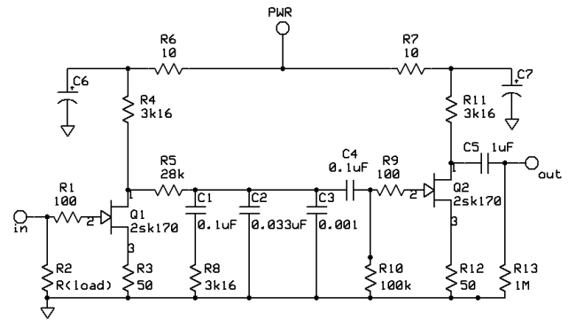

While waiting for the PCBs to arrive, I made a set of perfboard versions using WIMA MKS4 and EVOX MMK caps. I haven't added the JFETs yet as I need to measure the ones I have and make some matched sets. I'm just curious to see if a version using cheaper less exotic caps sounds significantly different.
