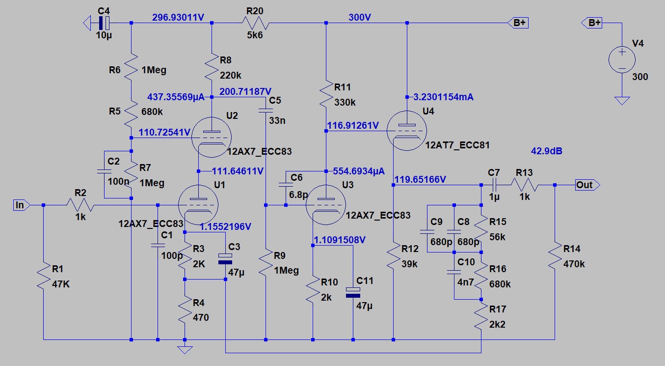

merlin el mago Member Joined 2009 Paid Member 2022-05-06 8:41 pm #21 2022-05-06 8:41 pm #21 Thanks Bela, I will give the info to my friend. E euro21 Member Joined 2004 Paid Member 2022-05-06 8:48 pm #22 2022-05-06 8:48 pm #22 Sample values: merlin el mago Member Joined 2009 Paid Member 2022-05-07 7:00 pm #23 2022-05-07 7:00 pm #23 That's super, now we can check the voltages according your schematic, many thanks Bela. Prev 1 2 First Prev 2 of 2 Go to page Go You must log in or register to reply here. Share: Facebook X (Twitter) LinkedIn Reddit Pinterest Tumblr WhatsApp Email Link
