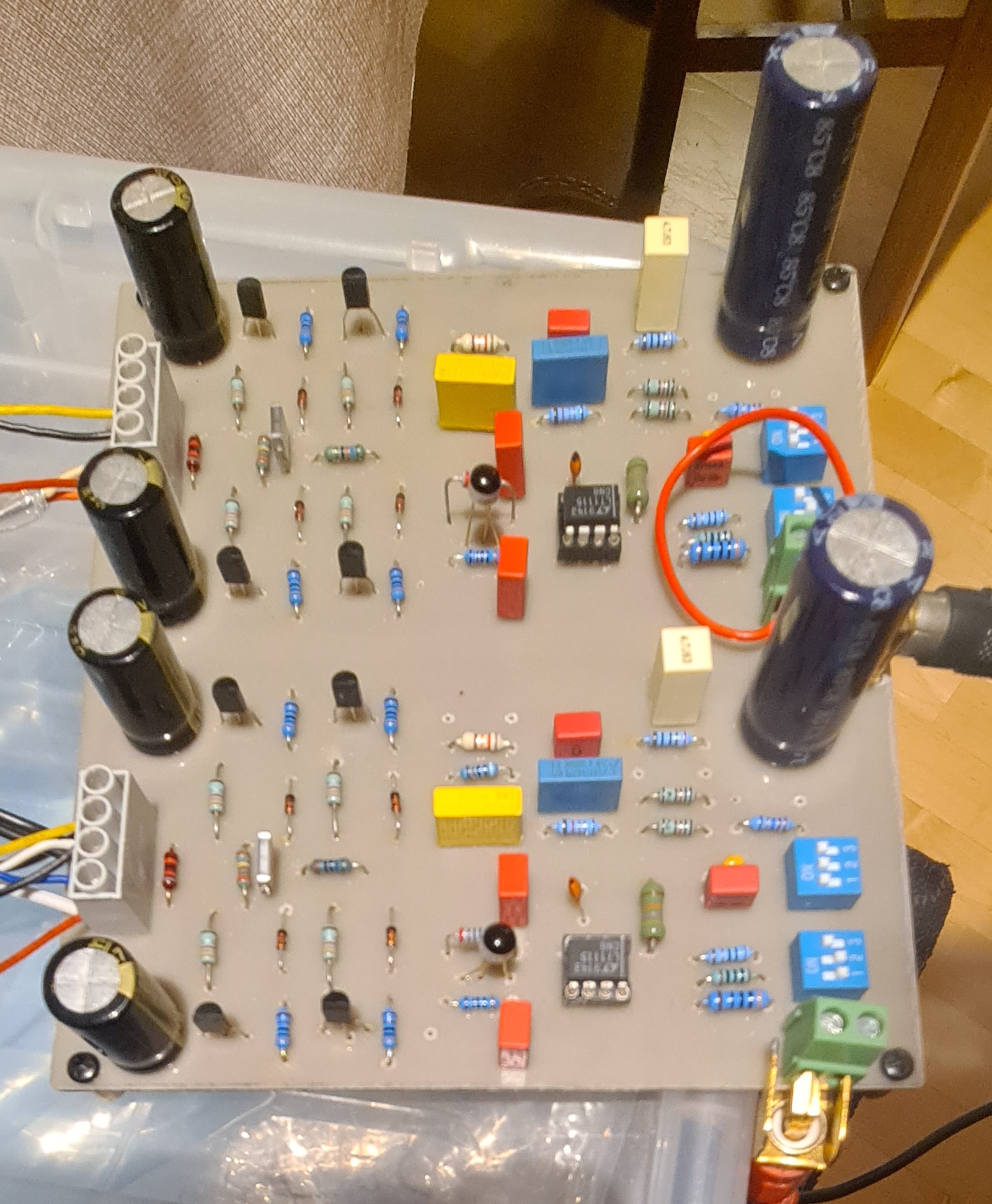

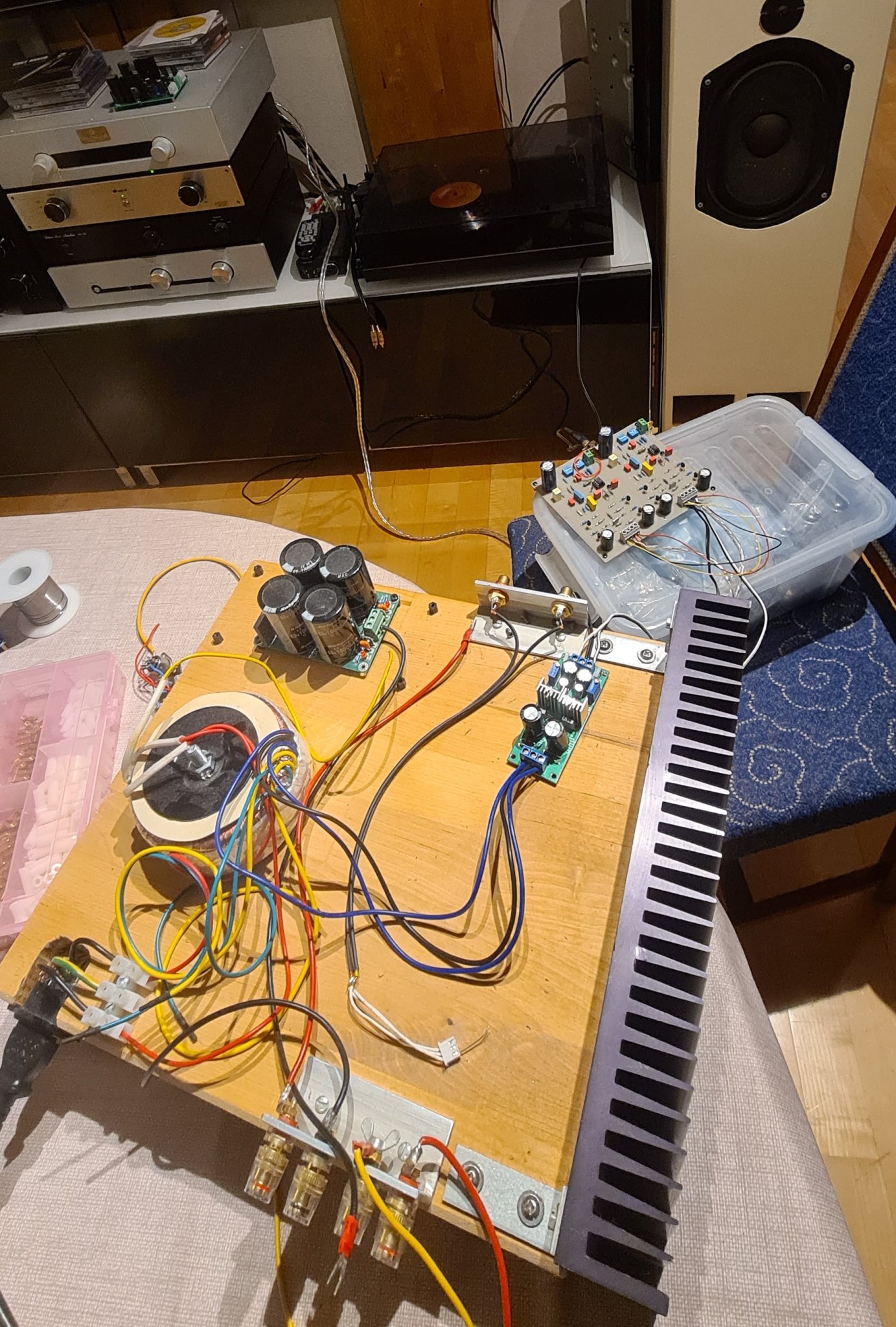

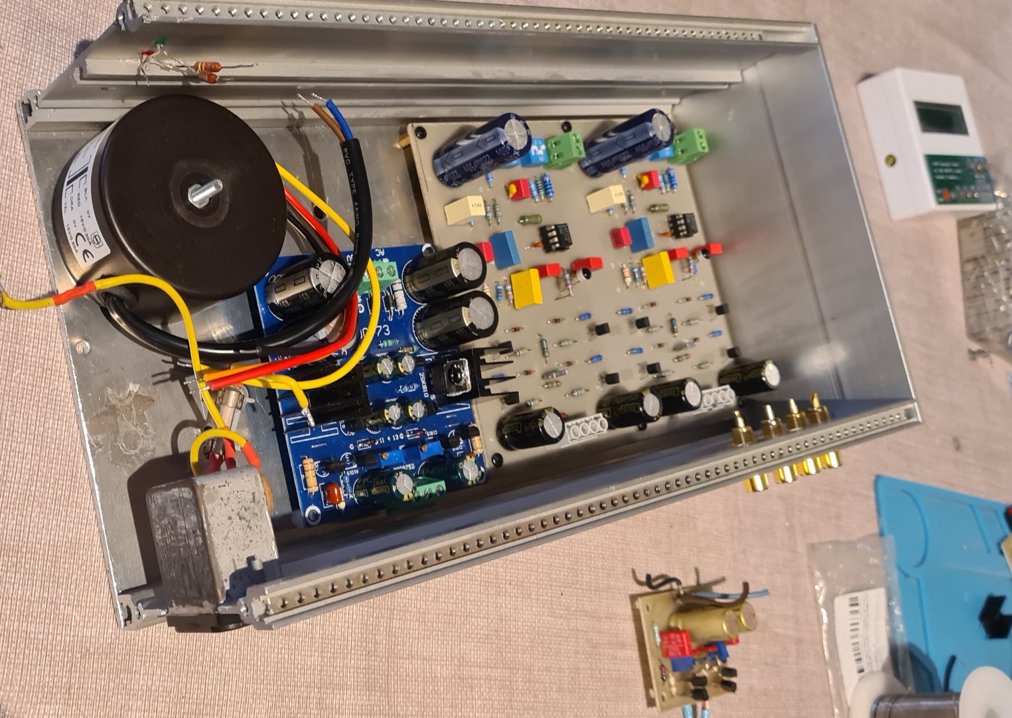

I finally finished building and testing the LT1115 preamp. Indeed a pleasant surprise!
"No" noise, no hum, sounds nice with my old Rega and Ortofon MC30.
Now this ugly duckling PCB will live in a suitable case, formerly occupied by a Hiraga MC preamp.
Finished board:
Testing:
RIP - soon:
(Hiraga MC at the bottom)
If I were to make this amp again, I would probably drop the FET and use a resistor. Using the original FETs seemed like a cool thing to do, but they have to be fine tuned to give the desired 2mA. With components according to the app note, the difference between the two channels was BIG. 2.1mA vs 1.2mA. No difference in sound was detected, though. And I would make a new, 2-layer PCB with a more compact layout.

No problems at all with the Hiraga MC...
But this little card was housed it the shown box together with 2 big accumulators and a charger.
Thought it was a good thing. But it was too much hassle.
Now I want to put the Hiraga in an ordinary preamp box togehter with a suitable PSU, some RIAA amp + AUX inputs + volume + output buffer.
At least, that is the plan.
Now I must first get used to this new toy!

Finished board:
