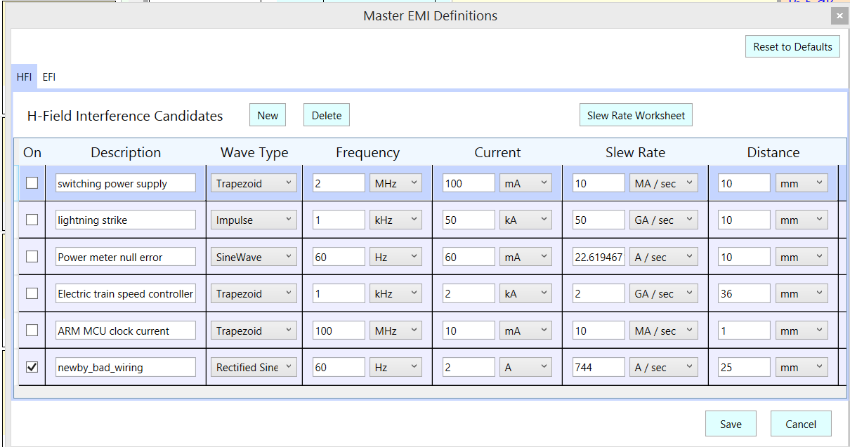

MitchMev: attached are 3 screen shots of a tool that explain your "noise"/hum.
Attach#1 shows the EMI database: I added a new interferer at the bottom, intending its 2 Amps to represent the peak 60Hz currents thru the 2 yellow wires from XFORMER to the 2 half-wave diodes. Your opamps probably only use 20mA, so the 2Amps peak may be a bit too high. BTW, this 2Amps is our aggressor energy.

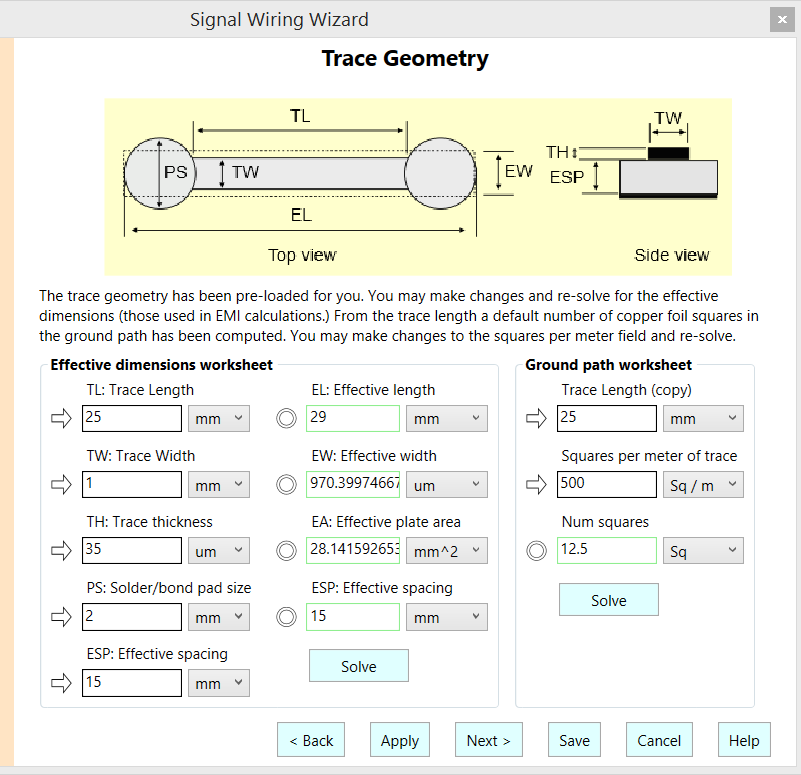

Attach#3 is the physical description worksheet for the circuit loop that is vulnerable to magnetic field. The 25mm length is about what I see on the bottom left, from RCA jacks to the wiring-board. The 15mm height is my estimate of distance between the GND wire and RCA jack center post.

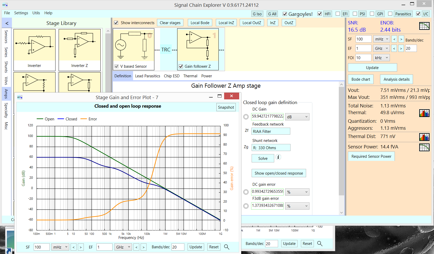

Attach#2 shows the SCE (Signal Chain Explorer) topology I set up; its just a 1milliVoltPP sensor, a "TRC" which is the 25mm * 15mm input loop, and an opamp with RIAA feedback. You'll notice the frequency response in lower part of the attachment. On the right side, at top, is the SNR of 16dB.
Looking below that, you'll notice the Aggressor is 1.13 milliVolts while the thermal noise is only 49 microVolts.
Cure? Twist those two yellow wires together tightly; their currents are in opposing direction, thus their magnetic fluxes ideally will perfectly cancel if an ideal twisted pair (machine twisted for uniform twists) is used. Or place a piece of steel between the top and bottom of the circuits.
