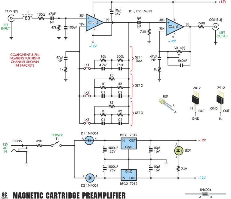

I copied the circuit from my Kenwood KX-A36, which uses 5532/6556, and made a pre amp using the TL072.
I used a 12 volt wall wart, and had to change the input and output resistors. The linear wart gave about 17 volts at that low load, good as the output is proportional to supply volts.
