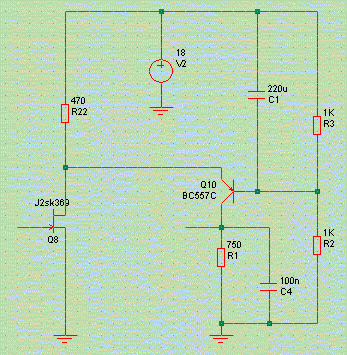

A bit of topic, but since you mentioned open-loop phono preamps, here's a frontend concept of one of mine, the particular values originating from my 21V PSU and the stash of 100nF Siemens MKV caps I have.
My other phono project is, incidentally, around an AD797 in inverted mode, with a, let's see, AD711 in the servo ;-)
