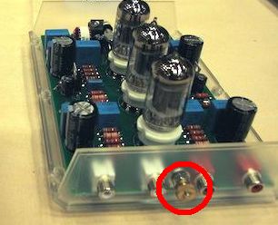

My vinyl equipment consists of a modified Lenco turntable and a Hagerman Cornet3 phono preamp. I have had a long standing grounding issue that is presented as noise from the speakers when I touch the tonearm. As far as I understand the reason for this is quite simple, the power supply that came with Cornet is a wall wart type, with a 2 prong connection. Meaning there is no ground. I have checked that I have continuity from the tonearm all the way to the mains connector on the phono amp.
I must be missing something, how should I get this grounded if the power supply doesn't have a ground pin?
You need to connect the ground screw with a piece of wire to a similar ground screw on your amplifier. Not to the mains protective earth.

Thanks for the reply! On the back of my amplifier? Do you mean the phono preamp or the speaker amplifier? The one on the phono is connected, my speaker amp (Elekit TU-8200) doesn't have a similar ground screw.
As far as I understand the problem is that while I have connection to the ground screw on the phono preamp, the preamp itself is not connected to any actual ground.

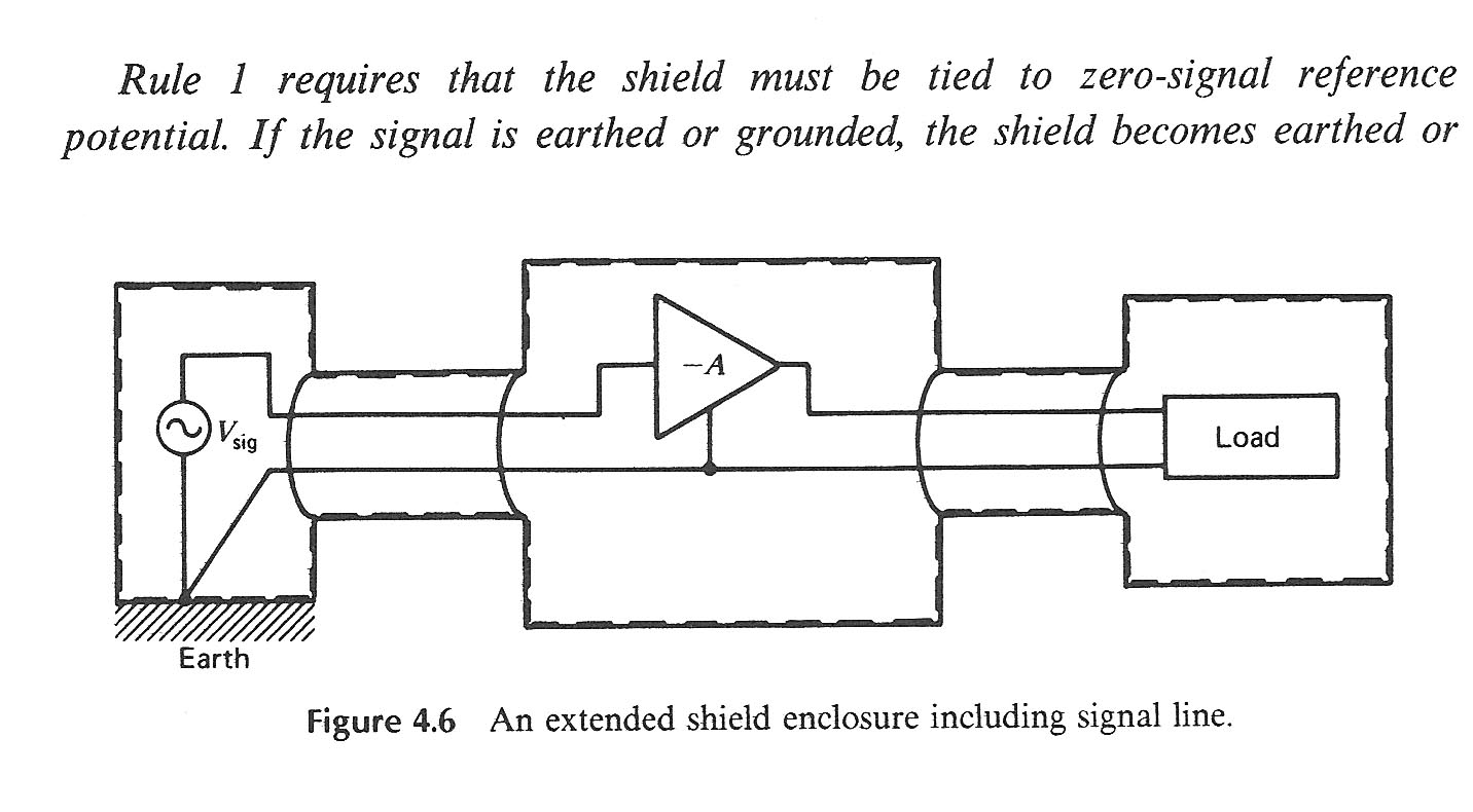

Now that you've solved the problem...looks as if the Hagerman Phono pre of your vintage is housed in an acrylic case. You could probably fit it into a nice LMB chassis. This is not ideal. From "Grounding and Shielding Techniques in Instrumentation" :
