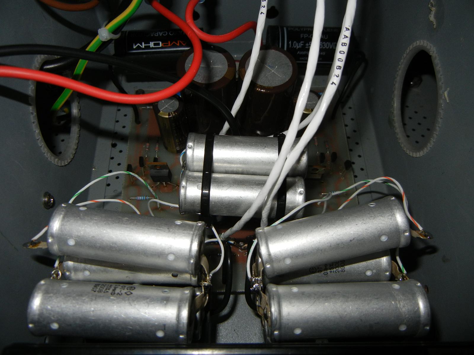

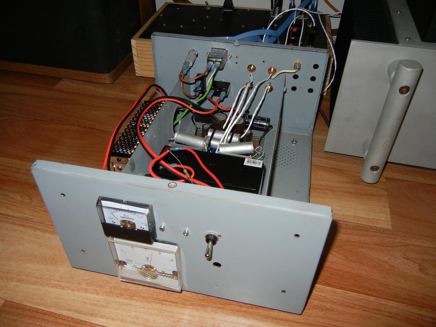

finally finished my preamp, using teflon caps for the riaa. running the preamp off 2 sla batteries and using a meanwell switching psu as a charger. soundwise i'm impressed! sounds clean, noise floor higher but i can live with that!

By the way, I hope you use a moving iron pickup with that phono stage. Having a big mosfet at the input brings a large loading capacitance (Cis) that will roll of the tremble of an ordinary MM (remember recommended loading capacitance of the manufacturer! Usually quite a bit smaller than the Cis of a regular power mosfet.).
Otherwise, enjoy! Hannes
hmm, I use a grado prestige gold mm cart, upgraded stylus, with no problems. this setup sounds far better than the commercial phono amps I've owned. almost matches my modified linn karik for sound quality. you could do a lot worse than a IRF610 when it comes to gate capacitance, the secret is proper biasing.

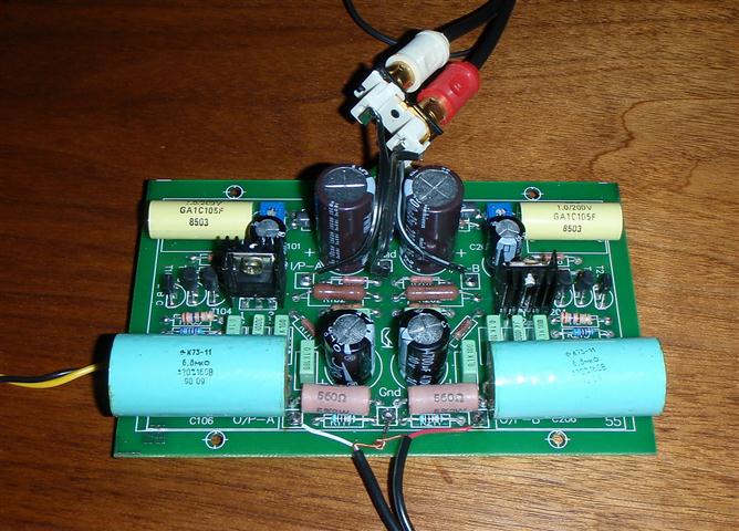

MOSeiden phono stage
Built, playing now...
Sounds good, actually better than expected.
And less noise than expected too!
BUT, gain is a bit too low for my system, with passive/buffer-pre.
Maybe a single JFet in front would been perfect..?
( + another 6-10dB)
Arne K
