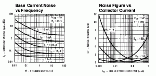

1) Yes the input resistence should be 47k but I haven't measured it yet. I've seen a few project where you can select the input resistence, pheraps your hears could coiche the good input restence.
Sure I considered the second stage input impedance. Sure, I measure the resistence looked at the collectors of Q1 and Q2 then I calculated the RIAA then I mesured the RIAA.
2) No noise is less with high current, the diagram from lm394 data sheet show it. Usally more current, more electrons you have and more SNR you have (i.e. in rx-tube SNR=SQRT(N) where N is number of photons that is related to the number of electrons then related to the current)
This is a big mistake. The total noise has two components: noise voltage and noise current multiplied by pickup impedance. Noise voltage of BJT is decreased with emitter current, as transconductance do (26mV/Ie), while the noise current (search for diagram!) is increased with emitter current. The optimal emitter current value for MM pickup -100uA.
