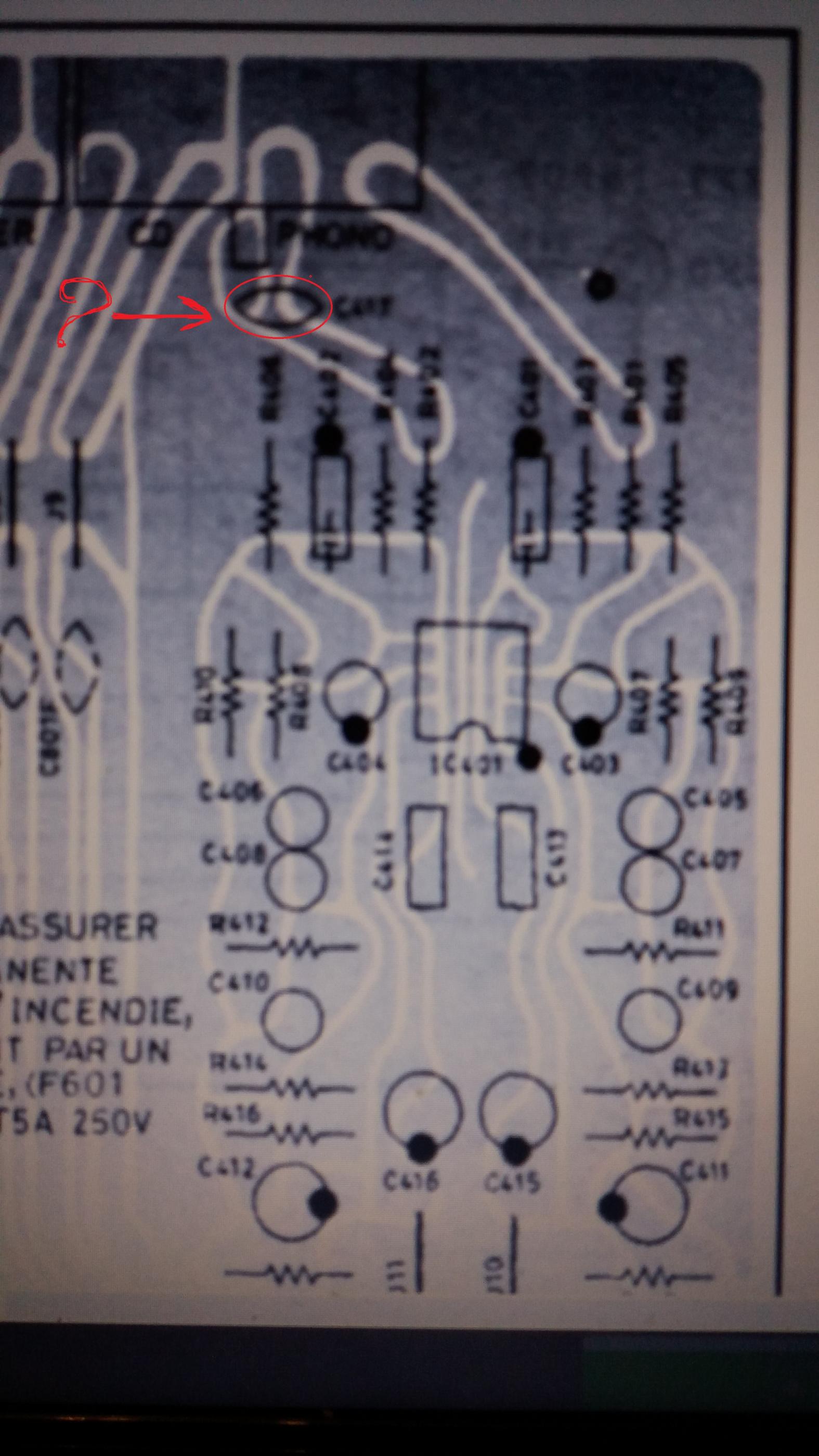

Phono circuit of Rotel RA931
Hi. I have built many phono preamp kits. All very good.
But none presents the ground connection of the rca with capacitor to ground of the circuit.
What benefit does this way of doing ?.
A capacitor connected from the phono ground shell to chassis ground helps to suppress
radio frequency interference by shunting to chassis ground any RF picked up by the
phono cable's shield. It should have very short leads to be effective.
I do not handle English very well. But what I see the ground connection of the RCA is to the circuit ground.
The turntable land is directly on the ground of the circuit.
From what I interpret, the ground of the phono wire is not in continuity with the turntable land nor with the earth of the circuit. The capacitor is 0.1 uF.
