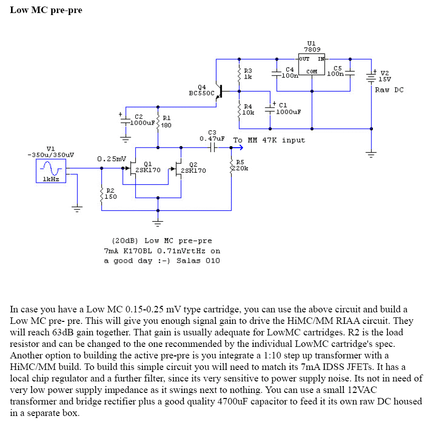

Hi, I’m using the Salas Low MC Pre-Pre in my 0.25mV cartridge to reach MM signal level before entering the Phono PreAmp, this works really well and had no problems with it.

Now the question, referring to Salas’s circuit, it’s possible and reasonable to move the loading resistor R2 in-between Q2 & C3?, this means after the MC 0.25mv signal was amplified and left the Q1 & Q2 without input load.
...it’s possible and reasonable to move the loading resistor R2 in-between Q2 & C3?...
No. It won't give the cartridge the right loading.
And why?
IF the cartridge needs loading, right where it is is the most logical place.
There IS an alternate with some promise of hiss reduction. Use NFB and Miller effect to emulate a small resistor with a larger resistor. However for the usual values of MC cart and load the hiss improvement is very small. And you need to know your gain pretty exactly or the emulated load won't be right. And in vinyl playback the amp hiss is a small part of the total playback noise.
