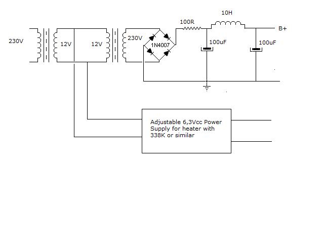

Hello everybody,
I'm building a new phono preamp and I'm now working on the PSU, attached there is a first schema.
Based on your experience what do you think about it ? Moreover, since my brother has a lamp shop, I would use 2 lamp transformer (pri 220V sec 11,5V 4A) but I don't know how these can work:confused:. So... any suggestion or comment??

I have no direct experience with back to back transformers, such as you have shown. But I've seen a number of schematics doing something similar. Conceptually, I don't see any problem with it other than some loss of efficiency. Actual noise performance will depend on construction of the transformers.
Sheldon

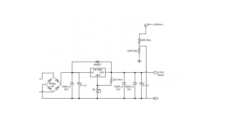

Attached is the heater supply schema with 338K regulator, the zero is raised from the ground in order to reduce any hum due to ground loops.
I did some simulation with psu designer, and modeling the two transformer as a single 220/220 I've a good output without ripple. But this is only a simulation.. it doesn't sound!! My bigger concerning is about the transformers, any experience about using lamp transformer like this??
The heaters are raised about 100V above ground, it may be too much for some tubes, probably 70V is preferred.
I'm currently building a SRPP headphone amp but with the same psu idea.
2 small transformers back to back (due to cost and space).
220/6 - 6/220.
Just make sure the second transformer that is in reverse has enough current as you will lose plenty.
I'll hang the heaters of the first tranny (AC) and then rectifiy/filter from the second to get around 300V.
I used a 2Amp for the second transformer which was an overkill, supplying around 100mA (but sounded great), so I'm trying a smaller one to supply around 16 mA.
